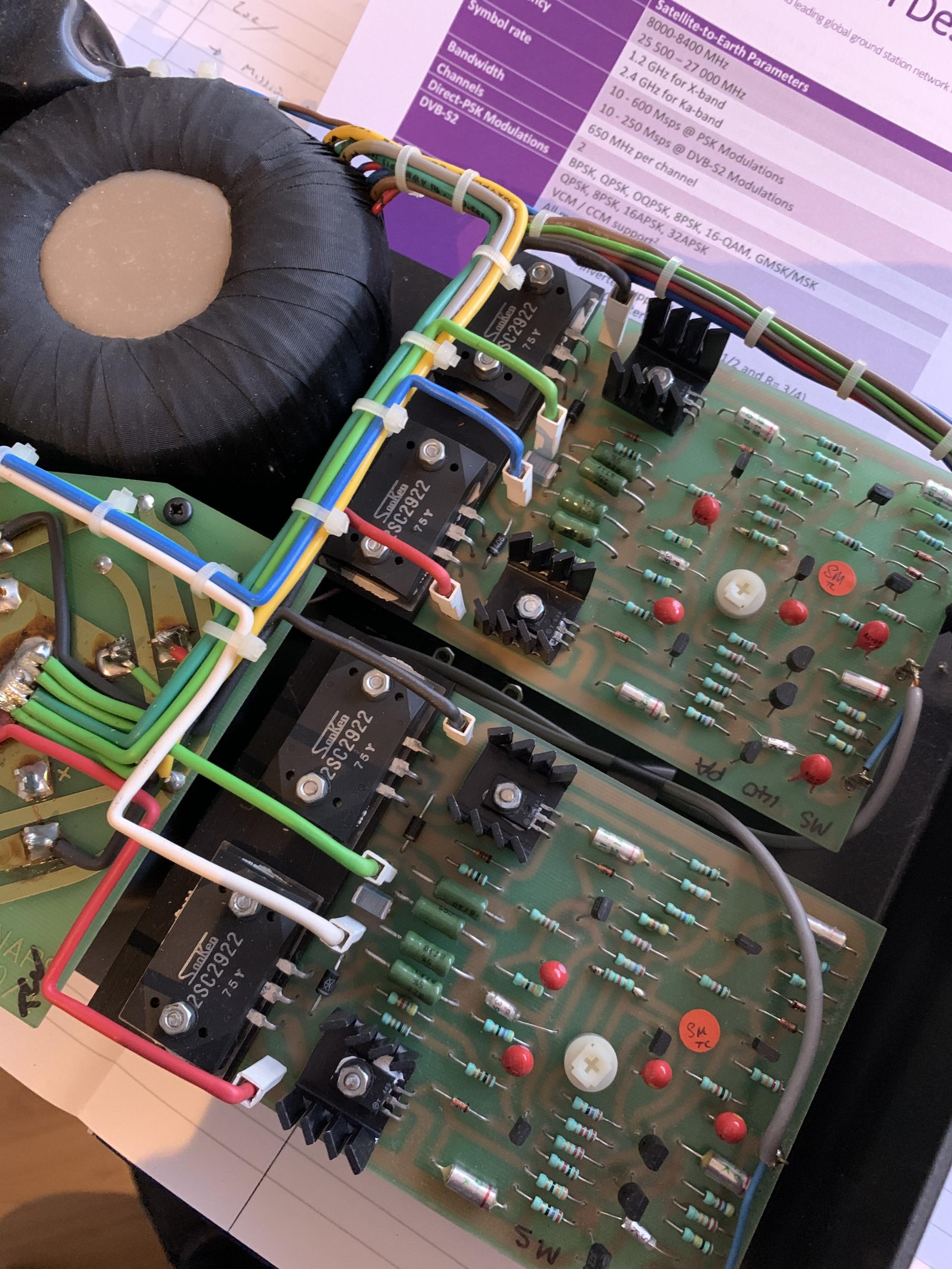

Looking for a little advice. I built a couple boards with spare parts I scrounged together, and used the stock schematic with the protection circuit intact. One functions perfect, the other has no gain. Both bias fine and have very low DC on the outputs but one just doesn't make gain in the VAS. All DC voltages are the same on both boards, the AC is the same in the LTP, and differs when it gets to the VAS where one simply fails. I thought it was a malfunctioning protection circuit that was dumping the voltage but i removed the two protection transistors and the problem remained. Should i replace the ZTX's? even though the DC matching implies they are functioning? Any guru have some advice?
The gain is determined by the feedback divider network. If the section splitting off from the 27k feedback resistor where it connects to the inverting input transistor of the long tail pair - that is the arm with the 1k resistor and 68uF in series - does not connect to earth properly then you will have a closed loop gain of one. Check the soldering joins in this area and that the 68uF capacitor - perhaps one of the scrounged parts - is not defunct.

Dude, thank you for the help. It turned out to be a 100K resistor where 1K belonged. Considering alcohol was the project's catalyst, it all makes sense now.

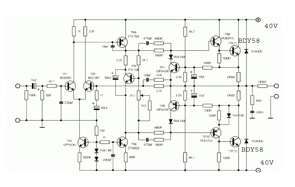

I was looking the high-res orj. nap250 pictures on the web. I can say that R18&R19 are all the same with schematic(390&680ohm). But, for R14&R15 I couldn't find any picture showing them 680&560 ohm . Three of them R14&R18 was 470&150(180?) ohm. I'm not sure about the values but, there not the values as in the schematic. Are you sure about R14&R15? Did you see that values on the orjinal Naim circuits? Or this values are changing in the Naim Amp.?

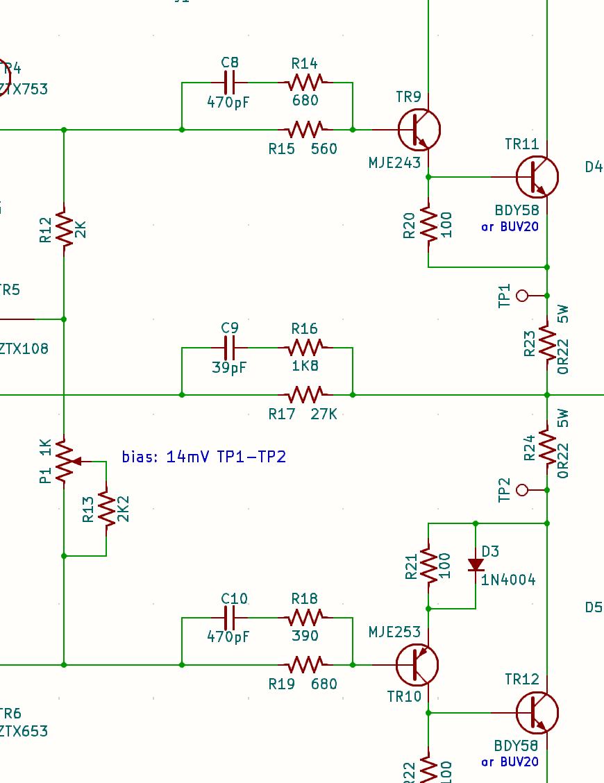

This is the schematic that I believe shows them as 680 & 560:

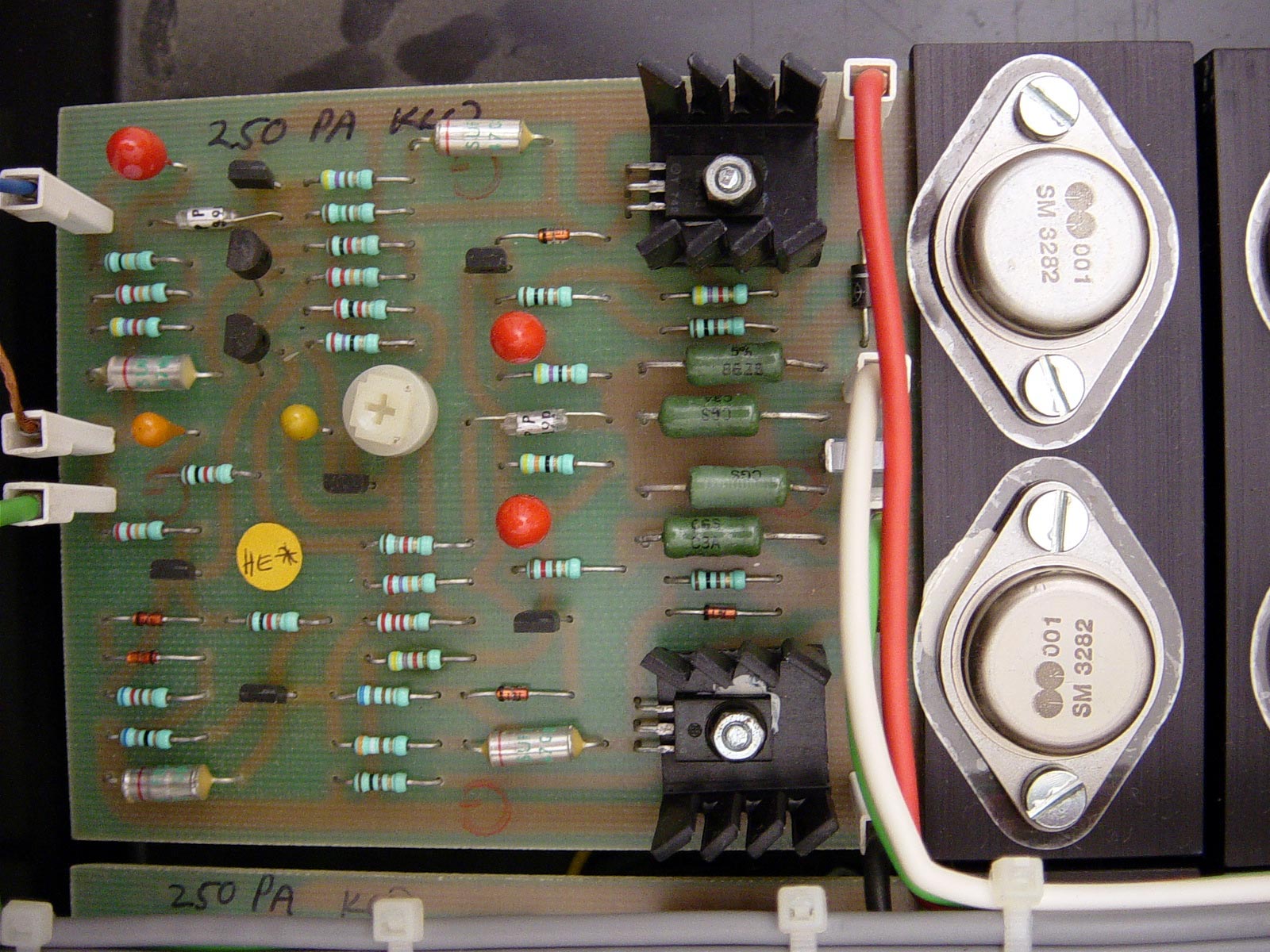

But yeah, this board has 470 & 150:
as do several other boards I've seen pictured.
Which is right? I haven't a clue... but 680/560 sims better in SPICE.

There are problems in using internet images without proper references to what they are. I could assume that the above pics are of a Naim factory or service centre modified NAP 250 (note the proprietary NA001 power transistors on an earlier PCB) though the assembly looks odd (thermal grease seems to be insufficient). It also has Zetex E-line transistors everywhere except the input pair and the output stage transistors, so what is it or what has it really become?
Even if modifications are factory approved, it still means you can't rely on the original schematic as a reference. In reading JV's last interview, you get some idea of what was on his mind when he decided to add those networks to the flagship 250 design. Here's the extract:

I have a 1980's brochure showing the internals of the Olive series NAP250 which shows values of 470R and 150R that you mention.
Re your simulations with 680/560, I don't see where you simulated amplifier with the regulated power supply connected.
It took JV a lot of trial and error testing to make the NAP160 into the NAP250 to make these elements compatible.
One could easily imagine possible flow on effects with changing just one value of resistor or capacitor anywhere in the power module or the regulator module being a root cause.
If the supply rails of an amplifier are increased then this will affect any common emitter stages in the system such as the VAS and both LTP transistors.
Under dynamic conditions the current drawn through collector loads will change the voltage seen at the collector of any common emitter stage.
This will change the collector to base capacitance in these stages whereas such has an inverse relationship with the square root of such applied voltage.
There is need to consider the differences between a system with in voltage rails in excess of 50 volts with an original design calling for 40 volt rails as per the original design. This is a big leap.
