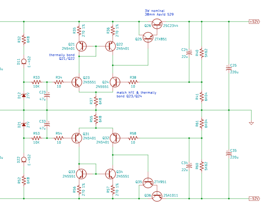

If I were to design it myself I would indeed put in a bigger shunt (and even more importantly I'd put in a CCS for the zener). But I was trying to stay as true to JV's as possible.
(FWIW, here's my "clean sheet" regulator for another project, although it only handles the front-end:
attachment.php

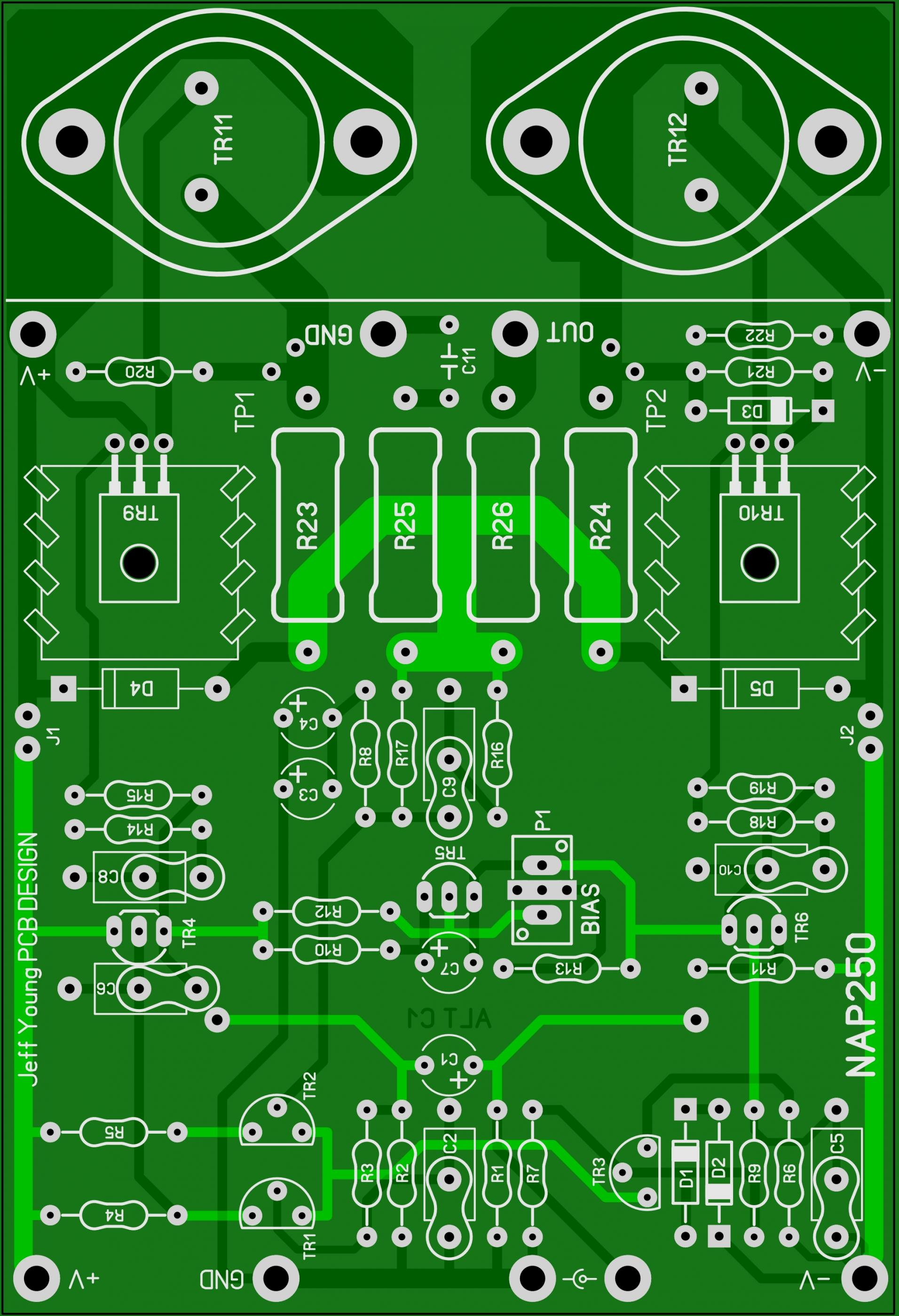

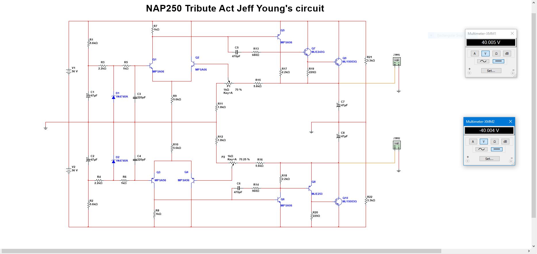

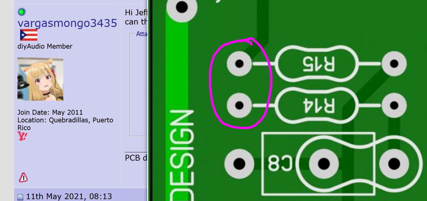

Hi Jeff I came back I fix some bug from me on post #153 and this is how the layout look like now 🙂

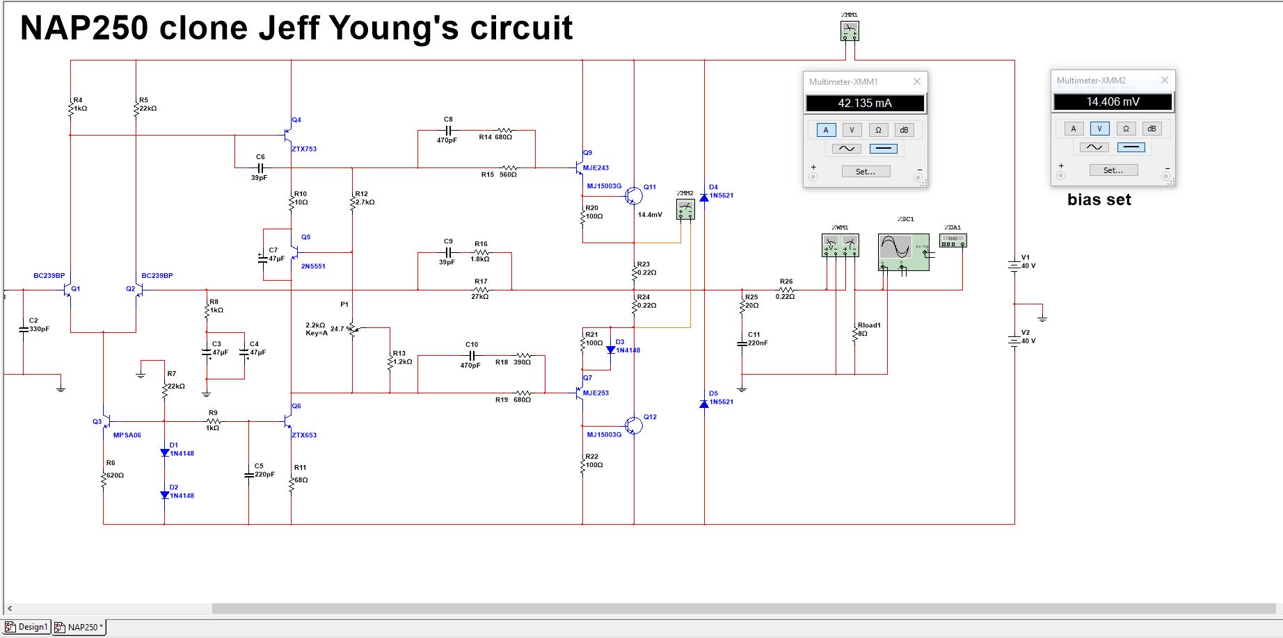

question this can work without the regulator? I see J1 and J2 and about current consumption in standby is low I got on simulation about 42mA from a 14.4mV
TP1 and TP2 that is about normal? I change P1 to 2.2K because it was drawing too much current if P1 use original value of 1K let me know when you get time
Regards
Juan

Hi Juan,
Yes, you can regulate whatever you want. Naim regulated both the front-end and output stage on the 250, and neither on the 140. Most HackerNAP folks regulate just the front-end.
The jumpers are there to support various configurations (including single regulator for both but bi-wiring from the regulator to the amp board).
Odd that you had to change P1. Was it drawing too much current in the sim, or in real life? (If the former, I'd guess it's just some bad models in the sim.)
P1 with actual original value 1K got it thanks and regulation info, I spend some time redrawing your layout I mean transferring to Sprint Layout 6 I love this style of kind like vintage look so nice here is the images side by side "not done yet" 😉
oh yes on simulation was drawing too much current got to be the simulation error yes I agree thanks Jeff
regards
Juan
