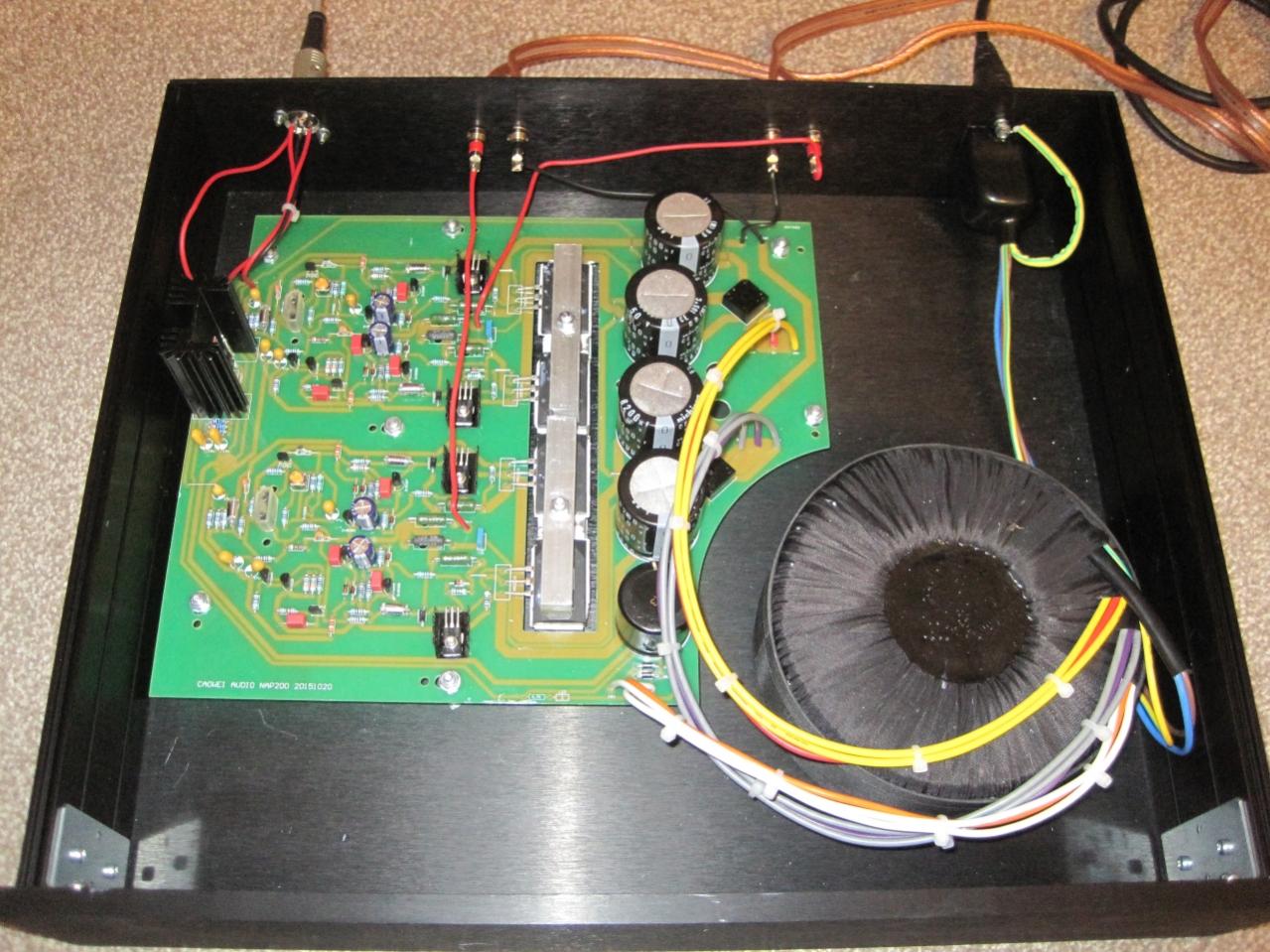

Finally finished construction tonight, see attached image.
I plugged it in (in series with a 60W bulb), switched on the power and.... completely uneventful, all was well! 🙂 There's about 7mV DC offset at each of the speaker outputs and I've set the bias to around 30mA.
It's relatively late here now and I've only just finished so I've not really given the unit chance to fully warm up and listen properly (everyone else in the house is asleep), however the first impressions are of a very detailed sound.
I'm used to the sound of a genuine Nait 3 but, to my ears, this NAP 200 clone sounds a lot more detailed and controlled. I'm still using the Nait 3 as the pre-amp, and will be doing for a while, but I'm sure an upgrade will come at a later date.
All in all a success, I feel.
There's a little internal tidying and cleaning to be done yet, and I want to replace the pre-amp PSU reservoir cap (currently using the old one taken out of my Nait 3 during a recent service), but these things can wait.
It will be interesting to see how others judge their versions of the amp when completed.
Nice looking build. What case / transformer did you use?
Did you replace any of the parts in the kit?
Thanks!
I used a custom transformer that I had built by a company in the UK - see this post for the spec. The intention was to match the part used in a genuine NAP 200 as closely as possible.
The case is one of these, I had it shipped over from Italy.
All PCB parts are as supplied in the kit, the output devices do appear to be genuine parts. I'm sure improvement by substitution can be made, but that can wait for another day.
I had to purchase additional components to populate the section of the board that powers an external pre-amp as these weren't included.
The output device-to-case heat transfer assembly was made out of a couple of pieces of aluminium bar cut to size - really not tricky at all. The plastic covers over the two pairs of transistors to the left of the board are just the end-caps off an HDMI lead.

howarthcd what did you used for the LTP transistor, the MPSA06 that were into the kit? Did you matched them in any way? 5mv DC offset is pretty good 😉
Hi, no I went to no effort to match the parts. My emphasis was really on getting the kit up and running to see whether it actually worked and so I have an objective to investigate and improve in future where appropriate. I'm open to any suggestions.
That said, what would you recommend as a replacement for the MPSA06 and how should they be matched? Would you recommend, say, the BC239C? These are increasingly rare nowadays though.
How should such a pair be matched - e.g. what hFE and at what current for this particular amp? Are there any other parameters that should ideally be matched?
