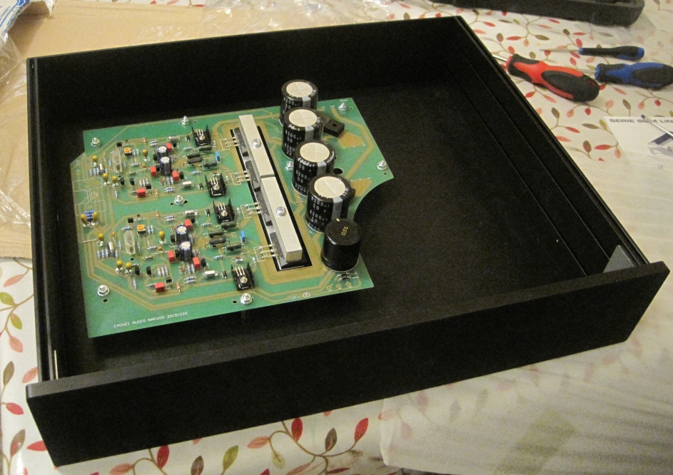

Thanks, the case arrived today and I'm impressed as you alluded to.
Annoyingly they've sent the version with a vented top even though I paid extra for the lid to be solid. The aluminium bars have also arrived so construction of the heat transfer assembly is underway.
Getting close now, just waiting on the transformer...

Getting closer... just awaiting the transformer, voltage regulator heatsink and a few bolts (and some spare time).
The heat transfer assembly is now ready, just need to drill some holes for the PCB standoffs and then for the connectors that will mount onto the back panel.

If you paid an extra for the non vented top, you should get it. Give them a call (email) and see what is their reply. They were always very responsive and helpful in the past.

Turns out it was my fault. The case apparently comes with two vented panels as standard, I'd specified that only one should be solid. Never mind, I'll just have to seal off the vents on the top panel somehow.

Someone said brass might be poor for a heat transfer device. Yes and no. The surprising thing is the transfer pads really are poor. Some amps have all the NPN on one heatsink and PNP on another. The heatsinks electrically isolated from the case. This allows just heat transfer paste to be used on the power transistors. A&R A60 had very high grade anodising on the heatsink. It managed to use the same trick without the complex isolation. That's brave and it worked.

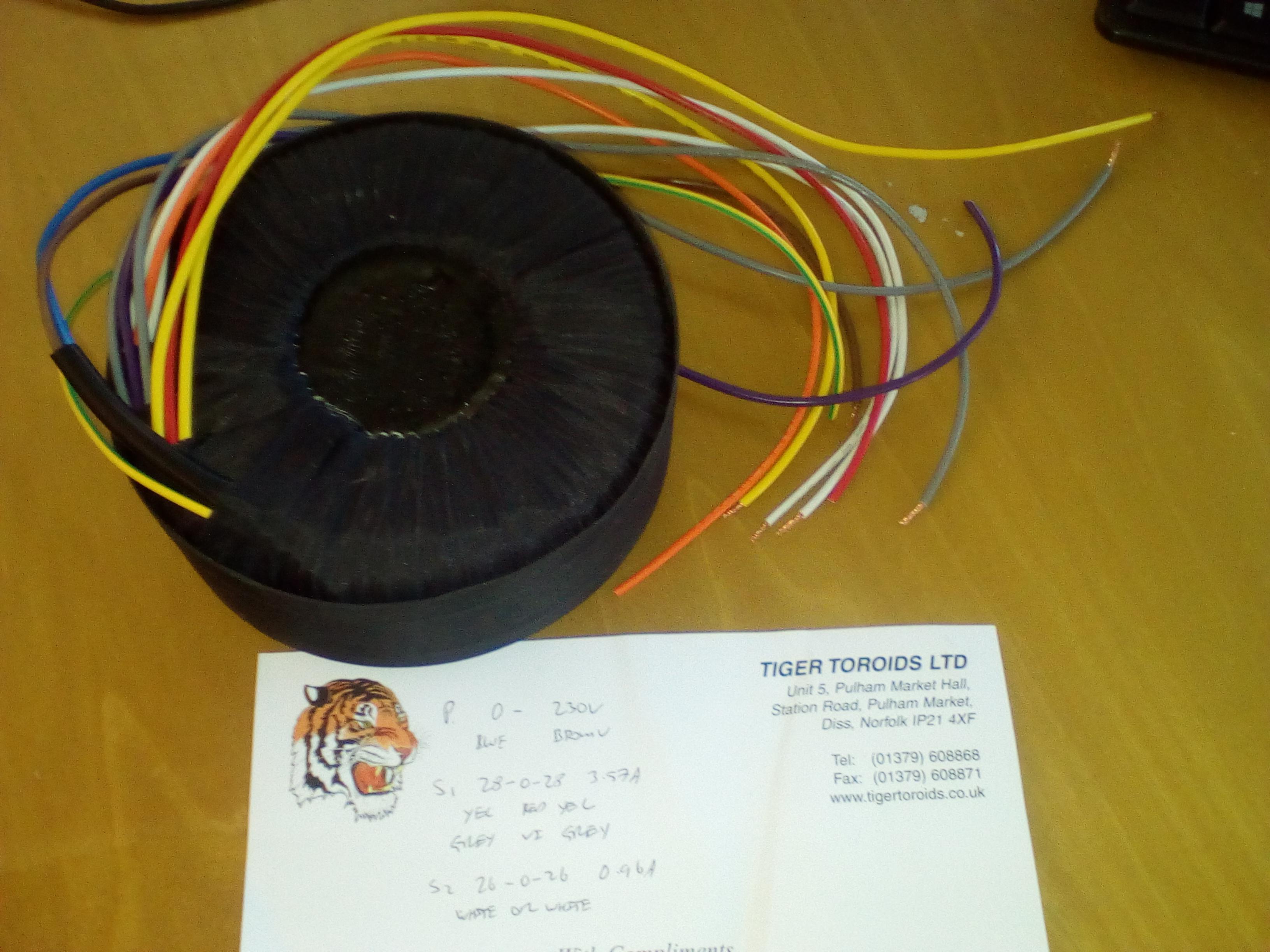

The transformer has just arrived and looks pretty impressive. To look at it's a lot bigger than expected, measures around 160mm in diameter and 70mm tall, but looks as though it will fit into the case (ModuShop, part no 1NSLA02350N). I've attached an image, but the image doesn't really portray the size of the thing in real life.
Requested spec was as follows:
Power rating: 450VA
Primary: 0-230V @ 50Hz
Electrostatic screen
Secondaries: 2 x 28-0-28V @ 3.57A rms + 26-0-26V @ 0.96A rms
GOSS band
Regulation: approx 5%
Estimated dimensions: max 75mm high
Mounting: insert in a potted centre
Leadouts: approx 400mm long flexible (stranded)
The transformer was built and delivered within a week (Tiger Toroids Ltd in the UK) and was quoted at £75 + £13 carriage + VAT@20%. They suggested using a 600VA transformer core, a lower-rated core may well be cheaper but I didn't pursue that.

Andrew. What fusing do you think a 450VA will need? I know it is something you have given much thought to in similar discussions. I suspect 4AT or larger. It is a difficult question as 4AT relates to about 1000 VA and yet might be too small. If avoiding a slow start circuit I guess that's about right at 4AT. I am very reluctant to open this can of worms. Feel I should. 4AT@230V will protect against the bad risks.
One thing that might be possible is use 2.5AT and accept like Naim you never switch off. Not my favourite.
Doubtless Tiger will give an idea. If the transformer has a heat fuse one can be slightly less concerned. Sadly if a one shot thermal fuse it would be a shame to loose the transformer if the Naim module went wrong. 2 Fuses in the DC supply seems wise. If these are bypassed with 1 uF ( across the fuse ) that is almost like no fuses fitted.
I'm starting with a T3.15A in the mains feed, as found in the genuine NAP200. The amp will be running on 230V of course.

In Naim's description for the NAP200 they boast "A new, top-quality 430VA toroidal transformer", T3.15A should be OK.
If the DC rails were individually fused then what would be the effect of just one of the fuses blowing? If there was to be resultant damage to the attached loudspeakers then I'd rather lose the transformer due to the thermal fuse tripping.
