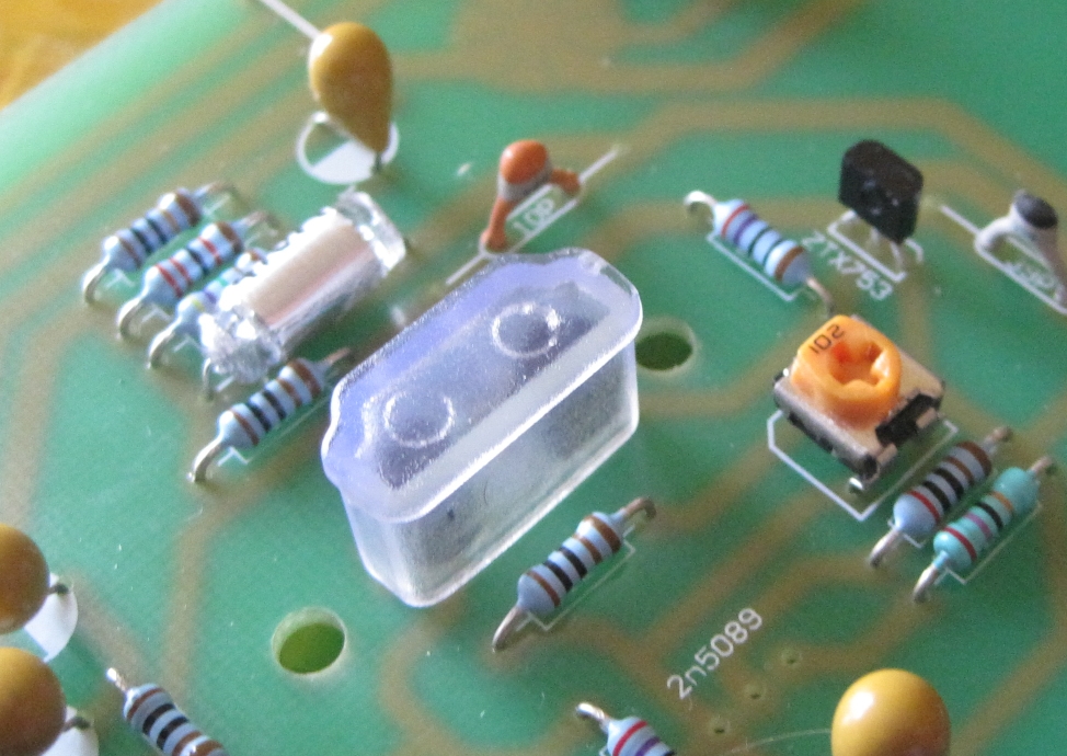

I was considering maybe using a piece of flat heat-shrink tubing, but opened up a little and sealed above the transistors.
Had a brainwave last night and I've found that the protective cover from the end of an HDMI lead fits perfectly and is a snug interference fit, see the attached.
