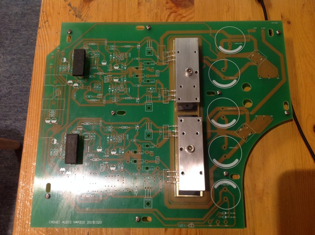

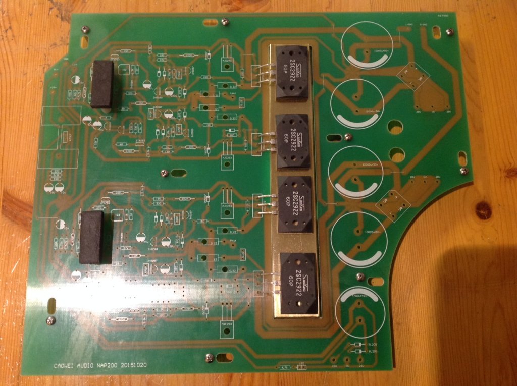

Regarding the heatsinking of the 2SC2922s, I've just ordered 20mm square and 1/2" square aluminium bars, both 200mm long. The 20mm will sit between the output devices and the case's bottom panel, the 1/2" will clamp the devices down onto the 20mm bar. I'm intending on using 20mm PCB standoffs, so this should all fit together quite nicely.

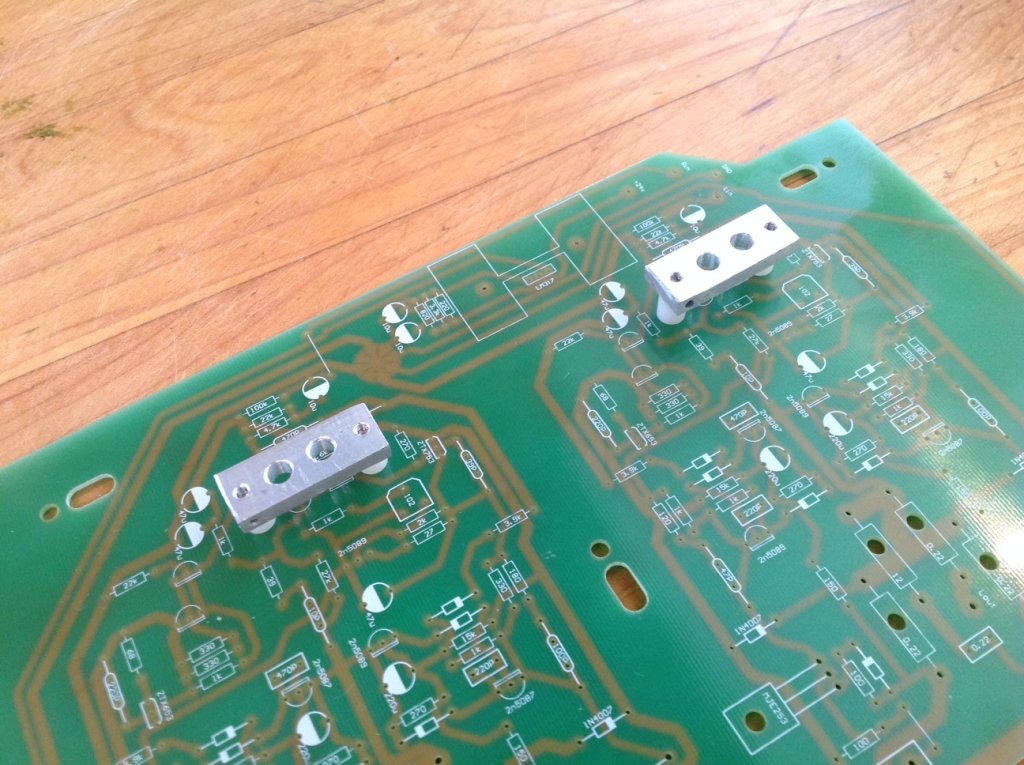

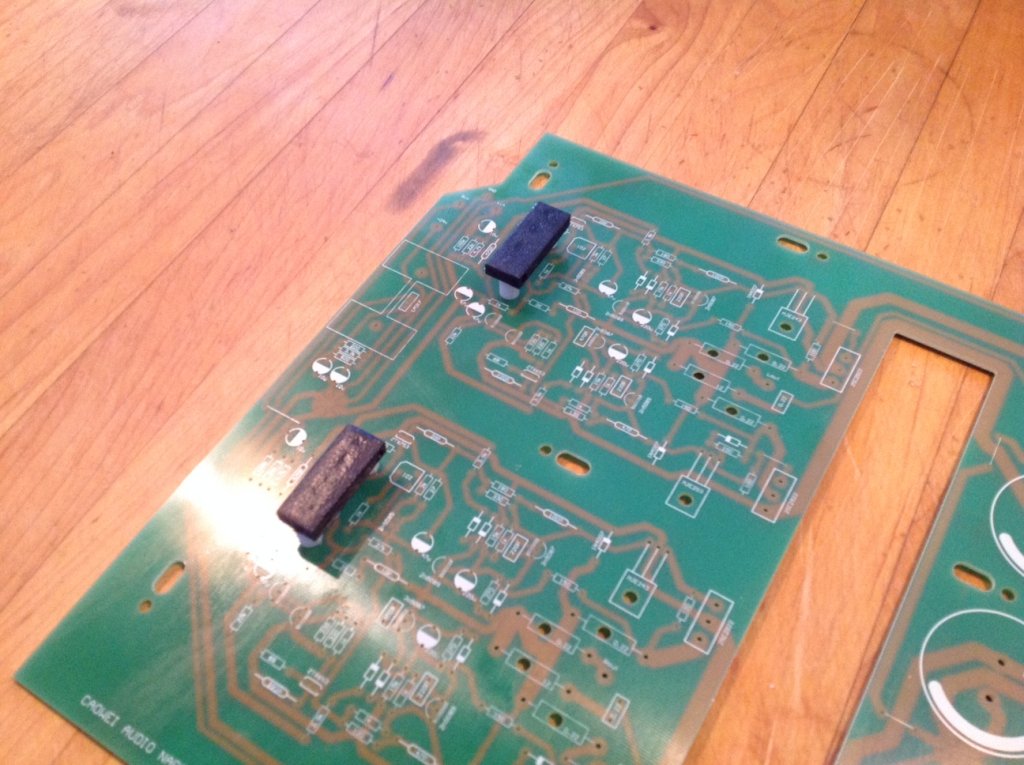

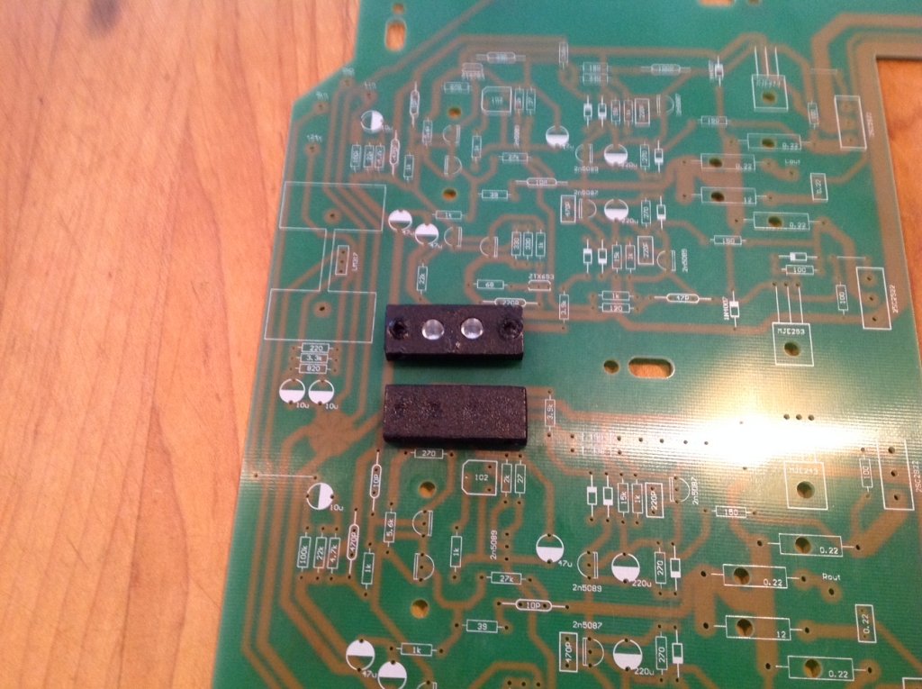

Here my own version of the LTP thermal coupling, piece of aluminum, then a little piece of alu tape on top. Then black paint. It will cover the LTP transistor pair, and fix the pcb with screws and standoff.
Mjona what do you think is the TR1 TR2 bias current in the NAP200 circuit, and do you think the NAP140 difference of about 10% HFE mismatch in TR1 & TR2 (TR1 being higher) to give the 'Naim sound' still apply here?

I see the NCC200 circuit - post 1492 on page 150 recommends TR1 should have higher gain than TR2. You might like to read what Dave S had to say in post 1419 about his experiences with this circuit.

For some reason I remember the term "Quiet Room" being used in relation to the NAP500 power amplifiers, which raises the question of whether the housing is as much about micro-phonic effects as temperature matching.

As the Naim has different current through the LTP heat coupling will not do much. No harm in trying.
One very odd idea would be to heat one transistor more than the other. It might work. As long as offset is < 100 mV don't give it a second thought. A resistor could be all it needs. Please don't bother to try this.

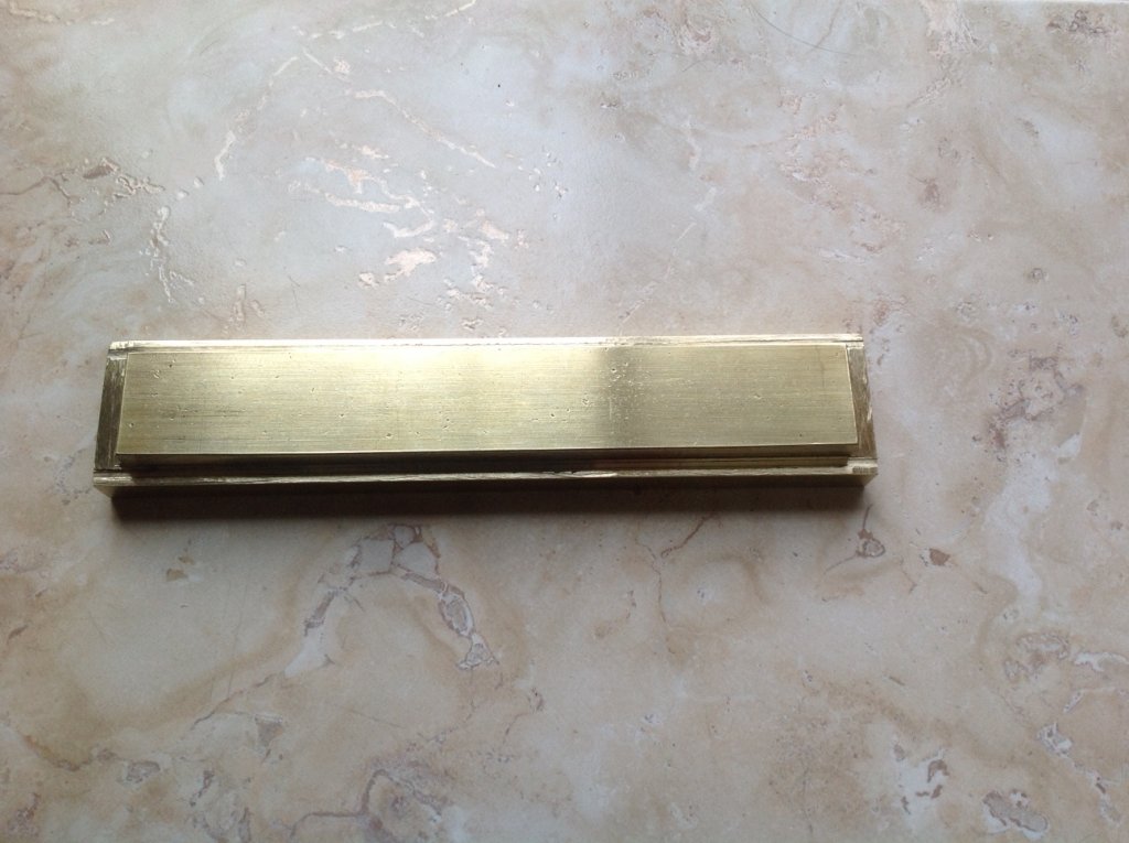

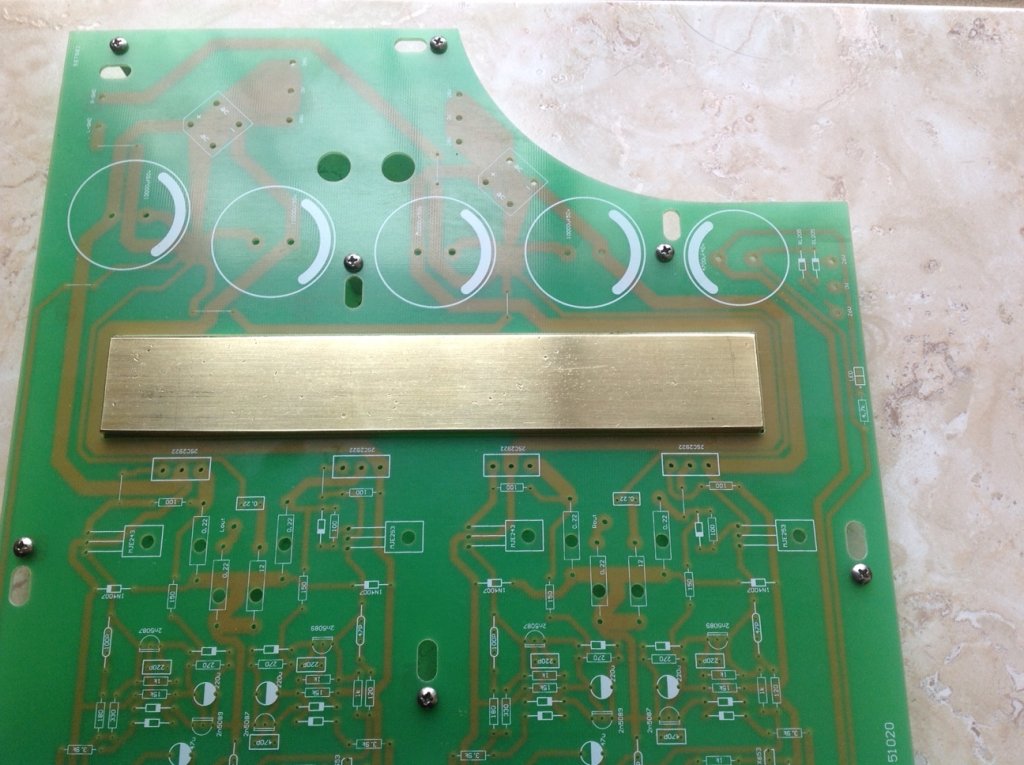

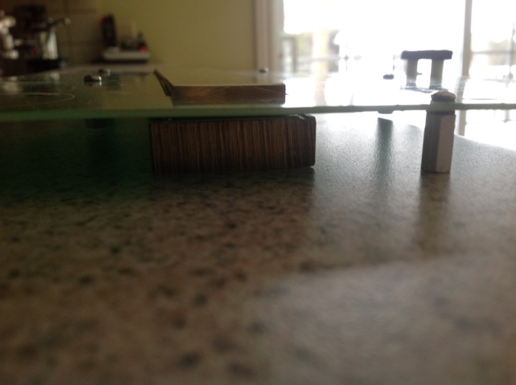

Heatsink issue solved, nice bar of brass, cut to fit 😀
But brass is way harder to cut than aluminum. It was very work intensive with a limited tools I had.
Looking good, that must have taken you a while!
Nice.![]()
Out of curiosity I've just checked and the thermal conductivity of brass is about half that of aluminium.
Are you planning on using the amp at high power? Just wondering whether the brass will be able to conduct heat away from the output devices quick enough to support higher power outputs.
Brass has very bad thermal conductivity!!!You will have problems.Better use copper or aluminium.
True... so you'll run into problems at approximately 1/3 of full power where thermal load is at it's maximum.Brass has very bad thermal conductivity!!!You will have problems.Better use copper or aluminium.
Actually you'll have to lower the supply voltage when thermal conductivity decreases.
I don't believe the short thermal path that exists between the transistor backplate and the relatively thin case, will make any great difference in the overall cooling rate. The main bottleneck is the case thickness, particularly in the area close to the heat spreader bar. The brass bar, even if the conductivity is half that of aluminium, will be much more efficient at heat transfer than the 3mm aluminium sheet it is attached to. You won't change that thermal resistance even with direct mounting.
Each amplifier is rated for a maximum 100W/4R and presumably 60W/8R - no big deal for a low bias (~ 30 mA) amplifier so there is not a great deal of heat to dissipate in normal use. There certainly isn't a need for scaremongering about reducing power or other pointless measures.
Ok good. I saw that brass thermal conductivity was half of the alu, but I had the bar in stock, and I knew that this amp doesn't heat that much, compare to a class-A (like my PassLabs amps).
No I was not planning to use this amp at high power. I always listen to rather low volume, maybe 1-5W. The rest of the power reserve is there just for that, a reserve for music transient. My days of listening to Ozzy Osborne at head banging levels are long gone 😉
