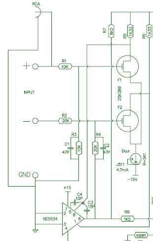

Thanks Nigel for explaining how this circuit was working. I was puzzled but it is to replace the NE5534 LTP by an external 2SK389 JFET.
Thanks for finding that. My similar idea is on my other computer that's having upgrades. This one runs XP and only 80GB. Some programs I run and prefer will not run on Windows 8 or 10. 7 just about works. I did try emulators, no good.
If wanting very low noise and good sound MC33079 can be run with inputs and outputs in paralell. I did this with a MC preamp for Lyra Helikon. 3 op amps as a gain stage of 62 with passive 75 uS then the final op amp as active 3180/318 uS at gain 17 @ 1kHz. If building a pre amp this is a nice cheap op amp that sounds very good. Don't clone Naim preamps.
