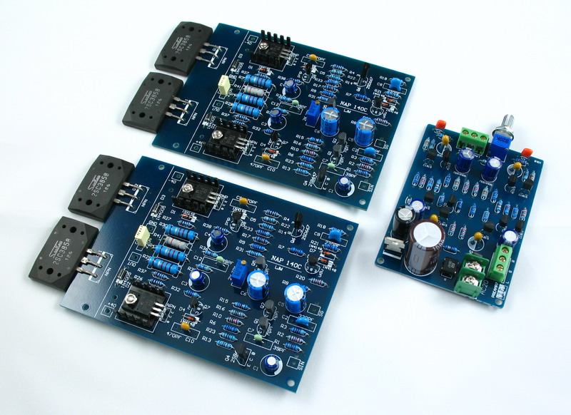

NAP-140 KIT. Dealers may not to handle sales.
Have what problem can contact me.
How many people are interested in NAP250? I can provide.

You are aware, I guess, these Renesas types are not manufactured for a long time so how can your suppliers offer this NOS that is unobtanium, for next to nothing? Or 4 x Japanese Sanken 2SC3858 that will cost $20 to you, not including profit, shipping etc. Having tested recent pre-assembled NAP140 modules and paid only $37/pr, I know I got only what I paid for but it is not using genuine parts as quoted. Not even the printing is correct, straight and the tinning is brand new on minimum 12 year old worn parts that are described as "pulls" from scrapped amplifiers.!!!
Customers are at yours and similar Ebay suppliers' mercy as to what is in those parts but whatever you quote as your design specified parts means nothing if the silicon is only a cheap substitute, as mine were (output transistors failed at 22W sinewave power). If you take a random sample from production and demonstrate it produces 70W RMS/8R then we may have more confidence in your claims. So, if the suppliers don't follow your declared specification, who can we believe? No-one! 😡
It is a great pity that our pastime is plagued with faked components that attract keen buyers thinking they have a bargain in their kit purchases. What they have is something that will work in a basic way as long as you don't use it anywhere near the original specified rating. Customers would be better off to use a small chipamp like LM1875 and still have better sound with a chance of it surviving normal use, too.
To be fair, most inexpensive and current manufactured parts appear genuine and that is reasonable since there is little point in faking cheap parts. So substituting MJE340/50 with long obsolete parts would seem a good idea, if they were real RENESAS parts. Certainly, I have bought NAP 140 kits that use cheap but good parts like 2SC5200 transistors. These worked near to spec. but cost more as kits.

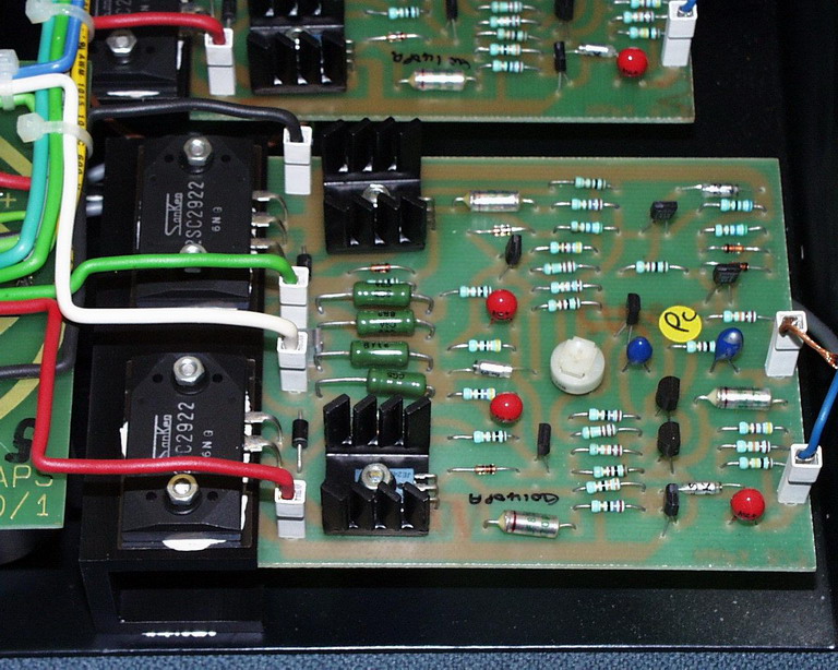

Iv'e almost completed my tubeshunter nap clones. I have a few questions if anyone can help. Should I send a wire from my signal ground to my star ground?, my input phono sockets are insulated. Do I check accross R29 to adjust the pot, and should I read about 4mv or less? Merry Xmas and a Happy New Year to all. Regards Barry
Hi Barry
Run a substantial earth lead from Input ground connector to star ground on the PSU or from an adjacent connector provided for it.
I also find it worthwhile to place a 10 or 12R resistor between the signal lead braid and the input ground terminal to lower Hum quite measurably in domestic amplifiers.
I guess you are checking offset voltage there and not bias (I hope). You measure offset across the output terminals to the speaker (without it being connected) and 4mV is as good as it gets. Few amps are this good and 25-40 mV is still OK.

Thanks Ian, I will do this and fire it up. I will let you know what happens. The last one blew up. (not my fault, honest). Cheers Barry
Better luck this time but do use a current limiting device like a light bulb in the active lead on initial start up, assuming you haven't already done so.
It won't protect from many failures that relate to fakes under higher load, but at least against errors.
Ok, After finding the tubeshunter o/p trannies are real and the ones I bought to replace them are fakes I have fitted the originals and apart from two joints unsoldered (oops) and one duff resistor, I now get a reading of 2.2mv accross R29 and 11.5mv and 16.5mv accross the speaker terminals. I don't know why they are different but I assume it is OK. Next I will plug in the pre-amp and speakers and see if there is any life. Regards Barry
