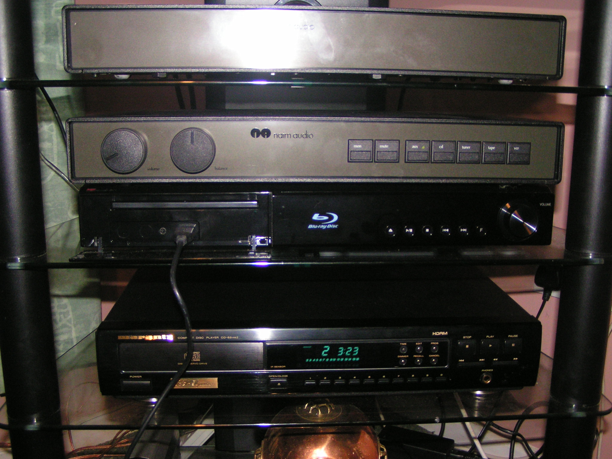

Nap140 clone
Just plugged it in and it sounds great. I now have a rebuilt Naim nap140 and highly modded nac192 I think? No hum, wide soundstage, great bass. Better than original. Yippy
Congrats. and thanks for the pics.- It looks good to me!
I'd love to hear about the nac 192 as I've never seen inside or a schematic. Do you have another thread for that perhaps?
