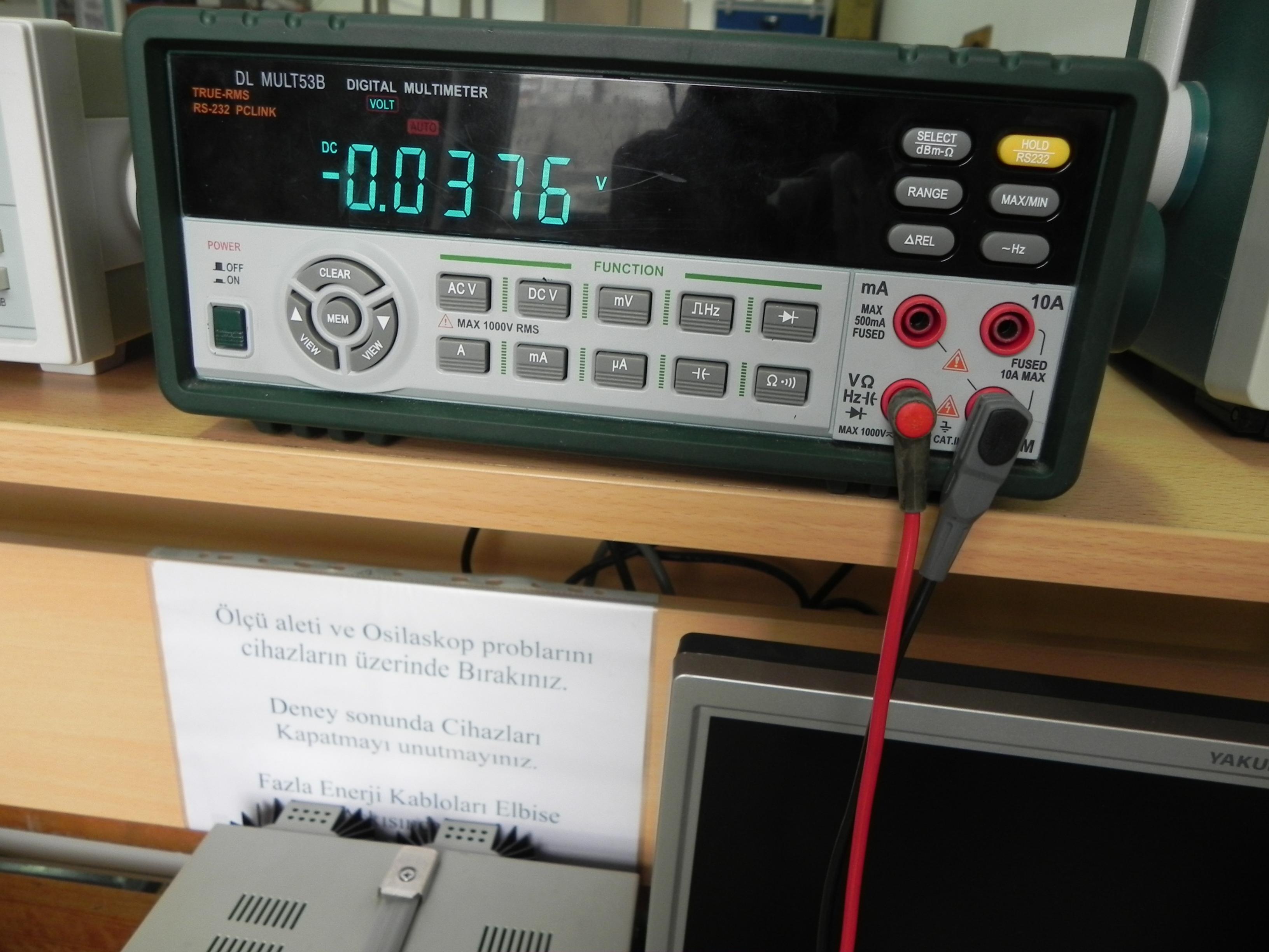

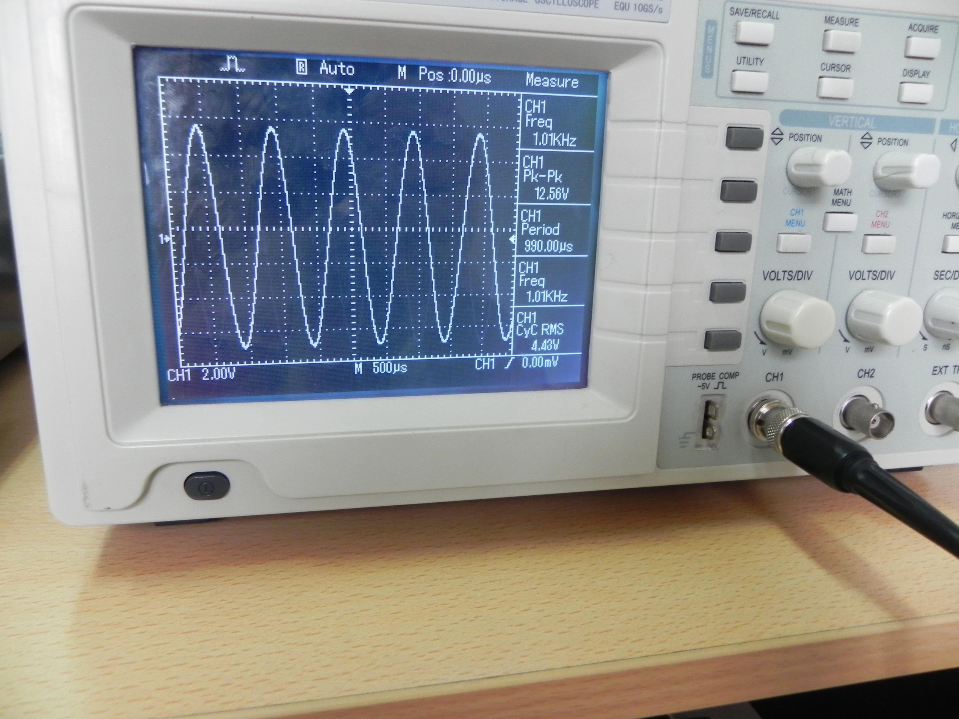

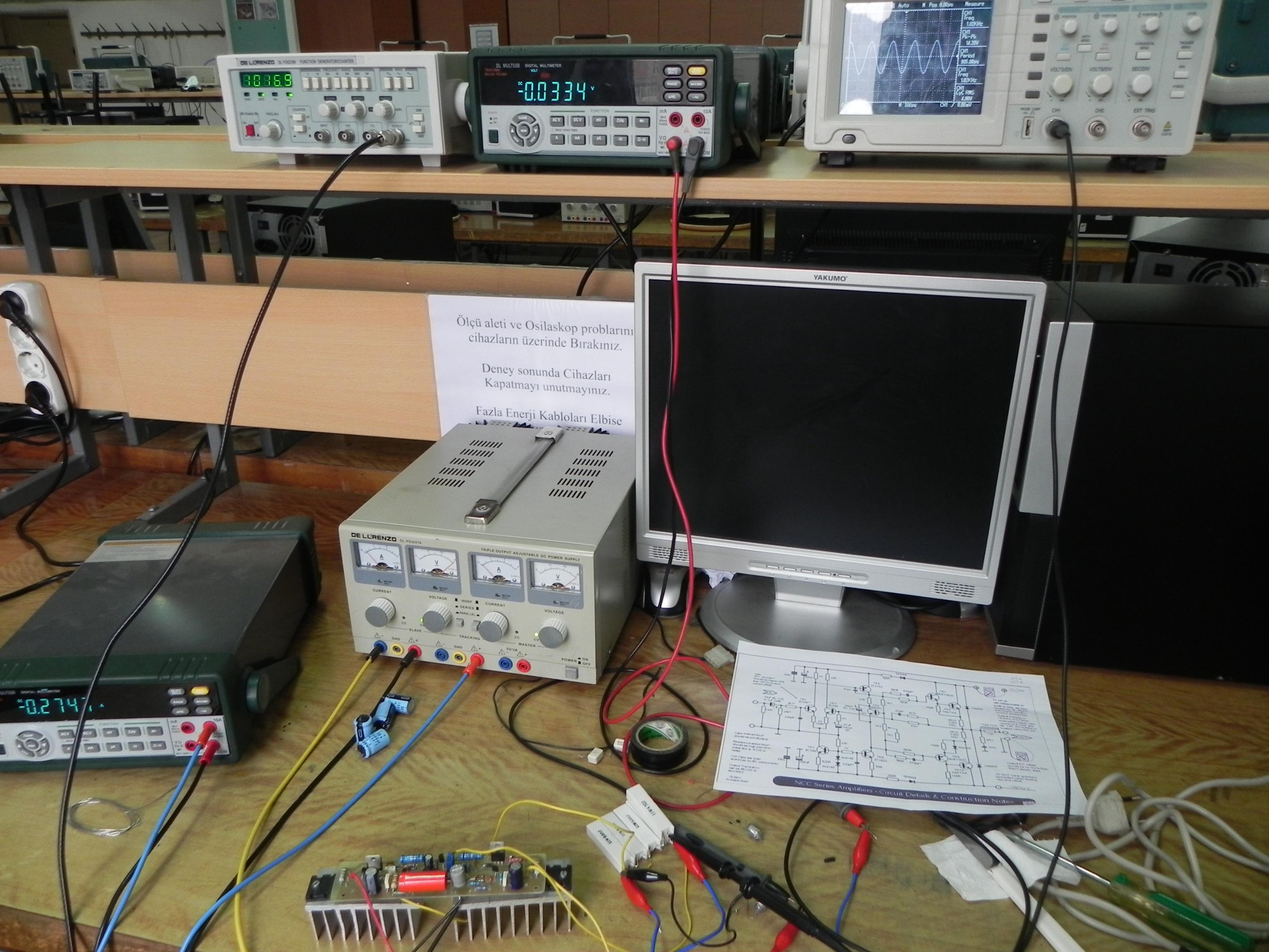

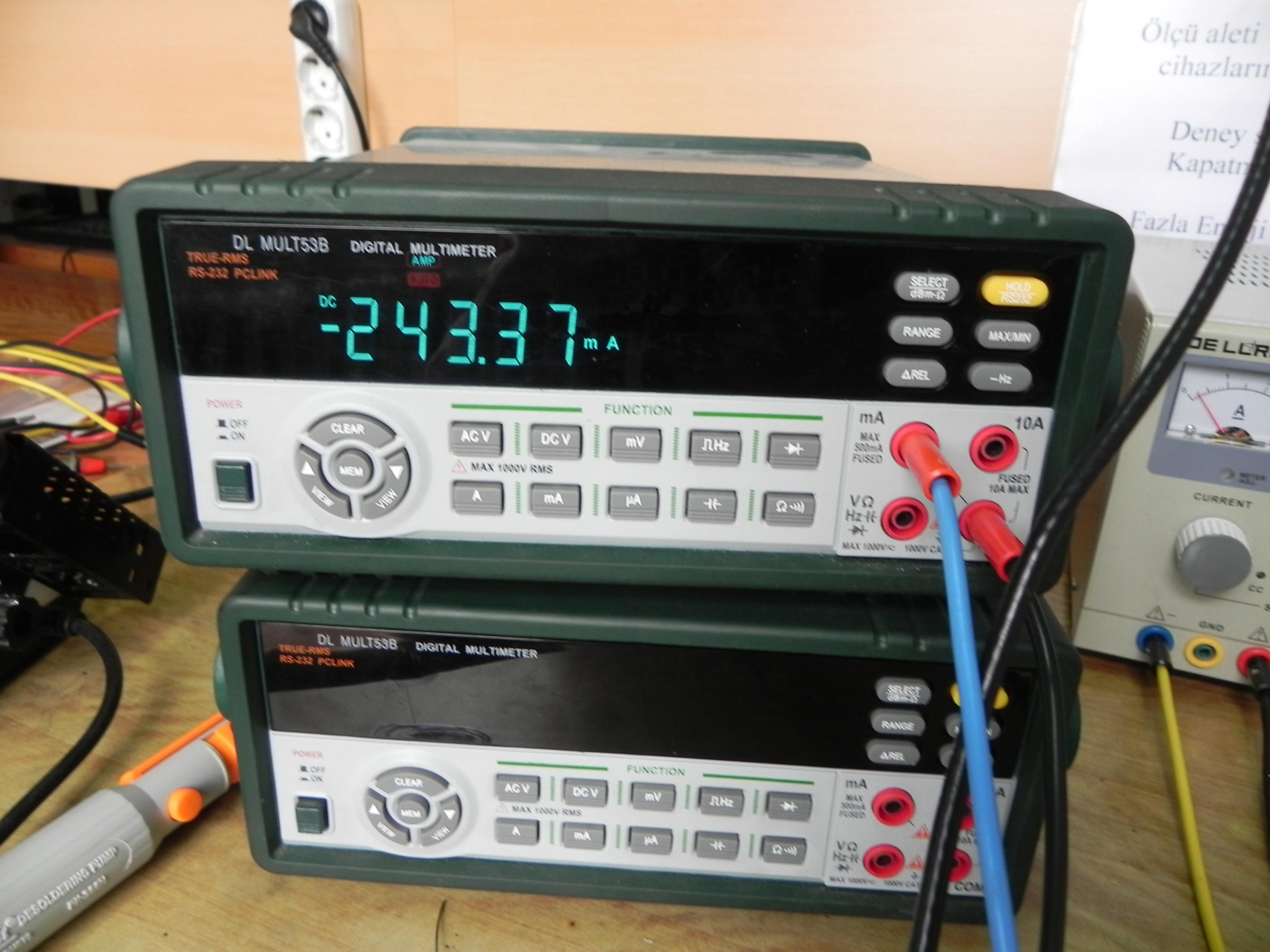

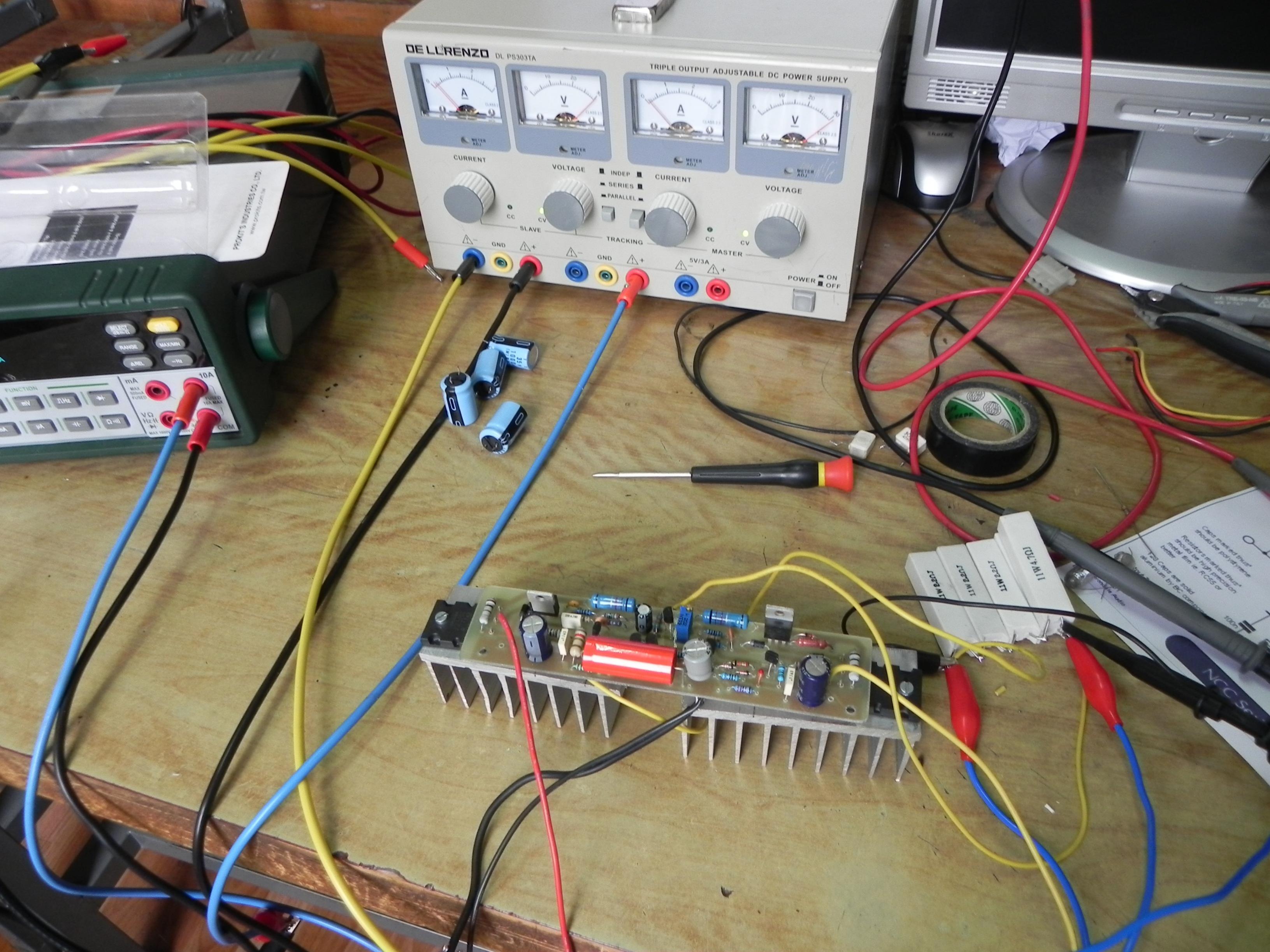

NAP140
I complete my nap140 today,
and did some test,its imprresd me,mid and treble so good bass frequency is enough for me.
I set it 50ma when no signal input,but after giving 80mv 1khz the current taken from psu be 240ma,it that sutiation amp not so hot its resanable temperature.It increases to 450-500ma when 1v apears in the input,and getting much more hot like class a.
Maybe setting to 75ma bias when no signal on the input make thesound little warmer.I'll try it
I like the amps sound,tomorrow ı will do a couple of test and after pakaged it to its case
some measuerment are on the photos.
1.photo is general sight
2.is +/-30v psu
3.is output offset voltage
4.is view of the output signal on the 9ohm resistor connected to amps output
5.is bias current
