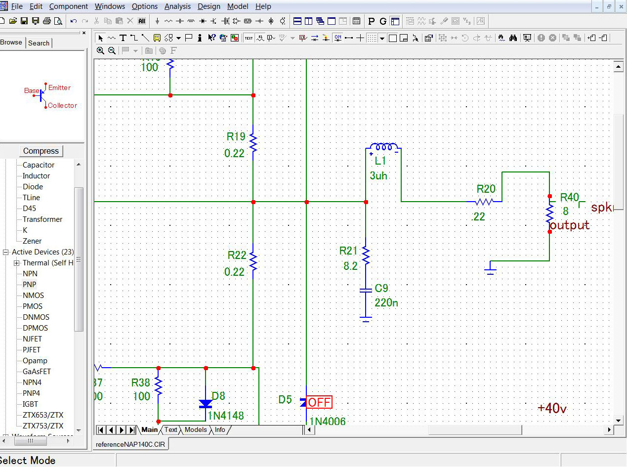

Firstly: re the inductor, when I rechecked the circuit and reran the simulations I found only very tiny differences in THD between when the inductor (3uh) was in parallel and in series. THD was around 0.012% (0.5v 2khz sin input) in both cases. My apologies. But it also also suggests that it doesn't matter which way the inductor is placed.
I still get bad THD figures (around 0.8%) with the protection circuit in place.
Juhleren, I've attached a jpg of the tail end of the circuit.
Ian, I changed the output resistor to 10, 50, 500, 5000.. and I get an unchanged THD profile. So I'm not sure what that says about the simulation.
Btw I agree with everything you say, even about the doodling (although it is fun). It is possible to simulate real loudspeaker loads but I don't have the time or skill or inclination. I'm not sure though that using a resistor to approximate a speaker invalidates the whole process. I find the simulations both seductive in their accuracy (eg being able to simulate changes in bias current and see them happening in the same way as with the physical circuit). On the other hand it is very easy to change anything then forget to change it back-as I did, end up with weird results, then have to recheck everything.

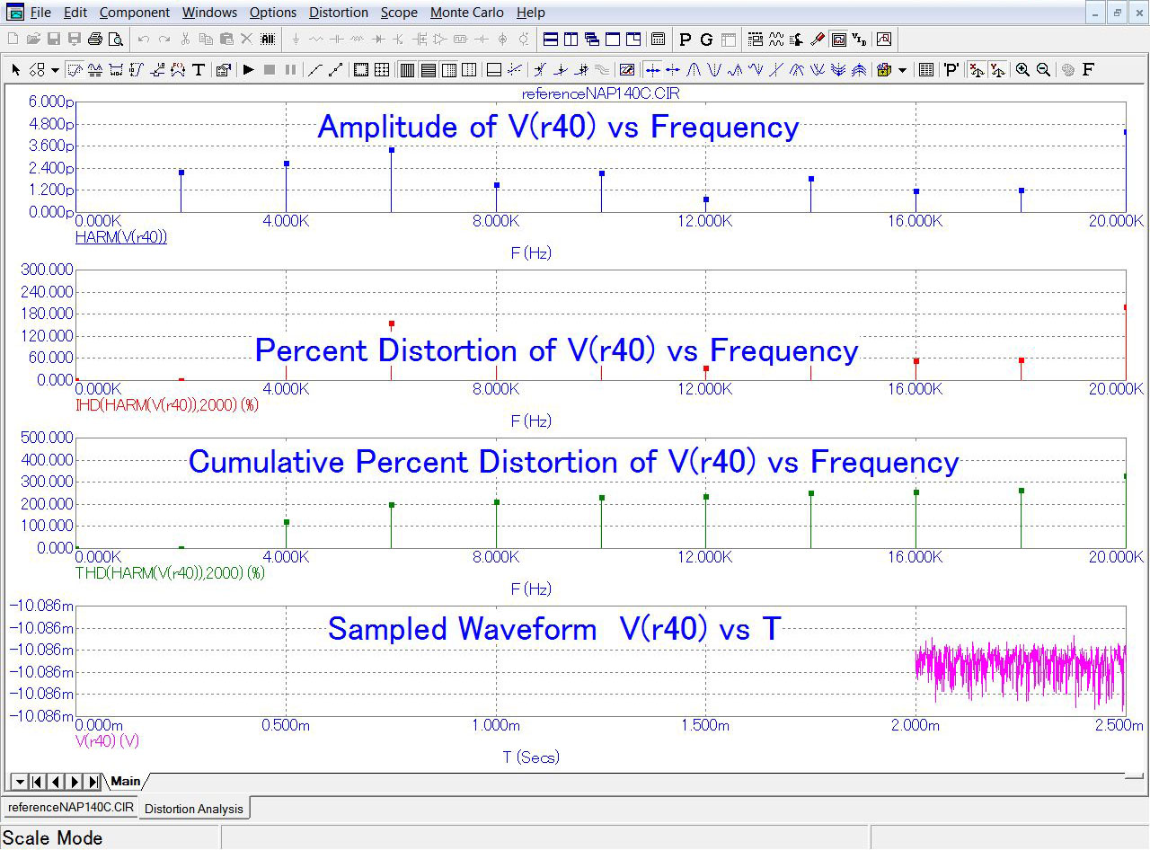

Juhleren, I've also attached a distortion plot using zero input. The distortion is high (relative to a tiny signal which I guess simulates hiss). I'll leave it for you to interpret.
