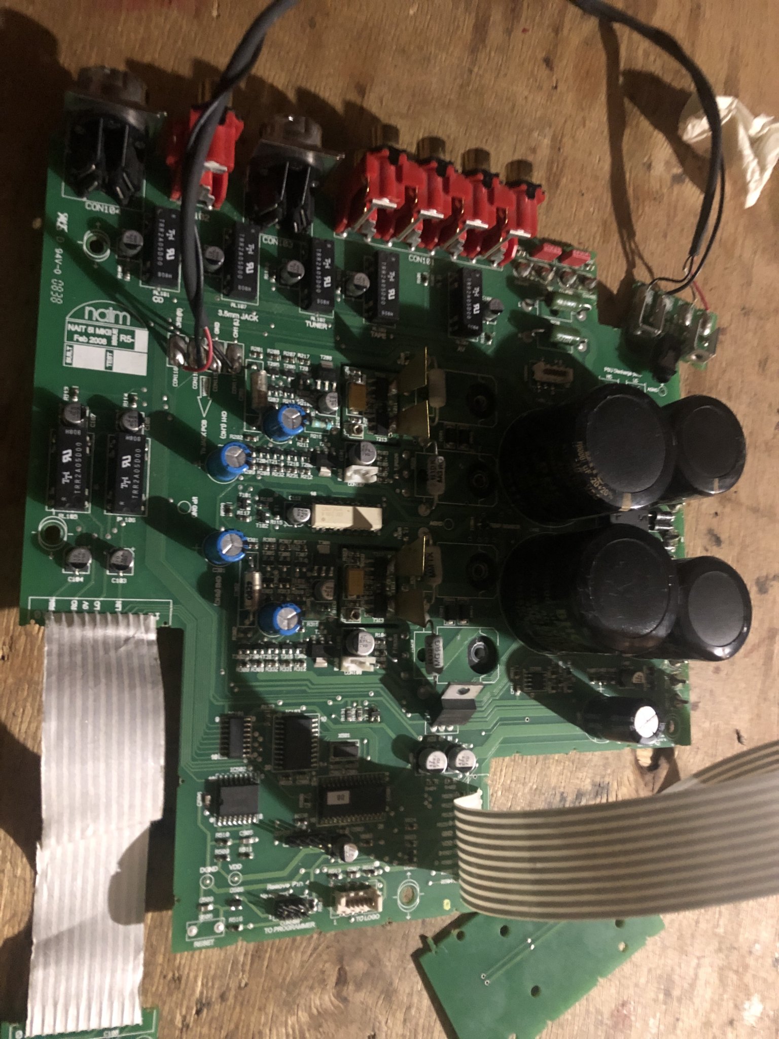

I have the original board from Nait5i-2in addition to Oleg who makes excellent PCBs, there was also a guy who made great boards, he passed by here but I don't remember his name, it's something like "kawoei" or a stuff like that.
I have one of these pcbs somewhere to rebuild my nait5.
@Oleg Turbin, does that mean anything to you?
Also i have DIY boards Nait2 and Nait3
You have the Nait5 or Nait5i ?
Also have the DIY boards for NAP140 olive
All diy boards make in fabric from original design
It's not a Nait5 but a Nait3,my memory is failing me.I have the original board from Nait5i-2

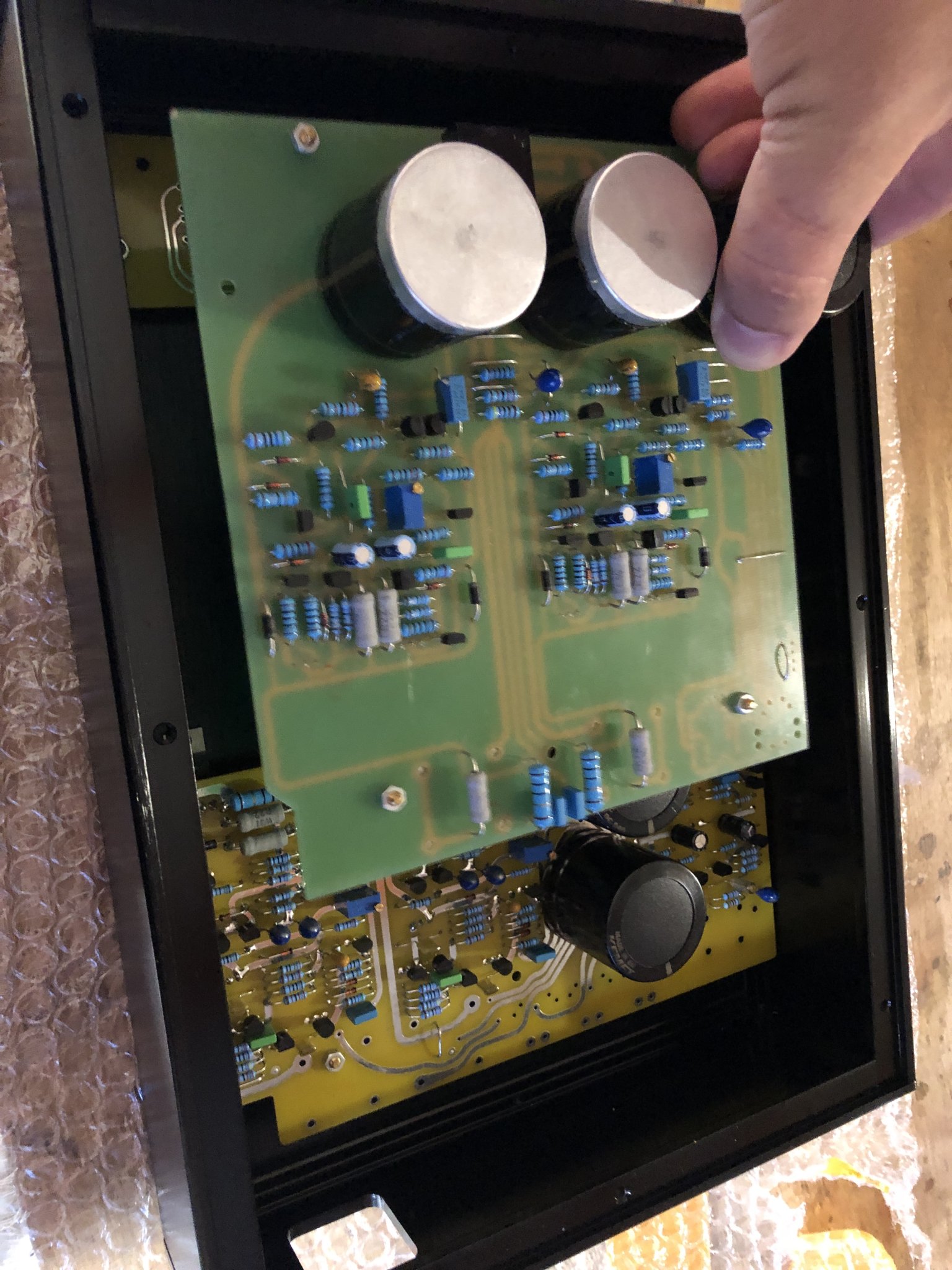

Бесплатная доставка, усилитель NAIM NAP140, двухканальный PCB | AliExpressWithout a link or picture is difficult something to say...
and
2 канала, NAP140 2SC2922, усилитель мощности на NAIM 140 80WX2 8R, готовая плата | AliExpress
I was heard that blue is better.
Hi, there! Do you have better option than ali? Gerber?Good Day
У меня есть платы NAP140 без деталей
Если Вам нужен комплект с деталями у меня его на продажу нет.
Оригинальные детали дороги и в данный момент их трудно достать.

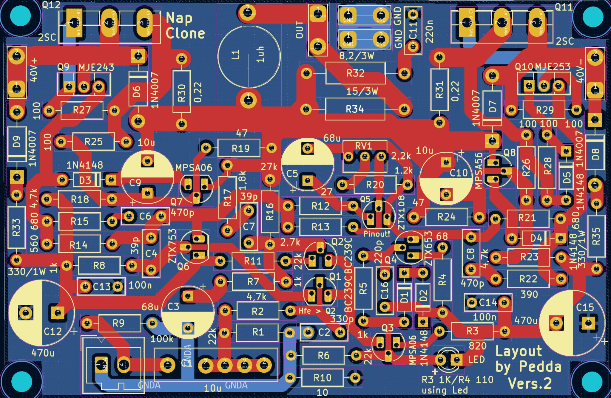

NAP140 clone, series 15R // inductor was added. Mostly it was 10R, in NAD C352 it is 1R. Why 15 ohm is choiced for nap140?
Naim Nap's can work for min 4 ohms (or 2 ohms) speakers. So, min resistance may be 4ohms (2 ohms) // inductor? ok? (I assume that, power transistor can handle HF output for 4 ohms).
Is there anybody to answer my question? is it really 15 ohm resistor better than 10 ohm (or 1 ohm) resistors? LTspice shows in square wave, 3, 4 ohm is enough for 8ohm speaker empedance.NAP140 clone, series 15R // inductor was added. Mostly it was 10R, in NAD C352 it is 1R. Why 15 ohm is choiced for nap140?

Interesting question, i am interested too....i found much different plans/schematics in the I-Net . On the most Nap 140 schematics the 10 or 15 Ohm resistor is missing, the coil/inductor too. Instead there is a 0,22 Ohm resistor in the output, as in the Nap 180 clone too. Only the schematics of the Nap 250 has the 15 ohm resistor with 1 µh inductor ? I think its very similar to an 0,22 Ohm resistor. Chinese informations about their boards are not helpful. No idea what i have built....a little bit of everything...Nap 250? I have to test it....

do you know about the differences at the output ? In some case i can find a boucherot network with 1 µH inductor and 15 Ohm resistor, in an other case exspecially on china clones an 0,22 ohm resistor after the zobel network. Is it perhaps only a mod ? In my oppinion the boucherot network is the better way for critical impedances.

thats all true. If you want to use any cable, you have to use that LR filter. thats for capacitance load due to cable or speaker. It's normal value of this resistor is 10ohms. Some amplificators can use down to 1 ohm. I want to know that how decided to use that unusual 15ohm value. Is this experimental result? if so what is the capacitance of the load( >2uf)?U can use the inductor on the output paralleled with 10R 3W resistor and use any speaker cable you like or prefer.
You do not need to mount the mentioned items on your PCB, it is fine if you mounted on the speakers terminal.
