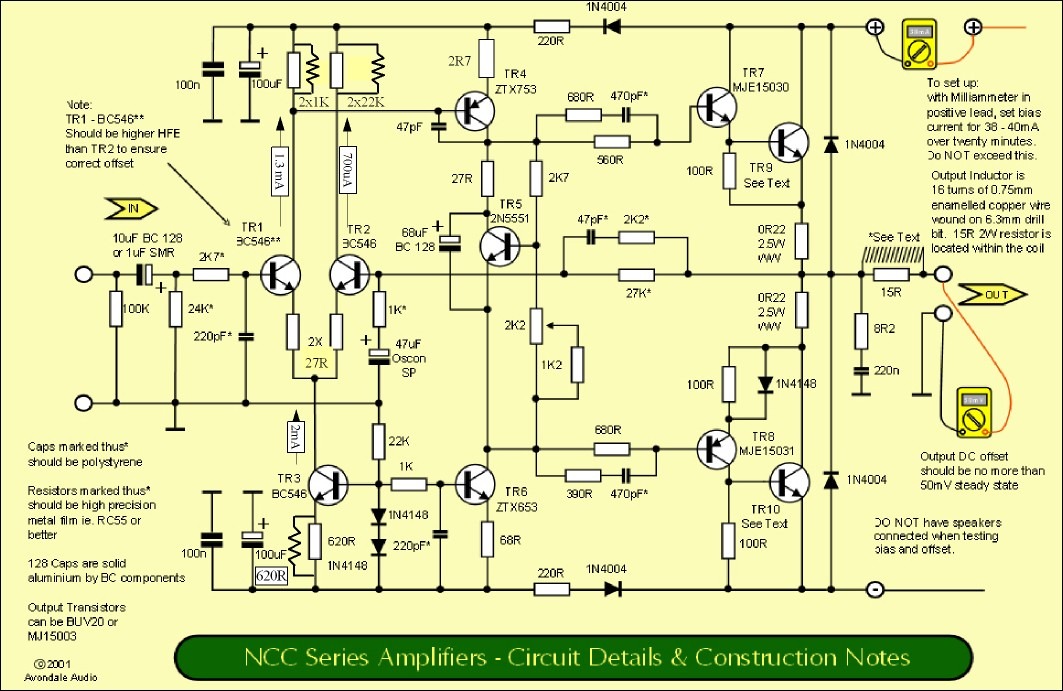

I saw 15 ohms in Avondale Audio's design. NCC series amplifiers. Also, I will give the schematics 🙂

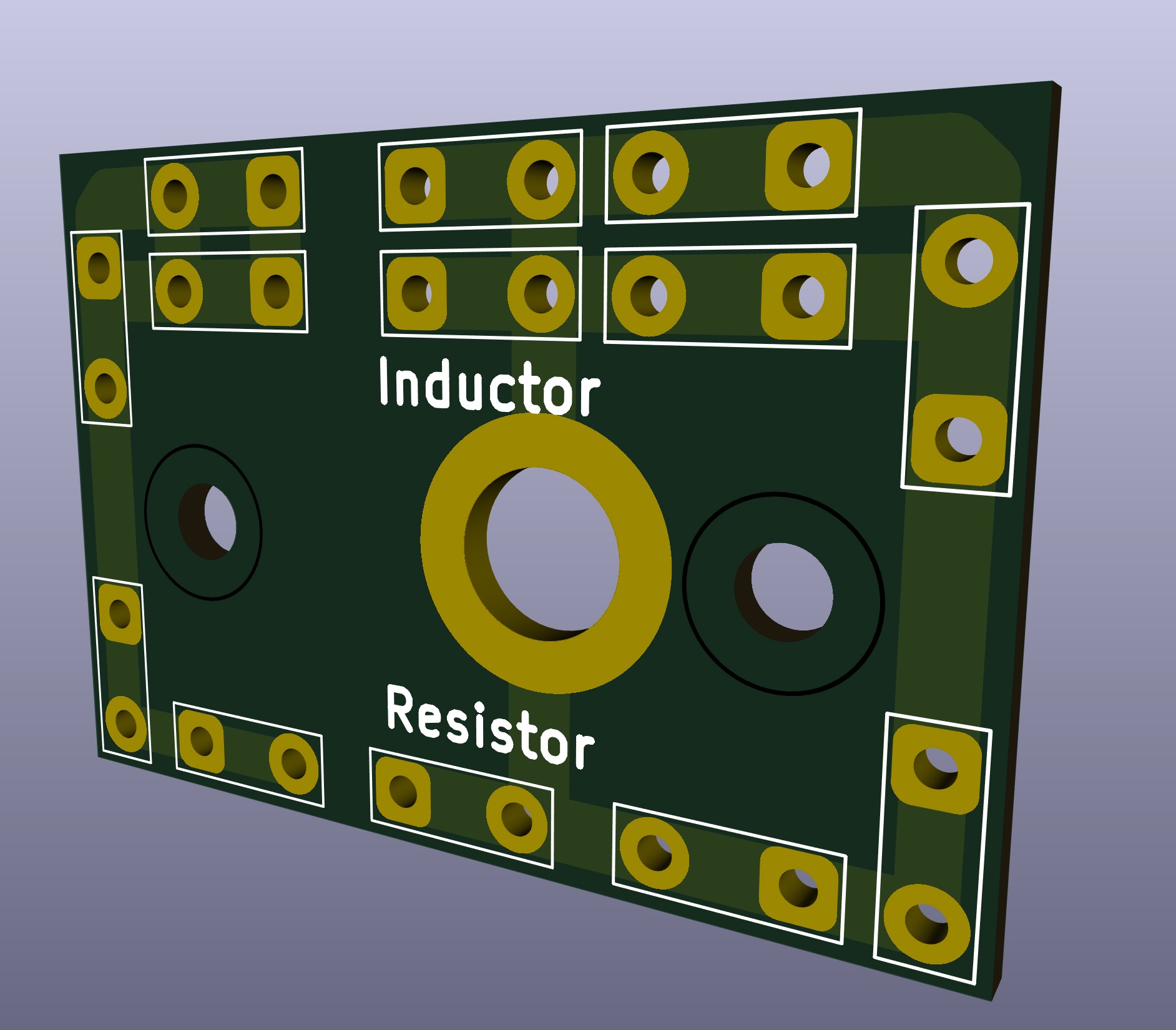

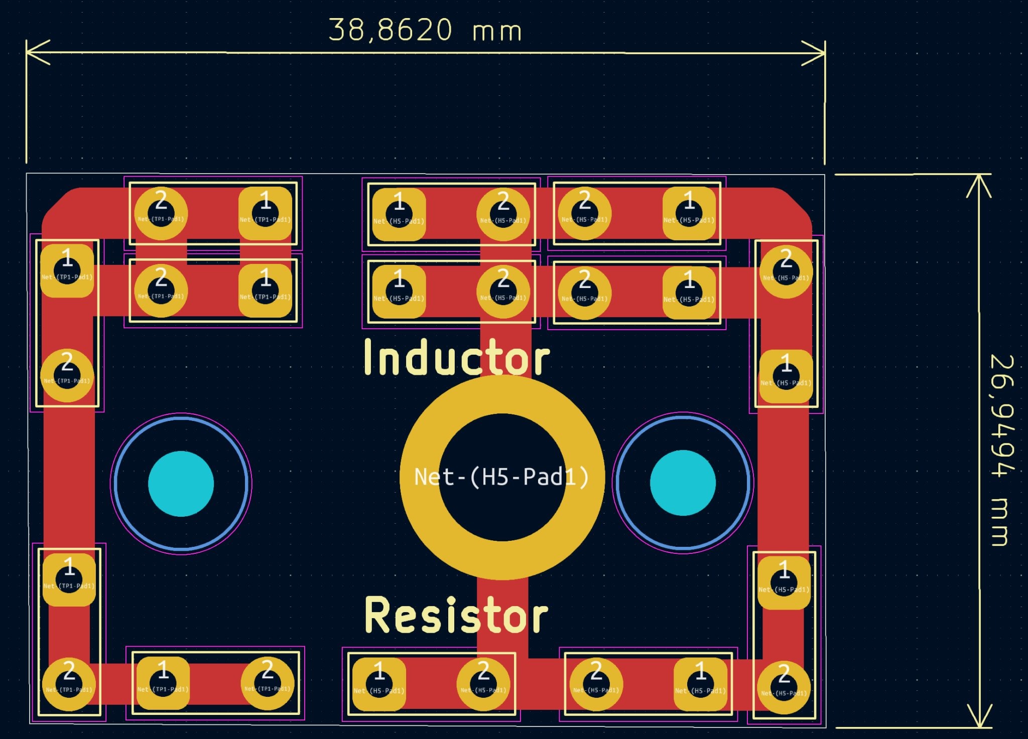

i made a little pcb for outfilters. Inductors with 15mm diameter, different length will fit, resistors with 10 watt. If there is space enough it can be mounted on the + bindingpost. The holes have 1,3 mm diameter because i used 6,3 mm faston print connectors. For input/output it is also possible to solder the print connectors in. How practical i will see. I think i order pcb's.
In the past i always used experimentel pcb's.
Greets
Peter

If i compare the NCC schematic with the Nap schematic there are more components on the Nap board. The path MPSA06/MPSA56 ist missing on the NCC. Resistor values are different in the voltage rails. ZTX753 has an emitter resistor, liittle changes on resistor values (orginial ?) and so on....
It reminds me of the mods shown on http://www.acoustica.org.uk/t/naim/power_amps.html
Dont know which amp is better. I think the Nap schamatic is the older one ?

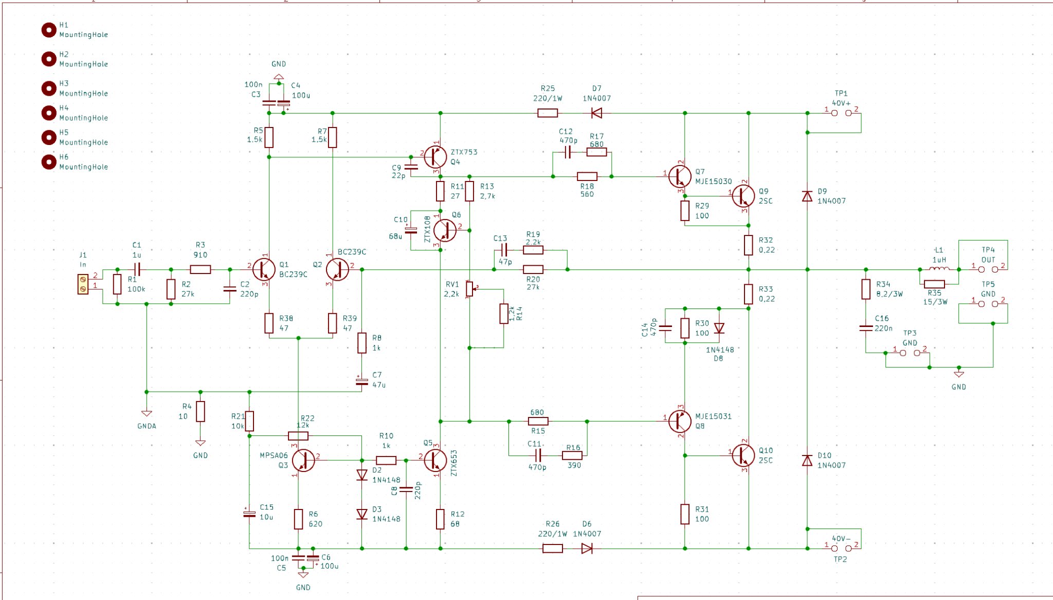

Thanks for the information Gabor, which amp sounds better. As i wrote....give me a schematic and i make a pcb 🙂

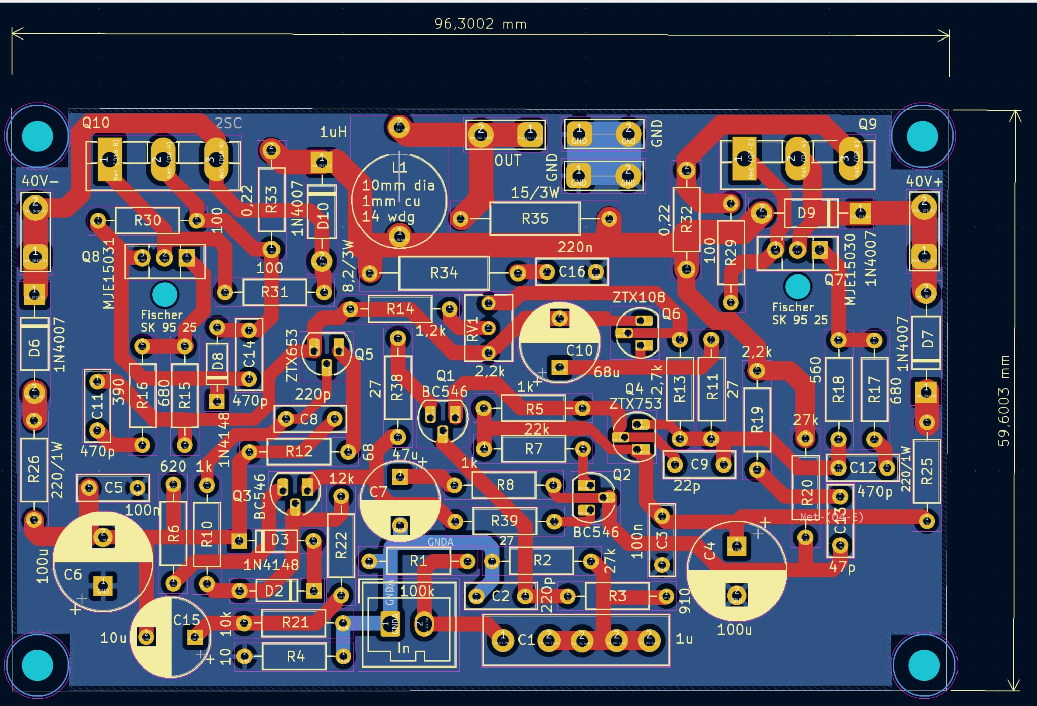

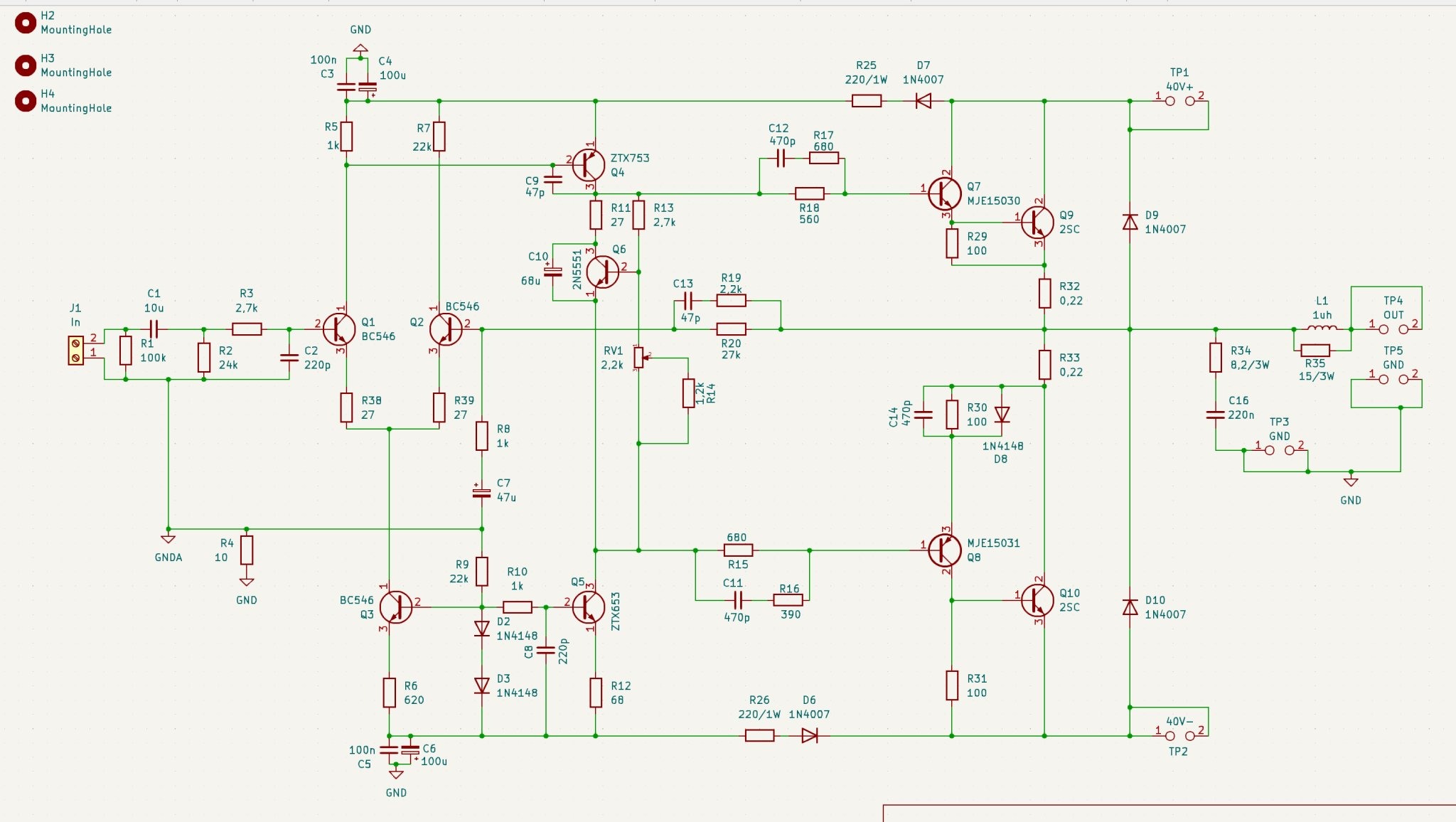

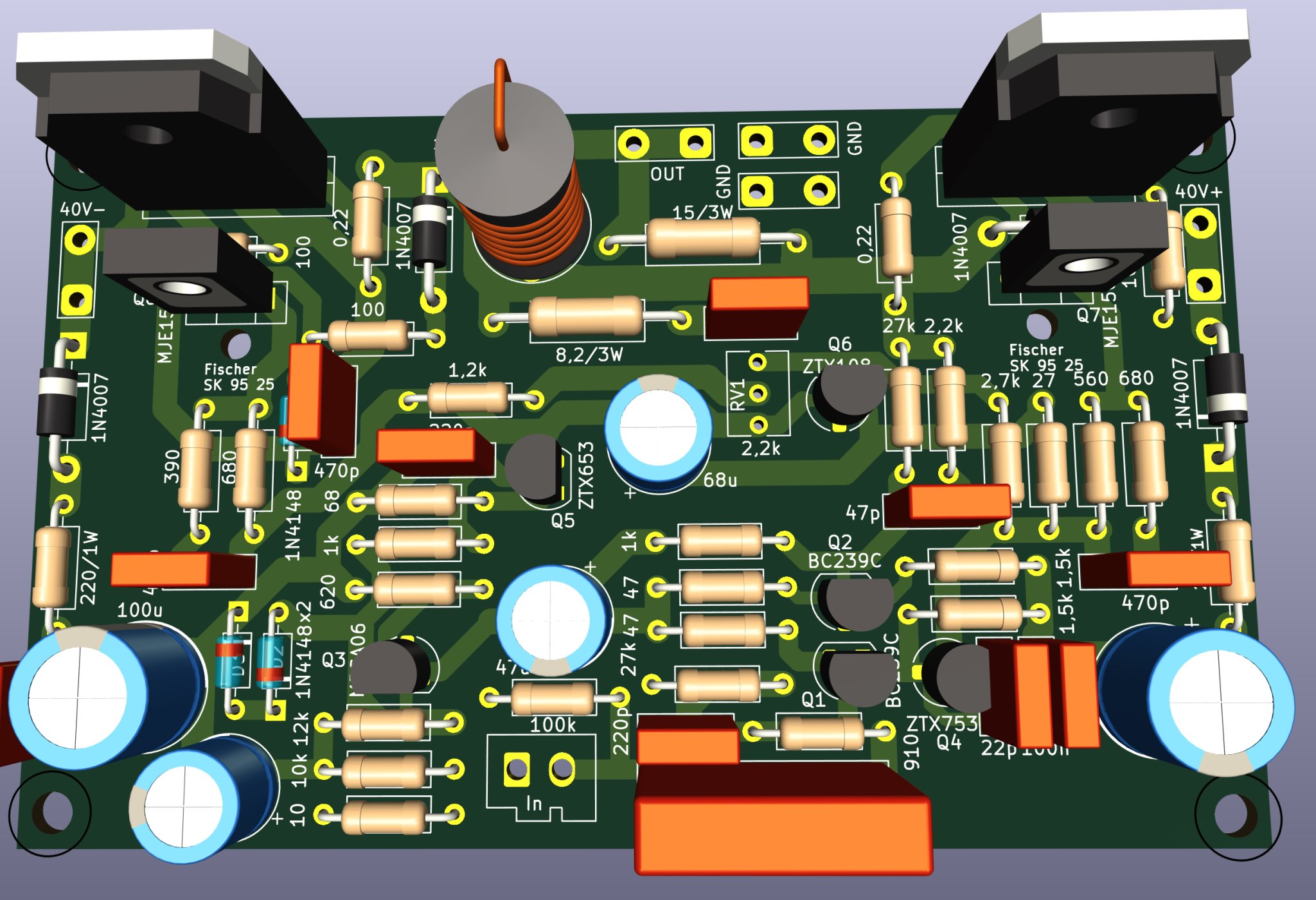

Not finished yet. It is the first try. But its crossing free...
I have to change a few values to correspond the plan of Greg Ball. But that is easy to do. Perhaps i have to change pinouts of transistors....
I the moment the input with its capaticitor dosn't satisfy me...
I will see what can i do....
Greets
Peter

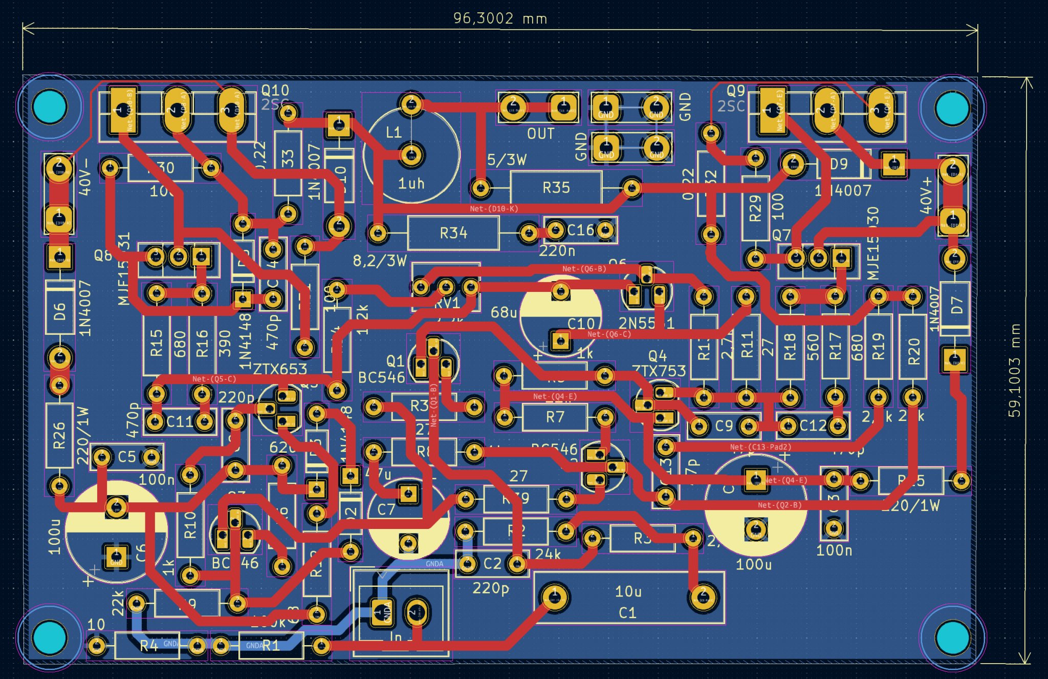

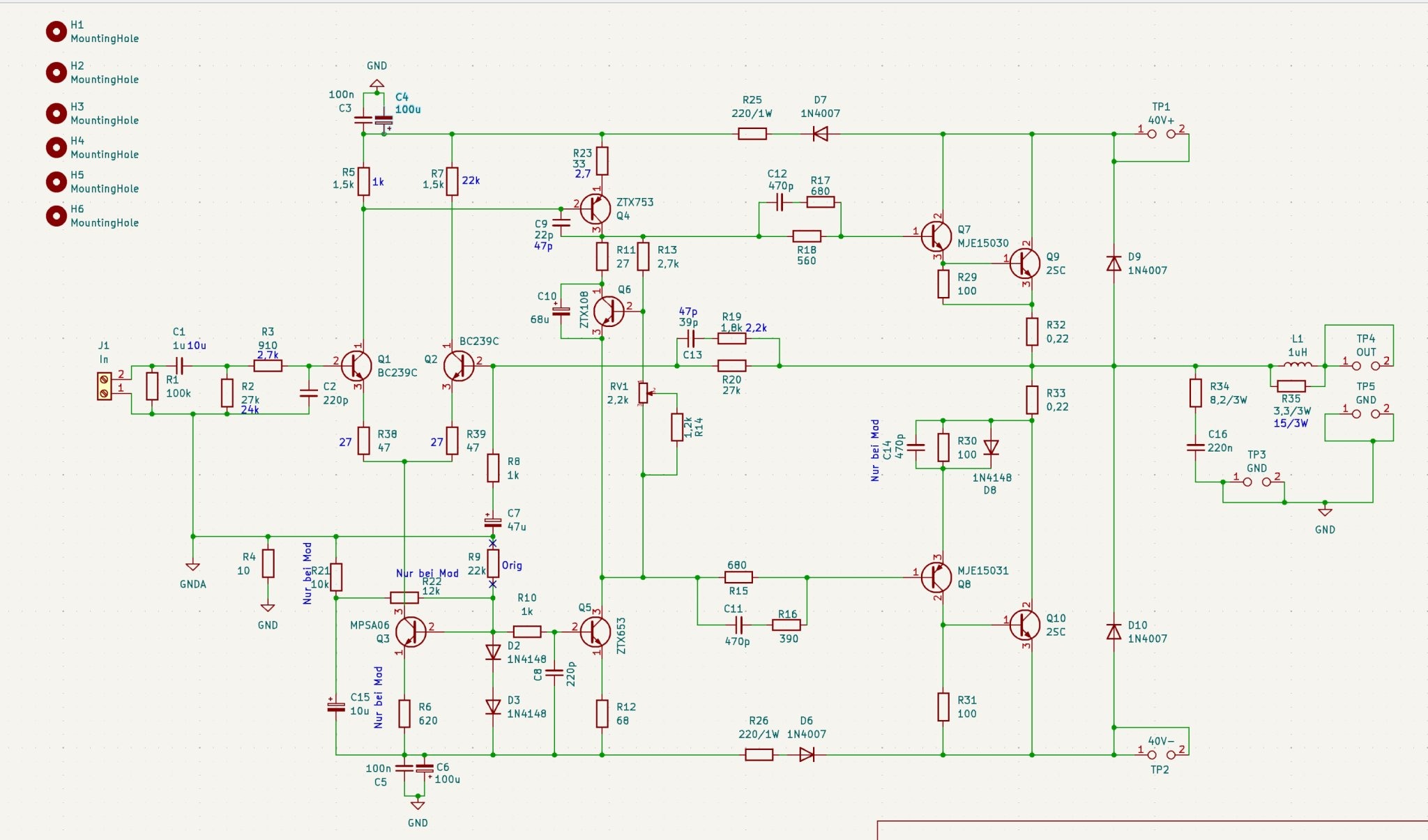

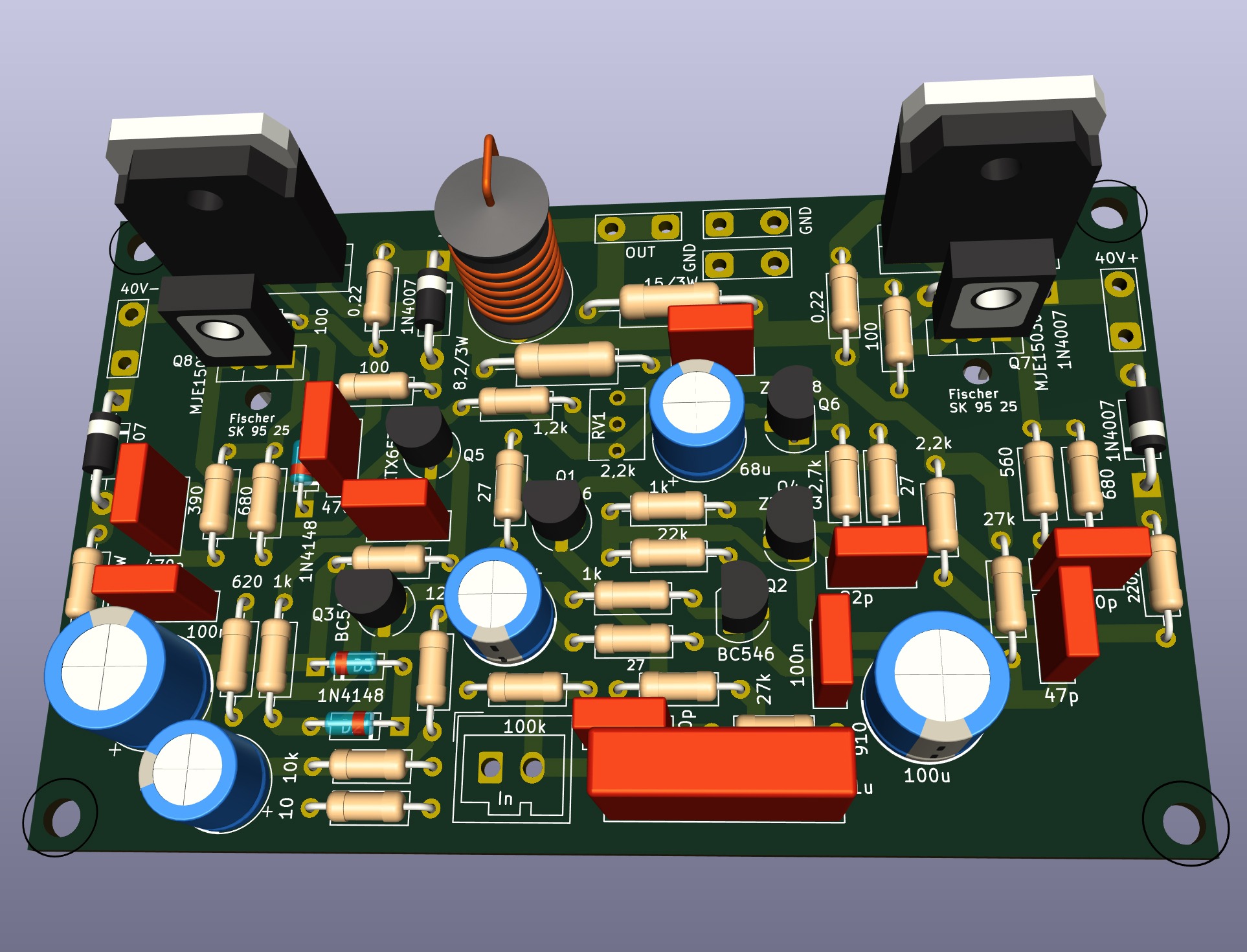

Hi....
It took hours...now i think i can live with this NCC pcb, i have made. I have done a few changes.....feedback resistors close to the output, transistors moved to other places. Controlled the pinout for the transistors MPSA 06, ZTX108 and so on...
The input has a signalgorund. If not needed i can short R4/10 ohm.
I hope all Mods of Mister Greg Ball now in....another look tomorrow.
Good night
Peter

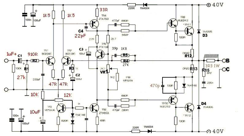

The plan https://www.diyaudio.com/community/threads/nap-140-clone-amp-kit-on-ebay.112453/page-48
It is easyer to read as the plan Gabor shows above. In the original NCC schematic are 47pf set for C9 (you are right).
You can ask me whats the meaning of C14. I dont know.
I can draw a schematic and make a PCB. My electronic knowledge is to small....sorry....
I only can hope Mister Greg Ball has done everything right in his NCC Mod...I tried to find more information about the mod, but the SKA forum is dead.
You can read about the NCC mod in the pinkfishmedia forum, but no schematic, no pictures.

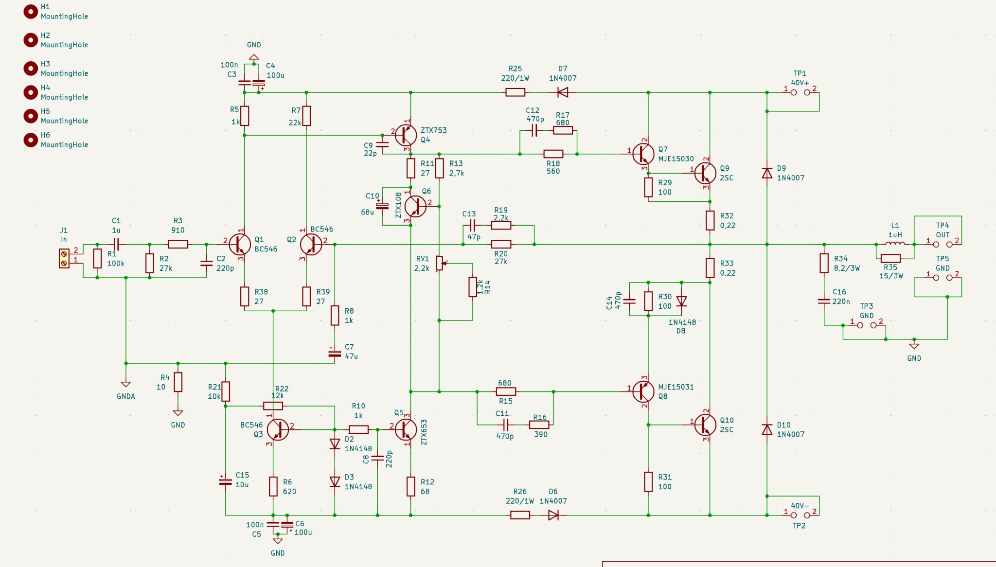

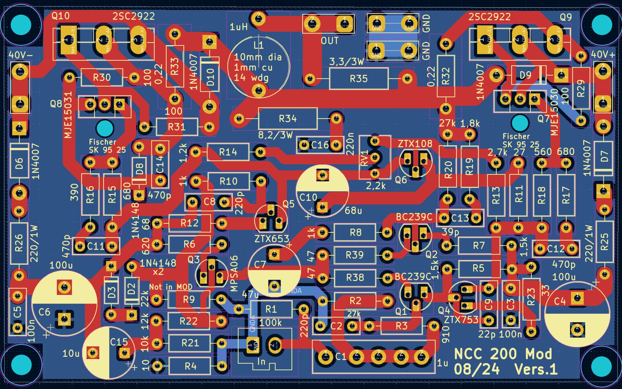

Hi....
in the schematic i have marked the original values in blue ( shows what is different to the Greg Ball Mod). In the Mod schematic only R9/22k is deleted.
Because that is the only different, exept the values, i can built the original NCC or the Mod NCC. R9 is also marked on the pcb.
The Mod schematic, Gabor posted, is really small. I made a sreenshot of my KiCad schematic with the marked values. i hope every thing is right now....
I had to realize that one resistor at the ZTX753 was missing, corrected.....
