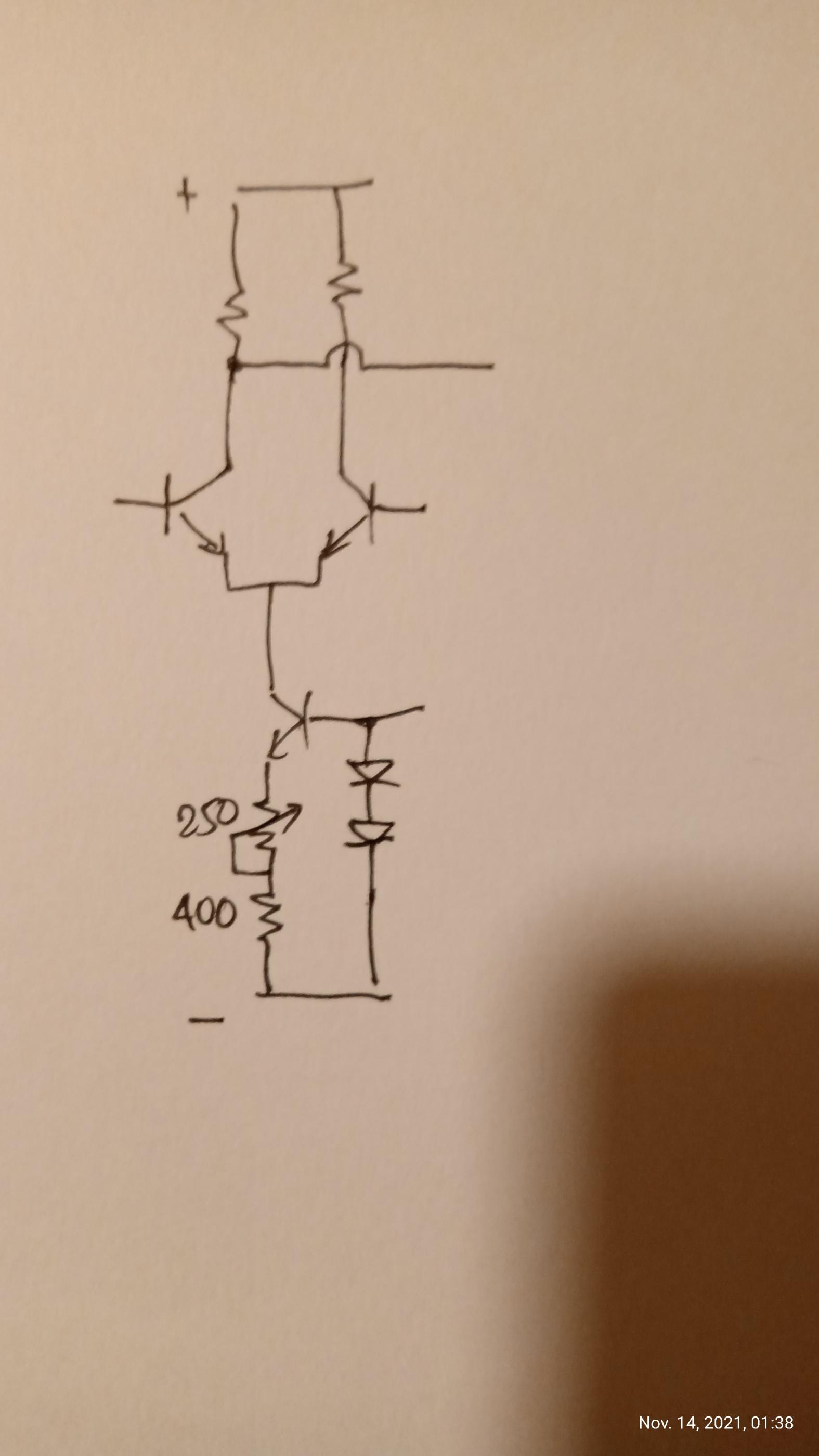

-NCC200 schematic 220R+1N4004 series; for decrease voltage. Can we use zener instead of resistance&diode? why?
-NAP250, NCC200 uses 40volts, so decrease in voltage changes the pre stage(Tr1,2, VAS) voltage. Do we use for example 43 volts for stay 40v for pre stage?
-Second question is, what is the TR1&TR2's Hfe ratio? There are many theory 1:1 or not?

1.The diodes are for reverse voltage protection and isolation, not for regulating it. The resistors reduce the voltage so that the supply voltages to the front end of the amplifier do not exceed +/-40V because that is the safe limit for the ZTX653/753 voltage amplifier transistors. It's possible to reduce that voltage in more controlled ways but since the current demand there is constant, resistance alone is apparently sufficient. You might notice that the Naim NAP250 design doesn't use these diodes or resistors but the power supply for the whole amplifier is limited to a nominal +/- 40VDC.-NCC200 schematic 220R+1N4004 series; for decrease voltage. Can we use zener instead of resistance&diode? why?
2.TR1,2 are tested for hFE within specificification but matched on test for the DC offset voltage measured at the amplifier output. The amplifiers are built in batches, so that once a (mis)match is made, other amplifiers will (mis)match similarly. However, building amplifiers one at a time from random parts will likely mean different results for each amplifier and every pair will need to be matched accordingly. The difficult part of matching is heat - even the heat of your hands is enough to cause the hFE to go wild, so avoid touching the semis. Note: by matched, I just mean chosen according to the lowest resulting offset voltage, as measured on test.
Standard topology reasons
It would be good to repost the related schematic but:
The diode, and the following 100uF caps maintain the LTP current for a short time after powering down, which reduces the resulting pop in the output. Otherwise the VAS CCS would produce a big negative pulse when the VAS shuts down. And, these, in combination with the resistor also reduce the power supply ripple to the IPS, both ~120Hz and supply droop feedback.
Balancing the LTP can be achieved in several ways besides matching transistors, but I can't say they all satisfy the "magic" sound you may be looking for.
(1) The schematic I see has no current mirror between the LTP and VAS so the base resistor has to be chosen so that half the LTP current produces ~0.65V plus any VAS degen resistor voltage for the VAS base. Generally that means it should be 2x the emitter resistor of the LTP CCS. You could tweak either of these resistors.
(2) You will note that the total bias resistance at the bases of the positive and negative inputs is very close if not the same. ie 27K =24k+3K I would move the 24K to the other side of the 3K and make it 27K, a match for the 27k feedback resistor, and then the 3K could be a smaller value, not part of the DC bias. But perhaps a small offset is not really a problem.
(3) And finally the 100 Ohm LTP degeneration resistors can be offset to balance the LTP. Using a pot instead of two resistors for offset adjustment is common although there should be a fixed resistor bypass so that pot slider open does not result in a huge DC output.
The collector resistor on the negative side of the LTP is redundant at best, and potentially contributes stability problems by unnecessarily compromising the phase margin. But then this amp has a "magic" sound for which you may feel that resistor is import.

All valid points.
I find though that the easiest way to control offset is to add a trimmer in the resistor of the LTP current source. Normally I'd put about 400 ohms standard resistor and some 250 ohms multi-turn trimmer in series.
However, perfect offset doesn't mean perfectly balanced LTP currents in this circuit. But that's not the aim here and is just one of the many tricks that one has to try in order to get the "Naim sound". My personal preference is for slightly negative offset. Some -10 to -15mV.
