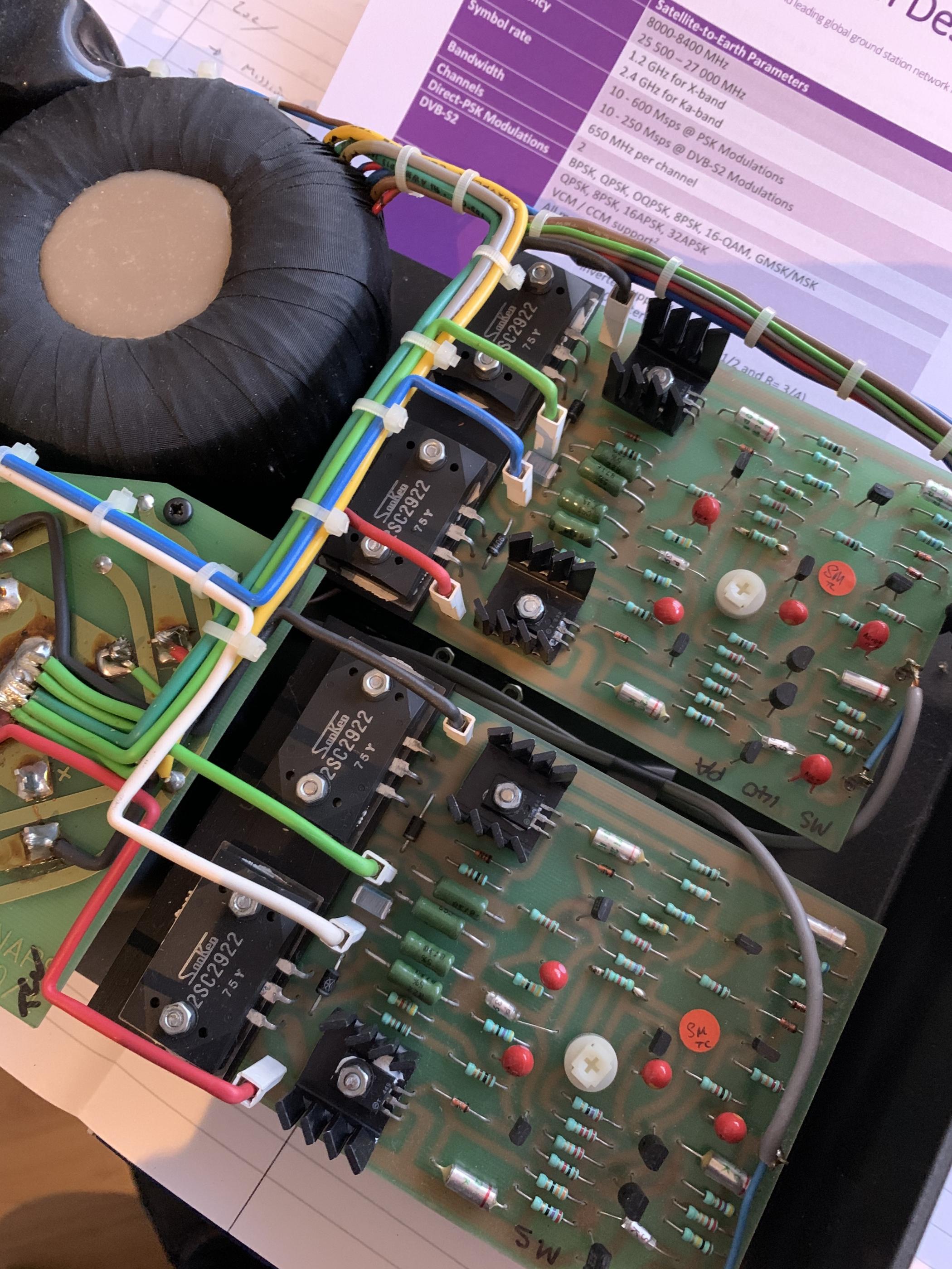

Aha! thanks mdardeniz for the images. They show what was likely copied directly from a real, later series NAP 140. I now have a little more trust in the designs published by HifiDIY, as long as they are identified correctly.

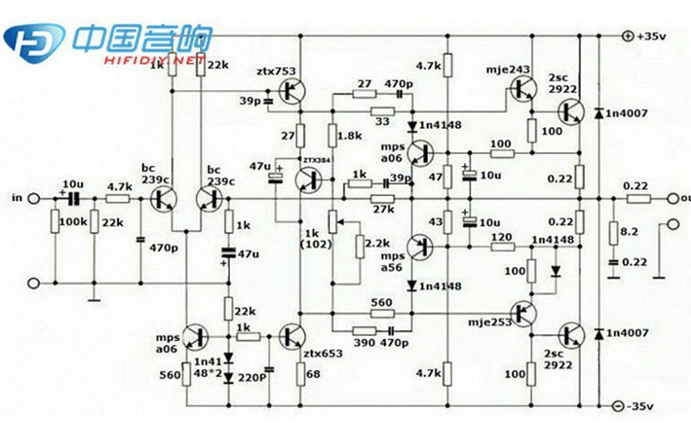

As a matter of interest, these were the same people who produced the first Chinese NAP 140 Ebay kits described in the opening post of this thread, in 2007. They were also the source of the NAP250/140 confusion, over-simplified schematics and unsuitable parts substitutions that are still with us in the cheaper kits. I don't know which is worse; no kits or grossly wrong ones

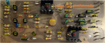

Interesting that the small devices are all in Zetex e-line packages. Only the LTP are TO-92. This makes me wonder when has MPSA transistor ever been in e-line package? Something is not right between schematic and picture, IMO.
Yes, they produced this devices in e-line also, i might have a pic somewhere.

If the transistor is in e-line it's not MPSA. E-line goes only for Zetex/Diodes. Unless I see a datasheet that says otherwise.
Compare the package size and shape of ZTX 752 (roughly in the centre of rensli's image, above,) with either MPSA06 on the left side. They are different shapes and the MPSA types are as expected - cylindrical with one flat face. The ZTX parts have two flat faces and are smaller. They are E-line package, the MPSA types are TO92.
However, having said that, look at this datasheet - MPSA06 pdf, MPSA06 description, MPSA06 datasheets, MPSA06 view ::: ALLDATASHEET :::
rensli may well be correct, though I've never seen these in E-line.
There is also something odd about the transistor labelling of that image. For example, where is the complementary ZTX652? Not that it matters for this purpose, that board looks like NAP120 to me. The power transistors would have been mounted remotely, on the rear panel, which is fashioned into a crude heatsink for that model only. [Review] Naim NAC12 and NAP 120 - vintage preamp and power amp
Here's another strange, fun fact - Naim licensed the manufacture of at least that NAP120 model in New Zealand. JV wasn't altogether happy about it and I think it was a short-lived venture to satisfy a market that was heavily protected with tariffs. You can check this for authenticity in the interviews published online.
Thanks Ian, that explain the transistors. Although I can't find any MPSA devices currently sold by Diodes Inc. on Digikey, Mouser etc. Probably Zetex used to make them some time ago under license and put them in their own e-line.
My main interest was to find out how valid the schematic and picture were. Seems to match, considering your observations.
As for the models, I accepted that the Chinese sources call everything either 140 or 250 🙂 People who want to find the correct info need to do their research and not take eBay ads as a fact. Not that it really matters for DIY. Most variations between models are merely supply voltages, output devices and regulation. I suspect that at the time even Naim were experimenting with "silent" mods in their production, considering how completely different are their grounding and wiring in the old models.
Source of picture is "There's 2 version of NAP 140 PSU design? - #4 by james_n - Hi-Fi Corner - Naim Audio - Community"
" the first NAP140s from 1986 used Sanken 2SC2922s. Then in 1990 the NAP140 was upgraded with Naim’s own NA001s."
I removed the link. may be illegal. You can search with google.
