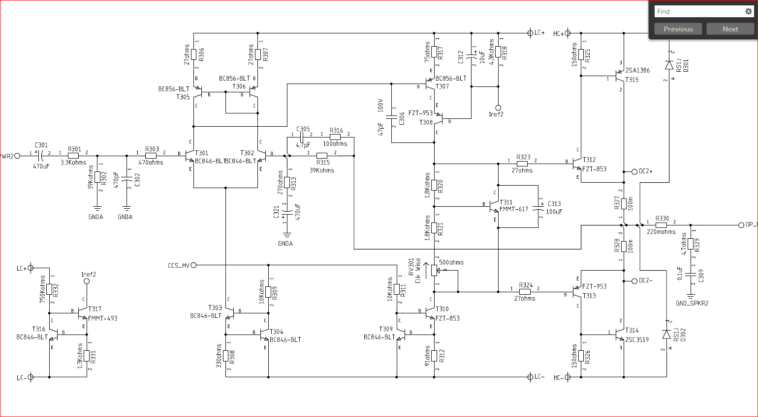

Are you sure? Why would Naim waste a resistor?The collector resistor on the negative side of the LTP is redundant at best, and potentially contributes stability problems by unnecessarily compromising the phase margin. But then this amp has a "magic" sound for which you may feel that resistor is import.
It raises some questions. I'm sure JV would not approve of this design. It breaks a lot of the design axioms of the earlier amps. I personally would not buy this because I can see many weaknesses in it. It looks almost as if Naim hired a college graduate to design it...or maybe Douglas Self . I doubt they lost the formula, but if not they have deliberately decided to compromise the sound quality for some reason. Could be to ensure it fits in the price/performance curve or maybe its cheaper to manufacture. It has more parts so it would only be cheaper if there was less, manual select on test.To change the subject a little and return for a moment to a previous discussion about the VAS transistors and sound quality, I thought some of you might be interested in what goes on in newer Naim models. I've been interested in the Nait 5i because it looks like it would suit my humble needs but not everyone likes its sound quality so I was pleased to find its schematic already linked/posted.
The accuracy of the input differential amplifier, or long tailed pair, is crucially important in a NFB design. Any errors will be unfixable. There are plenty of mathematical explanations of LTPs around to explain what conditions, like transistor gain and Ic and so on make for the smallest error.

schematic graphics
I think people put a resistor there for "symmetry" without considering that the other side is actually pulled up by the VAS BE junction, 0.65V from the rail. But the higher Z on that collector creates an unnecessary "Miller" capacitance. You could argue that it reduces the power dissipation of the transistor; not really an issue. Remember this is a trial and error design so if it didn't cause any problems then it stayed.
Something similar is the diode in the emitter of the PNP driver, although that could actually be useful for cross coupling if they only used it that way, but rarely do.
As I said before, there is no accounting for the "magic" sound. And DIYA is full of beautiful schematics that have serious problems, like the symmetrical IPS amps.

This diode/resistor combination has a specific role in any quasi-complementary amplifier. It's often referred to as a "Baxandall diode" after P.J.Baxandall who is usually credited with defining the application - same guy as the one who developed the Baxandall tone control system that is still used in analog audio circuits. See post #7 here: Help in design: adding a Baxandall diode across emitter in Quasi Complimentary Stage....Something similar is the diode in the emitter of the PNP driver, although that could actually be useful for cross coupling if they only used it that way, but rarely do.....

39p/1.8k is for additional stability. Because NCC circuit has degeneration LTP resistors the open loop gain of the amp is much lower, which makes the amp more stable with its usual closed loop gain. So, they omitted that RC circuit.
Stability also depends on PCB topology and wiring. Cloning a circuit doesn't mean you'll make it same as the original.
NCC200 is not promoted as Naim clone anyway. Avondale believe theirs is an upgraded design but their schematic is popular for DIY experimenters because it gets updated from time to time so that mostly common and easily found parts are specified. Still be careful with the issue date or you may find yourself with a different schematic to the one you began with.
The NAP250 schematic we find on the net, is unchanged from the original, issued more than 45 years ago, as I recall. This is what most Chinese kits are based on but as Ruwe mentions, they may not be exact copies either - many will omit the phase correcting networks referred to. If you wanted to buy the PCBs or a kit of parts for the NCC200 though, the price would be many times the price of Chinese kits. So you will have to work through what changes should or should not be made if you are using particular PCBs designed for a different clone version.
It's called "phase lead compensation" if you want to look it up.In Naim's schematic in feedback path there are 27k // 39pf & 1k8. NCC schematic for 39pf & 1k8, wrotes "not necessary". what happened or changed on the schematic, how it happend not necessary? I'm not an engineer. If it's silly question, forgive me
