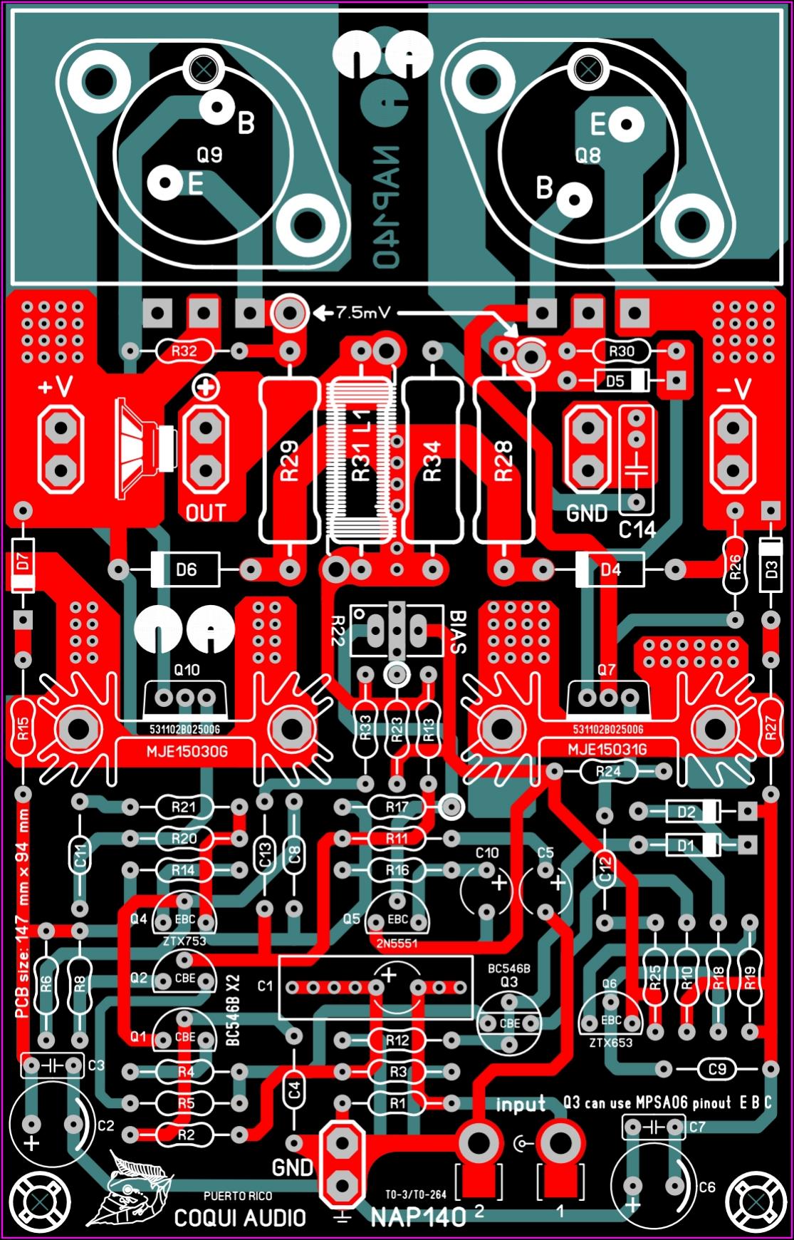

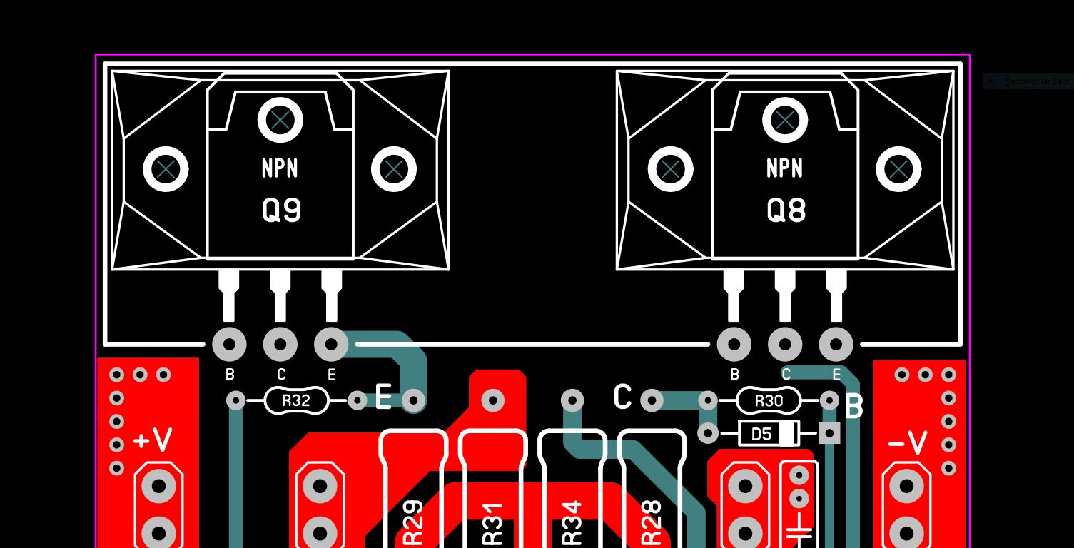

hi guys I'm a fanatic PCB design, I got a question I made this PCB and I need to know if R31 needs a coil around it?
Julian Vereker (the founder of Naim and the original designer of the amp) thought not. However, they have been known to self-destruct if you run them without speaker wires attached (which also have some inductance and so act like a coil).
Personally I don't use one. I know others that do.

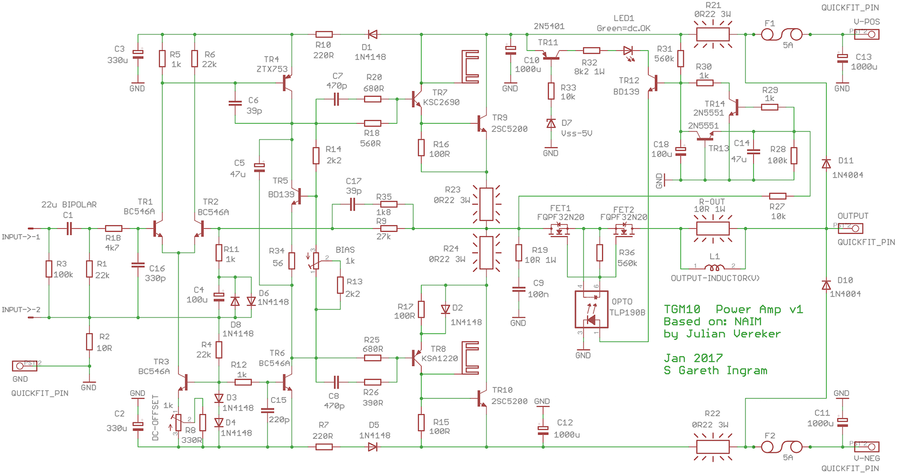

Is it possible to put semiconductors together for stable bias?
I know Naim relied on the enclosure for bias control which is less than ideal but it’s possible to have an inherently stable thermal design, as I have done so already:
TGM10 - based on NAIM by Julian Vereker
but I didn’t use TO-3 power devices which makes it more challenging. Maybe there’s a way to do it.

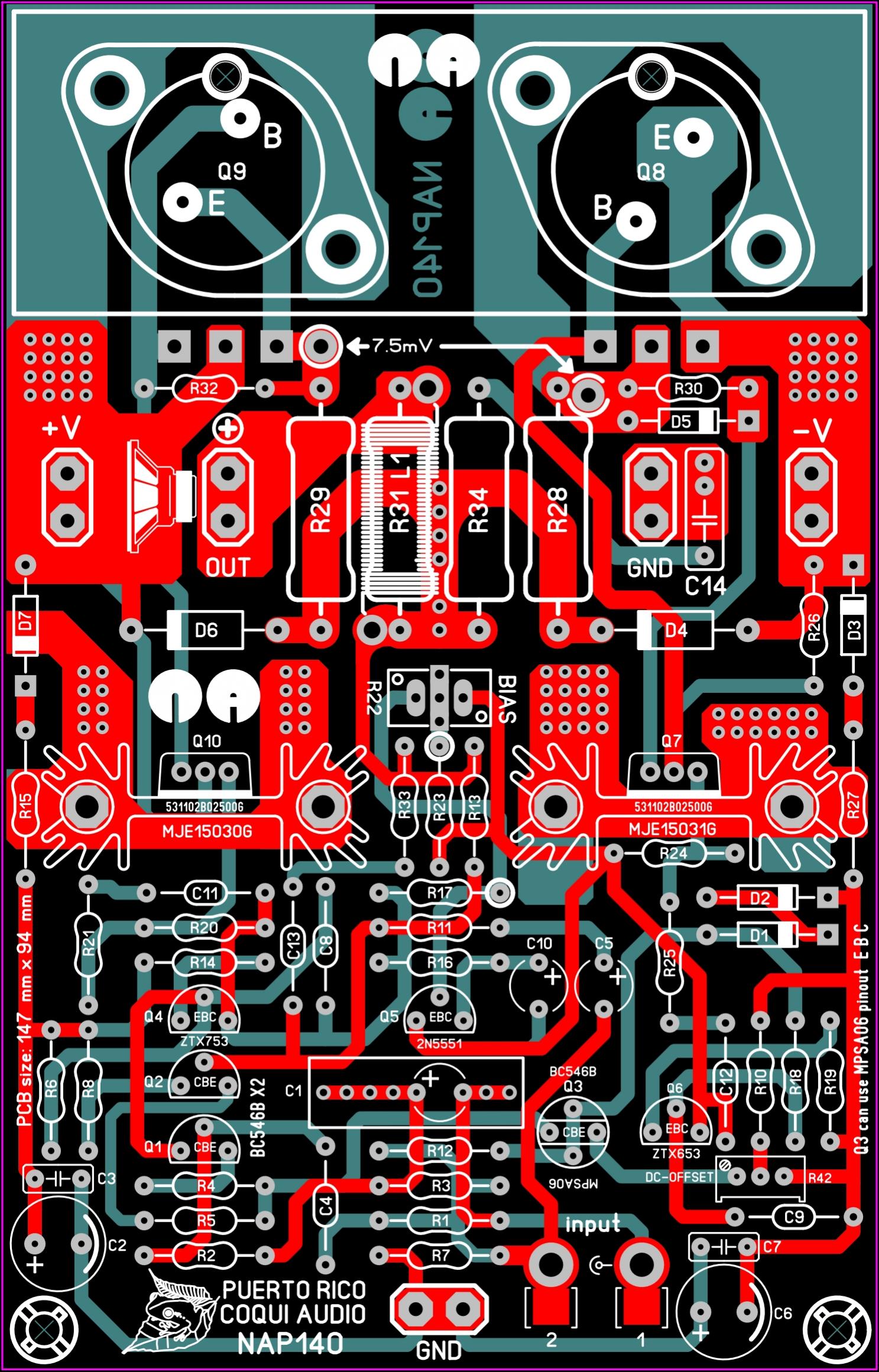

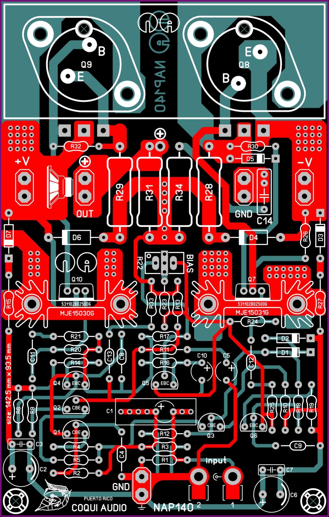

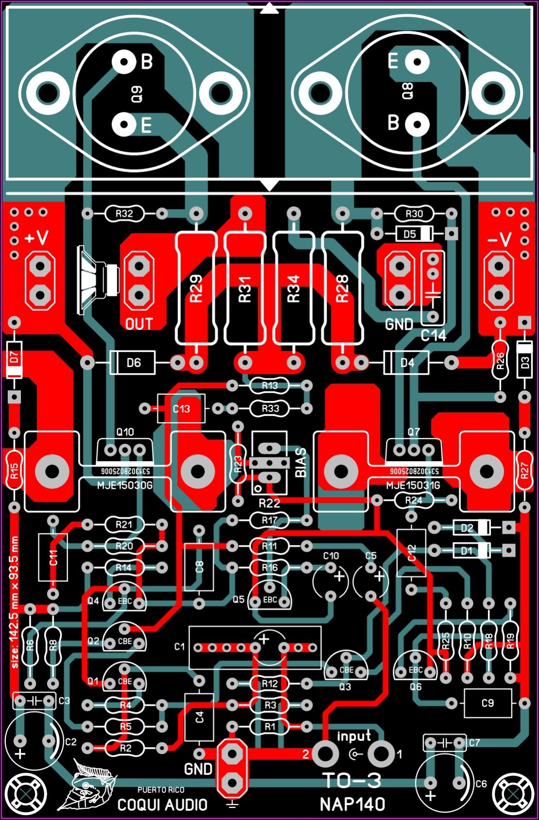

nobody? okay lol here is what I have so far I decide to add an option for TO-264 transistors anyway I'm just gonna documented here since this is a section for NAP 140 clones good day guys 🙂
I'm gonna check on that sure 🙂

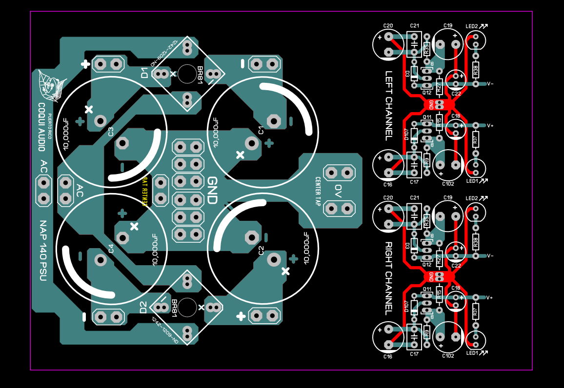

I would love to have a scanned image of the PCB of the NAP 140 and the PSU PCB's does some one have it? not from the eBay ones I mean the actual original PCB is some one can share I would really appreciated, by the way I don't have intentions or aim to sale noting only pure art PCB work and share ideas here if some one have the scanned image of the original PCB please PM me I'm a freak of vintage PCB designs 😛 thank you
Regards
Juan
Hi Juan.
It's important to use good quality psu capacitors. Not all capacitors are the same. My rule of thumb is "the heavier the better", but mfrs never give the weight. I have used Mundorf MLytic AG with good results.
As you have modified the original amp circuit to have front-end rectification and smoothing (which I do not recommend), you are able to separate the front end psu traces from the power transistors. Have you considered building regulated supplies for the front ends? Naim have a front-end psu module now; I'm not sure whether they can be retro-fitted to a NAP-140 but they can on some NAP-250s.

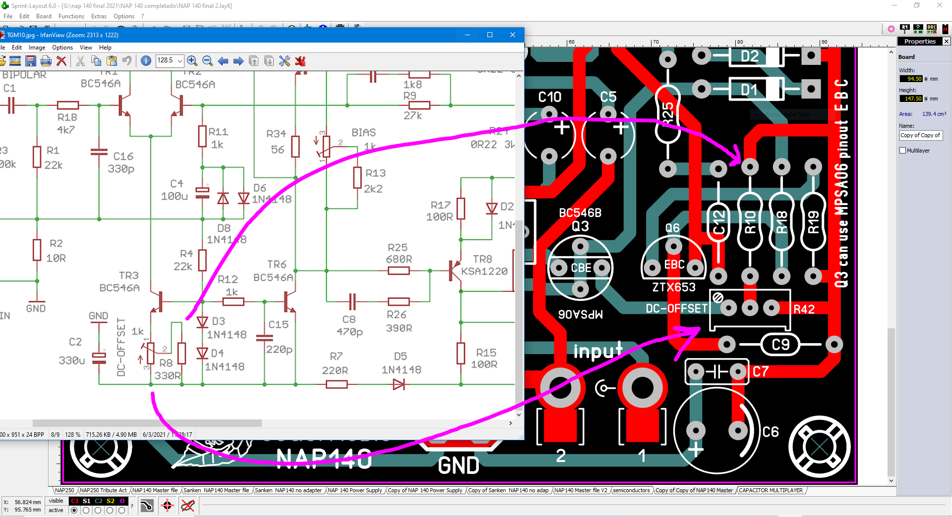

hi traderbam I was thinking to use the circuit from Ostripper capacitor multiplayer the current consumption is really low a few mA is just and idea that I have see image and schematic I'm thinking to add R7 10R is not on the layout PCB is a good idea? the TGM10 circuit looks interesting 🙂
I see you are making a modified version of the original: Mongo-NAP? 🙂
I think R7 is intended to reduce ground currents that might flow between the star ground of the amp and the ground of the equipment feeding the amp, which could modulate the input gnd voltage. The Naim does not use R7 and they expect a Naim pre-amp to drive the Naim power-amp, so they have control over the grounding arrangements.

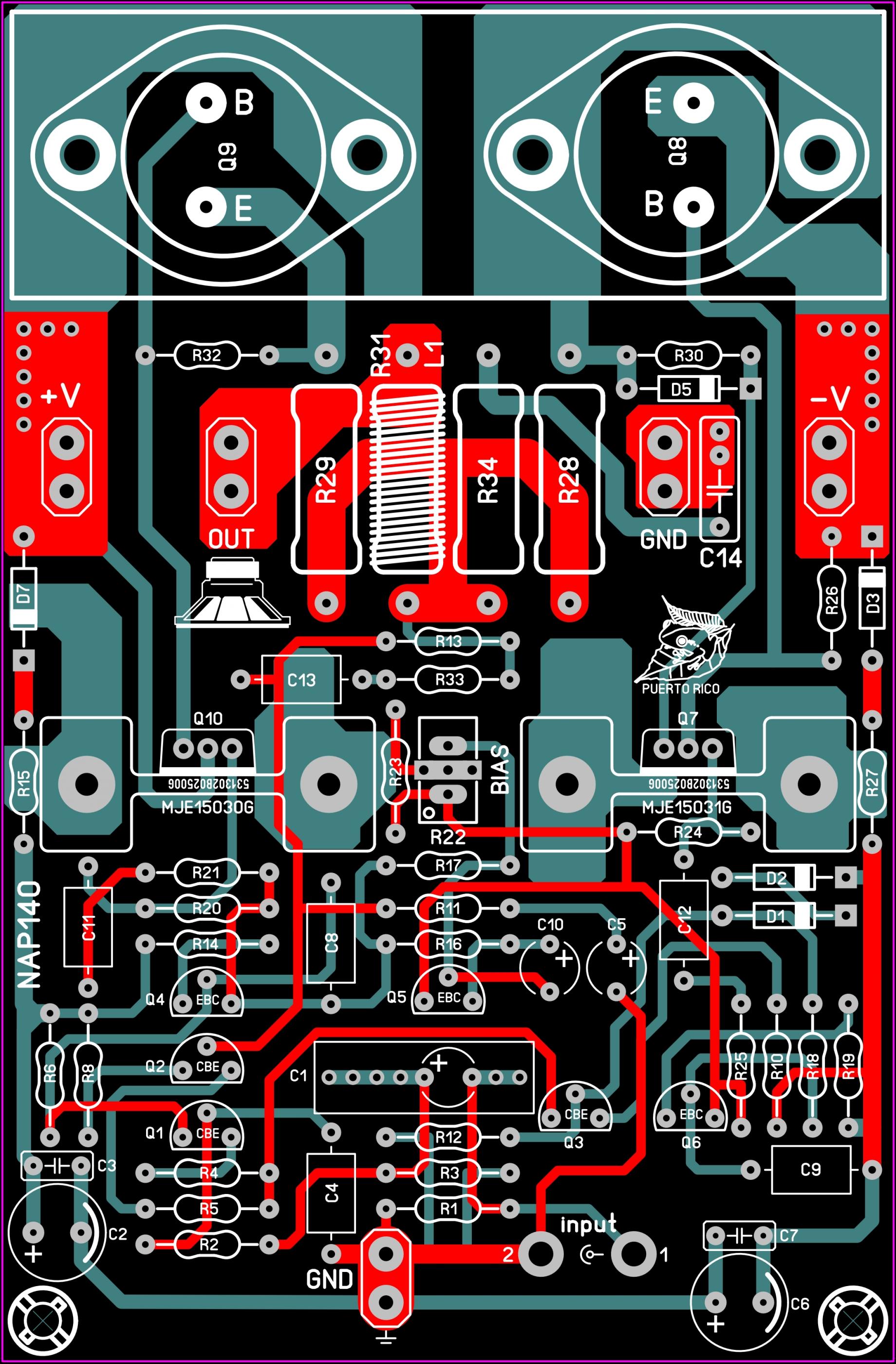

hi I add the R7 and R42 pot to adjusted dc offset also I change the R21 and C11 and the R25 and C12 orientation I use this schematic reference just a few things 🙂 MongoNap? good name 😛 lol

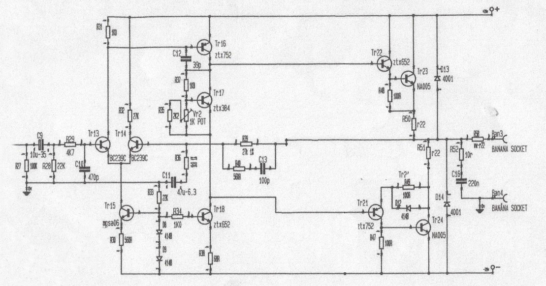

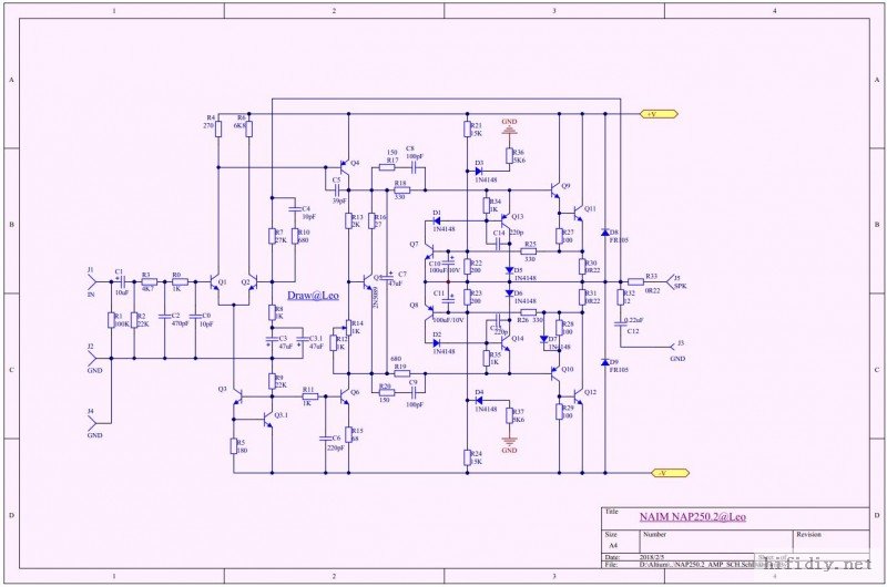

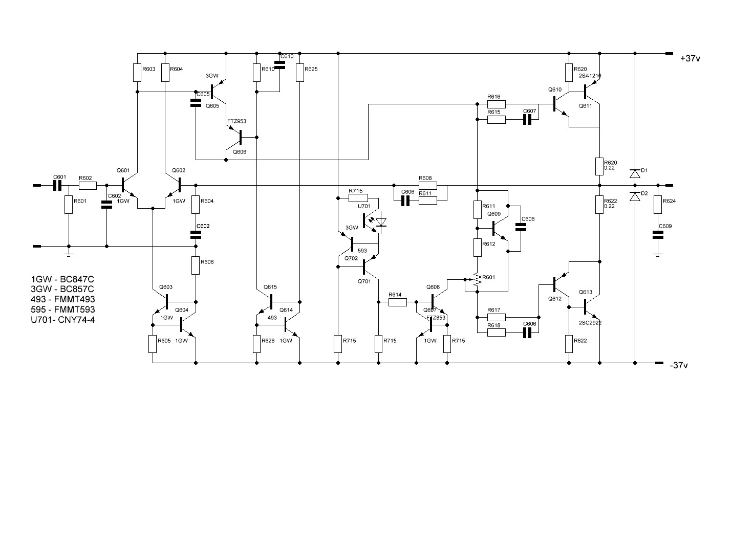

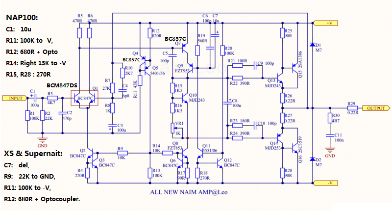

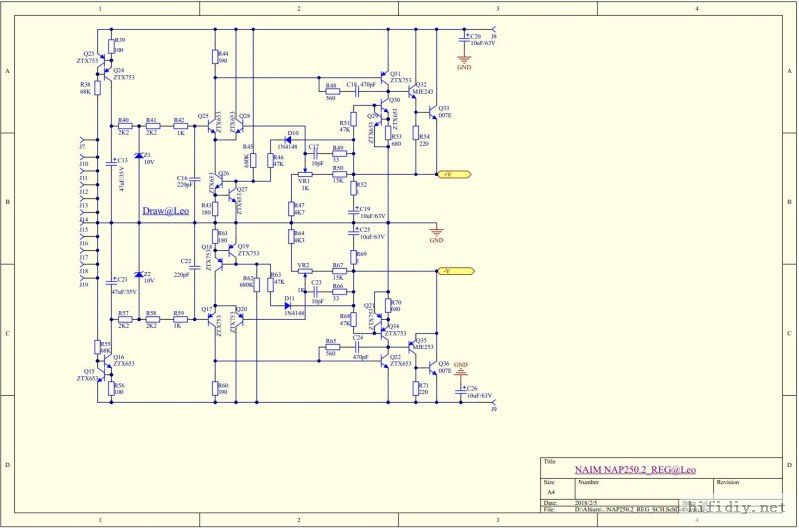

For reference I enclose some schematics I saved over time: one original NAP90 and recent amp designs reverse engenered by members of the Chinese forum:
