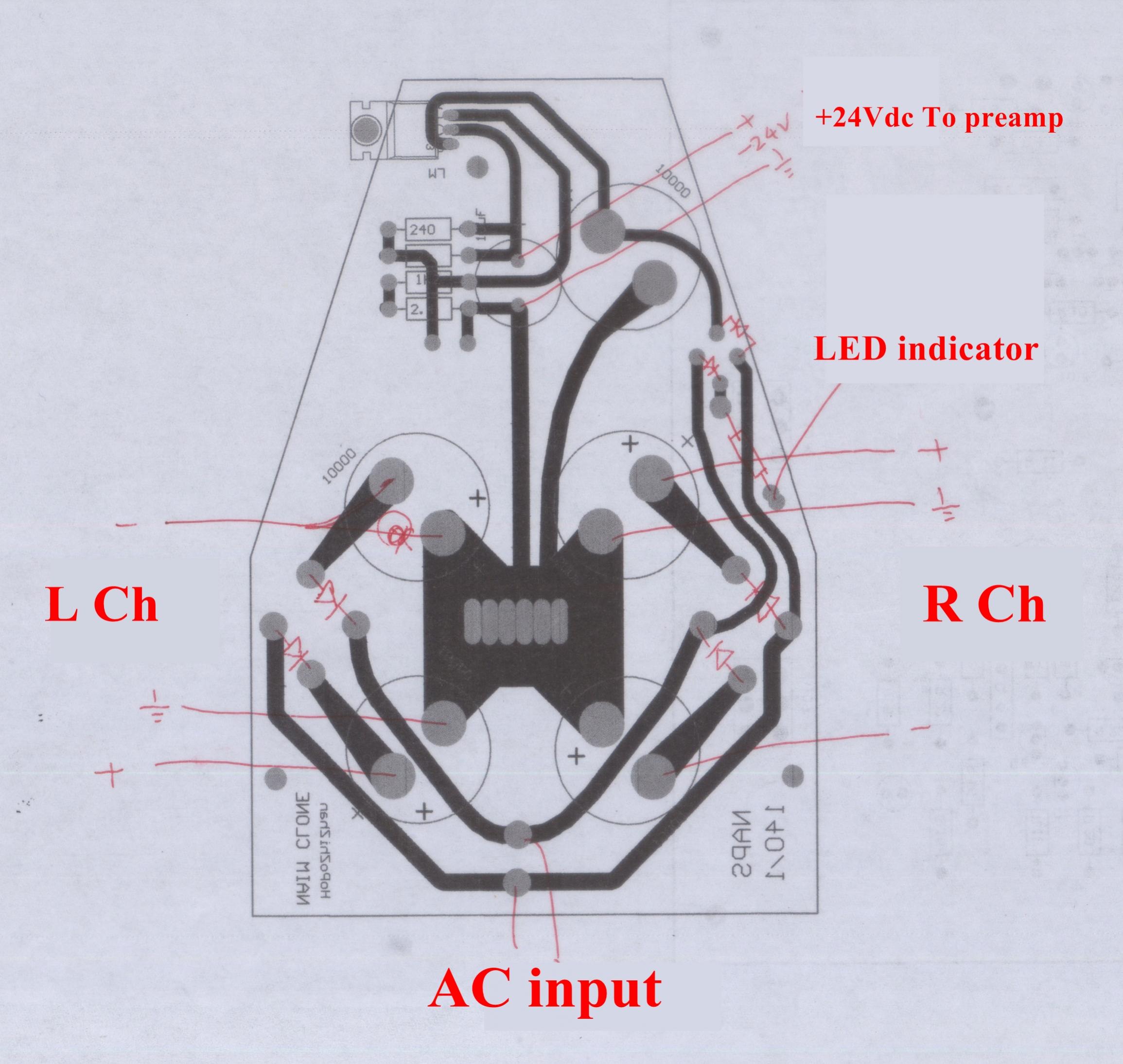

Hi guys
I received my boards from Jim's audio, very nicely done. As far as I saw compared to this site Modifying Naim Audio power amplifiers and what Jim's audio write in the description, the power supply board is an exact copy from the original.
Is is correct that I need a DC voltage of about 34V ? (in the clone schematics they mention 40V).
What I am not sure about is the transformer: According to the schematics I got there is a single winding with 0-24V and the Transfomer should be of about 160-200VA. No center Tap... is this correct ? I am confused after reading...

AC inputs are both ends of the secondary windings and the centre tap connects to ground. You can't run this amp without +/- DC rails.
Above 30V and below 40V per rail I think should work fine. I would suggest a bigger transformer, especially if you run close to +/-40V. Better >300VA.
Yes, the rail voltages specified and found on larger NAP model amplifiers, is +/-40VDC which, for unregulated power supply models, suggests transformers with 2 secondary windings of 28VAC (it would be custom wound for this unusual voltage). Naim look-alike 110/220VAC mains supply transformers of about 350VA rating and 28V secondary windings can be sourced from China but freight costs are a problem there.
Clones of the smaller NAP140 model require about +/-34VDC supplies and can work with standard, dual 25VAC secondary windings on even a 160VA rated transformer, as long as it doesn't have to drive 4R speakers at maximum bass volume or some such high power level.

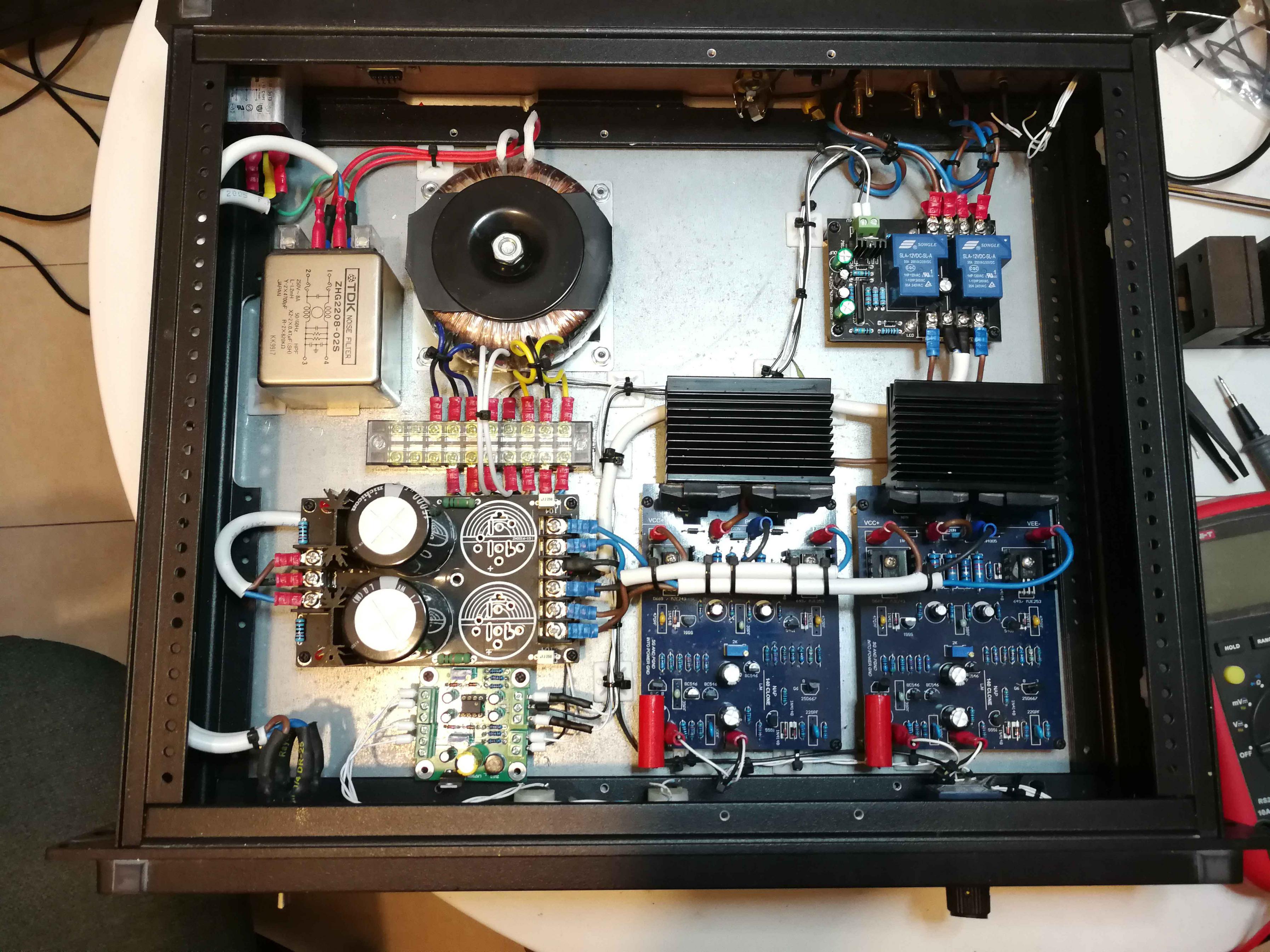

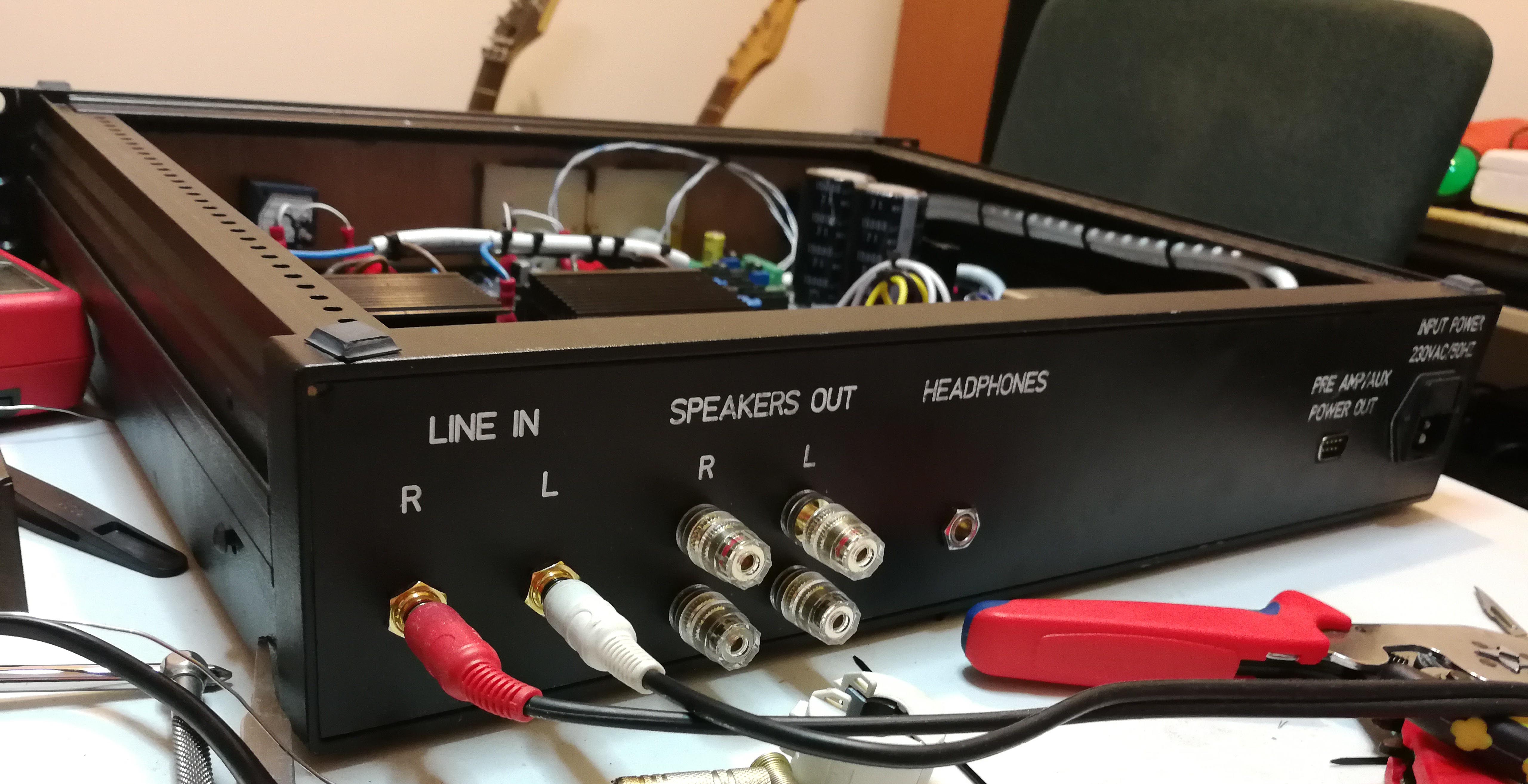

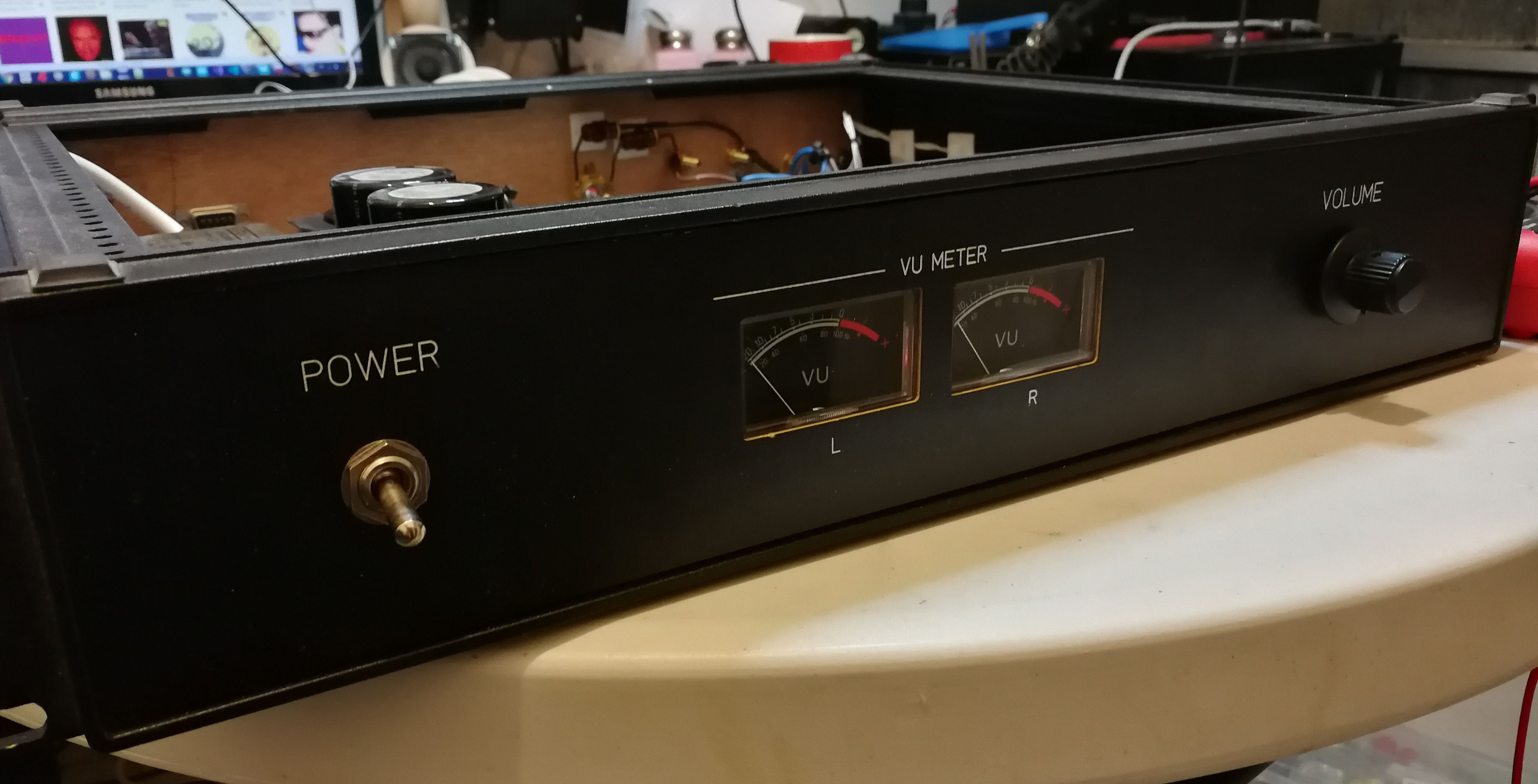

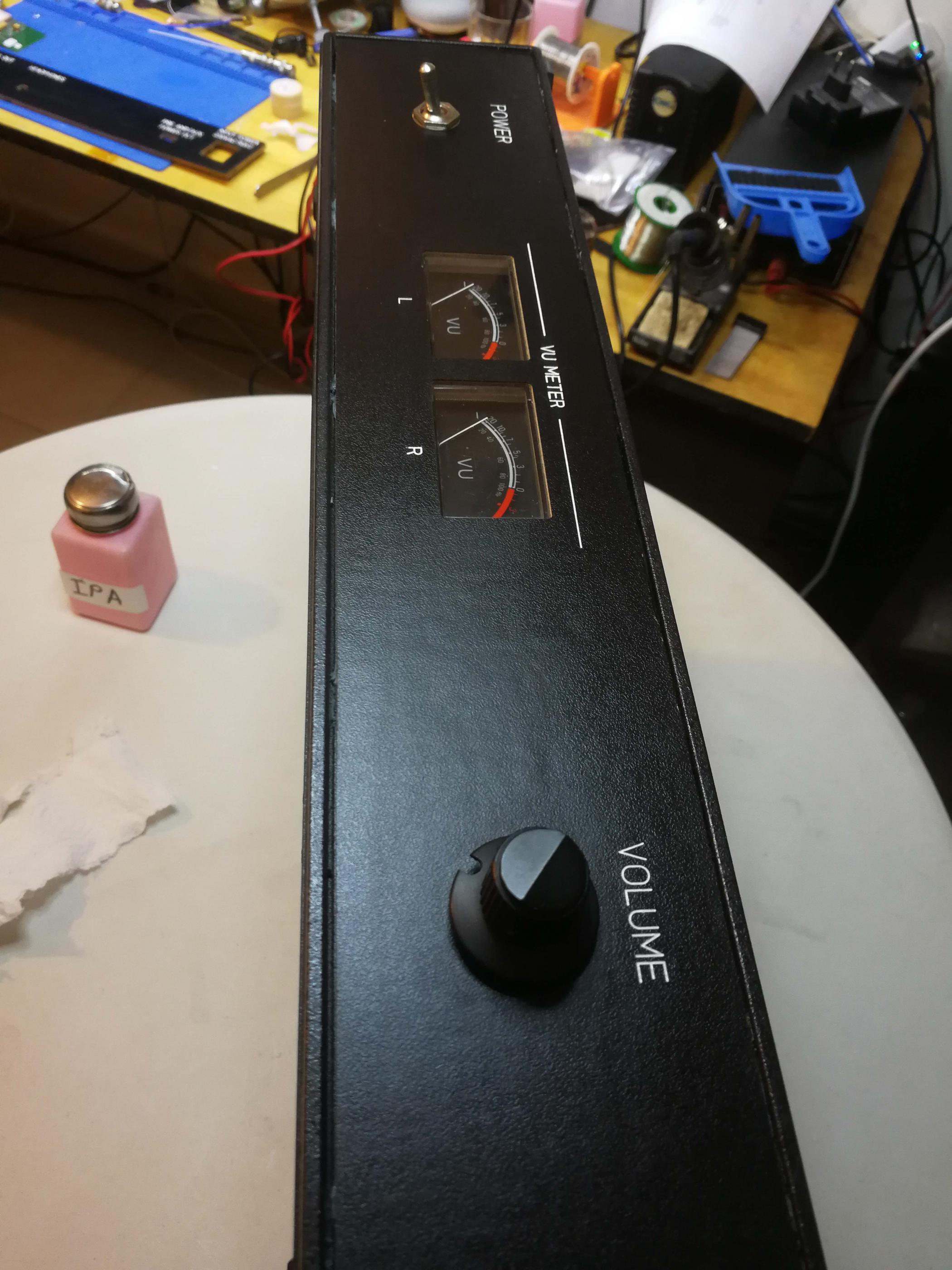

Here is my clone amp...
i love viewing all of your posts. great job.
i started this project about 1 year ago. it took a lot of time to complete.
the input capacitors where changed to foil.
i have some line voltage filtering.
the amp is built inside 2U rack enclosure i found 10 years ago and kept.
the heat sinks are from a LPKF CNC old motor driver board. (i converted it to mach3).
i used the CNC to cut the panels and text.
the volume pot is ALPS (ali express version).

Yes, some very tidy and pro. quality assembly work there. Some nice tools you have too!
However, you won't be able to listen at high volume for long without the output transistors overheating. For normal convection cooling, as I see it, those heatsinks are way too small, the fin spacing too narrow and wrongly aligned. Unless you also have fan-forced air draughts for those sinks, let me suggest some basics for normal convection cooling:
- Heatsink Fins should be aligned vertically to allow air to flow freely from one end of the fins to the other.
- There should be vents in the case to admit cool air at the bottom and exhaust hot at the top, usually directly above and below the heatsink.
- Fin spacing and thickness should be large - typically spaced with 10mm pitch and the thermal rating should, I think, be at most 1.5K/W for each NAP 140 amplifier module, assuming no more than standard +/-34-35 VDC power supplies).
Your current heatsinks will be rated for use with a specific fan and duct/cover but it is unlikely the present arrangement will stay reasonably cool with more than a few watts output, even though only a small bias current is used.
Heatsinks don't need to be huge for the power levels used in most homes and apartments (i.e. <5W) but with those little fan-forced air types, you wont be able to listen at living room levels (and definitely not party levels) for long before there is a smell of hot transistors, burning and then silence. You could add a simple thermal power switch to avert such a disaster but that's hardly a solution.

I would like to join in the compliments on the cleanliness and the general great accuracy of workmanship.
Excellent LC cell power supply filtering, softstart circuit and DC output voltage protection.
But apart from perhaps the small size of the toroidal power transformer, I have to agree with Ian Finch:........ the two heatsinks are unacceptably small, and the position of the power transistors, with respect to the radiating mass, should never be peripheral but always central and barycentric to maximise heat loss and reduce Thermal Resistance.
I would see the following modifications as perfect, in priority order:
1) Replacement of the heat sinks,
2) Increase the power of the toroidal power transformer,
3) Adding a pair of electrolytic filtering capacitors for improved dynamic performance of the amplifier.

Thank you all for all your comments and insight.
As for the heat sinks, they dont get hot at all... im using a 4 ohm speakers and even at high volume levels the heatsinks dont get hot. So much that i tought that i could have done without it and just couple the transistors to the chassis. Maybe i need to do real measurments of power and temperture.
As for the toroidal transformer bigger is better and more power bank capacitors are welcome.
I connected 2 resistors to the outputs for a headphone jack. 470 ohm i think 3-5 watt.
I was somehow disappointed with the resolution and seperation compared to the phones output from the sound card umc404hd. It was brighter and had more details.
Maybe I should test with different value of resistors. Maybe its an impedance thing.?
Im using sony mdr7506 headphones.

Naim traditionally used the chassis as a heatsink.
When I built my Naim clone, I also just used the aluminium chassis as a heatsink and had no heating issues at all.
It's surprising just how much heat a 2mm thick aluminium chassis can absorb and dissipate.
