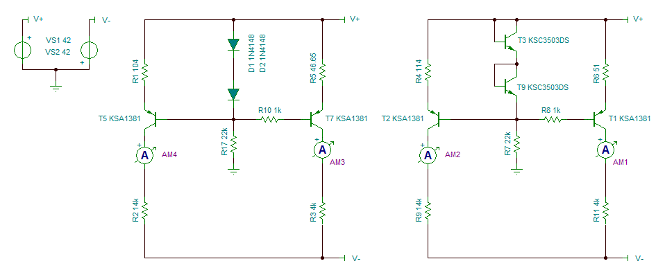

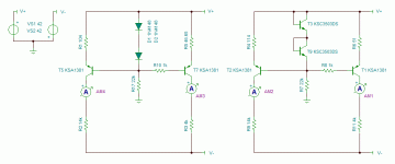

As far as the mentioned issue with Constant Current Source drift
If using a diode type CCS if you use all similar transistors, and also use same
transistors or complementary transistor wired as diodes.
Then the drift will not be as much from ambient temperature

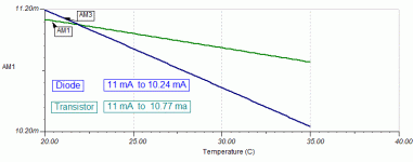

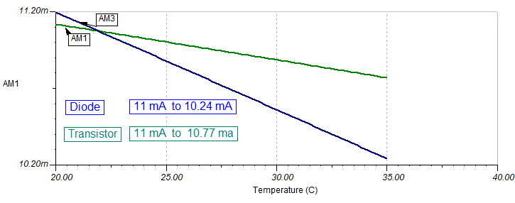

Showing here I set AM1 and AM3 to be 11 mA at 22 C temp
then did basic temperature sweep from 20 to 35 C
attachment.php
Green line transistor used as diode shows less drift
Blue line diodes shows larger drift from temperature
attachment.php
for the amplifier in the thread you could simply use all ZTX transistors in the CCS
and also as diodes. and the CCS would be slightly more stable.
I dont see it really as issue, countless amps use basic diode type CCS without issue
I just found it a interesting exercise to be able to just use transistors as diodes
on the existing board if you really feel CCS drift changes the sonics of the amp at different temps.

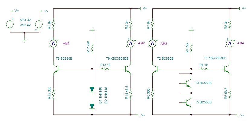

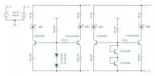

Because we tend to collect a lot of cheap TO92 transistors such as BC550 and maybe sort them for matches or noise level, could you test that or a similar small signal type in your TINA simulation, assuming it's still set up? I do expect it to be the same as your BJT - just curious though.
attachment.php
attachment.php
The transistor as a diode will usually reduce temp drift better
if all the transistors all match.
A lot of designers like to use T0-225 or T0-126 packages for a Vas
transistor, so they will tend to use the same package for the CCS.
When tested in models, It seems the larger package transistors,
used in a CCS will drift more. likely from larger surface area. So the same larger transistor is better to be used as a diode.
Seems smaller T092 are less likely to drift
So likely using all T092 in a CCS would remain pretty steady
