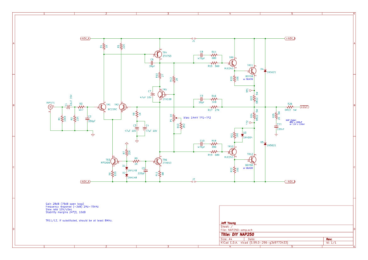

I'm doing a short run of NAP250 boards (with regulators; without SOA).
This is a true nostalgia project with considerable research done into the original circuit and device selection. I'm even deleting the silkscreen and solder-mask on the boards. (It will be a two layer board with plated-through holes, so not entirely old-school).
attachment.php
790990d1572347883-nap250-clone-amp-board-front-jpg
790991d1572347883-nap250-clone-amp-board-jpg
I have designs for both the original regulators (again, without SOA), and an inverted one which references the VAS to ground, greatly increasing its PSRR at high frequency.
See more here:
NAP250 clone
Jeff.
