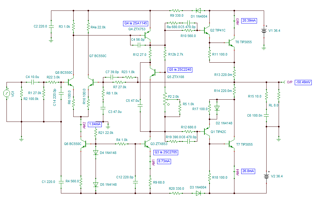

In a simulation your output offset ought to be almost zero. Can you post your schematic?In simulation, changing the 620R to 560R reduces the offset from 77mV to 50mV, and nothing else seems to change, apart from a (very) small reduction in simulated THD.
Here it is. My sim package (Tina Pro) doesn't have models form some of the transistors, so I have made some substitutions, which of course is less than ideal. (The actual transistor types are in blue. The TIP3055's are of course 2SC5200!)
I can upload the .sch file if it's any use?
Referring to the schematic posted below.

If you look at the circuit, nothing can significantly reduce the offset, except if you modify the VAS. If you look at the VAS transistors (Q4 and Q3), top transistor doesn't have emitter resistor while bottom transistor has 68R emitter resistor. This imbalance tends to move offset to the top or positive side. If you lower the R9=68R, offset will move down but this also means current will be higher. IIRC, original VAS current is 10mA with the ZTX? (Yours is 8.7mA).
You can also balance the top and bottom VAS by adding small resistor on the emitter of top transistor. This might have quality compromises that have to be checked. If there is no space for new R on the pcb, you can attach 1/8W resistor on the transistor's leg.
You can also reduce the negative voltage rail by adding RC network on the negative supply. This will lower currents in LTP and VAS, which means you will need to adjust.
This is the consequence of using circuit intended for different VAS transistors, which have quite different properties with other substitutes.
As mentioned before, besides balancing the input and the feedback resistors, the easiest way to play with the offset is to change R4 to a trimmer. If I remember correctly I had slightly negative offset of -10mV at about 540-550 ohms. That's without degeneration resistors.

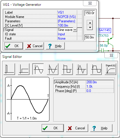

VG1 was set to 200mV sine - however setting it to 0v makes no difference to the measured parameters.

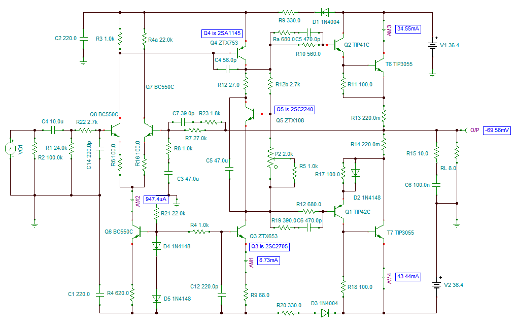

I have posted the revised schematic (27k -> 24k and 3k -> 2.7k changes) and simulation measurements with DC conditions. I also 'adjusted' the bias pot (in the simulation) to more accurately reflect my bias settings.
Incidentally - I checked the quiescent current yesterday, and both (+) and (-) legs are around 35mA, and remain stable there once the amp has settled.
It would seem my only issue is the DC offset, and at around +- 60mV, I'm really not sure if it's that much of an issue?
Interestingly, apart from the bias differences in AM3 / AM4 in the the simulation, it actually matches fairly closely with my 'real' amp.

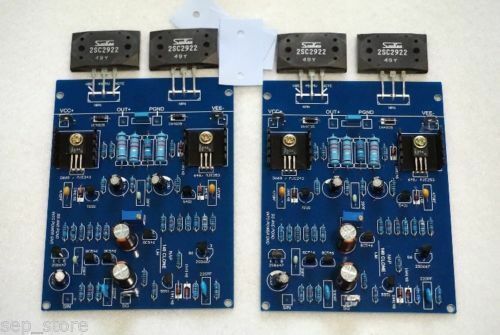

Which boards do you have?
I see that there are several different types on Ebay now.
The most common version seems to have heatsinks on the drivers, which lay flat on the board, with the 2SC2922 output transistors.
For some time now, it has become virtually impossible to find PCB versions of the NAIM NAP 140 clone similar to yours and mine.
To be exact, the one without the current protection net and with the TIP41/42 as drivers (that I have been replacing for years and in all my previous versions with the much more linear, refined and musical MJE15030/31 from ON Semiconductor) and the 2SC5200 as power transistors.

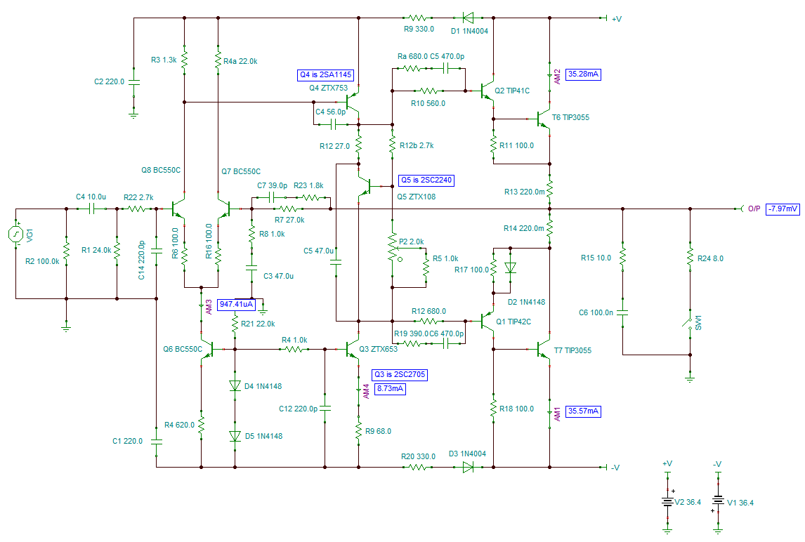

In your sim try changing R3 to 1.3k and see what the offset does.
Yeah, I'm with you too. It is an attempt that should be tried.
@audio_tony
Yes, that brings the offset to -7.97mV - perfect.
