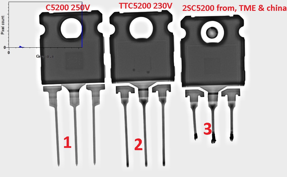

I have recently purchased 3 Types of 2SC5200 transistors.
1. is from farnell C5200 - onsemi
2. is from farnell TTC5200 - Toshiba ?
3. is from TME&china 2SC5200 - Japan.
3nd one is the most common and from chinese/ebay/taydaelectronics, all nr. 3 2SC5200 sourced from these places look, feel and behave the same.

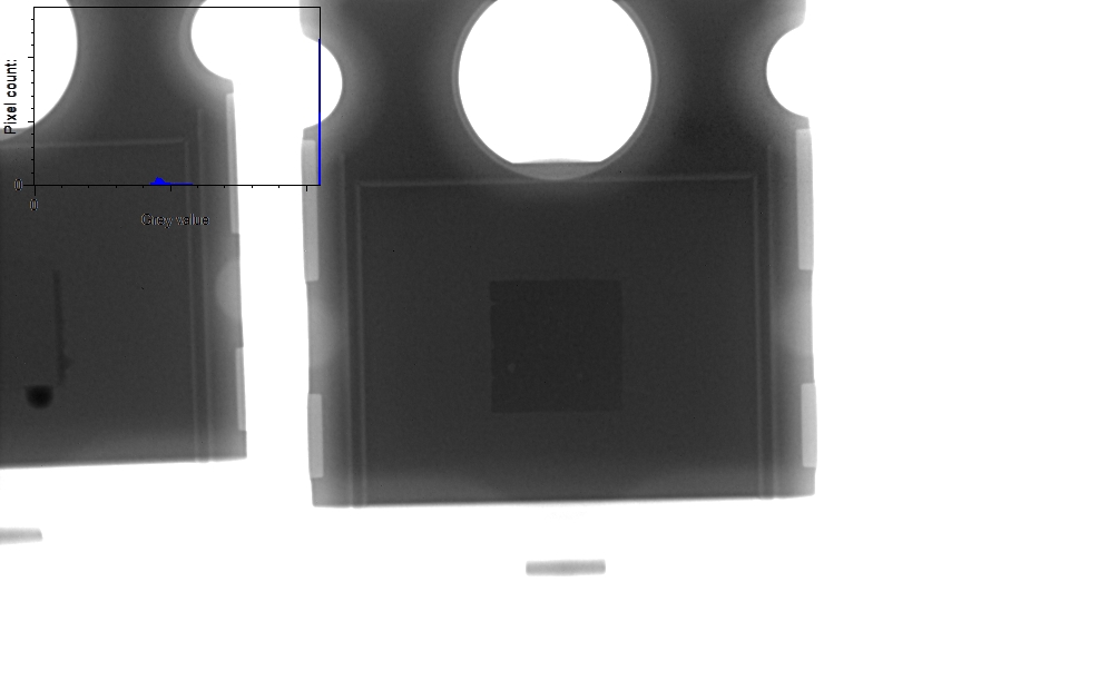

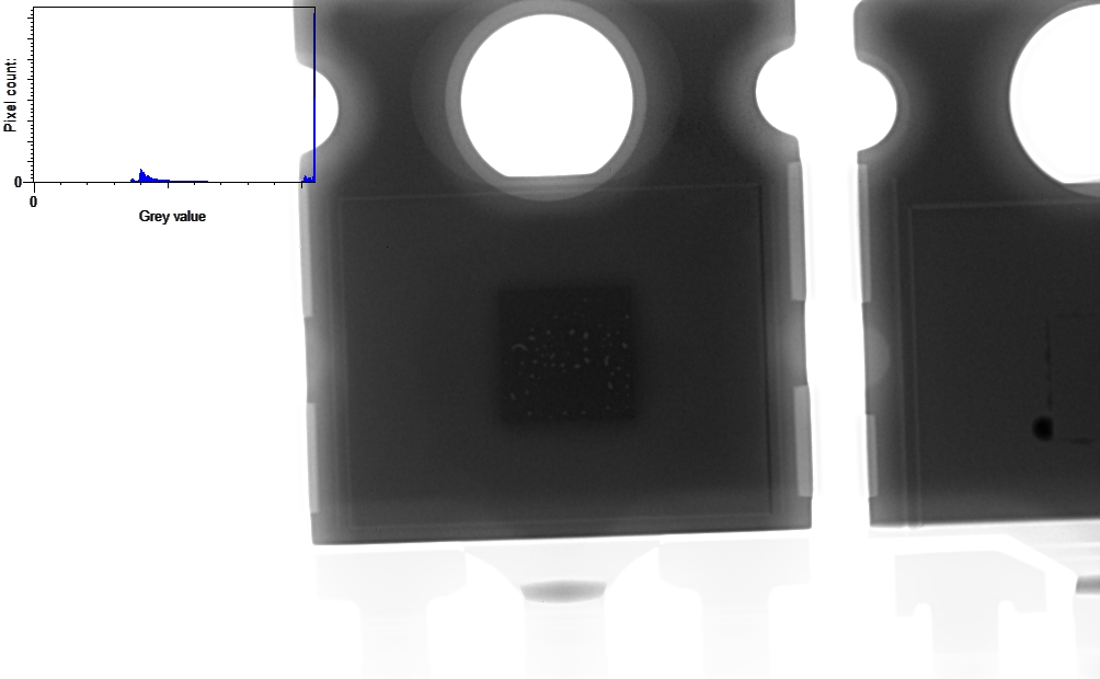

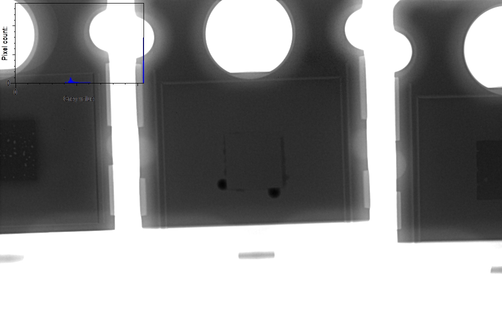

I am conserned about nr. 1 & 2 transistors on the pic, especially with nr. 2 which has 2 dots near the die ??
Nr. 1 seems like short-circuited, its not in practice... on photos it seems that bonding wires are alot closer to each other :)

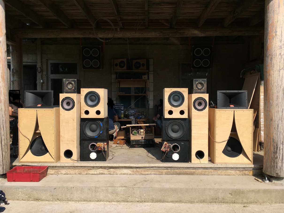

Last photo represents speaker comparision, were mine are the eminence beta 10 CX sitting on top of the black coloured speakers.
To bad i had no true naim or naim clone with me that time.....
Carlsons sounded very powerful, eminence was faster, better acoustical perfomance, especially in human vocal range. Next year will try to re-tune speaker box, increase volume and alter some filter components. It does feel that i have tuned the box too low in frequency.
Some tough's about transistors?

Hope your transistors aren't bad. May I ask how you took the pictures? They look like xrays!
Looking at the pics on Counterfeit Transistors, it seems mine will turn out to be fakes (the font looks nicer than the 'real' ones). Still, we'll see if they are functional.
They actually might not be bad yep, i have not used NR 1 and 2 in circuits yet.
Maybe someone knows here why some DIE's are not perfectly straight edged like nr 3.

Hi Rensli, are you referring to the chip dimensions or the backplate when you say "die size"? They are indeed different to the Japanese products internally, as you may be saying. The Chinese Toshiba products (that's TTC5200/TTA1943) are about 30% smaller in silicon die area than the original Japanese 2SC5200/2SA1943 yet both types come in the large TO264 case. The laser printing is likely to be a little different between the factories, which you can also see in some pics on the web.
Yep, Chip's differ in mounting, a little bit in shape and position... and from other artifacts...
all three different 2SC5200 transistors had the same chip dimensions aka die size ?? ... except MJL21194G from on-semi, stronger, bigger.
