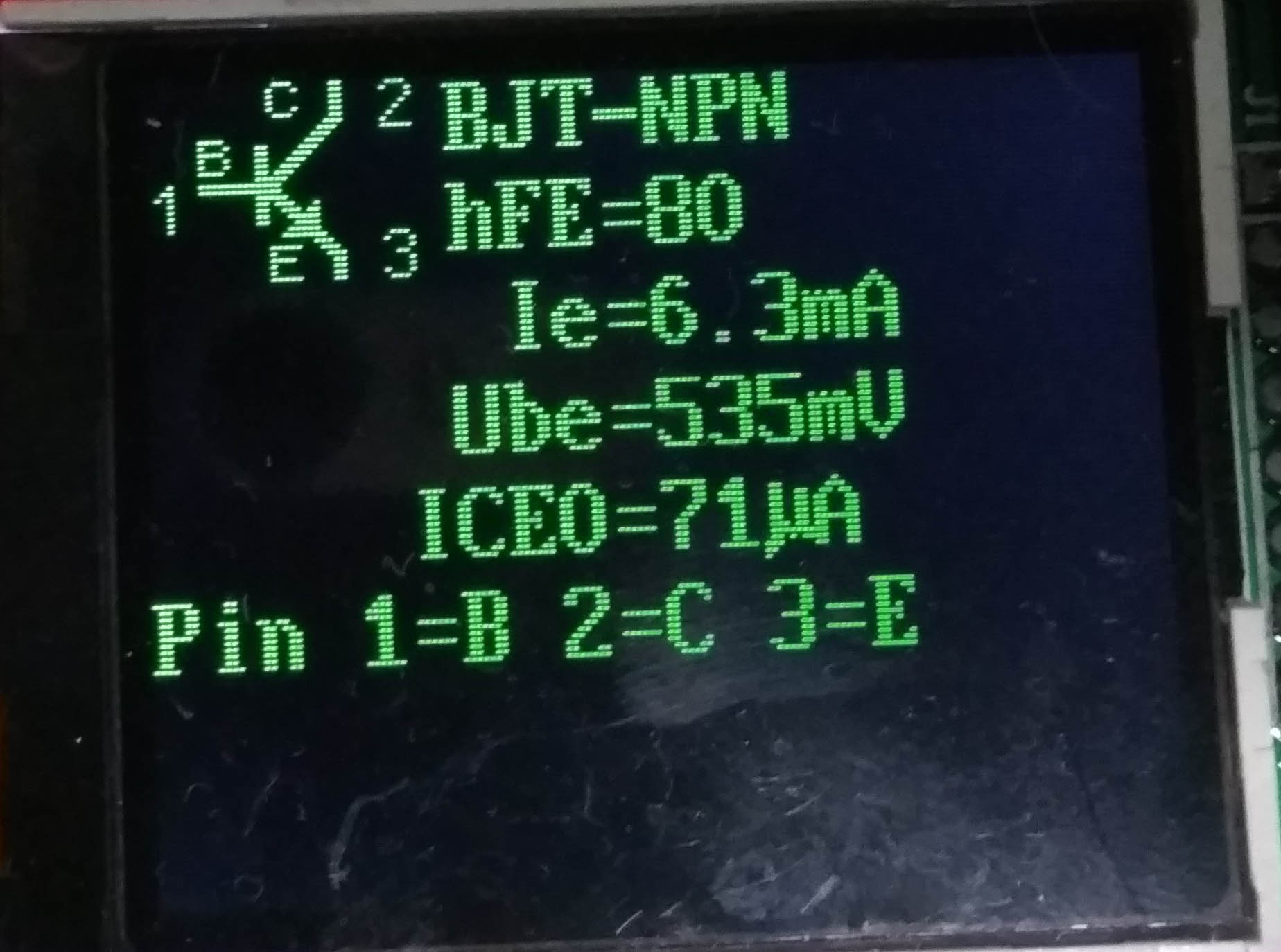

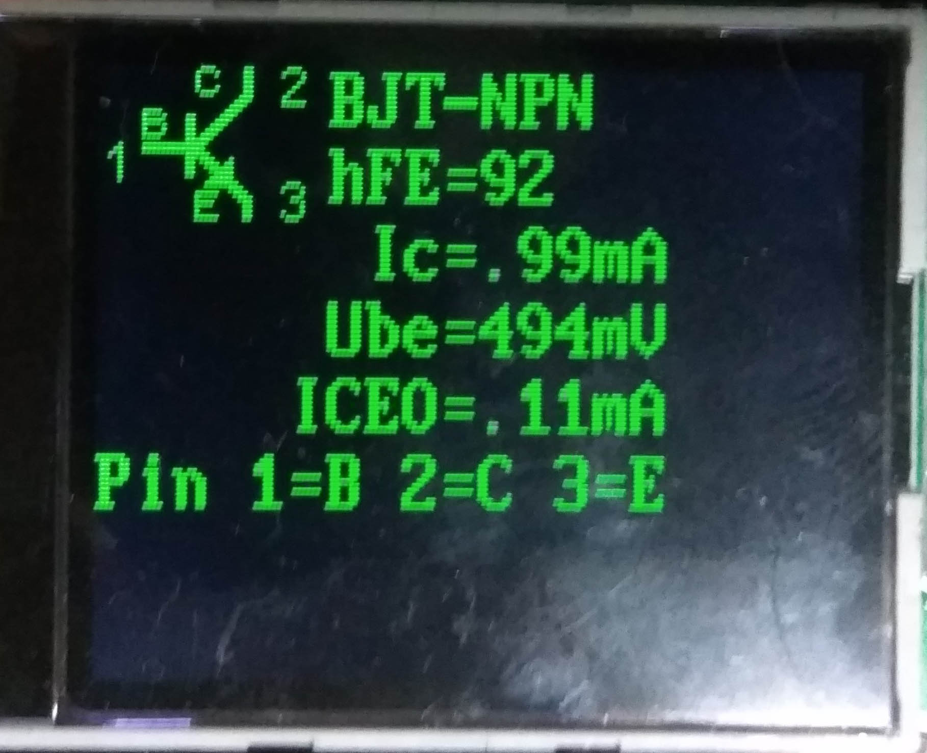

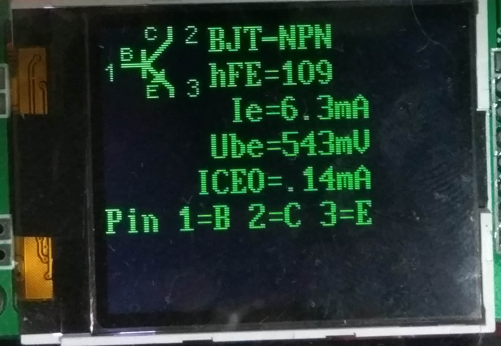

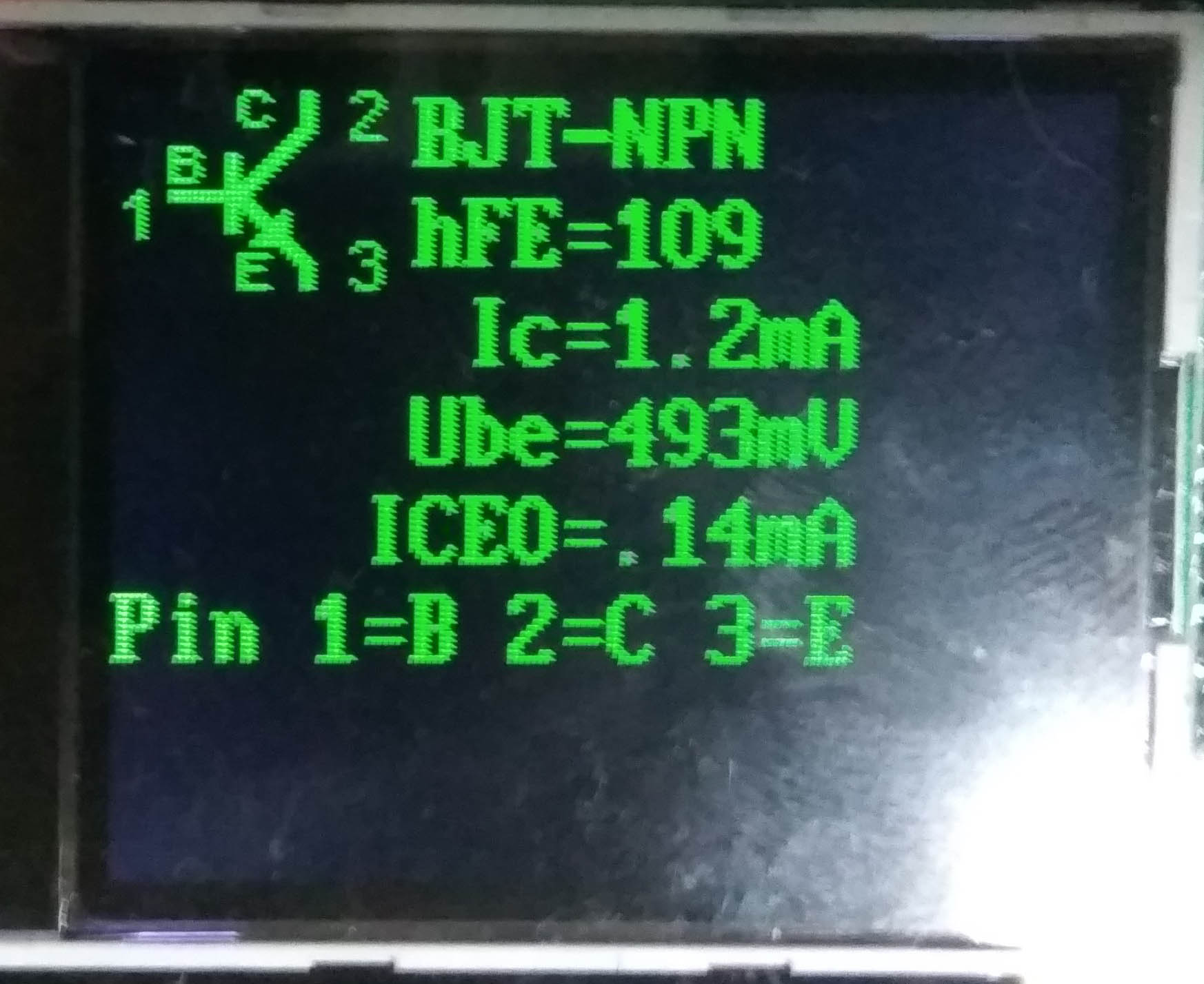

I got myself one of those cheap transistor tester from fleabay and here are the results.
The first two (92hFE, 80hFE) are fakes and the last two (109hFE, 109hFE) are genuine ones.

BTW, measuring transistors with Atmega 328 testers is a waste of time - they give results that are bunched together and all the same in each bunch or occasionally give random high/low values. They may be useful as go/no go testers but that's about all. Look at your measurements - see how they are closely grouped? Those are very unlikely results for any sample of 4 transistors.
I suggest that power transistor gain or Hfe, should be tested at much higher current, like perhaps 0.5A and on a heatsink, if you want meaningful results. Gain measurements that are in the milliamp region are pointless on anything but small signal types (TO92 size etc.) which work at that sort of current. There are meters for this that aren't terribly expensive but certainly cost more than $10 and require a plugpack power supply too.

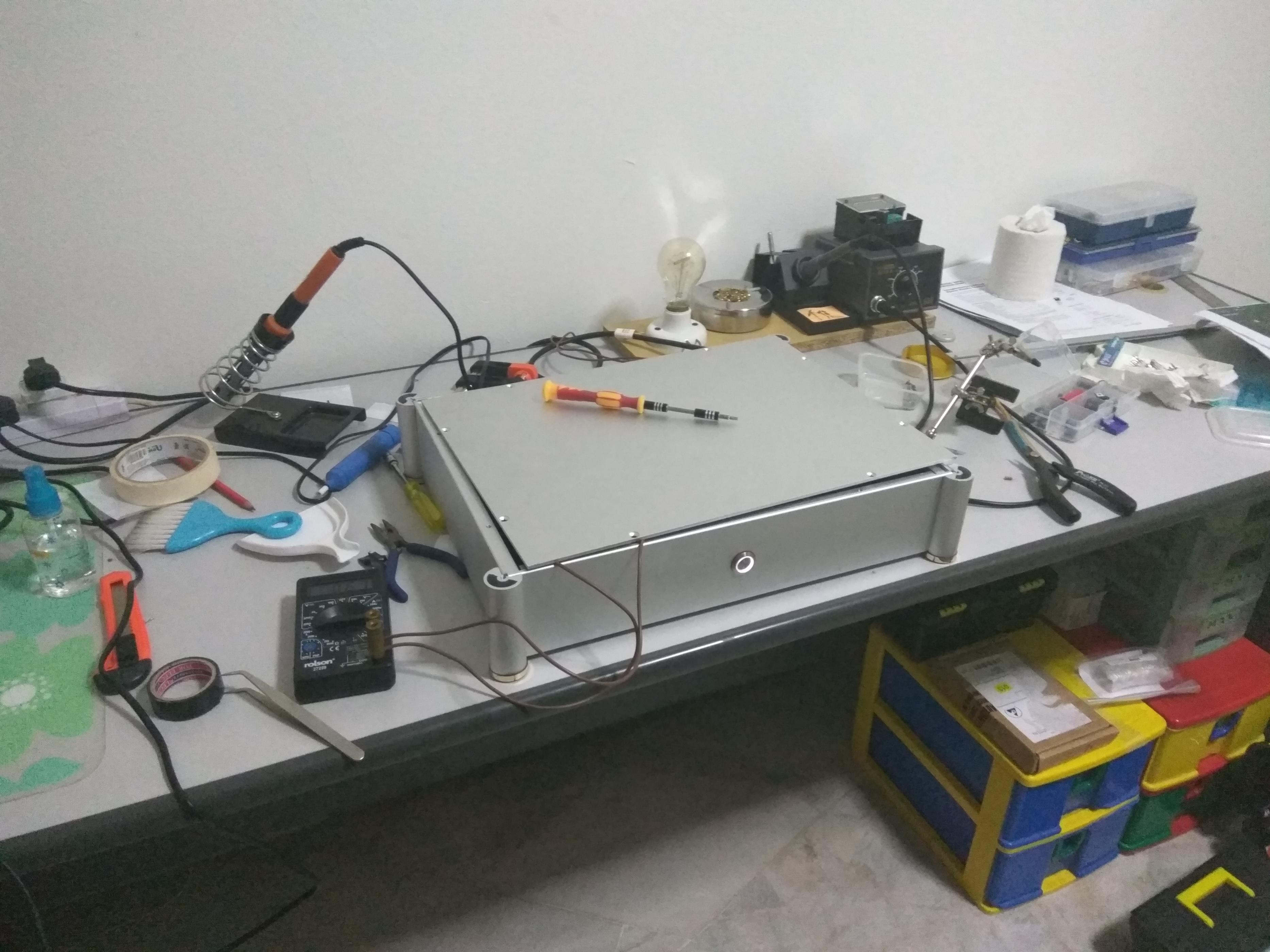

I've been reading through the thread and there has been numerous warnings against that.Could be handy to have some ventilation in that case.
For maybe other builds I'd say that would be a great feature on the case.

I notice you haven't fitted a heat spreader bar between the output transistors and the case, as discussed at the beginning of the NAP200 posts in this thread. Sure, we see other build pics of the kits without one too, since it makes construction easier and cheaper. The amplifier will probably work OK without one at modest power but don't try to push the amplifier anywhere near the original design's maximum (200W/4R) power rating. You might be in for a nasty surprise and sooner than you think, in hot weather.
I haven't been pushing them at all with my pre volume knob at around 9-10 o'clock. The top of the case gets slightly warm and the bottom feels warmer by a bit after a few hours listening.I notice you haven't fitted a heat spreader bar between the output transistors and the case, as discussed at the beginning of the NAP200 posts in this thread. Sure, we see other build pics of the kits without one too, since it makes construction easier and cheaper. The amplifier will probably work OK without one at modest power but don't try to push the amplifier anywhere near the original design's maximum (200W/4R) power rating. You might be in for a nasty surprise and sooner than you think, in hot weather.
I've been trying to source some heat spreaders around here but aluminum shops don't take small orders. Some hardware stores do carry aluminum profiles and bits n pieces but none are the correct shape.
