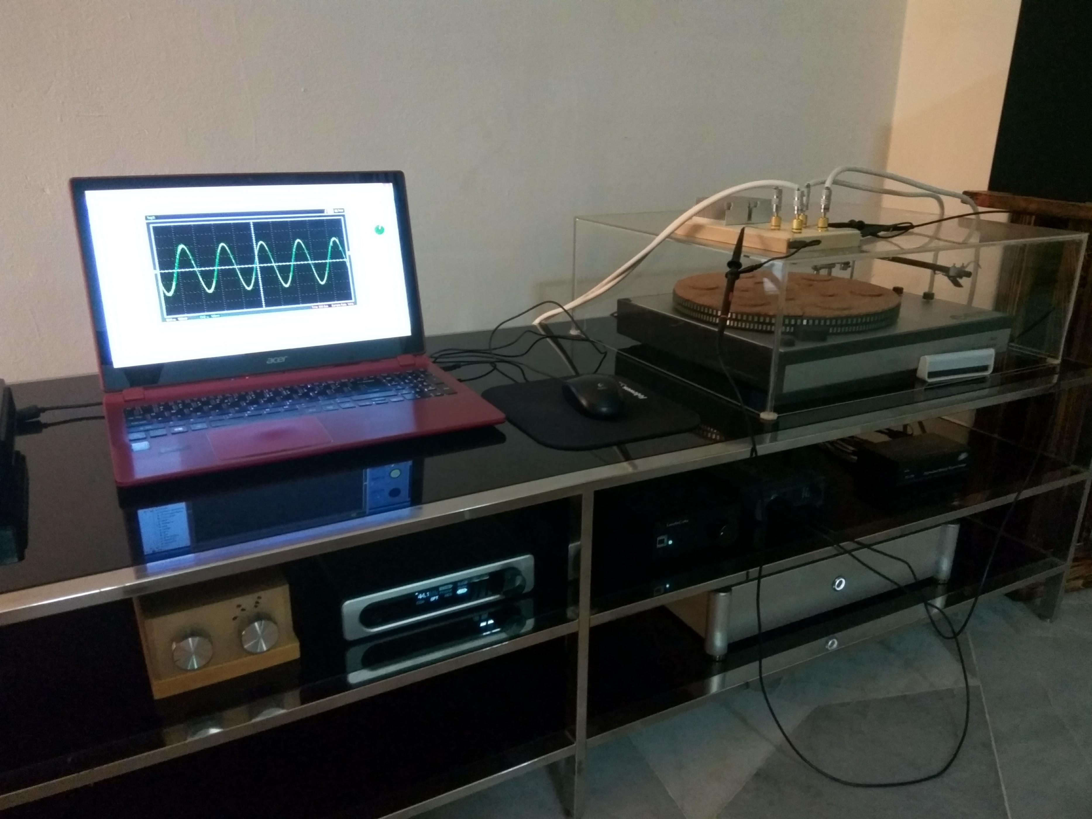

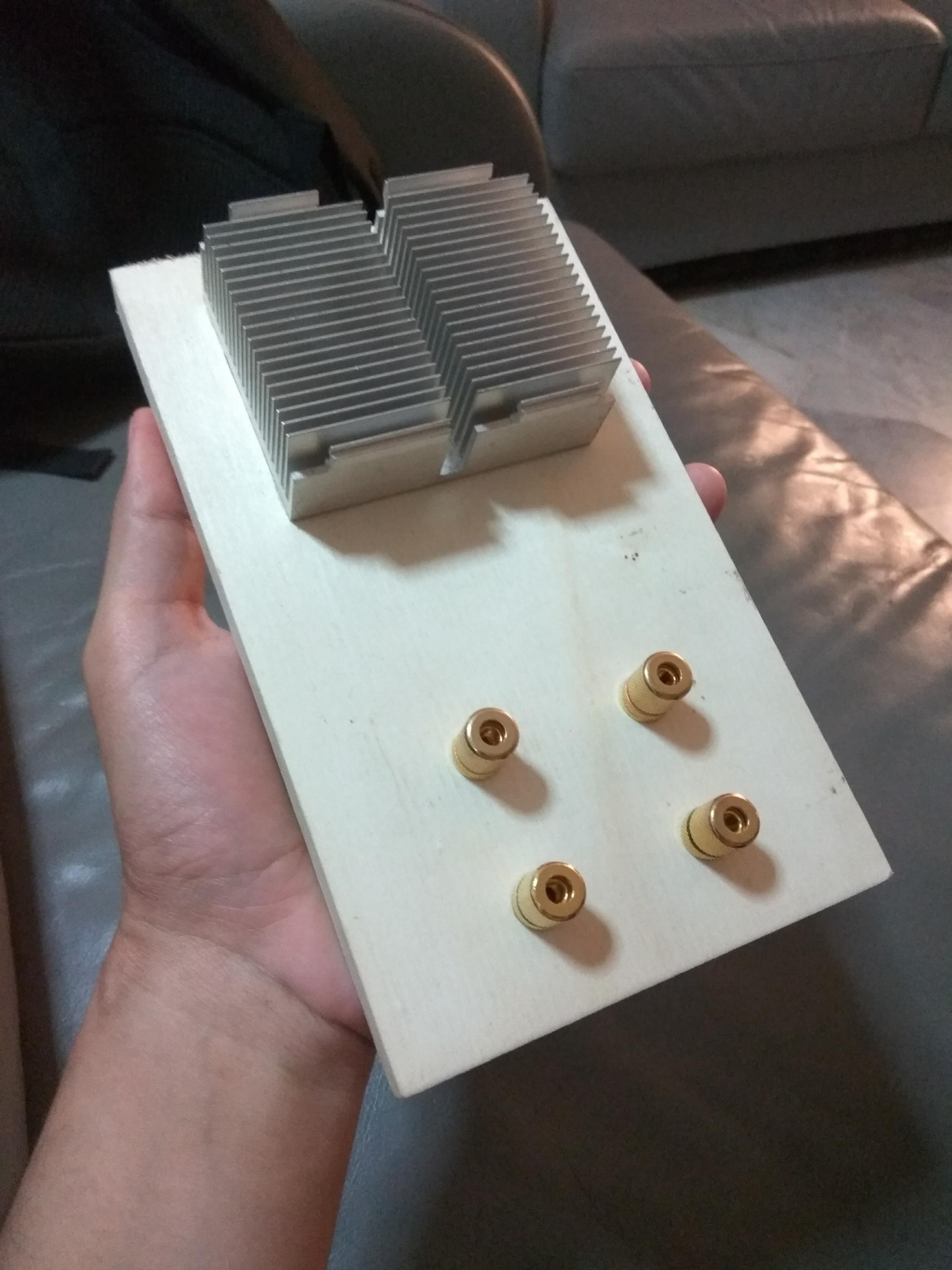

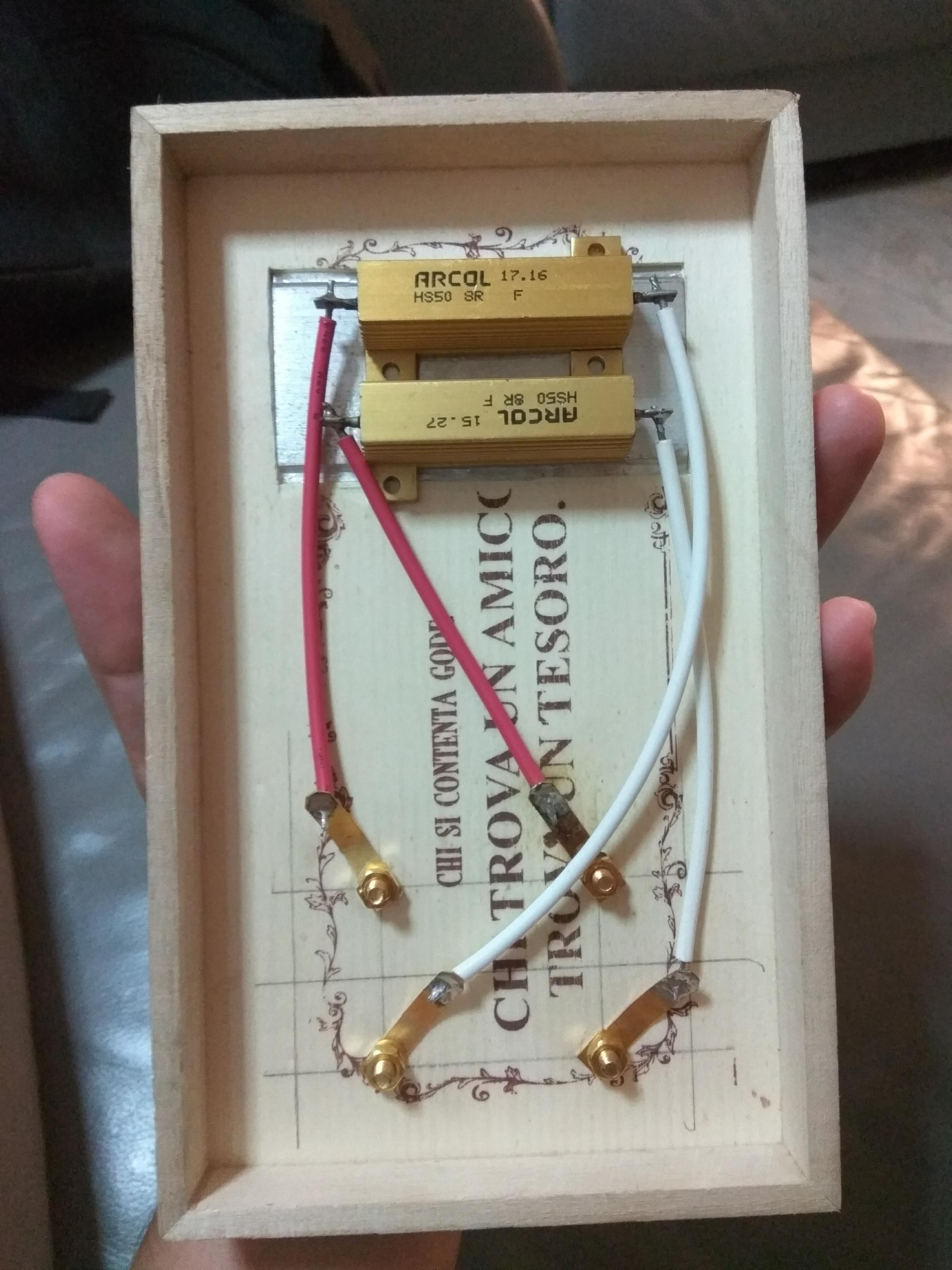

Anyway, I made a dummy load the past day and today managed to hook it up to the amp and my USB scope.
When I turn up the preamp volume the amp starts to make a ringing sound. I wouldn't say its a humming sound because its rather high pitched. Here's a google drive link for the recording.

Scope shows everything fine. No distortions.

The last time I heard a high pitched squeal from an amp it was oscillating at several 10s of MHz. The power transistors made the noise. But if your scope doesn't show anything...
What's the bandwidth of your scope?
Is the squeal the same frequency as the test tone? If so it may be ok if it is just due to very high currents. The 14s delay is curious - sounds like a thermal timescale. What's your dummy load? Are you sure it isn't the load that is squealing?

1) My scope is the fairly basic Hantek 6022BE. It has a bandwidth of 20MHz. Nothing shows on my screen except for the test signal.The last time I heard a high pitched squeal from an amp it was oscillating at several 10s of MHz. The power transistors made the noise. But if your scope doesn't show anything...

4) My dummy load is a pair of 8ohm 50W resistors mounted on a CPU heatsink. The load isn't making noise, I placed it on top of the rack while the amp is at the bottom tier.
I'm gonna need to get a higher rating load resistor or at least bigger heatsink with fan because I've just tested it out again and the heatsink got hot. Also I know I've mentioned it a few times the amp case feels only warm to the touch? I lifted it up a bit and touched the bottom case at the output transistors and it was very hot. However with the whole aluminum case thing going on, I turned it off for like a few minutes and the temperature dropped very quickly. As usual Ian is right, I'm gonna need the spreader bar if I want to run it loud.

So for those who are interested, here's some square and sine waves I got. It looks pretty grungy but I believe that's the laptop USB contaminating. It looks like that with no inputs and from its own square wave generator as you can see from the last image.
Imgur: The most awesome images on the Internet
Input was from Matrix Mini-i DAC, signals were generated from Online Tone Generator - Free, Simple and Easy to Use.
Your 20 MHz bandwidth 'scope should detect amplifier oscillation from most bipolar transistor deigns, since it will likely not be much higher than 400 kHz but I would not depend on that. Zoom in on the trace by using a shorter (X) scale period and see if the trace appears thick and so check that there is not much more going on than a simple sinewave.
Your dummy load sure hasn't got enough heatsinking for more than a very short period. Without the designated fan and ducting for those CPU coolers, the efficiency will be very low - as in useless. You don't seem to have mounted the resistors yet so use a good quality heatsink compound, to get optimum thermal transfer. With a dummy load, an insulating type is not essential and conductive, silver bearing types will be OK, as long as you can still fasten the resistor down absolutely flat on the sink over its full contact area. Arcol resistors should be fine for insulation from the outer metal cladding. Otherwise, check that they really are still isolated from the heatsink when mounted, only because I once found a couple of cheapo, unbranded types that were not.
If you think about it, each amplifier in the NAP200 is good for 100W/4 ohms and your heatsink would need to be rated at 0.3°C/W to keep that amount of dissipation below finger-scorching temperature. That's a pretty big and expensive heatsink for DIYs to buy so a properly fitted fan forced sink is a fair option. I happened to find a short length of heavy, industrial heatsink extrusion which I measured at ~0.2°C/W for my dummy load and that takes quite a few minutes to get hot with almost 200W disspation from 2 X 100W metalclad resistors, similar type to yours.

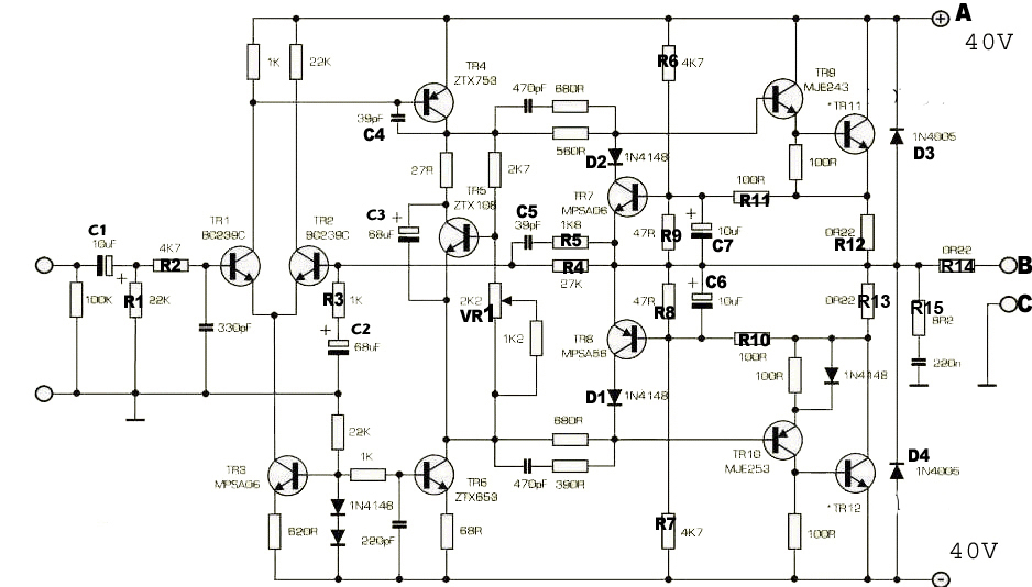

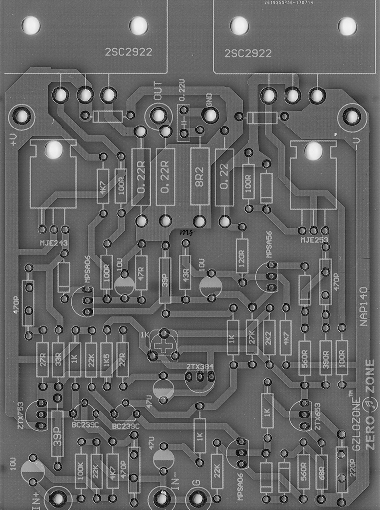

I have a pair of NAP140 clone boards that I have just assembled (appear to be closer to the NAP250 schematic though).
I have tried to carry out the initial setup with the power trannies removed and using a 32v Lab supply, but I can't get it working.
I am getting in the region of 1.2v across R12 & R13. Variable resistor has no effect.
Setup: Using a basic lab supply, I have V+ connected to +32V, V- connected to 0v. This PSU has current limiting and soft start.
Am I supposed to connect the Input GND and Output GND together at this time?
Am I correct in thinking that these GND points are not to be connected to V-?

Here is the PCB and the schematic that matches the closest.
You need symmetrical PSU (like +32V, 0V, and -32V) to properly turn the amp on.
Thanks but I think the NAP boards are supposed to run on 30-40VDC. (The schematic is a bit misleading and marked 40v top and bottom).
If I put 64VDC on the rails (+32V : -32V), I think I might let the smoke out..I read posts by another person who smoked their boards with 44VDC.
Most builders have used an AC transformer then bridge rectified to around 40ish VDC, but I've heard others mention that they used a lab supply also.
I figured DC at the rails is DC whether it comes from a transformer or a lab supply (for initial test purposes anyway).
The supply voltages necessary for the original NAP series amplifiers varies from +34/0/-34VDC to +40/0/-40VDC. The limitation with the larger models is mainly due to voltage ratings of the VAS transistors, TR4 and TR6 as shown on your post of Neil McBride's schematic. These are important for Naim type sound quality. Though there's very little difference between the models, that is actually the common, generic NAP design with components as per the early NAP250 design, which used fully regulated supplies of +/- 40V to enable the max. power rating of 125W/channel /4 ohms.
I doubt your build will be using the original (genuine) transistors marked on the schematic - maybe not the same as marked on the PCB either, so check any substitutes and odd-looking brand marks out thoroughly - even those with the same part numbers can have different pinouts from different manufacturers and this spells big trouble.
Most people having difficulty getting their kits to work, come unstuck by using substitute small signal transistors which often have different pinouts to the board layout. In the past, that was caused by the kit suppliers' choice of substitutes with no information or explanation. Now, newcomers to DIY also mess about with their own ideas of what they think are better parts right from the outset and of course, voltages go haywire and often burn with the wrong pinout or wrongly fitted parts.
BTW - The power supply must be connected with the common 0V to ground if you expect it to work properly. The 0V connection is to the input ground symbol shown at lower left side of the schematic. PCBs sometimes have 2 holes there, one for signal ground and the other is linked to the PSU star earth. I suspect the external PS will prove noisy (a hum) using a direct connection without a proper chassis and star earthing (which can be followed from the details of setting up Avondale Audio's NCC200 modules - Google it.
