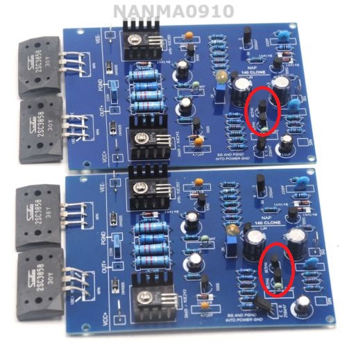

On the point of testing everything thoroughly, if anyone bothers to read back to look at just a few builds in this thread for themselves, most problems earlier, were found to be with assembly errors. Apart from confused colour codes of resistors, the biggest problem was understanding that TO92 transistor pinouts are not standard and when substitutes or fakes are supplied in kits, errors occur. For example, the original ZTX653/753 VAS transitors have a different pinout to common substitutes 2SD667/B647. Some PCBs were modified to suit the subs and marked appropriately but many were not and kit sellers did not provide advice to this effect. The same problem occurred when 2SC, 2SA small signal transistor types were substituted for BC550, BC384 and 2N types. Chaos ensued rather than a bit of caution, common sense and looking up datasheets.
Certainly, if you have rail voltage at the output, you either have a shorted output transistor, shorted connections or wrong transistor types fitted to the board you are using. Did you also check for solder splashes and the isolation between transistor collectors and the heatsink? Remember, not all boards are the same and there are dozens of different clones out there. So check it twice, 3 times or more by testing transistors to ensure that all component leads are correctly identified and fitted - it only takes one blunder to ruin the whole project :crying:

I recently bought a zerozone nap140 pcb and I have a question about DC drift at the output.
I used bd139/140 instead of ZTX, bc546b for input, bd139/140 for driver and 2n3055 for power transistor. Protection part left out.
Fired up with 2x30VDC, input shorted, 8 ohm resistor load. Measeured the 0.22R resistor and set the bias to be 3mV, so around 14mA.
The problem is the output DC. It starts at around 6-8mV, and slowly (1 min) goes up to 15mV. As soon as I touch the VAS bd140, the voltage drops to 12mV (in 1 second). Strangely if I touch the VAS bd139, nothing happens. If I also touch the input transistors top, it drops more back to around 10mV. They don't seem hot, but then why would they drop? Is there a way to decrease the DC and also reduce the heat drift?
Does it drifts so much for others also? I'm afraid if I put it in a box the heat may go up and the drift increases lot more.
Have you boxed up the unit when you're measuring the output DC? Are the transistors matched?

You should never power up this board with the power transistors!
First power-up should be with the drivers only. The circuit works fine on drivers only and output floating (no load)
That has several benefits:
1. If something burns, it will be cheap.
2. If nothing burns, but still the circuit is not working, you'll have generally more time to troubleshoot and measure before it fails permanently... In the worst case, something cheap will overheat and burn.
3. You can verify the whole circuit works - check output offset, check bias spreader work by turning the trimmer and measuring the voltage change between the driver transistors bases.
4. Leave the bias at something like 2V between base-to-base of the drivers. Then, add the power transistors and turn the trimmer up (by now you'll now what is the up direction) until current flows in the output resistors (5-7mV across). That's it!
