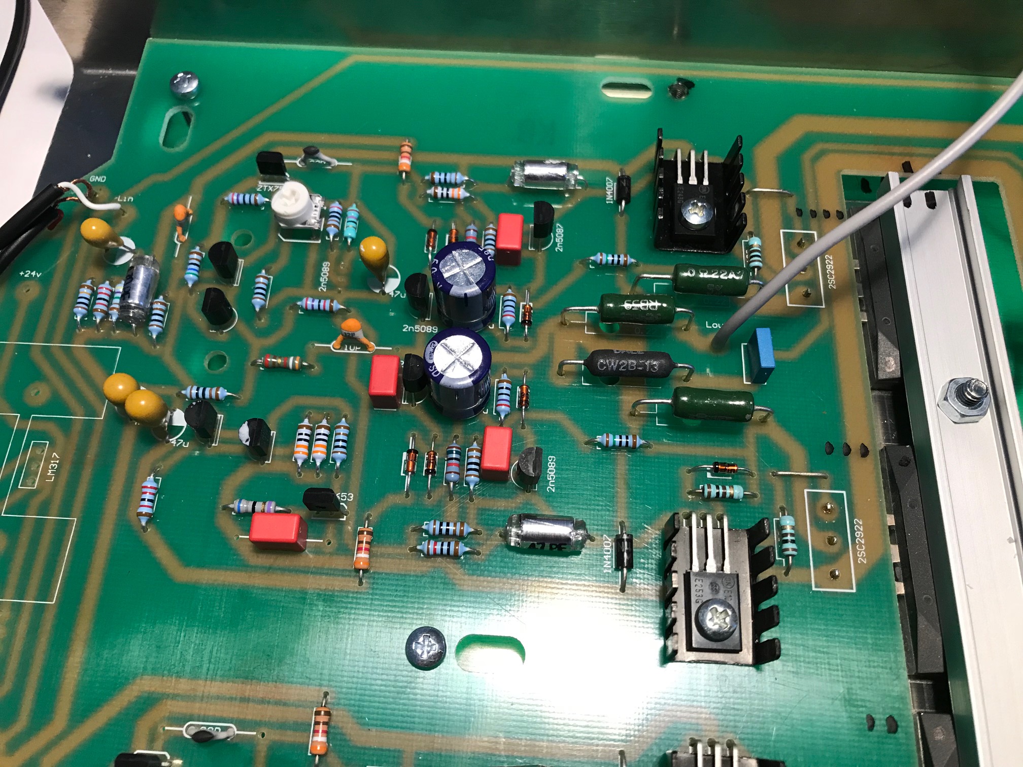

If you are going to have C10 you'd better have C11 too. But based on your circuit board photo I wouldn't add either. Just make sure you are using good quality PSU caps and your wire runs to the PCB are nice and tight.Is C11 a bad idea?

A couple of easy changes that should make it sound better:
Use a polystyrene 56pF cap (next to Q4) instead of a ceramic.
Use a bipolar cap for C3 (or at least put the existing cap around the right way: + to gnd).
NOTE: Almost all the Naim power amp schematics I've seen on the web continue to have the feedback dc blocking cap the wrong way around. I have no idea who started this mistake but it seems to keep on going. Including in the schematics just pasted here. The +'ve terminal should go to gnd because the LTP base voltages will be slightly negative.
It's very tidy. Note they have put the main PSU caps on the power amp board with the star ground there. They haven't put smoothing caps elsewhere in the case with a second set of caps on the board which is what some of these kits encourage.i love the nait 3 !
I've not tried a polystyrene cap, but I have used both silva-mica and npo ceramic. The ceramic performs superbly
Don't run decoupling capacitor leads to a remote PSU Zero Volts.I've been looking at that decoupling mod for the Nap140 too and have gotten me some low ESR Panasonics rated to 50v to test.
Is C11 a bad idea?
(The schematic is from the Acoustica mod list).
Join the two decoupling caps together with the shortest possible leads and take the Speaker Return to that junction. Take the Amplifier Output Zobel to this same junction.
Finally run a wire from this junction back to the PSU Zero Volts inside the twisted triplet that brings power to the PCB.
