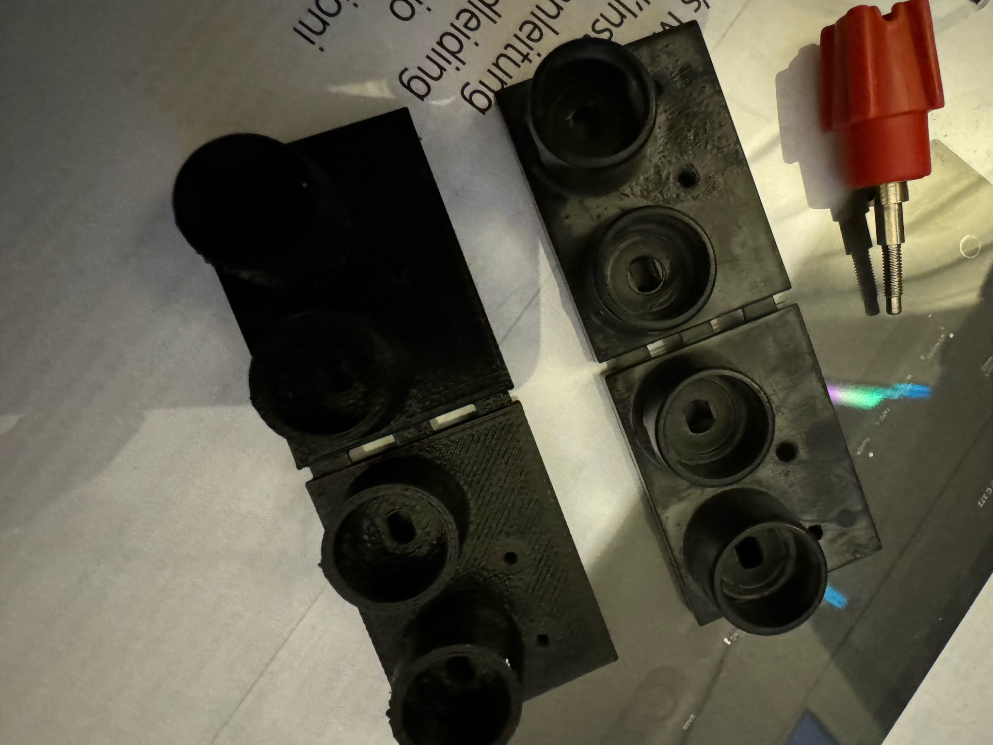

I am just starting a rebuild and repair of one of these myself… was thinking of starting a thread on my journey and then found this one… I’m basically doing a complete tear down and rebuild, replacing all electrolytic caps and refinishing the case etc. today I started working on the speaker terminals, which were a bit damaged, so I drew up a replacement and printed a quick test print to check the dimensions… now that they fit, I’ll send it out for SLS printing of the replacement part and move onto the next job… 🙂 Not sure how this forum works yet, so if you want me to move this to a separate thread, just let me know. 🙂

@madis64 I’m trying to keep the amplifier as original as possible with respect to the case etc. all the ones from eBay that I found have different centre distances or would require some other modification. This drawing took me about 45 minutes and then the test print another 45 minutes and now I’ll get it SLS printed for probably about $20, so it’s just more economical and interesting to me to do it this way… SLS gives you an almost perfect finish and I’ll cerakote them afterwards if the finish isn’t exactly what I want… just my thoughts for now… 🙂
Ok, if this is the goal then I understand.
I was meaning more like those:
https://speaker-terminal.com/en/produkt-kategorie/nad/
- should provide the ability to use speaker cables with banana connectors.
(some years ago these were also sold on eBay, do not kow the current state).
Reactions: Stepping3D
@madis64 those terminals you linked to look great! I’ll definitely keep them in mind for future projects, I hadn’t seen them before…
The SLS printer I’m working with uses Nylon12 powder which is one of the more rigid types… the surface finish is really nice, and you can barely tell the difference between sintered or injection moulded, except the SLS parts have a more textured finish. Cerakote is great for next level finish, because you can directly apply it to the SLS parts without much prep and then it bakes on and gives you a hard ceramic finish. They use it on firearms and race car parts. With plastic you generally coat it and then bake it at around 60c for two hours, depending on the exact version of coating you’re using…
