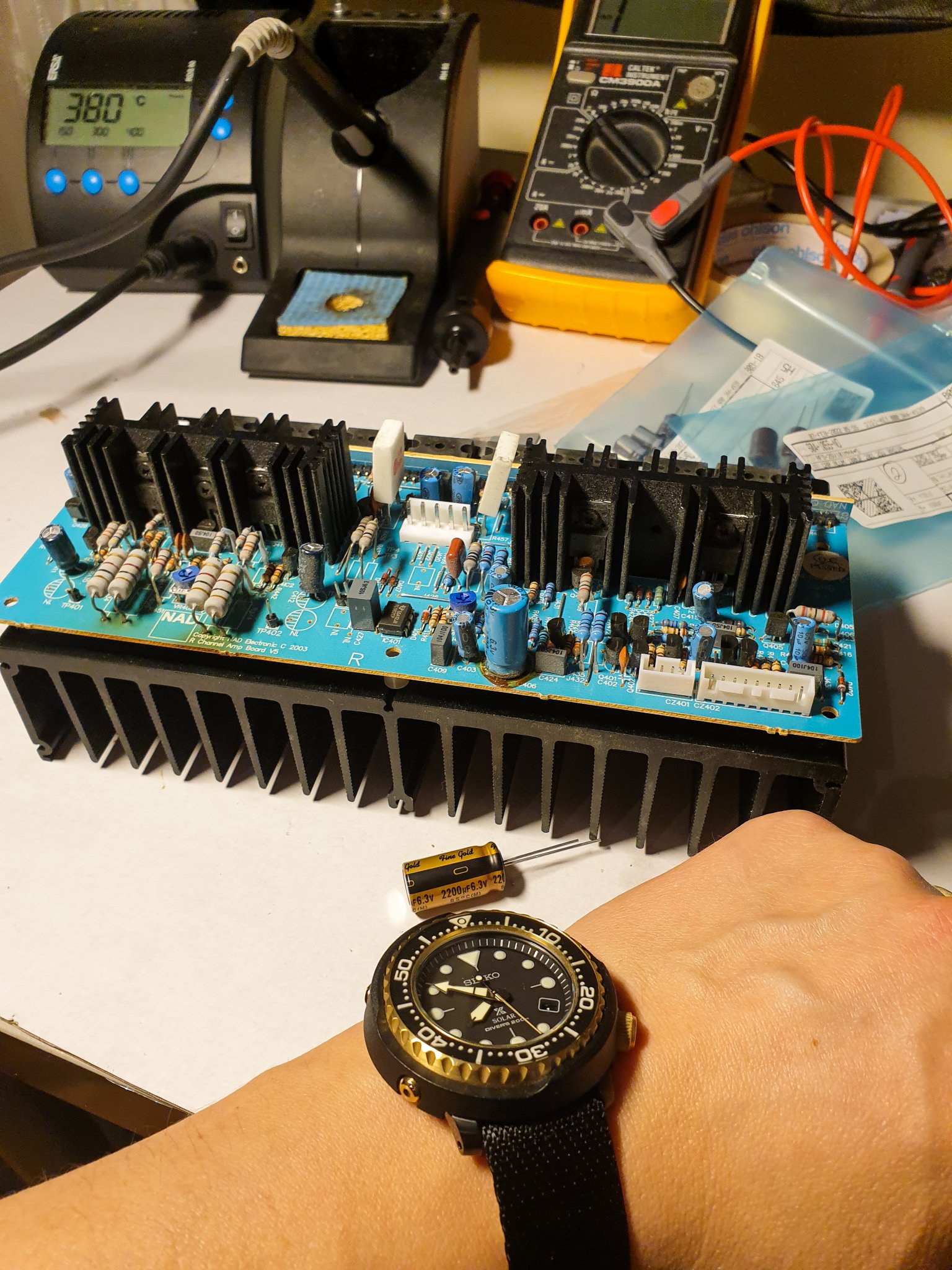

Now all the caps on the right amp are changed.
Reconnected it late last night to try it out, but when I started the amplifier it died in a fraction of a second. Tried to disconnect the right amp but the amplifier is still dead.
No idea what I did wrong and it was too late to look for the problem.
Didn't take that many pictures this time due to a bit too eager. Big no-no...
Let's start with the mistakes in text though.

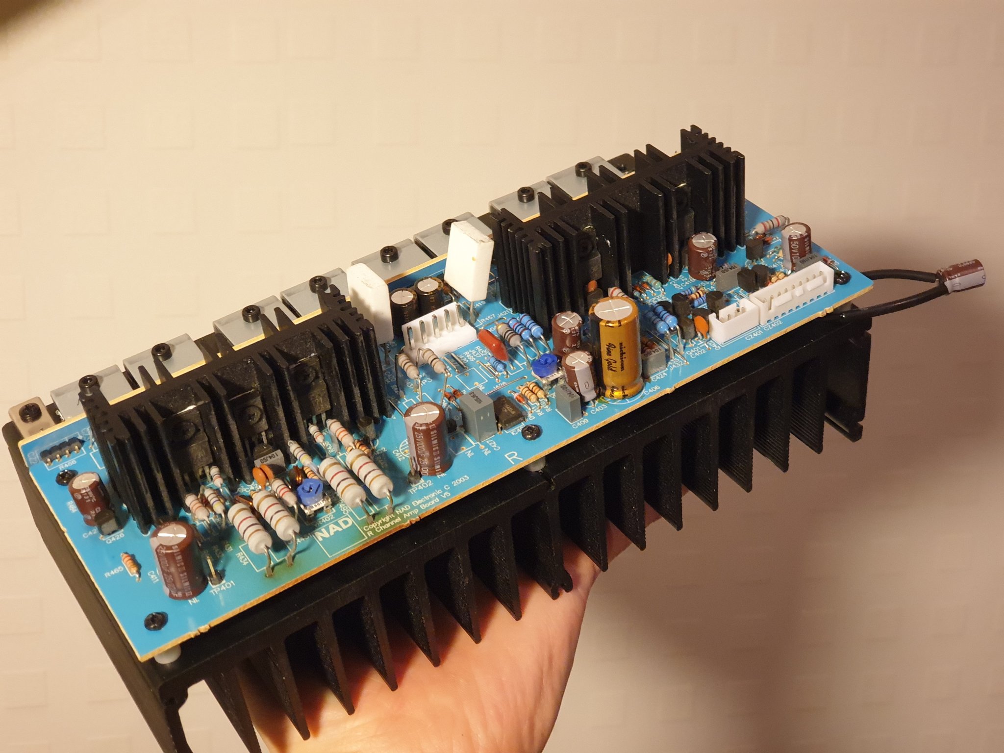

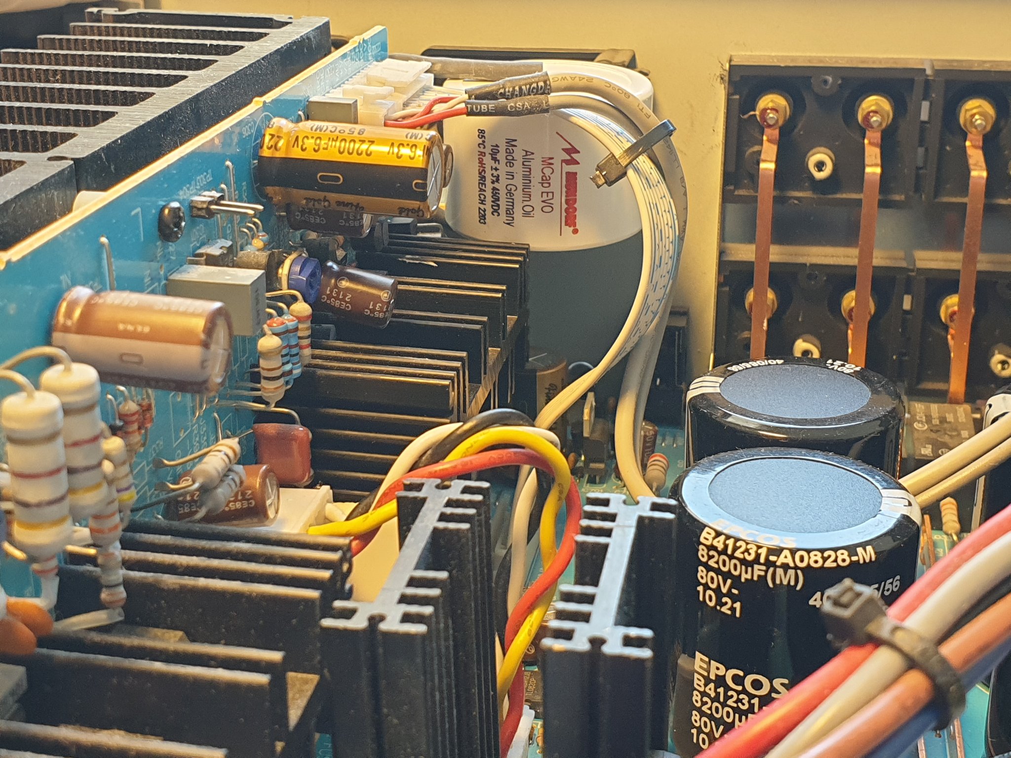

The caps I ordered for C422/423 had to thick leads, so I had to drill the holes a bit bigger (0,5 mm to 0,8 mm), no biggie.
The caps for C411/412 should have been rated to 105C. Had noted that and written it in the list, but I still ordered 85C somehow. Those are the black ones to the left.
There are mountig holes for four caps, so I changed to the outer holes to get a bit more air arround them.
For the coupling cap I soldered leads on the back of the card. By doing this I can fit any cap I want, and I can change it by just popin' the hood. Is Mundorf EVO a good choice if I want to keep it under 15€/cap?

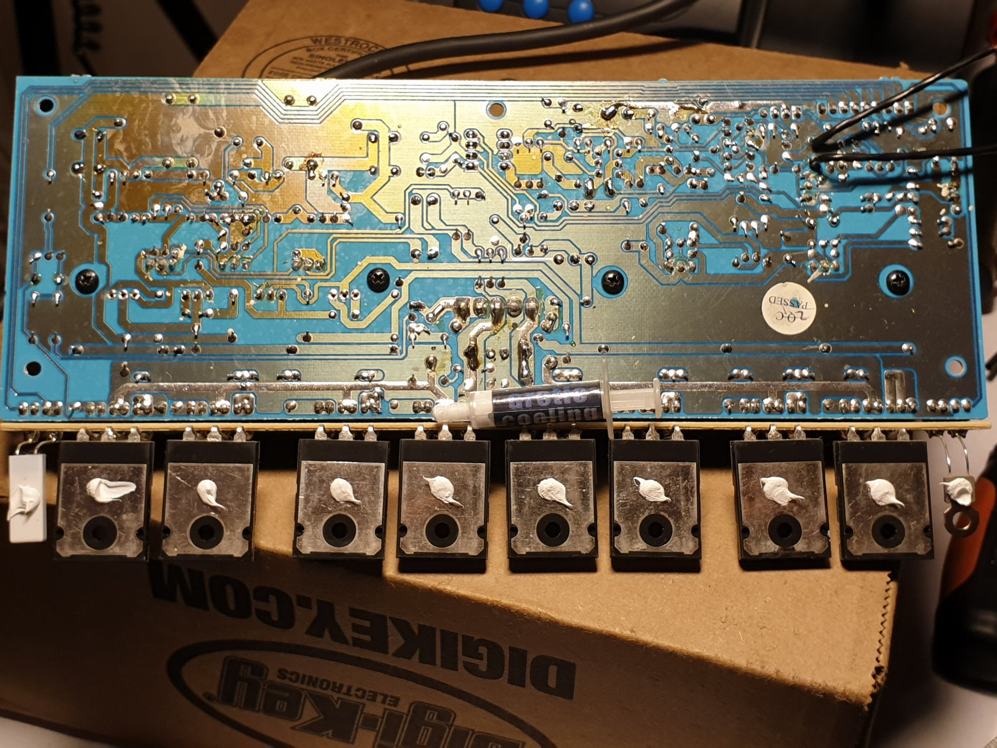

Thermal paste, don't forget that!
I used some old tube that I rejected for the CPU/GPU years ago. Still better than the pads for sure.
And here it is!

No?Did you only use thermal paste? No insulation to heatsink?
I thought the mosfets should not have any electric connection to the cooling plate. Do I need to isolate them in some way?

As the back of the transistors are metal they should be electrically insulated as the heatsink goes to chassis ground.
Well, then we found the problem!As the back of the transistors are metal they should be electrically insulated as the heatsink goes to chassis ground.

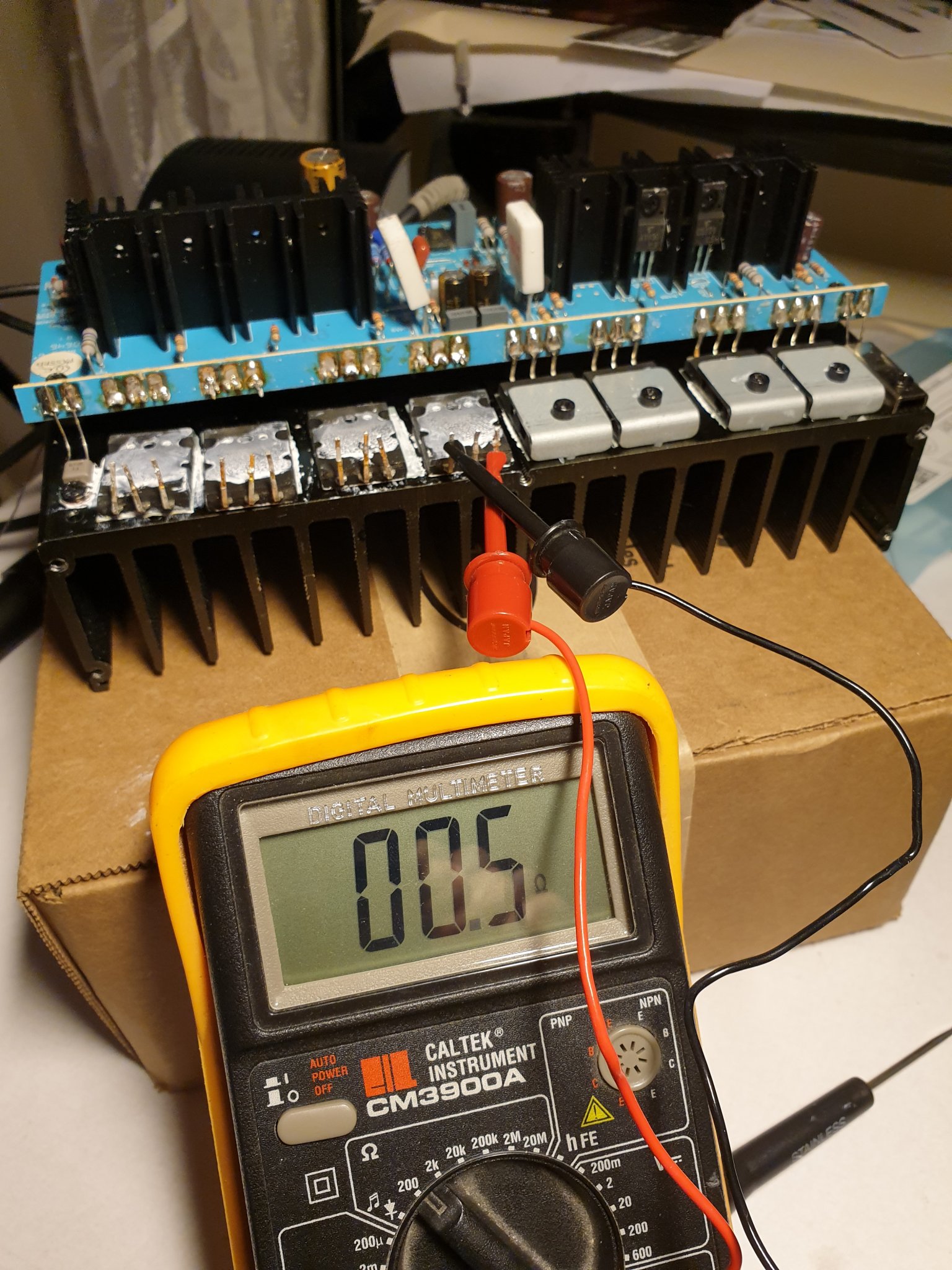

Looks like center pin (C) on both 2SA1943 and 2SC5200 may have been put to chassis ground. Maybe something blew up? Comes straight from +/- 64 volt rail.
Maybe.Looks like center pin (C) on both 2SA1943 and 2SC5200 may have been put to chassis ground. Maybe something blew up? Comes straight from +/- 64 volt rail.
Shouldn't have been that great of a connection since the thermal paste is non conductive, but it might have been enough...

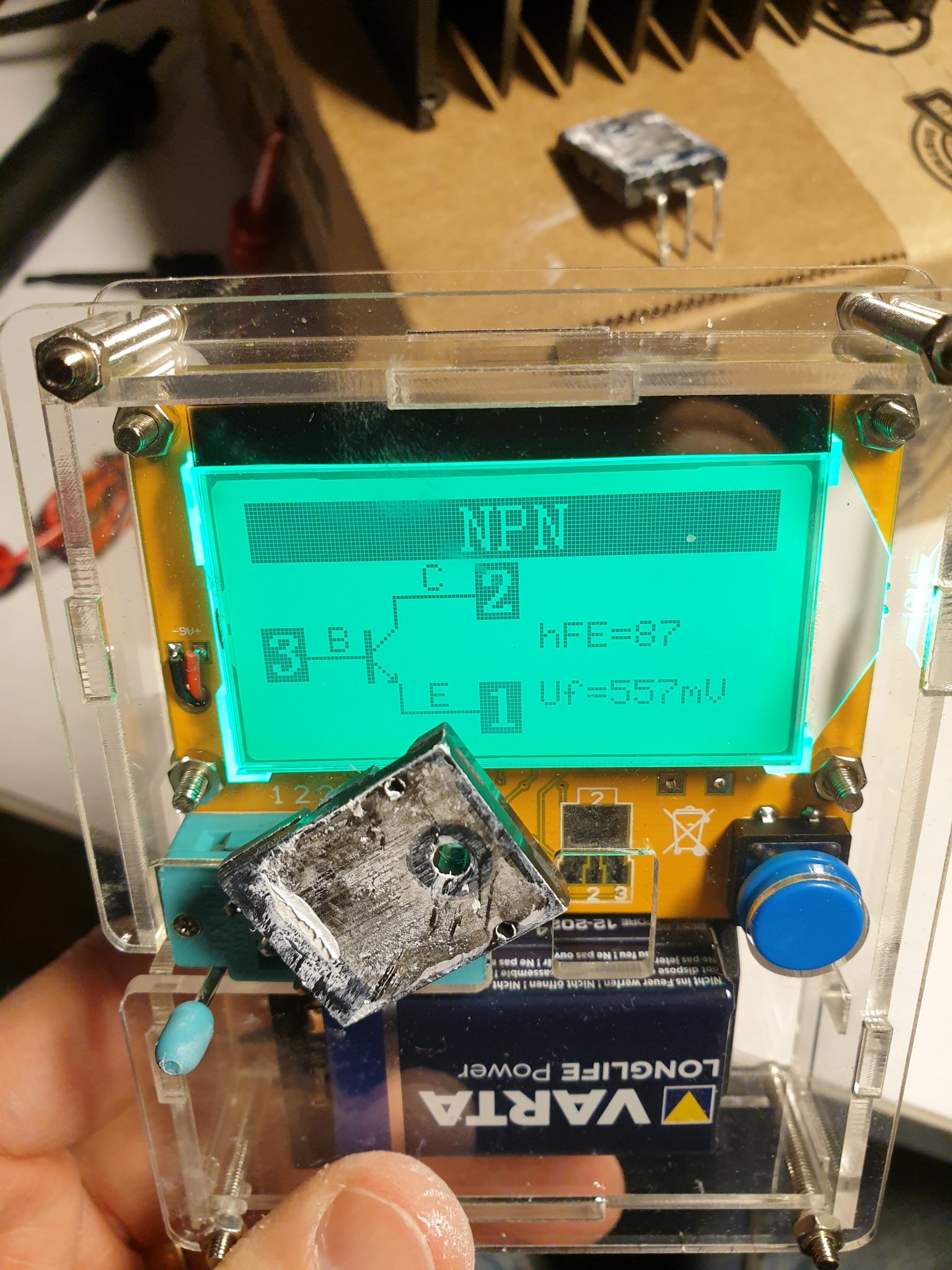

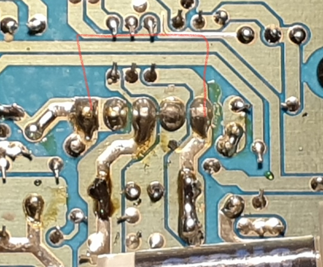

Found out that there is a short between pin 1/2 (VOP R) and 5 (-64V) in the power connector.
Not sure where though.
Is the short towards the amp board or with the amp board disconnected?
If on the amp board it may look like shorted output transistor(s) 2SC5200. Warning: Noob😉
With the board disconnected.Is the short towards the amp board or with the amp board disconnected?
If I can't find anything obvious, I can start with them.
You were right, one of them is shorted!Is the short towards the amp board or with the amp board disconnected?
With the 2SC5200's removed the resistance between pin 1 and 5 is 1k instead of 0,1.
The left amp with the transistors still in order has 480 ohm, so it sounds right.
When I meassure them, the others are like this.
Should be ok?
I'm back!
I checked all transistors and caps in contact with the short circuit but didn't find any more damaged components. Changed the shorted transistor and it powers up.

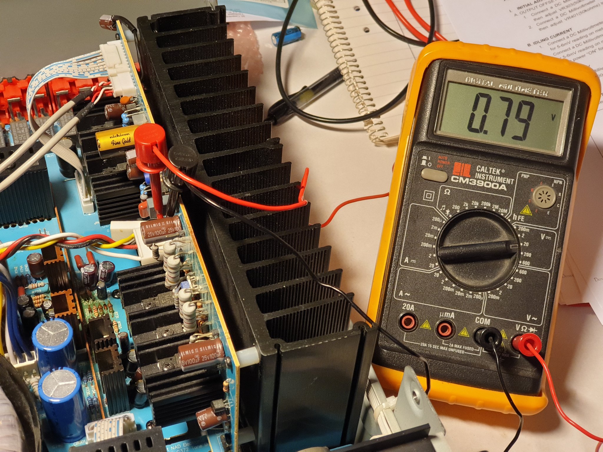

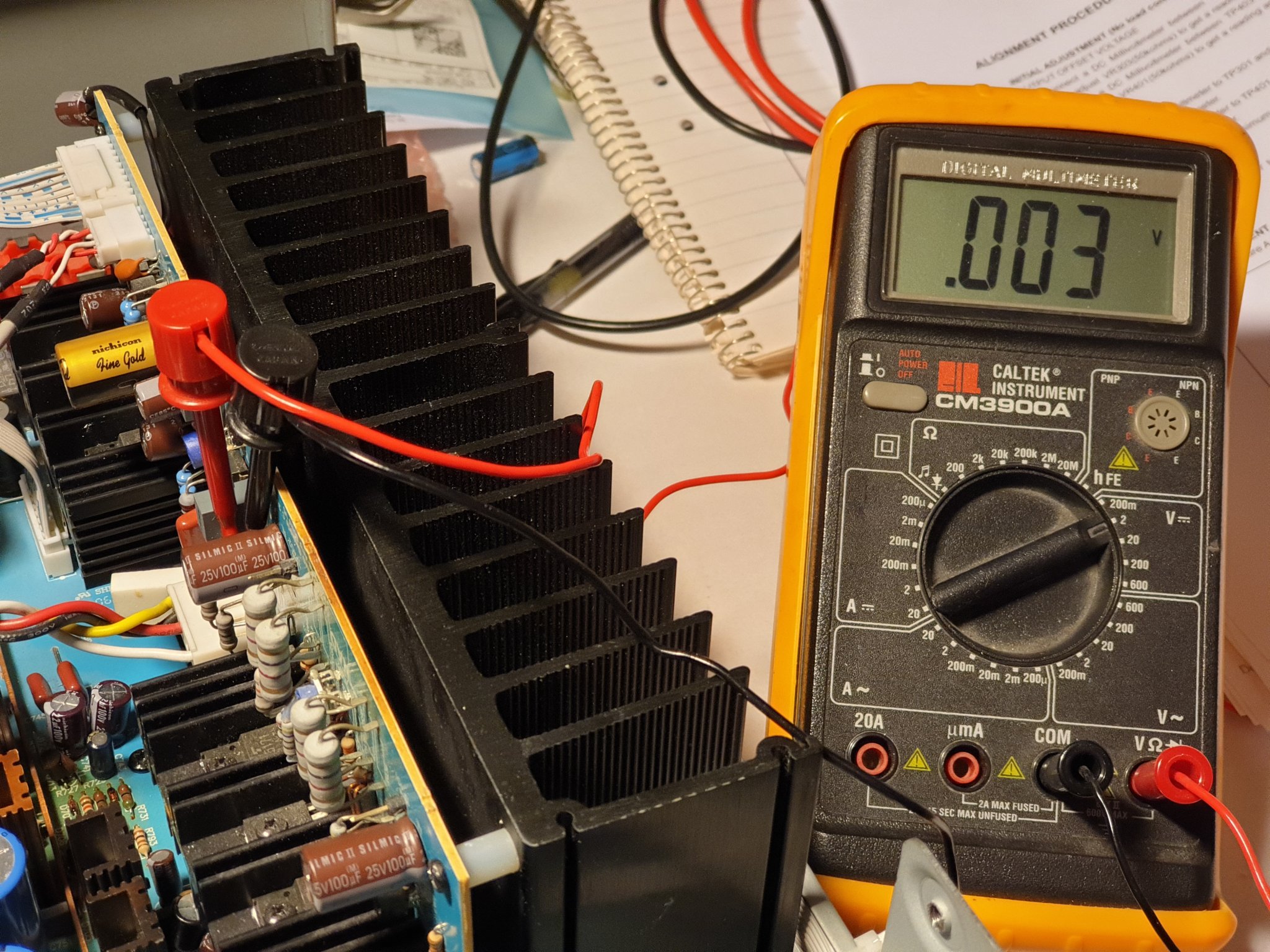

According to the manual the amp should be adjusted at start. The values was within specs right away (+-3V), but I got it a bit closer to 0V.

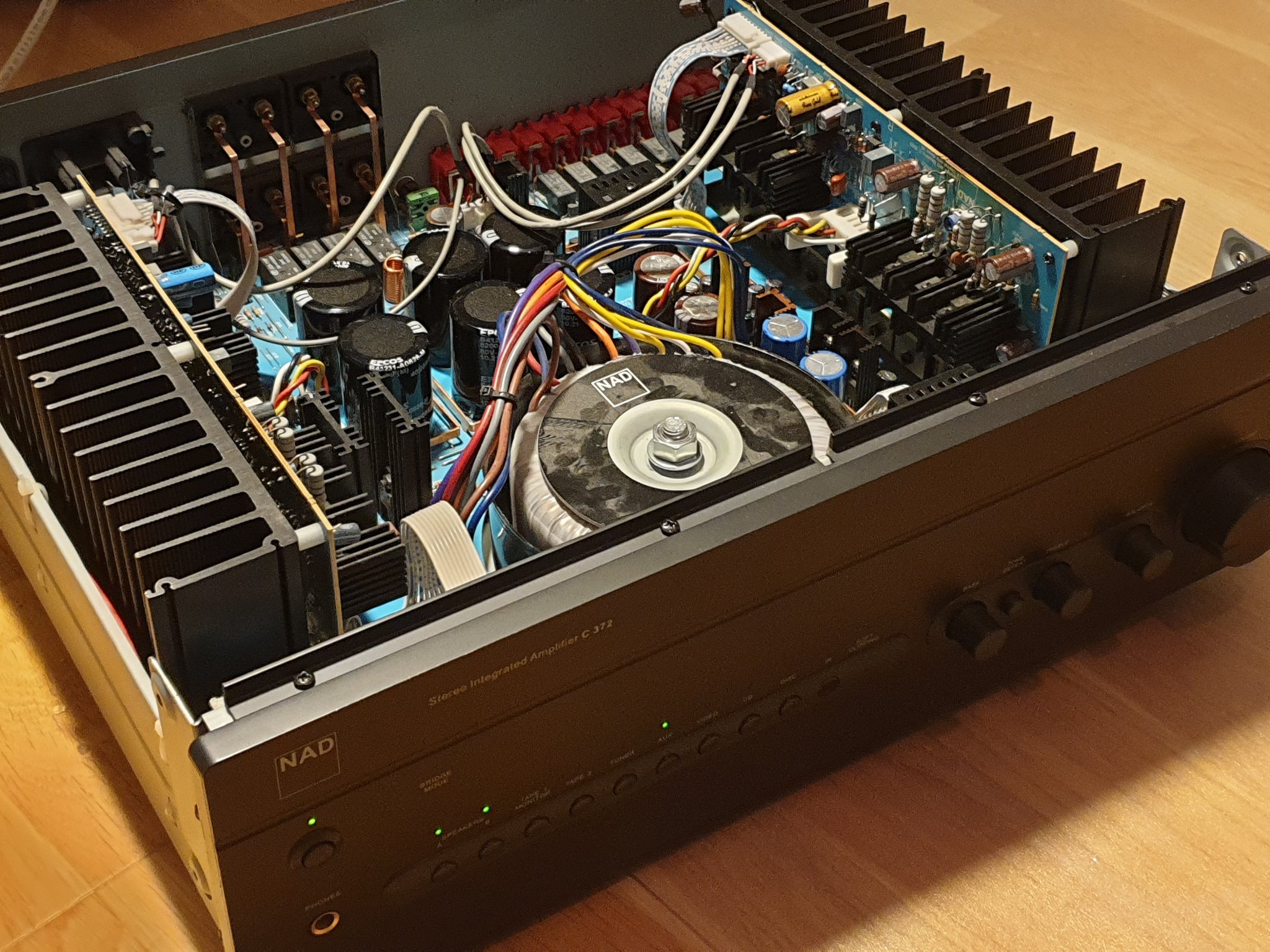

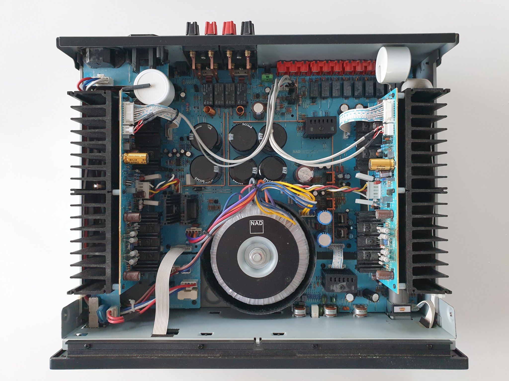

Finaly done!
Took a few weeks to get the Mundorf caps since they were out of stock.
Started to upgrade the home cinema instead while waiting so this got a bit extra delayed.
Started with the untouched left amp and did a full recap and installed the Mundorf so I could benchmark it against the right one with Elna coupling cap. What a difference!!
Now when I'm done with both, all that's left to do is get all documentation in order.
I'm so happy with the new sound and I'm pretty sure that it didn't sound this great when it was released.
Thanks again for all guidance!
Couldn't have done it without you guys!

Did you do the alignment procedures in the service manual? I'm finishing a rebuild of my c372 now. I have gotten through alignment A and B without issue, but attempting alignment C I'm measuring 70V between TP701 and TP702 instead of the 50-100mV specified and I can't imagine what I've possibly done wrong!Finaly done!
