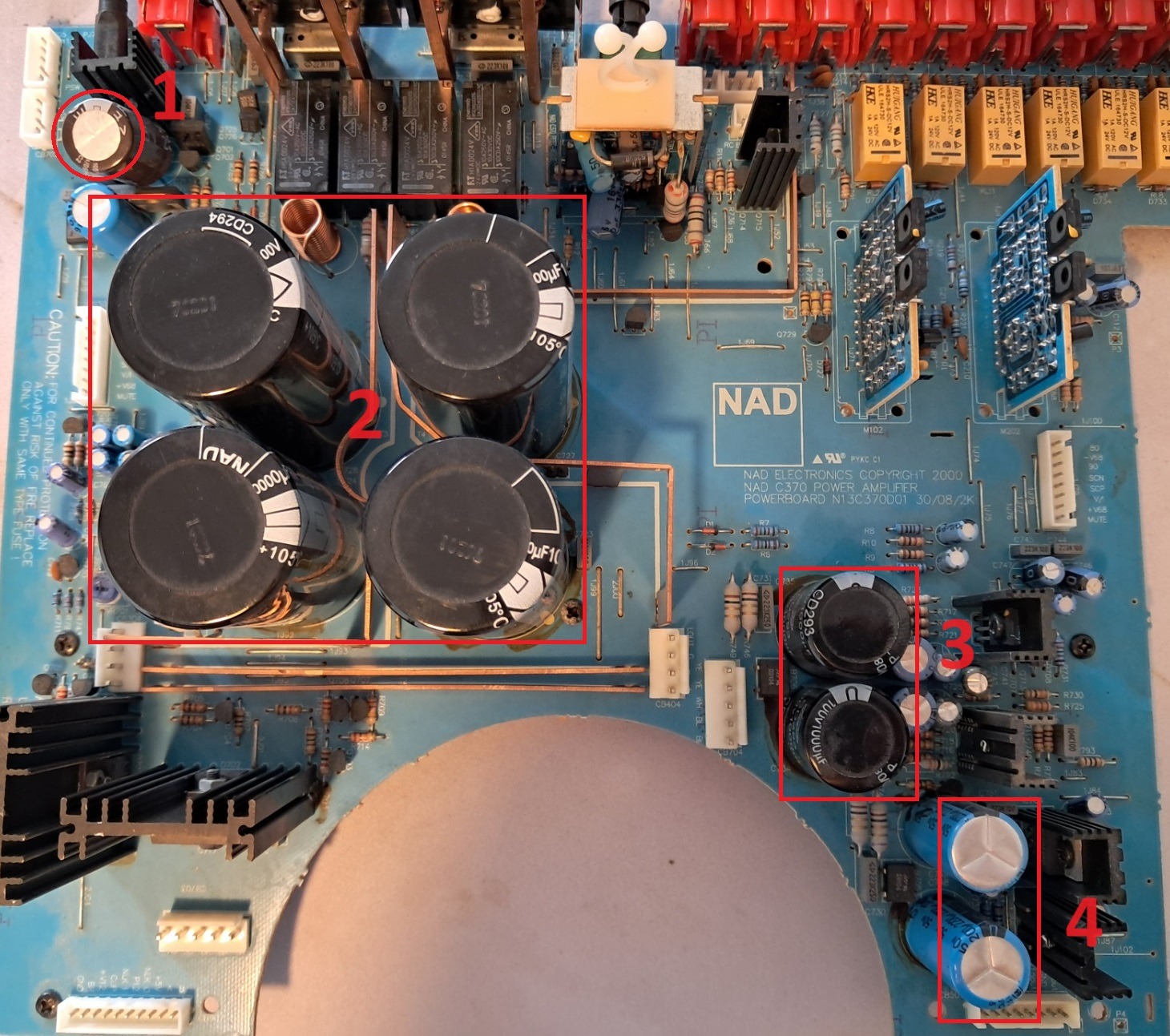

But... I have some questions I hope You can answer - but first some photos of the Main Board:
The caps in areas 1 and 2 were changed during the service.
I'm not sure about the caps in areas 3 and 4?

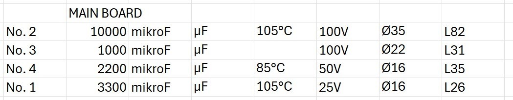

This is this values of the caps in the 4 areas:
Well anyway. Since all of the caps are 20+ years old, would You change all the caps (also those "new" 105°C caps)? I have no brownish areas on any of the board and it working as it should - except, I remember it to sound better than it does now.

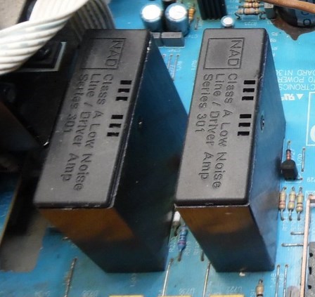

The two small vertical boards are the LineIn modules (there are two more like them on the Tone Control Board - the Pre-amp modules).
These vertical boards live inside these small black houses:
At first I thought it was some magic NAD components, but thanks to Quirkaudios site I learned the truth...
I'm thinking of letting them out of their house and give them some sort of cooling plate - BUT - is these houses for shilding? They are made of aluminium.

What makes you think it is underperforming?I feel like bringing this trusty old amp up to its former glory - and maybe beyond...
In other words - knowledge is light, ignorance is bliss, have you measured it in any way (RMAA, REW, ...)?
The capacitors in red quadrants on the photos would be the last ones I would replace...

OH... and Madis64 (or others in the know).
What is the brown stuff around the caps in the squares on the board? Glue or...?

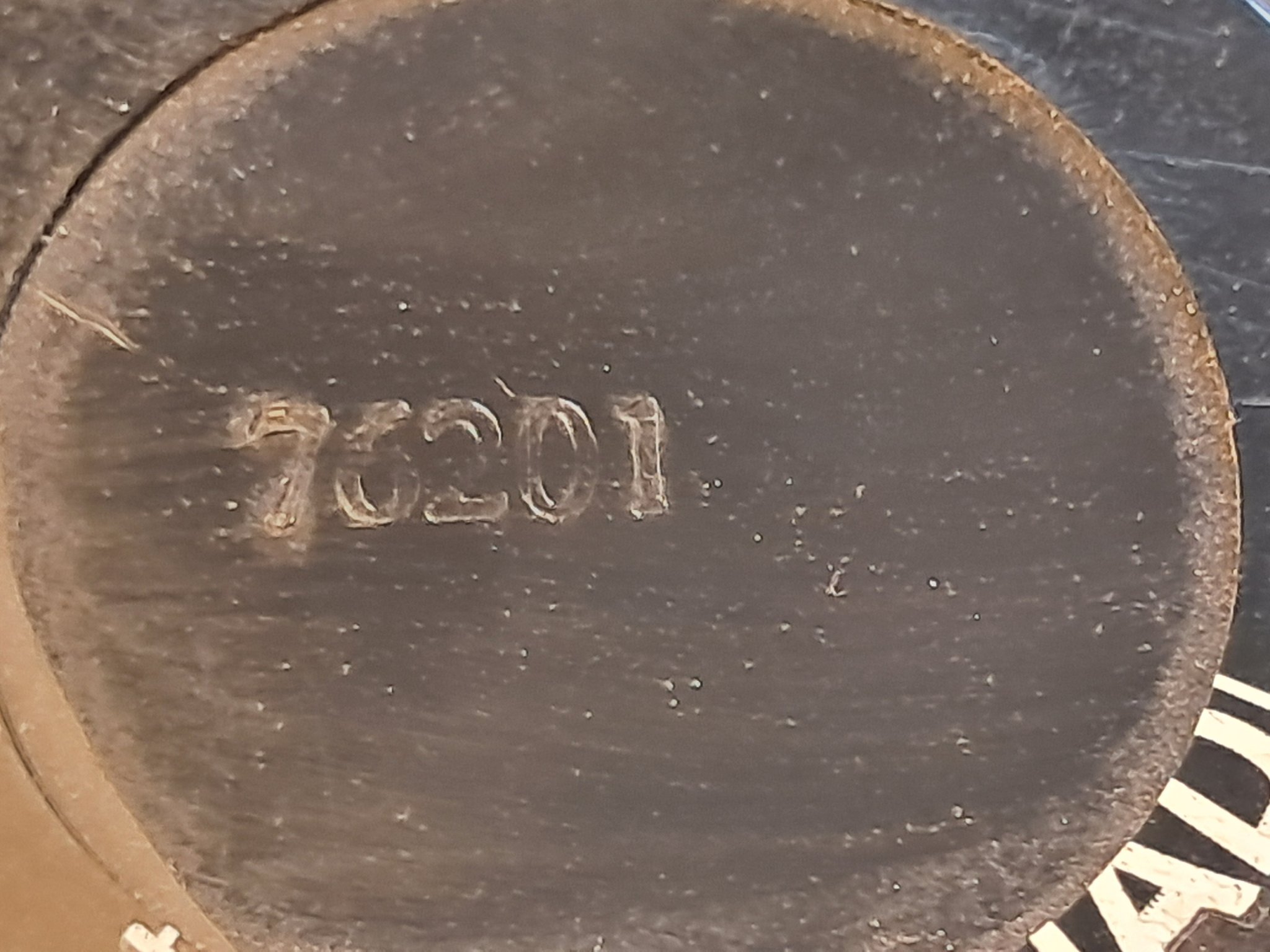

Do you know what this stamp on top of the big caps (square 2) means:
Is it some kind of information about the time of the manufacturing?

They are big and shiny and they definitely persuade the amp owner to pay the "maintenance" bill. But they are the power rail capacitors - bigger problems (and effort) are usually in the signal path.
Probably glue. If it covers any nearby leads of other components then its should be removed - its effect is usually corrosive.What is the brown stuff around the caps in the squares on the board? Glue or...?
Regarding stamping on top of the capacitors - I have never looked at that, usually the manufacturing time of the device gives you a clue about how old the components can be.

Yes, I have learned that it is the caps in the signal path, that should be my focus.They are big and shiny and they definitely persuade the amp owner to pay the "maintenance" bill. But they are the power rail capacitors - bigger problems (and effort) are in the signal path.
I think i have bought into the idea that all caps "get tired" after 3 decades of service - this is maybe not the truth?

Yes. But these caps have been replace since the amp was manufactured.Regarding stamping on top of the capacitors - I have never looked at that, usually the manufacturing time of the device gives you a clue about how old the components can be.
