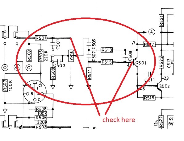

check in the circled area and at the base of this transistor, this is where i traced noise to before with the scope

These things can suffer from grounding problems. Recall what @Mooly said about the build quality. Things that look good often aren’t, and it might have even been that way from the factory. They simply didn’t put in meticulous attention to detail - that would add cost. Check ALL the grounding connections, even ones that “the problem can’t possibly be here”.

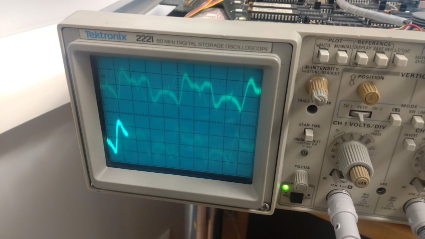

Is the hum with no load/no speakers attached
I am actually not sure we tested with the scope WITHOUT load. I will check.
will do

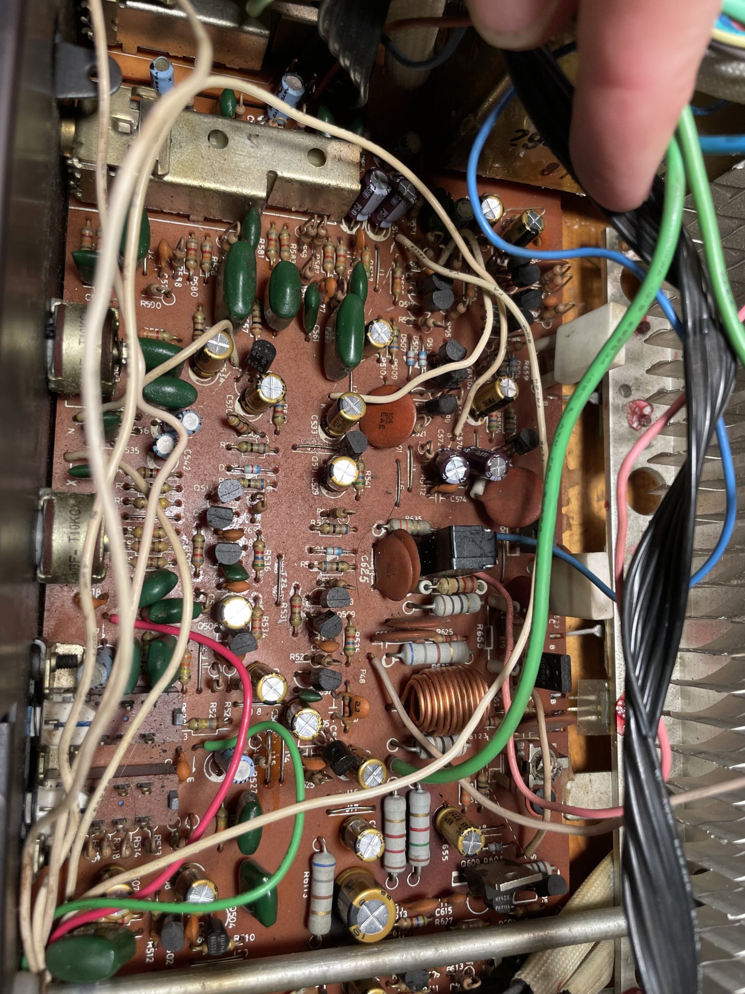

Ok - time for an update:
The ground bar/connection was NOT the issue.
Hum still there when I got the amp back.
So I thought “what now…”? And started moving around the cables again. One of the long white cables (A -> A on schematic) was most sensitive to being moved around, so I tried desoldering it and relocate it to beneath the PCB instead. That eliminated 80%-ish of the hum.
Now there is mostly hum when I ENGAGE the “Speaker EQ” circuit. So I suspect something there. Tried to clean the switch, that had no effect and soldered all connections in the area.
Any ideas are welcome 🙂
