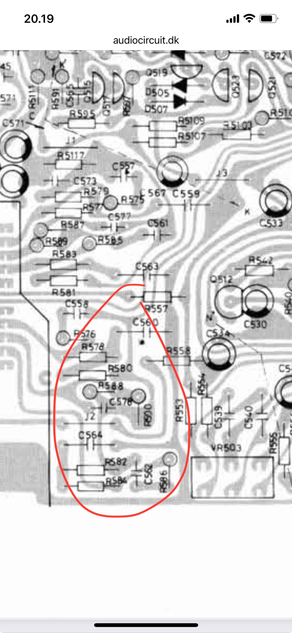

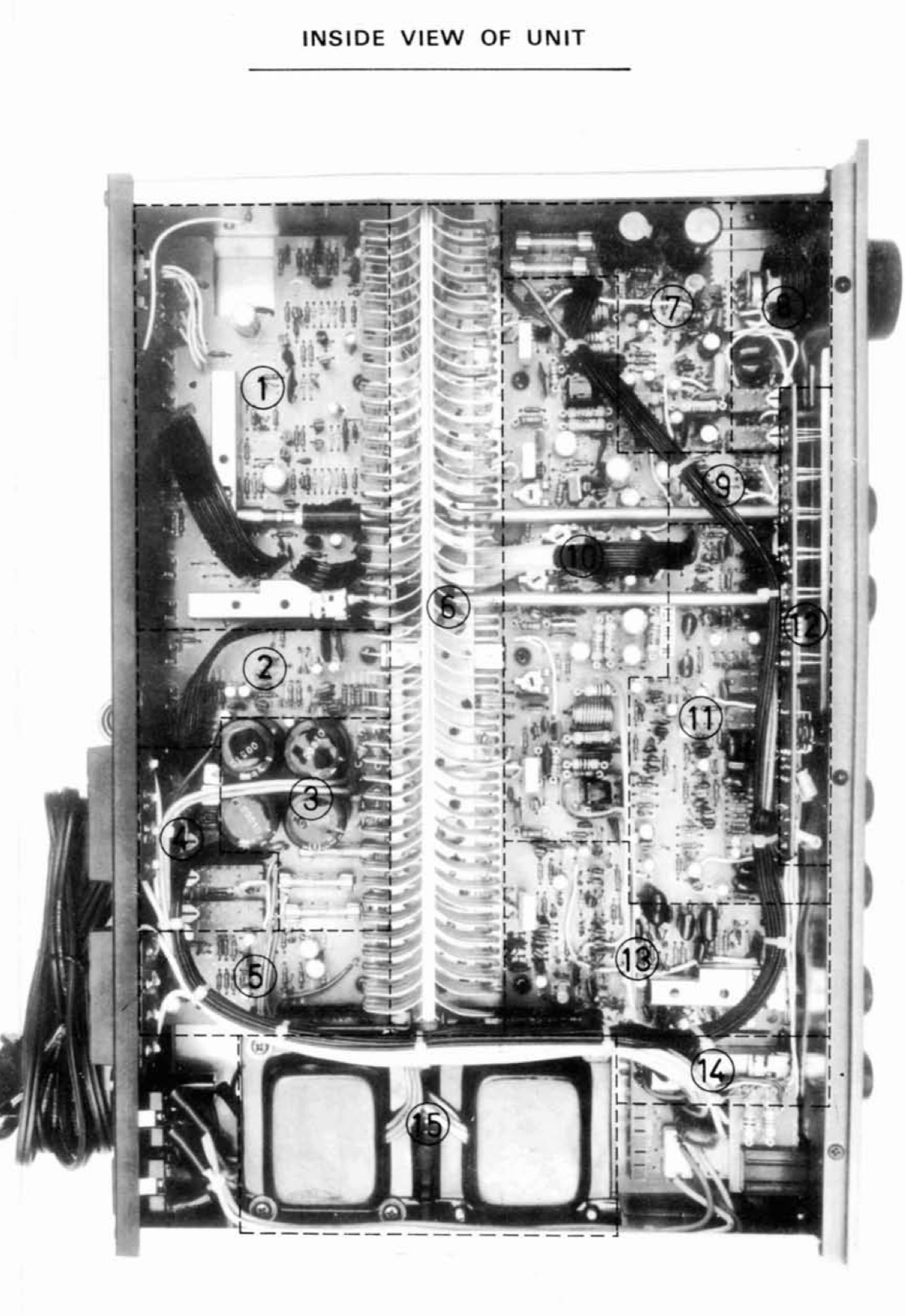

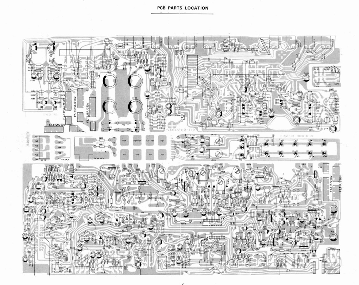

Is the 25 V rails the 25 volt output from the regulator? And is this found in area 7 in this picture (top right)?
I assume the 25 V “rails” are the 25 volt used throughout the amplifier, or?
Area 7 was totally “burnt” due to the power dissipating resistors, the capacitors there had lost their plastic etc.

The area 7 had been rather hot (there are some large resistors and the adjacent components are insulated to protect them. Could there be something else wrong there, in addition to bad caps?

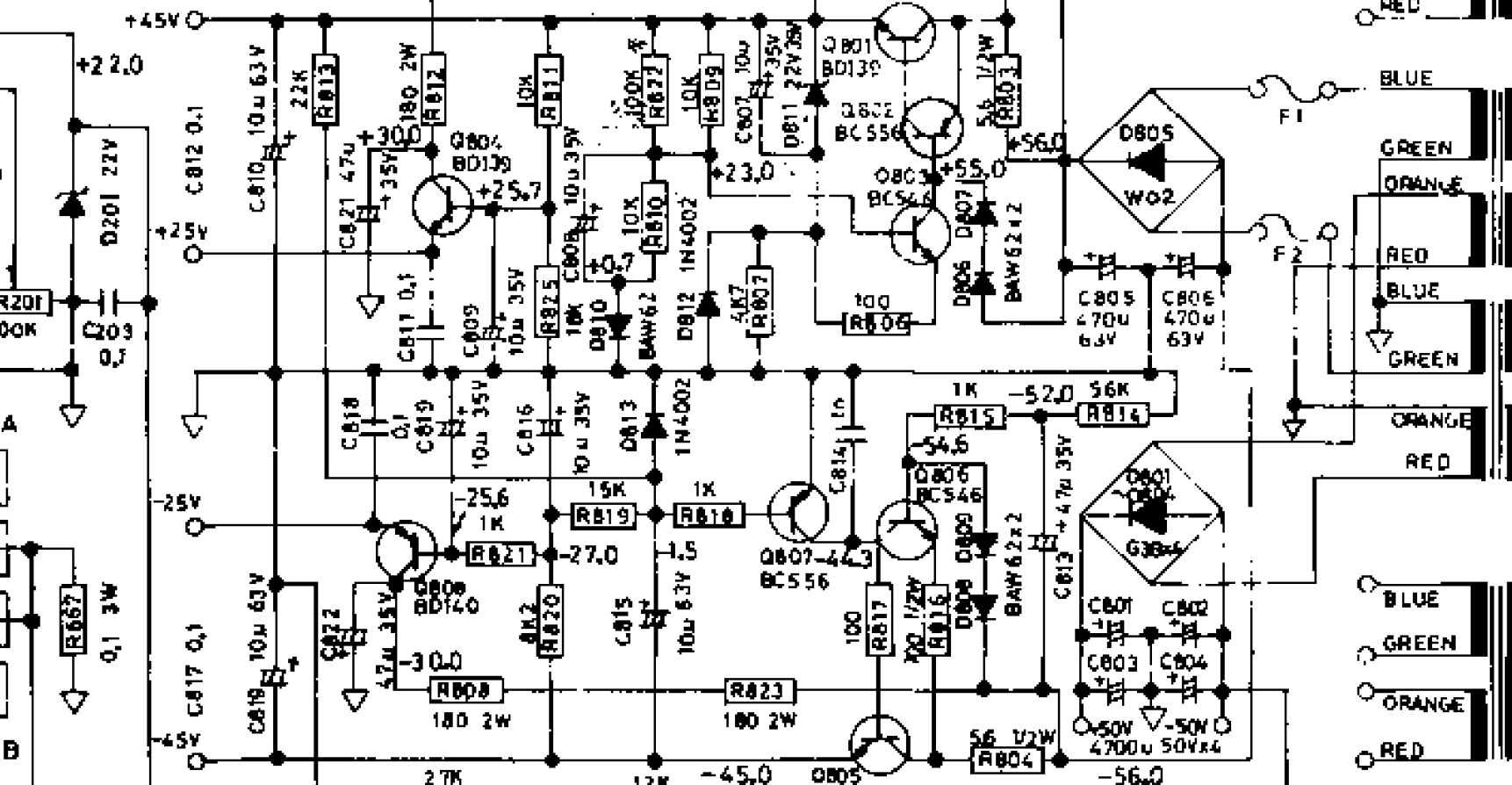

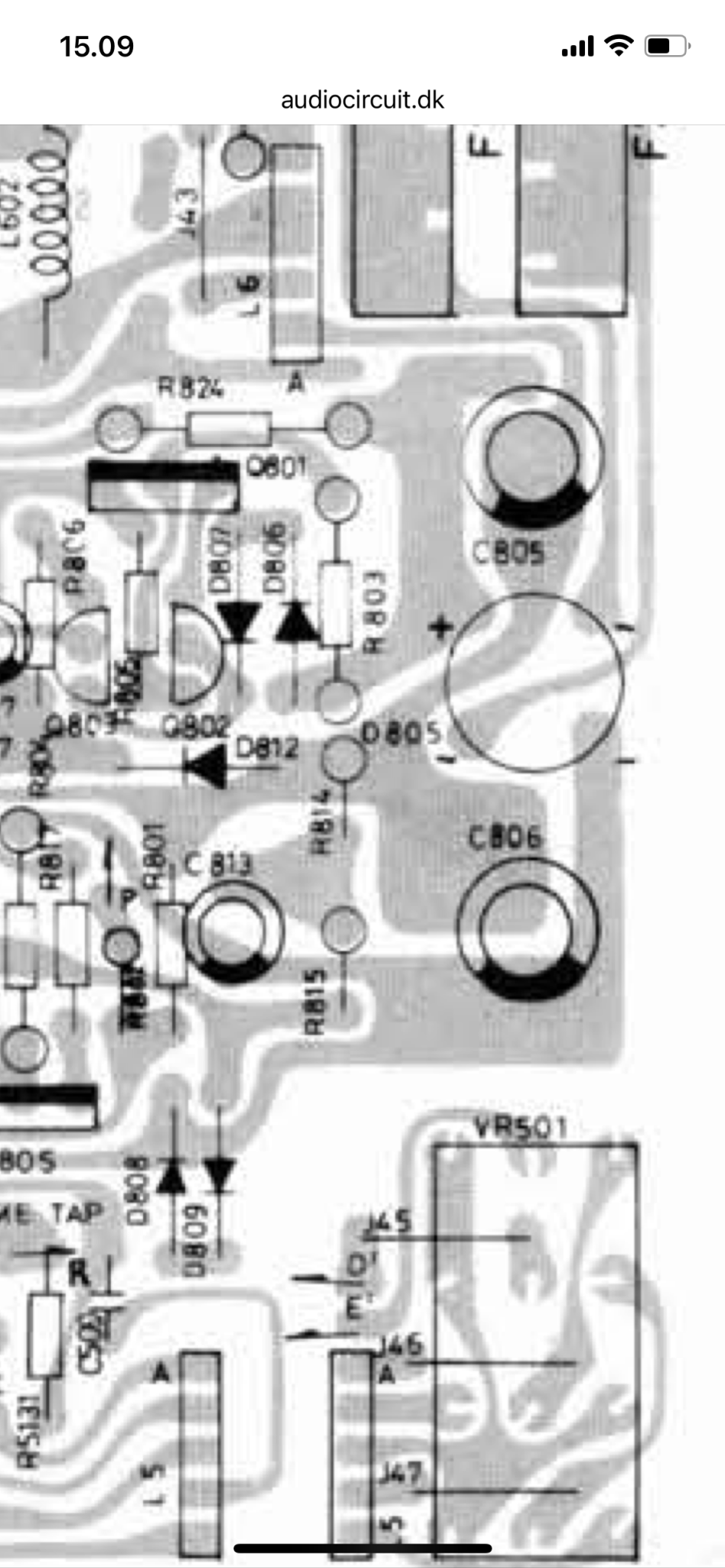

Next step: where do I measure the rail voltages/AC ripple? Included is the layout that is easiest for me to understand (the schematics are less easy to translate to real-world where-is-what 🙂 )
Update:These are the four regulated rails and the main caps that need checking but in reality all the electrolytic caps are suspect in a NAD of this age.
I tried from start of the regulator.

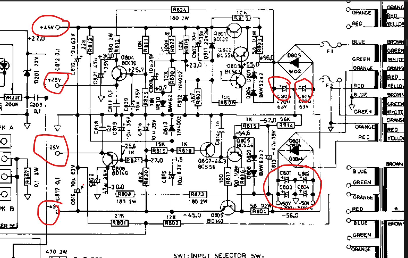

Across the leads of C805 and C806 there are 60 V DC (expected?) - but also close to 500 mV AC (not expected?)
Assuming this is unintended (?) I looked at the function of the close by diode D805. I had to ask Co-pilot how to use my Fluke for this.
Below, note that I do not understand why red vs black behaves “in reverse” compared to what is expected per fluke manual.

500mv ripple sounds normal. The caps are low value (470uF) and the supply is 'raw' with no stabilisation or regulation.
D805 is a diode bridge of four diodes.
First thing is to say that checking parts in circuit often gives unreliable results due to interaction with other parts.
On the diode range your (digital) meter will put out a test voltage and the red lead will be the positive. When checking a diode the diode will conduct when the red lead is on the anode and the black on the cathode. Analogue meters often have the polarity reversed on ohm and diode ranges... its just the way they are.
The diode bridge is extremely unlikely to be faulty.

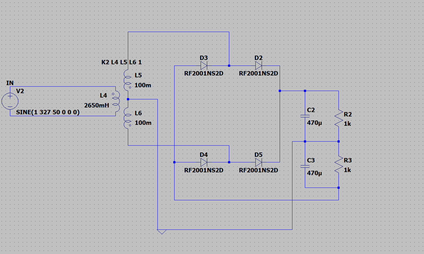

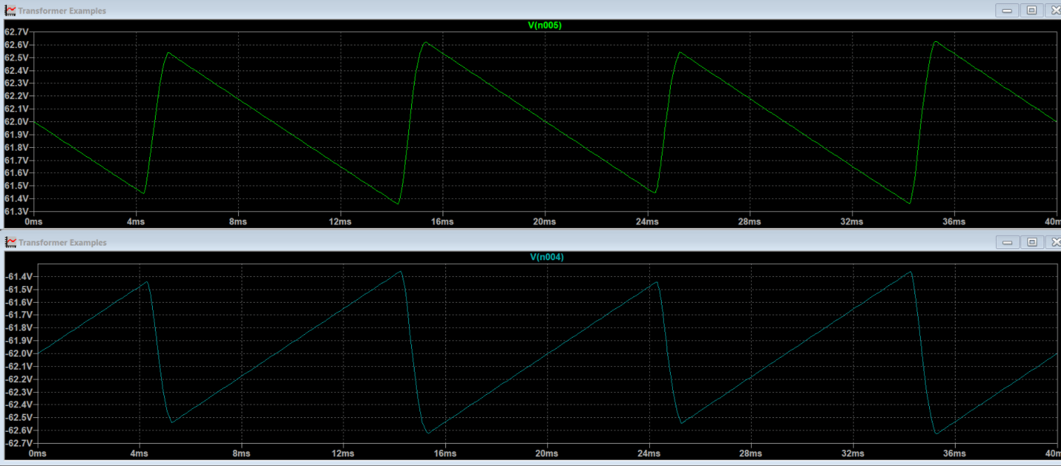

Here is a similar setup as a simulation. 470uF caps with1k across them which at 60 volt rails draw 60 milliamps load current.
This is the ripple on each rail which is over 1 volt peak to peak:
Ok, thank you - so my 500 mV AC in this position is not unexpected.

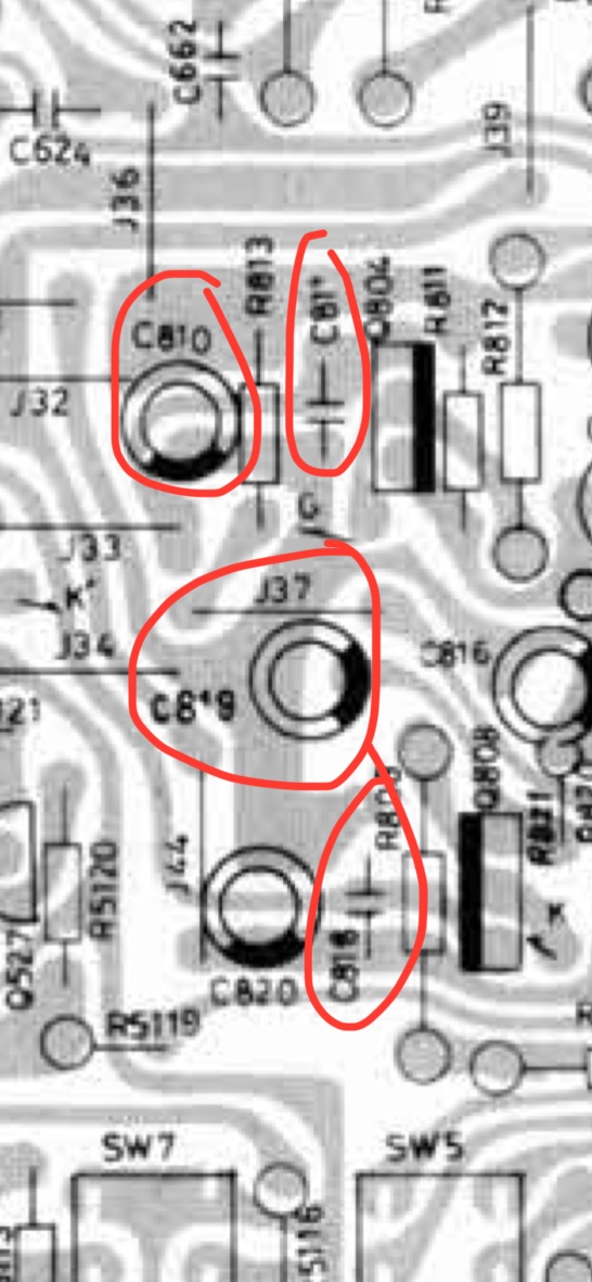

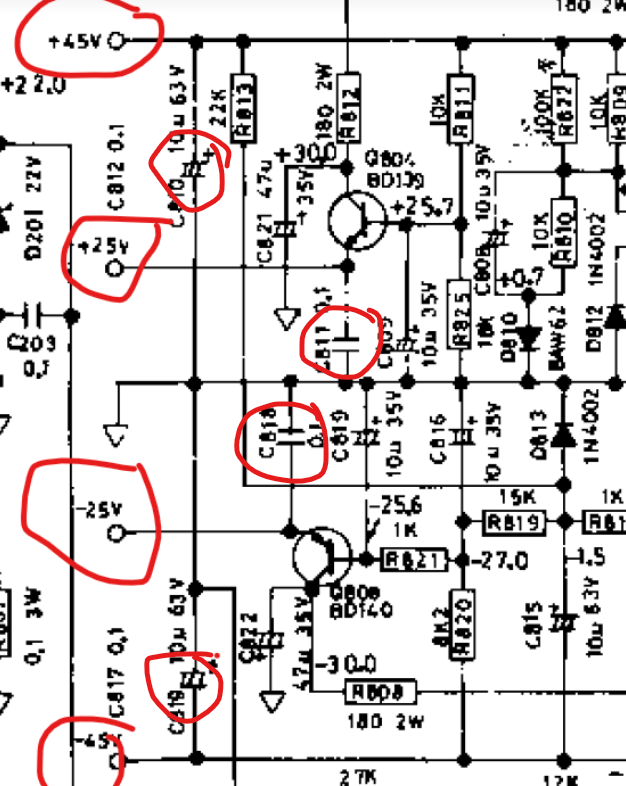

You need to find the points I circled on the diagram. It will be easiest to measure across the caps that are across the rails, these four circled. There should be virtually zero ripple here, we are talking a millivolt or two at most.Could you point me to where on the PCB I find this - and what AC to expect?
I believe I managed to ID these caps (two electrolytic and two ceramic). Hard to read in the numbers on the schematic, but hope you can see if I did it right by the numbers? Does it look like I found the correct ones?
What I measure:
C810: 47.9 V DC, <0.5 mV AC
C811: 48.4 V DC, <0.5 mV AC
C819: 26.4 V DC, <0.5 mV AC
C818: 25.8 V DC, <0.5 mV AC

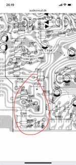

I have no idea - I tried to find the correct ones but not sure I found them 😅My glasses have to be betraying me again 🙂 - where are the smoothing caps of 25V rails?
If you can point to the specific ones on the PCB layout image above/in the service manual it would help. Just to verify if I am measuring the right ones.
It is page 6 in this one: SM
If I could do that then I would not be asking about them 🙂If you can point to the specific ones
Fair 🙂

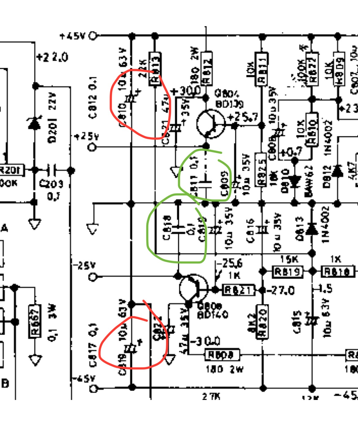

I think I found the wrong ones / I cannot understand why the two 25 V rail ones would be one ceramic and one electrolytic - would it not be “symmetrical”, i.e. the same type and value for 25 and 45 V, respectively?
The -/+25 and -/+45V rails all come from the upper bridge D805 and 470uF reservoir caps. The output of the regulators need only the small value caps shown.
Thank you - yes I understand that they come from the same original source. However, trying to understand the schematic vs my readings.
Would I not expect same readings across the two red ones and the two green ones, respectively?
Am I correct that
1) the two green ones are located between ground and 25V + and -, respectively?
2) top red one is located between ground and +45V?
3) bottom red one is located between -45V and ??
Am I correct that
