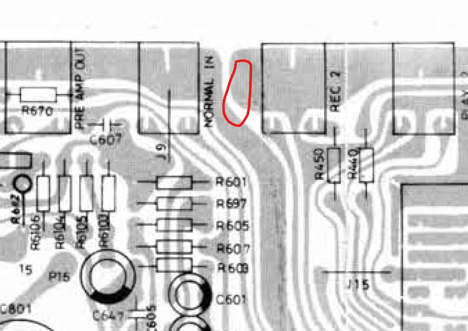

  1. there is one capacitor that is not in the SM (see pictures - it is not in the parts list and not on the diagram). Is is named C690 and the original one is a 3.3 µF, 25V. It is just next to the "normal in" socket. What is this? and do I just replace 1:1 and forget about it?

The cap would be here:
And so I'm guessing it is something added in production and possible to couple two grounds together to overcome some issue or other such as stray pickup or radio breakthrough. Just fit like for like for a replacement.
The hum may or may not be a 'fault'. This is an ancient NAD don't forget and they were far from perfect.
VU meters almost certainly normal as the lowest LED is 0.5 watt, then 5 watt and 25 watt, 50 watt and 100 watt. Most listening is done around the 1 or 2 watt level... yes it really is that low... and that is why they don't light.
When choosing caps replace like for like for uF and voltage and choose appropriate types that physically fit. You will have to measure the size and pin spacing and look at what is available.

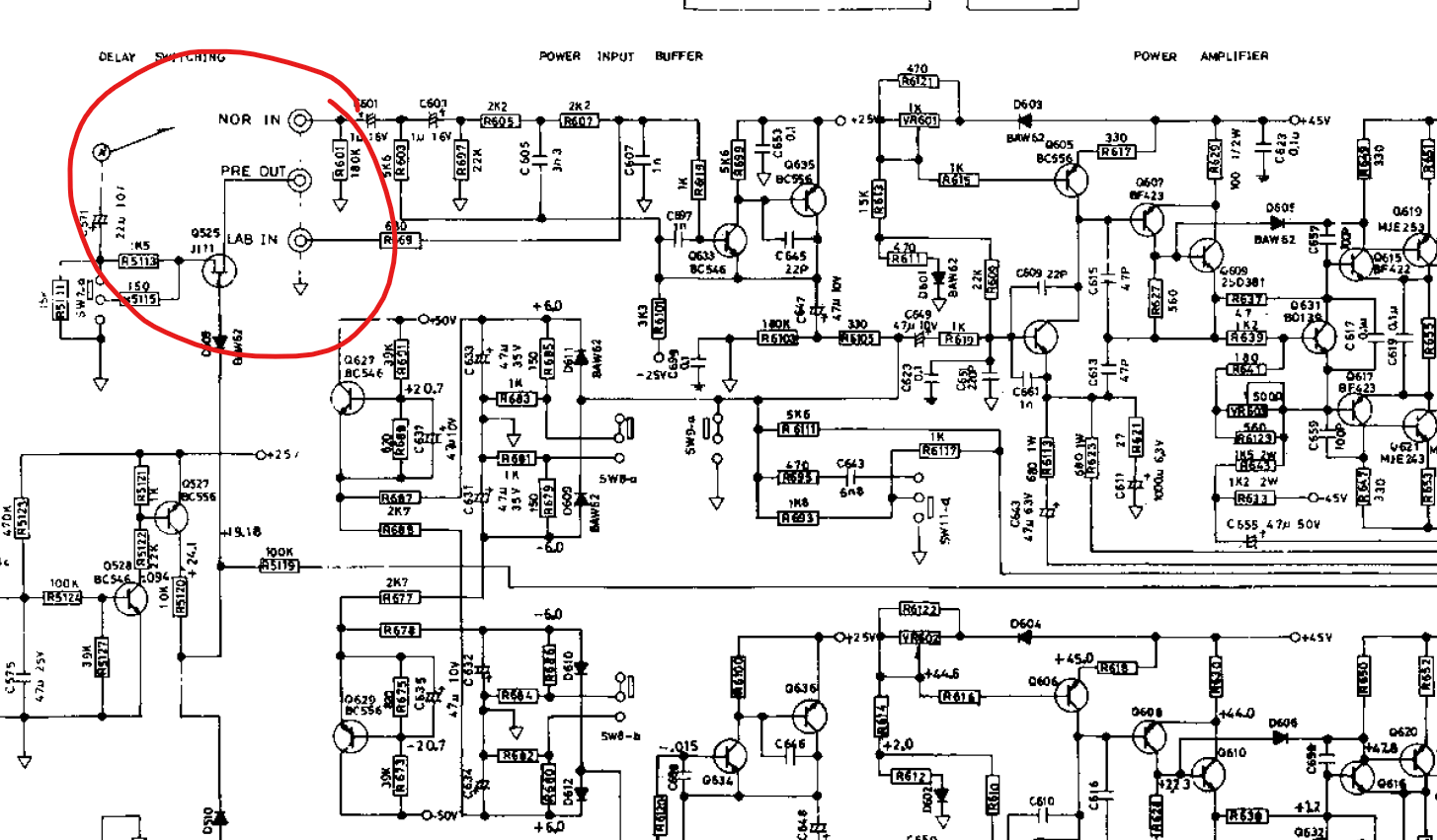

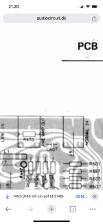

As standard on these integrateds there is a pre-out and a main in, which you plug together to run as an integrated amp (sorry if I am stating the obvious). As mentioned in an early post, hum is not present when using an external pre-amp.
See pic of diagram and link included
https://audiocircuit.dk/downloads/nad/NAD-3140-int-sm.pdf
