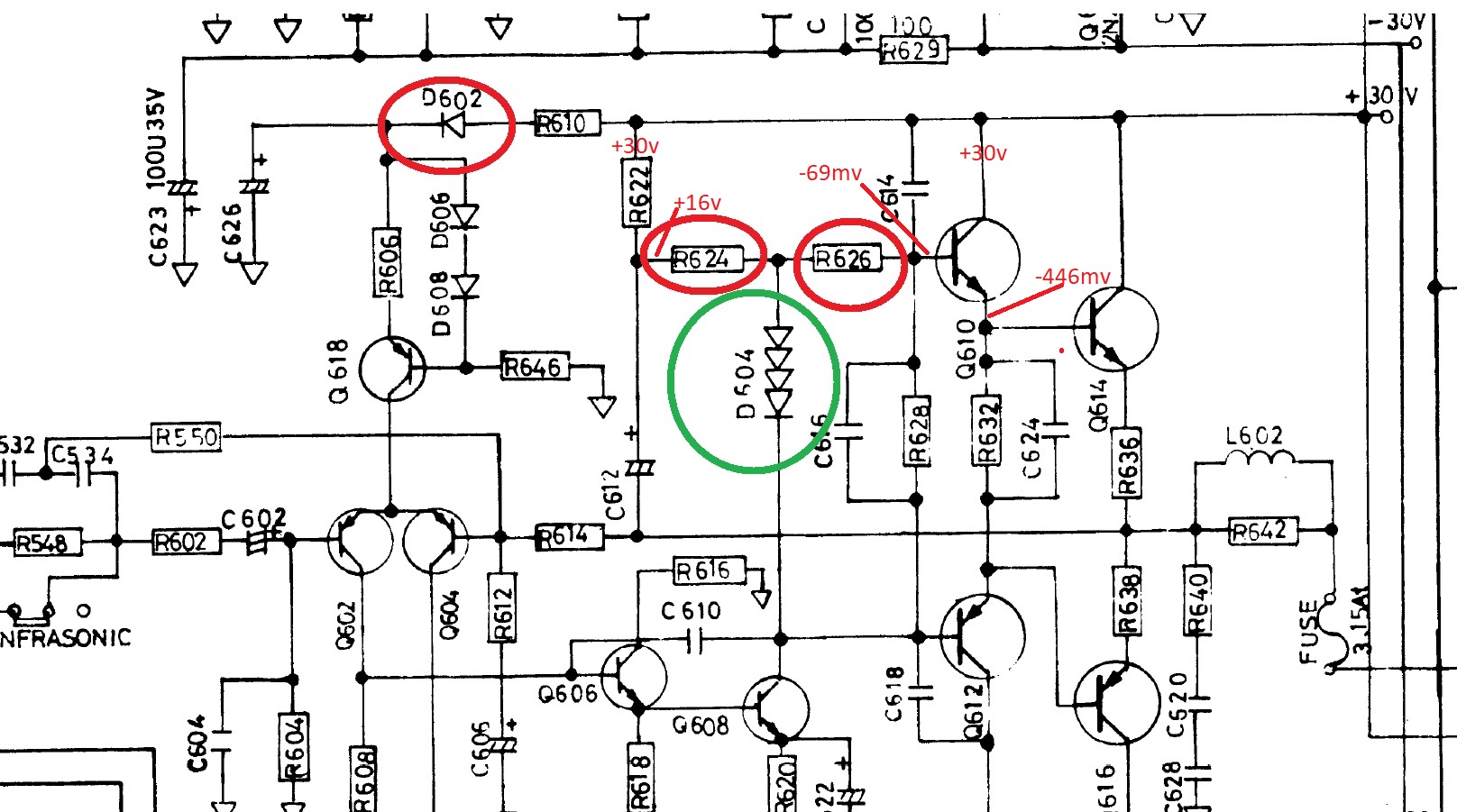

some interesting voltages, prob why its not getting any current across R626(temp pot)
Q610 is a new BD139
ignore the circles they are from a previous drawing

The voltages could show a problem. You need to look at all four base/emitter voltages.
Negative 446 millivolts on the NPN output would imply that the emitter should be at almost negative 1 volt in order to preserve the correct junction polarities and yet if you have a lowish offset of 0 to 100mv then that isn't happening.
You need to check all four transistor voltages and check the resistors are OK.
What is the voltage across the diode pack? You have to see what that is and whether it is enough to bias the stage correctly. It needs around 2.5 volts across the pack.
i currently still have this shorted out(does/would this make a difference to the figures? i thought it might)

Yes indeed it makes a difference. You will not achieve any bias current at all with it shorted.

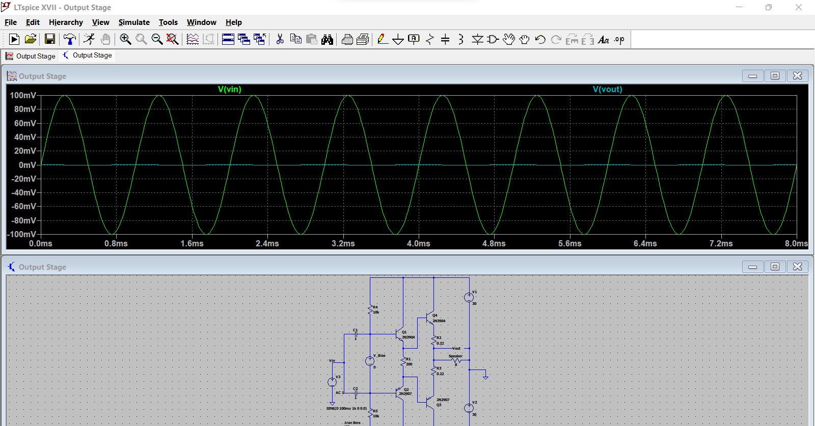

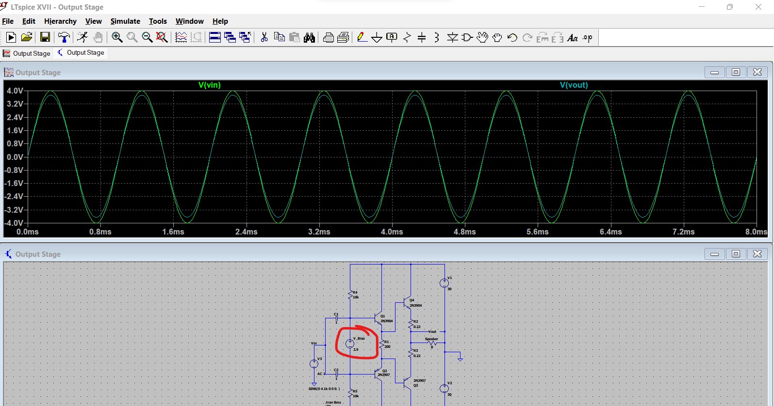

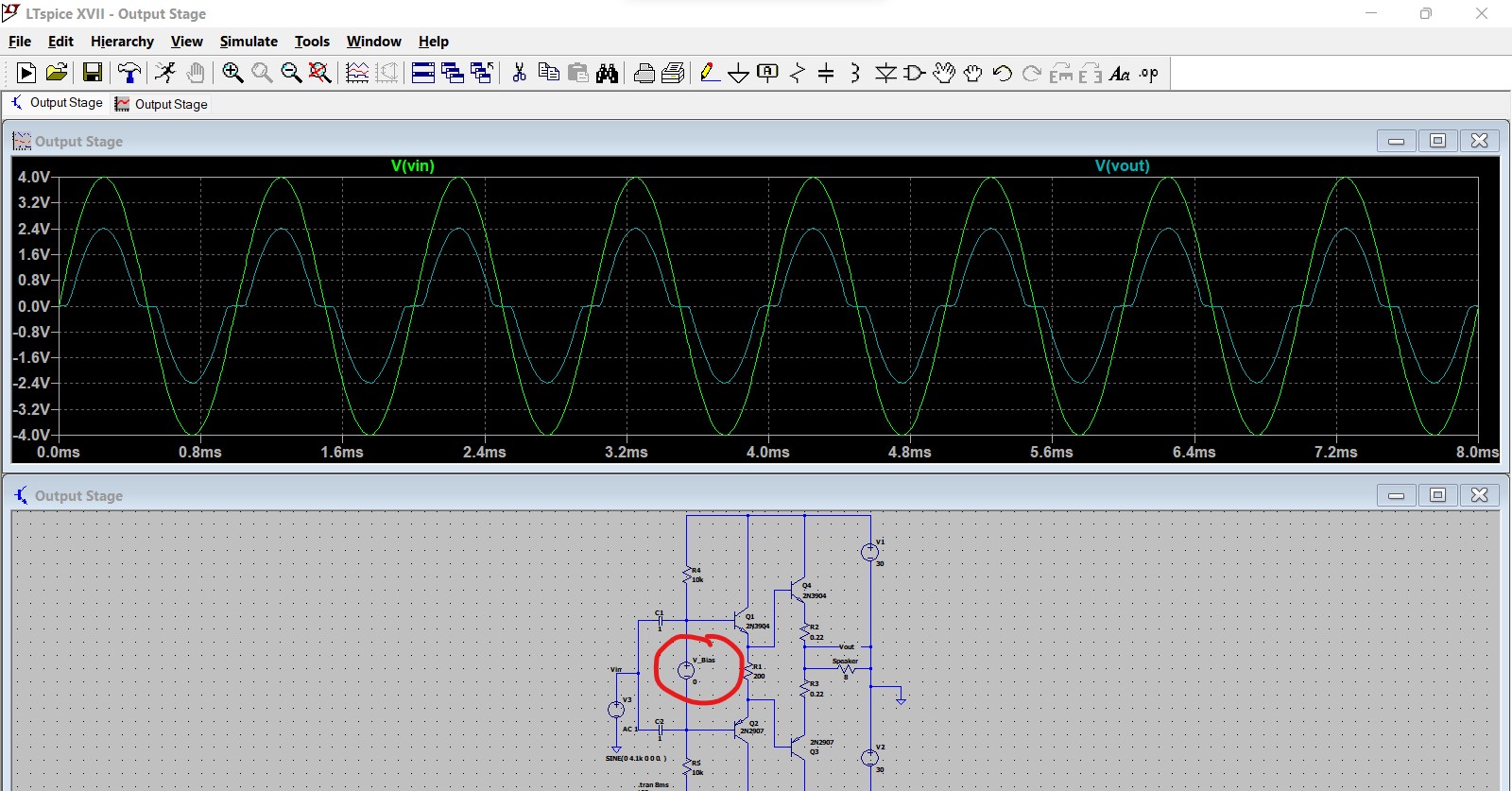

Try this and see if you understand it better. Have a play with the bias voltage generator and look at the current in the 0.22 ohm.
With zero bias voltage we get crossover distortion. Can you see why there is distortion? It is because the input voltage has to overcome the 0.6v (approx) B-E turn on voltage of each transistor. So there is a 'dead band' of -/+1.2 volts where the output stage does not respond. Time passes and no output voltage occurs until the input voltage has overcome that 1.2v needed (0.6 for each transistor in the upper and lower halves) for them to conduct.
With a bias voltage of 2.9 volts we have bias current of 28 milliamps flowing. The distortion has gone. Even a milliamp or two is enough to reduce the distortion. This bias voltage (across the diode pack) brings each transistor up to and just beyond the point of conduction. The 'dead band' has gone and it can respond to very small input voltages.
Try cutting the V_Bias voltage out of the sim and putting four diodes in there instead.
Next try making the bias zero again and this time reduce the input voltage to just 1 volt. Look at the output voltage noting the scale. Now turn the bias up again. Whoa... big big difference 🙂
Note... the distortion produced by the complete amp would be nothing like as bad as here because the output stage is enclosed within the overall global feedback loop. That reduces the distortion by a massive amount.
