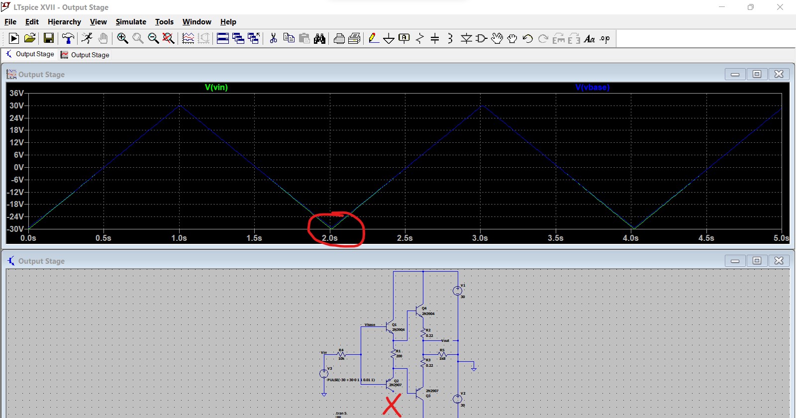

In the real amp this is the resistor that is being driven (last image). In the simulation we add it as a load. So whatever value that resistor is in the real amp you can then add to the sim.
Run the sim and look at Vin and Vbase. The two traces overlap because the voltage is the same on each end of the 10k.
Now cut the collector of the driver transistor and run it again. Zoom in on the lower tip of the waveform and you will see the voltage difference separating them. That voltage difference is across the 10k. Vbase is lower than Vin because the stage is now loading the driving voltage source because it has low current gain because of the 'damaged' transistor.

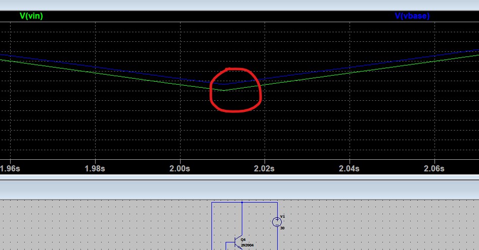

A Vbe multiplier would be the best solution. The economy version 😀 which is just as good as a full version but uses less parts consists on one transistor and one preset.

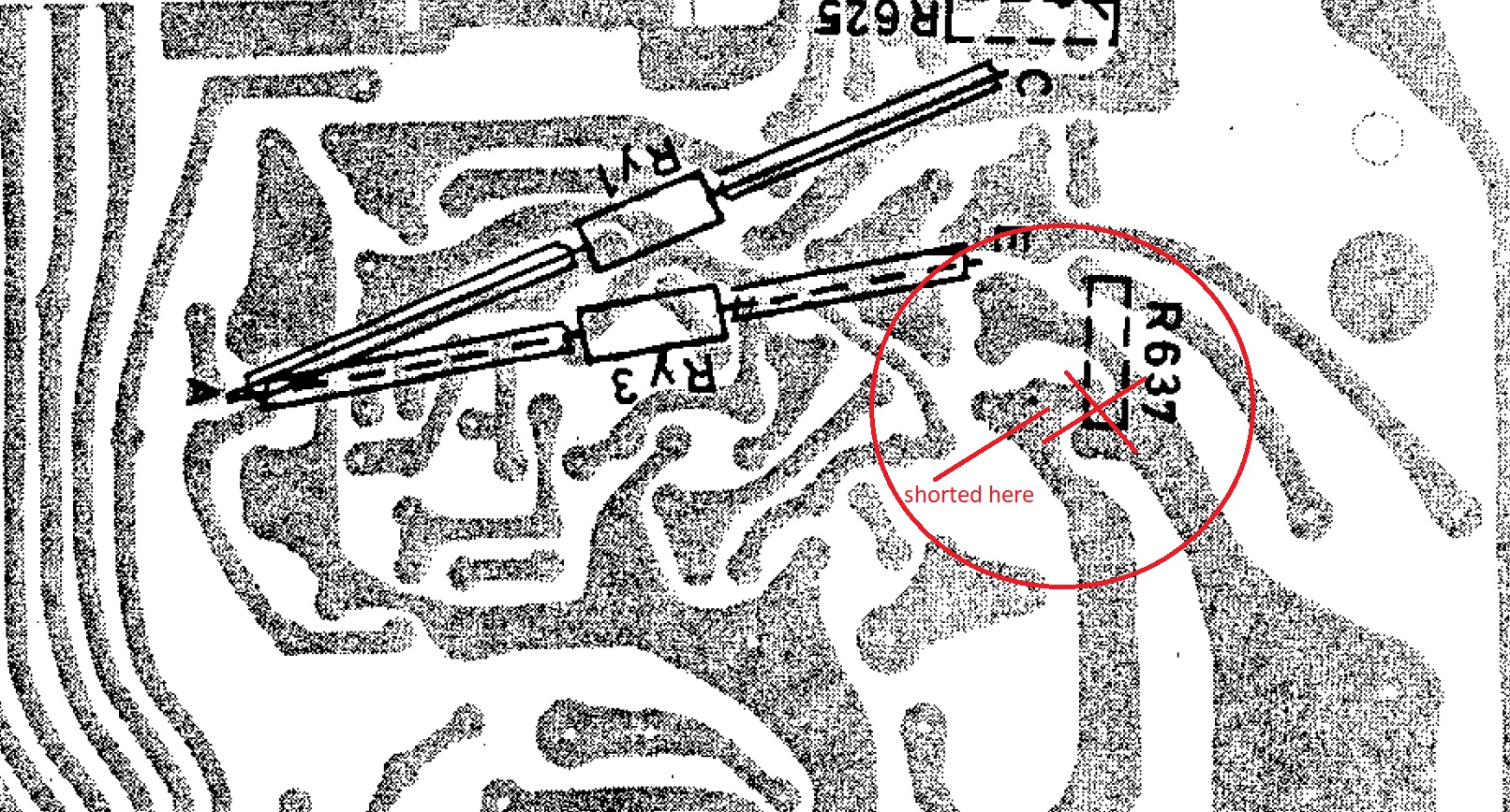

what would be the effect of shorting out R637 and R629? (by mistake i mean ) it did spark a bit and now the lamps on again 🙁

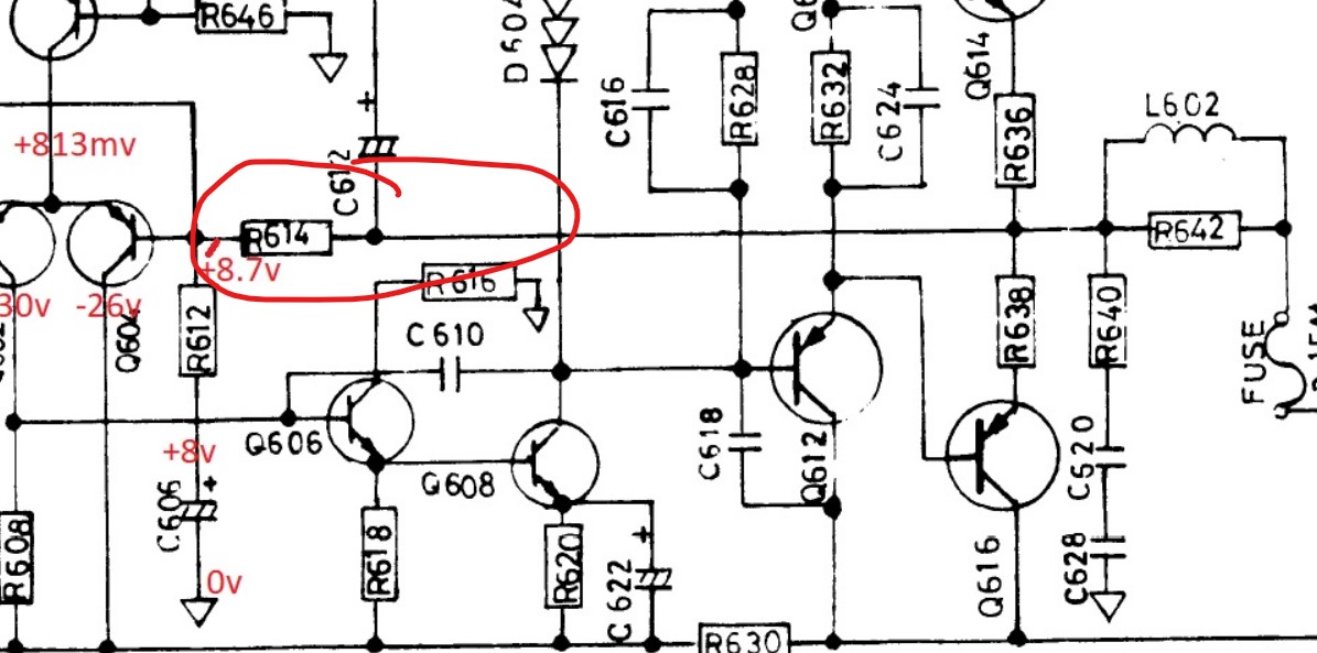

R627 on my diagram is the 6k8 between the base of the driver transistors. The voltage across this resistor is always going to be in the 2.5 volt region. If the diode pack is linked out then it would be zero of course.
Shorted to what? One resistor to the other or each one to ground. For R629 it would depend which end got shorted. If the bulb is on all the time then you probably zapped one or more of those four transistors.

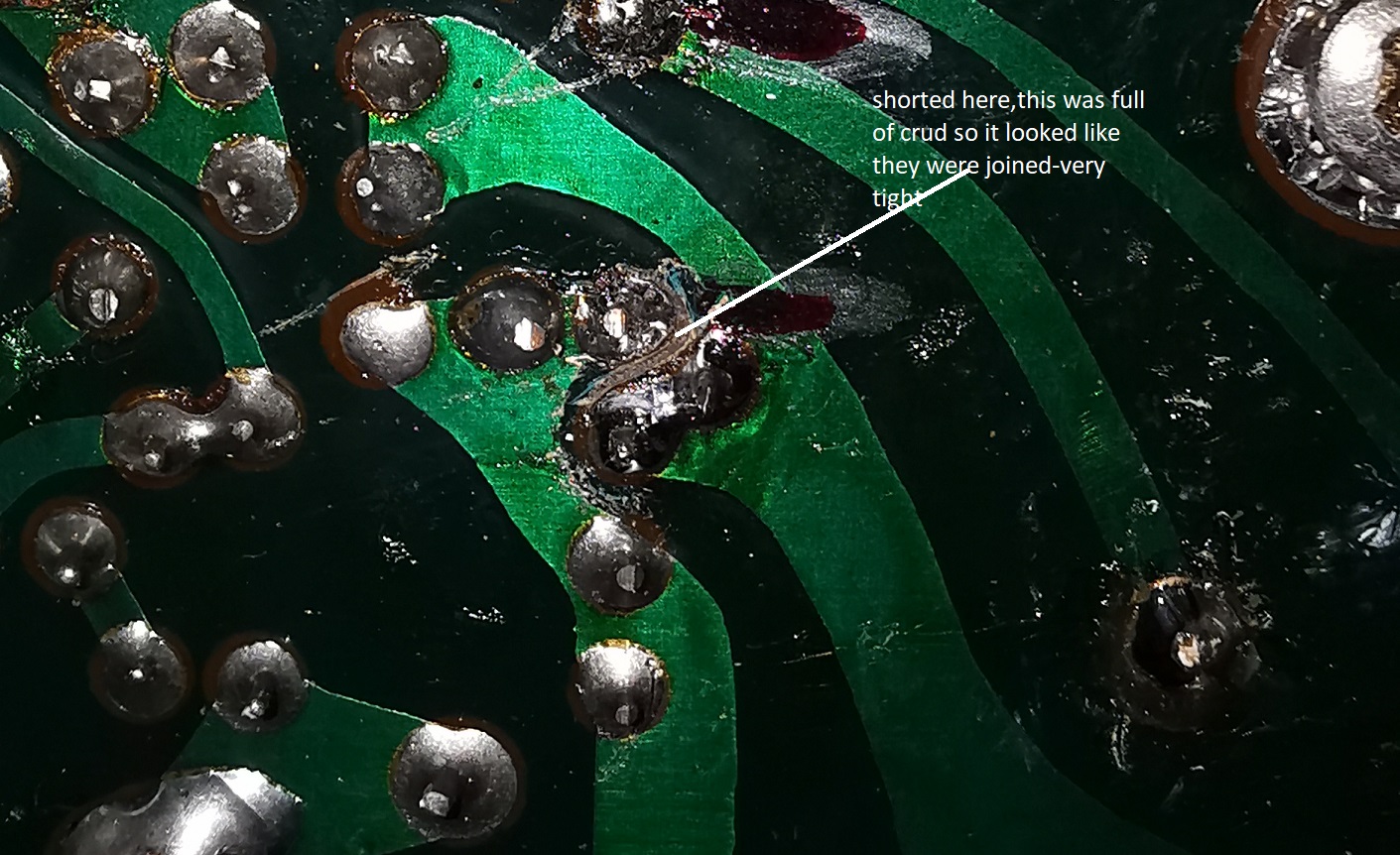

im defending myself with this one 😉
Lots of flux can make it hard to see what is underneath 🙂 It happens.

just between those 2 resistors
here you go
Thanks. OK, so that makes sense 🙂 It was R637, not R627. I thought it sounded wrong 😀
You will have to see how it works out when you are happy it is all otherwise OK. I'm not a fan of fixed bias designs like this as they are so critical on the actual parts used. Even minor differences in replacements can bring the adjustment out of range... but we will see.
R637 is so low in value that it won't matter which end you shorted on that one (but check it is OK and not open circuit. It should OK as the bulb should have saved it).
If it touched R629 on the -30 volt side then you shorted the output to the negative rail. That probably zapped the upper NPN output and maybe the driver.
If it touched the other side of R629 then I think it might have burned R629 up and also damaged other parts round Q605 and Q607.
If it sparked it was probably the supply side it touched so just output and driver suspect.
Remember, link the diode pack out and the output stage should draw no current.
