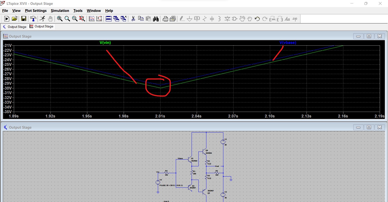

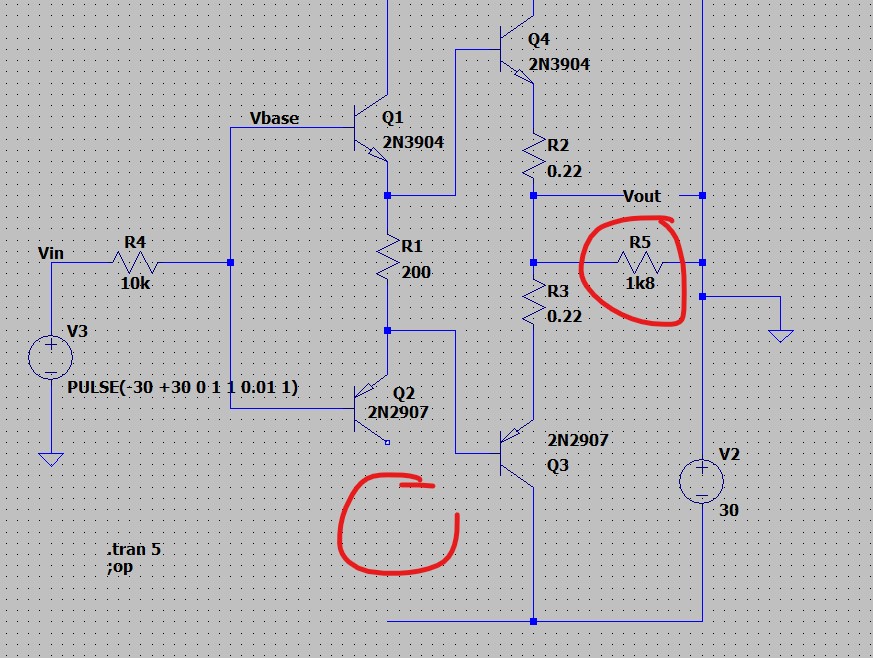

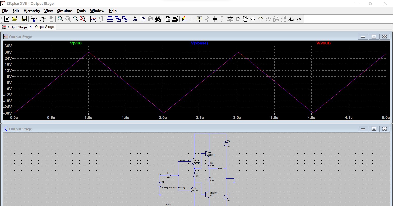

Just so you can follow the logic...
This is similar to your NAD output stage. Whatever voltage is applied to the input side should also appear at the output. The transistors give no voltage gain but they do have massive current gain connected this way as the first transistor feeds into the second transistor in each upper and lower half.
This shows the input voltage, the base voltage and the output voltage. All are similar.
The massive current gain means the stage takes very little current from the voltage source driving it.
Nothing from the supply rails can feed back to the input side.
The input voltage is slowly going from -30 to plus 30 here.

I'm going to say at this point that that is a little suspect, particularly the 900mv across the 10k.
That level of voltage suggests the current gain of the lower half of the stage (the two PNP's) is low. It just 'feels' wrong to me.
You would get that effect if either of the two PNP's was either faulty or had a missing connection... or if there is doubt, was incorrectly fitted.
It would also do this if either PNP had the supply missing to the collector.
To be absolutely honest, the 30mv reading also looks high and again exactly the same applies to the upper half of the circuit.
It needs investigation.
Try the sim I attached. Add a 1k8 load to the output (in place of a speaker... in the sim, not the real amp) and snip the collector of each PNP in turn. The 1k8 is the feedback resistor which is the only load the output stage is driving. Look at the voltage across the 10k at the -30v point. Its about 900mv.
This is the detail we have to get into now to fix this. I suspect you have more than one fault/error causing the overall fault.

No, I would leave it so you can retest with the 10k. We have to figure out why you are seeing that volt drop across the 10k... well the reason is the stage is loading it to heavily because the current gain seems low. We need to find a reason why.
Have to go for now
(The 1k8 is whatever value R614 is in your amp. That is the load the stage is driving)
Have to go for now
