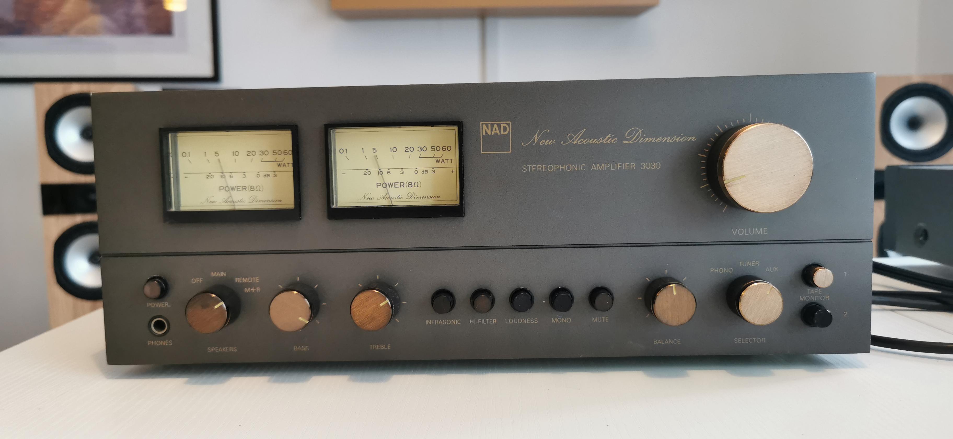

Those values look fine to me 🙂
Was there any doubt over the diode packs being intermittent or anything like that? I can't remember, was this the amp that failed after being repaired previously.
Also remember that the offset and idle current values should really be re-checked when it is running on full mains rather than via a bulb to check all is OK on the full rail voltage. Don't get hung up on any slight variations though 😉 It is just to check it is all operating normally.
When i brought it only one channel was working(although i never plugged it in and tried it.) the diode was never questionable from my perspective, it just kind of went in that direction under general conversation.
R632 and C616 were burned up but after that i never realy found anything at fault apart from that transistor Q610 where the leg fell off, but it does make sense why Q610 may have been at fault now i look back.
im going to put all my stuff away, tbh , im still a bit washed up with the covid thing, but ill keep the amp out,and check things while its being used and sitting idle,voltages and temp etc.
All i have to do now is look at why the power meter lamps are not working, then maybe look at a way to fit VBE'S, on a board perhaps as there isnt any room to just plonk things on the board.
Its been a real slog this one as im sure ive ended up correcting more than one or 2 things, maybe more while trying to located the faults i was chasing.
been interesting though this one, thats what makes it fun, it wouldnt be if everything was the same all the time.
I feel like im starting to be able to look at things more now without constantly bothering people , and wasting peoples time over silly things.
I realy appreciate your time when you get involved because you take the time to not only suggest what maybe wrong, but explain why and that realy goes along way in helping me with things going forward both technicaly and practicaly ,thank you !🙂

all stable at idle on for 4 hours now/idle and being used.
heatsink temp 35c, which given the ambient is pretty good.
R632 and C616 were burned up but after that i never realy found anything at fault apart from that transistor Q610 where the leg fell off, but it does make sense why Q610 may have been at fault now i look back...................
R632 burned up just suggests classic output stage failure. I know its all been around the houses to get it working 😀 Well done.
And thanks for the kind words 🙂 its been interesting and from my point of view it has been good to have someone interested enough to see it through.

so the lamps in the 2 watt meters at the front-no 6vac supply from the transformer, so not sure what i can do here,maybe try and replace them with a couple of LEDS and nick 5vdc from somewhere, so its out with the meters,which are not easy to get out and have a look!
scrub that the wire was broken, but the lamps are blown lol
LED's can always be used but you are best running them off a highish DC rail (because they use so little current anyway) and connecting the LED's in series with a suitable resistor. A practical problem can be getting good and even illumination. You want diffuse wide angle LED's and sometimes a bit of plastic to spread the light can work wonders. Old plastic milk cartons, the kind of thing.
Using AC for LED's also requires a diode to protect the LED's from high reverse voltage, and you also have the problem of visible flicker at 50Hz (a bit like on old TV's). So a DC rail is best.
All finished now apart from the lamps and all stable on idle and centre.
realy pleased with this how its turned out and after listning to it it has realy grown on me, might even be replacing my 3240PE its that good, and its in top condition🙂
Job done with this one.
