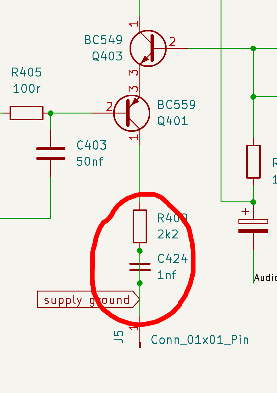

# The area around R409 & C424 still has errors, not least regarding the neg. (Vee) supply rail, or lack thereof.... check it against the manual schematic, and you should be able to complete the GND net as well.
# R431 also seems to have added an issue now.
That's all I can see at the moment, so it's getting there slowly. The reason I may seem somewhat insistent on getting the schematic correct, is that everything else depends upon it - the 'nets' that are being defined by your schematic are what form the basis of ALL of the pcb track layout, if the nets are wrong, the pcb's wrong.

@poundy, C424 is now shorted.
@poundy - OK, I'm back after 'xmas now, and have pc (& Kicad) access again...
Good to see the schematic progressing: mz543578854 already highlighted the shorted cap - don't forget the missing Vee rail supply and the wrong ground net label (all in my notes above).
The only other errors I can see in the schematic now are various part values, but those shouldn't affect generation of the pcb.
Once the area around R409 / C424 is correct, you'll be able to proceed with sorting the pcb tracks - note - if R409/C424 is not corrected, the netlist & ratsnest (that are generated from the schematic) will both be wrong, and it will 'force' the pcb to be wrong (the netlist & ratsnest essentially define where tracks can / cannot be placed).

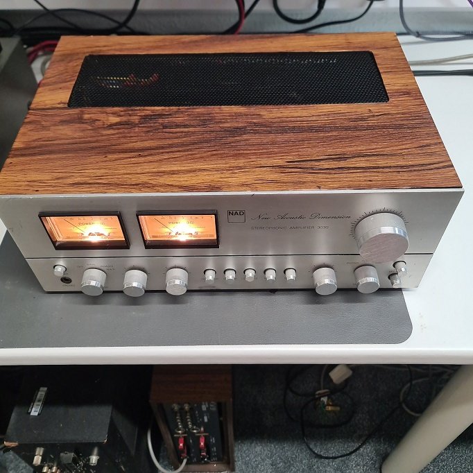

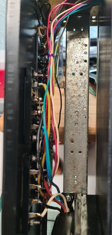

well ive finished the main part of the amp, and it sounds fine.Im pretty pleased how its gone as it looks pretty good compaired to how it was when i first got it, it was ready for the scrap heap.
now onto finishing the pre amp boards

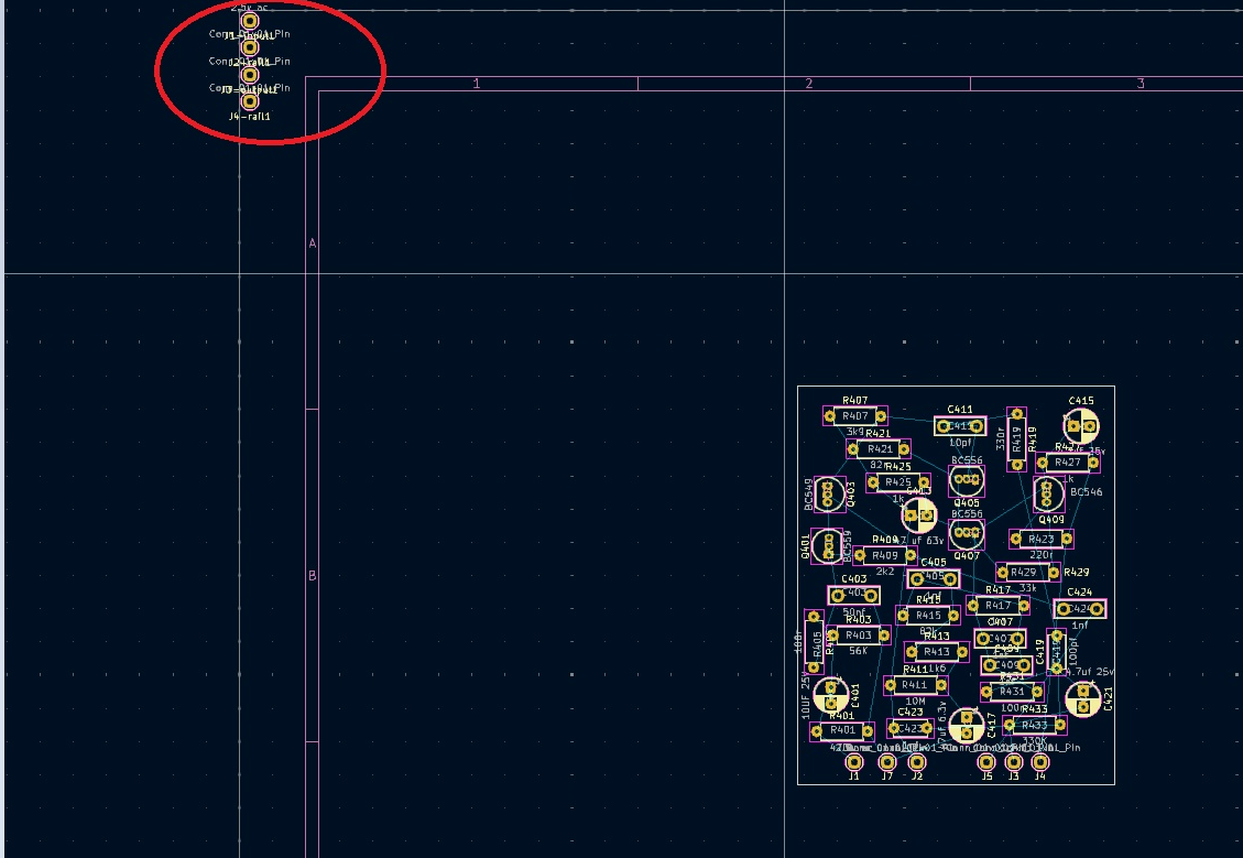

any idea why i would have these additional pins that are not allocated? should i delete?
They would have been 'transferred' onto the pcb from one of your earlier schematic versions, and I assume subsequently deleted from the schematic but not from the pcb.
You can just select & delete them on the pcb screen.

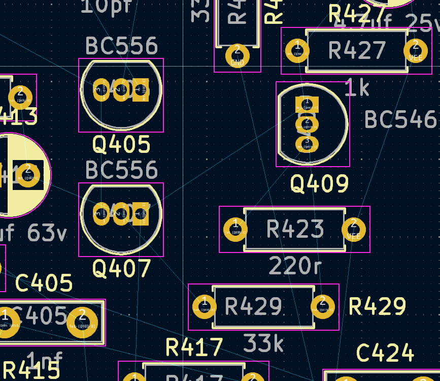

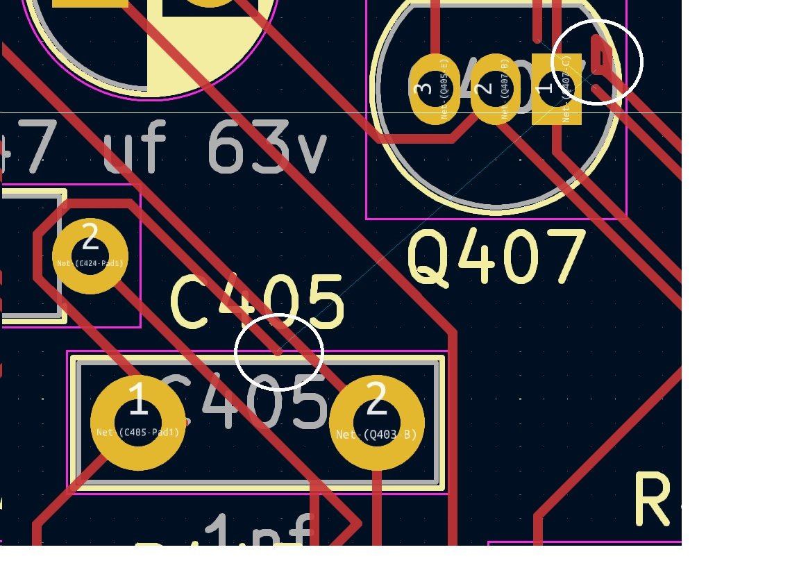

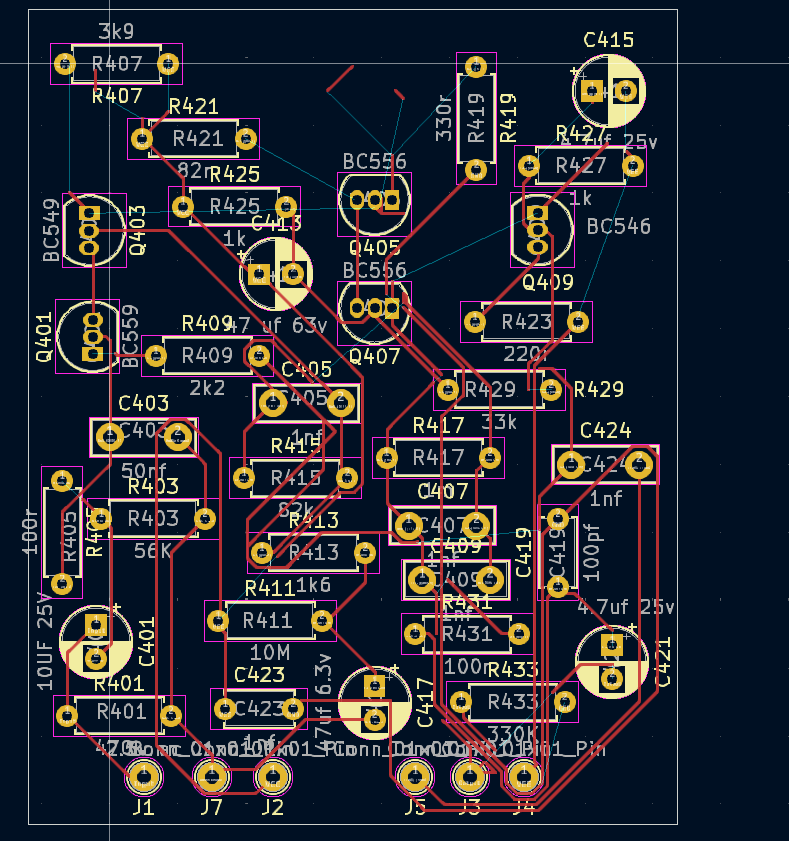

ok so im getting there with this, and im nearly there i think, but i have a few instances where it cant place the track.I presume this is because as it is currently set out they cross each other
can you manualy place buy hand?
@poundy, the "trick" is to position the components so you avoid this. It looks as if you just put them were there was still space on the PCB and now you are trying to just connect them. Especially for a phono stage which is likely prone to catching noise that is not recommended (also not for other layouts).
You should probably get rid of your current tracks, position the parts as in the original and follow how they routed the tracks.
Not quite sure what you mean by 'manually place by hand' - the tracks should all be routed by hand, except, in this case there is one place where an external wire link has to be added which I was going to come to later (it connects one end of R409 to one end of C424). As far as I can see, that's the only one which should be needed if you've followed the NAD manual routings. You can actually see it on the NAD diagram, and it's the white insulated link in the pcb photo.

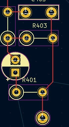

(1) For the various ground connections - we'll add a 'ground plane' to the back of the pcb (so the entire back surface becomes 'ground').
  • select the bottom copper layer of the pcb (on the RHS of the pcb screen you have the layers list, just select B.Cu - that just means whatever tools you use now will be used on the bottom copper layer)
  • select the 'Add Filled Zone' tool, and then draw a rectangle on the pcb which fills almost the entire surface of the pcb (you click each corner of the rectangle going around, and end up back at the starting point) - it'll look like a blue rectangular outline. That's created a 'zone' on the bottom layer.
  • press the letter 'B' - that'll 'fill' the zone with copper. It should add 'hatching' to the rectangular outline
  • to view the 'zone', you can use the 2 buttons on the LHS of the screen called 'Draw Zone Fills' or 'Draw Zone Outlines' (just toggle to whichever is needed at the time
  • finally, to make the new zone into a 'Ground Plane', 'Left click' any point on the zone outline to highlight it, then 'Right click' and select 'Properties' - you should see 'B.Cu' ticked as the active layer - now select '/GND' from the list of available 'nets' - just leave the rest of the entries on their default settings and click OK. That assigns the zone to be part of the GND net.
  • 'Left click' away from the pcb surface (to deselect the zone) and press 'B' again.
Note - All of the component terminals which connect to ground (/GND) are now directly connected to /GND via their solder pads, and a bunch of the ratsnest lines will have disappeared (that's why I said ignore the ground connections before).
Until now, everything you've done will have been on the Front Copper (F.Cu) layer (hopefully), but now there's 2 copper layers, so be sure to always select the layer you want to work on... that will apply to the silkscreen layers as well later.

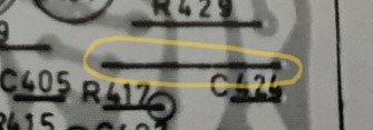

(2) For the wire link - one of the easiest ways I've found is just to add a 'jumper' to the schematic, as follows:
  • insert a 'jumper' between R409 & C424 (you'll find jumpers listed in the components lists) as shown below
  • annotate the schematic again (so 'JP1' gets added to the annotations)
  • add a 'footprint' for the jumper - I used "Connector_Wire:SolderWire-0.5sqmm_1x02_P4.6mm_D0.9mm_OD2.1mm"
  • switch to the pcb screen, and 'update' the pcb for changes to the schematic - so the jumper is added as a new component (it's the 2 square 'terminal pads' in the pcb snippet below, above R409 & C424)
That'll add a 2 terminal 'jumper' to be inserted onto the pcb - it needs to be placed in such a way that one terminal can be directly connected to R409 with a new pcb track, and the other terminal can be directly wired to the appropriate terminal of C424.
Note - You will need to 'edit' the footprint to space the 2 terminals of the jumper further apart (you can see from the footprint name that they're only 4.6mm apart in the std. footprint) - that can be done just on the pcb screen (right click, edit footprint, etc.) and saved without affecting the library footprint. It's a useful exercise in itself, for working with footprints (do it off to the side of the pcb screen to avoid accidentally interferring with the pcb layout).

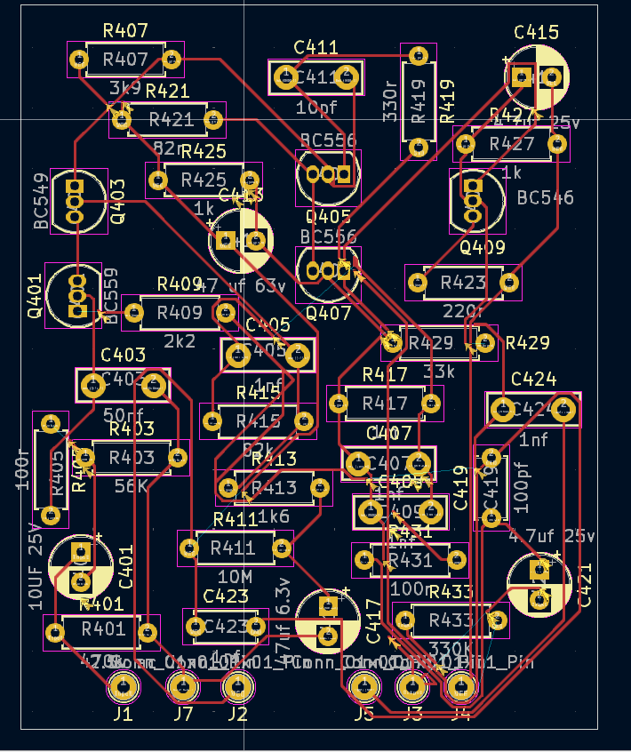

hi, all of the parts are laid out exactly as they are on the original board.
I see... You should be able to route the tracks according to the original then. Some of your parts are rotated compared to the netlist created fro the schematic (e.g. R407). KiCAD keeps track of all connections and ensures they go to the pin they are connected to in the schematic.
So for some parts like R407, you need to rotate them so the tracks can go the way they are on the original.
It might be easier if you post your KiCAD project and goldie, I or someone else gives you a boost. But of course I do not want to discourage you from learning KiCAD better.
OK - it's worth stopping & reviewing at this point:
  • start by hiding the 'fabrication' layers - so all the white text gets hidden - you don't need to see that info, and it wont appear on the final pcb anyway (in this case).
  • you've kept all the horizontal resistor footprints and not used any vertical footprints (as the original does) - that's fine, but it costs 'real estate' on the pcb, so makes routing the tracks more difficult.
  • the transistor footprints you chose (with 3 inline terminals) add a little complexity vs. the originals. It's a minor change, but adds a little complexity.
  • you've ignored my suggestion to leave the ground cionnections until later - so have added a bunch of un-needed tracks (see my above comments re. adding the ground plane), none of which are needed, and all of which add complexity...
  • J1, 2, 3, 4, 5, & 7 are also complicating things - just drag them off the bottom of the pcb for now and don't connect them with tracks yet. The bottom of the pcb shape, and the physical connection to the NAD amp has to be modified later anyway.
  • As you're developing the track layout, you also need to bear in mind - every track you add potentially 'blocks' other tracks, e.g., Kicad will not let you cross tracks, as that would violate the electrical rules.
  • avoid 90 degree track turns or junctions, use 45 degrees.
You need to look at part orientation and position much more, e.g., look at C401 - if you turn it 90 or 180 degrees you can make the tracks to R401 & R403 much shorter & neater (shorter & neater, is better), and, as 'mz543578854' says, the same for R407... there are quite a few others. You'll need to be critically looking at each component as you add the tracks, what's the best orientation / placement etc. to give the shortest, neatest, track layout... and, as you progress thru' the pcb, you may well need to go back and re-examine parts that you've already done... The original NAD layout & track routings do work and are a very good guide - BUT - they cannot be copied exactly, as Kicad uses straight line tracks, not the 'curvy' tracks of the original. That means slightly re-organising the positions sometimes.
I don't think I can talk you through all the changes... I have been thru' the exercise, and do have a rough 'first pass' layout, so, as 'mz543578854' suggested, maybe the easiest is for you to try to reproduce a picture of that ?
It's not perfect by any means, but it's functional, tidy, and would work (once finished). It should give you plenty of hands-on experience with part & track manipulation if nothing else. It's produced using your earlier posted zip file + my corrections thereof. If your schematic now differs at all, it may not be 100% equivalent, but will be very close provided you corrected your schematic as discussed.
