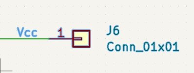

I'm not sure for Kicad 8, but in 6.0 the net label tool is on the right (it's where the add component or add wire tools are) - it looks like a capital 'A' above a line ('Add a Net Label')

when you add these labels, are they just dropped next to the item in question? Im just wondering how they end up associated to that position.I don't know what you have now, but your last post with a full schematic shown was #118 - none of the power rails, or the input or output nets, are labelled on that. The GND net is labelled.

I just use the 'Add Net Label' button, type the name in ('Vcc' here), and press OK - the symbol on the right then appears (as in the first image below), and can just be dropped onto the schematic wherever it's needed.
The small 'square' has to be dropped onto a wire, so that it connects - it'll disappear once it's connected (as in the second image). As far as I can see, most if not all of your are not connected - you can zoom in to see.
