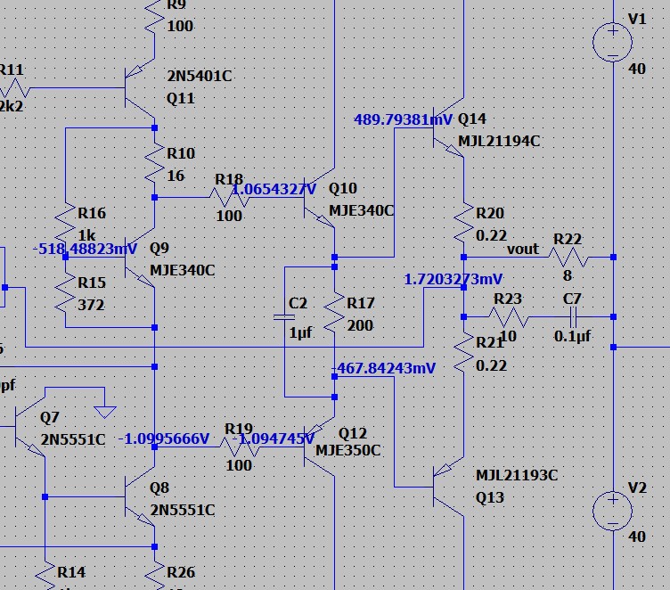

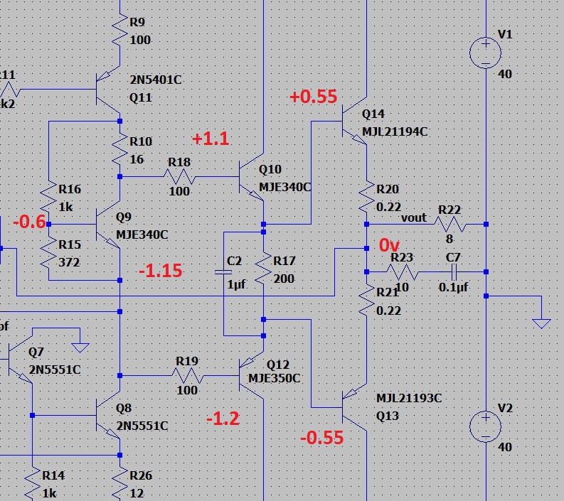

This is from a different amp but it is similar configuration. First image are what I would have 'expected' if asked. Second is what the sim says.
The voltages are all logical and and form a logical progression. So don't get hung up on looking to achieve certain voltages at certain points in the circuit because that will never work.
Get the midpoint correct first (short out Q609) and then take it from there.
