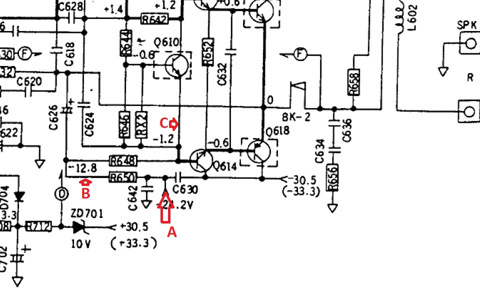

how do you see this being rigged up?
- NAD 3020b
