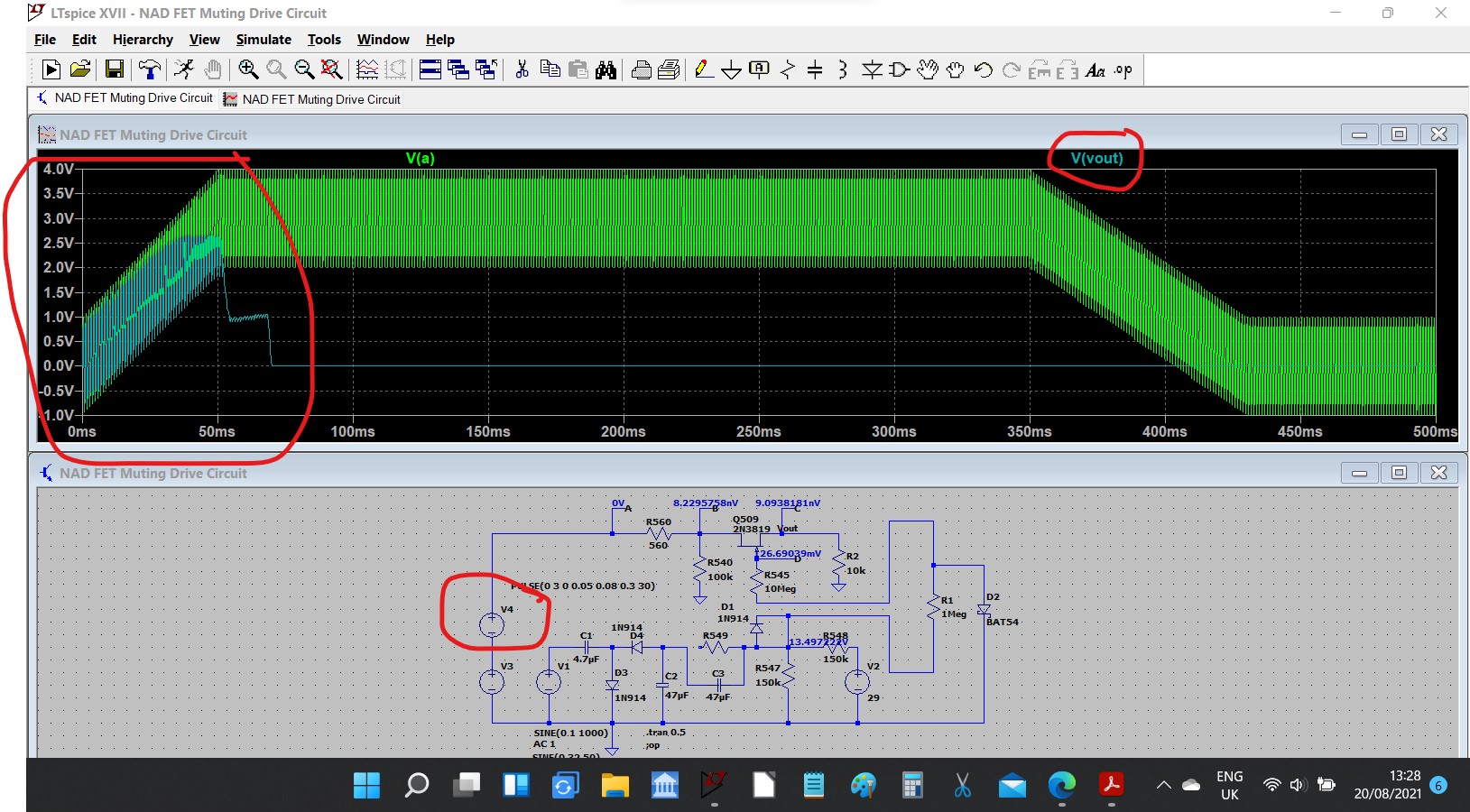

I've just tweaked the simulation to add a switch on surge to the audio input voltage. The input voltage now has a sudden DC shift as power is applied. That must happen in reality.
The FET's can not mute until there is enough negative voltage on the gates to turn them off.
The sim shows a brief pulse or thump getting through at switch on. The green trace is the signal from the preamp, the blue is the output from the mute circuit.

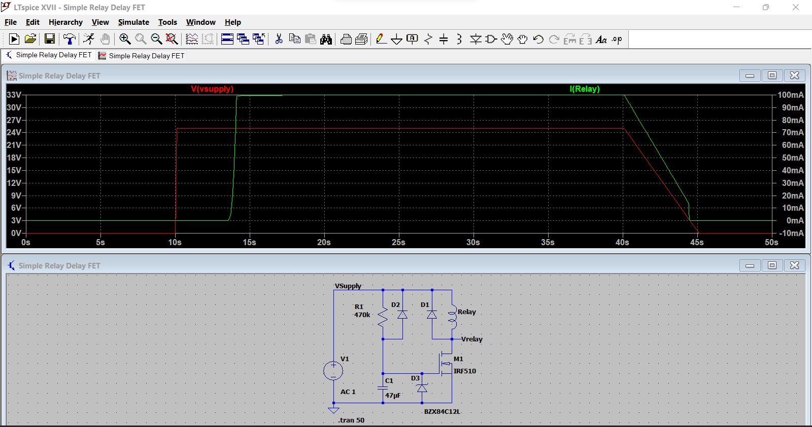

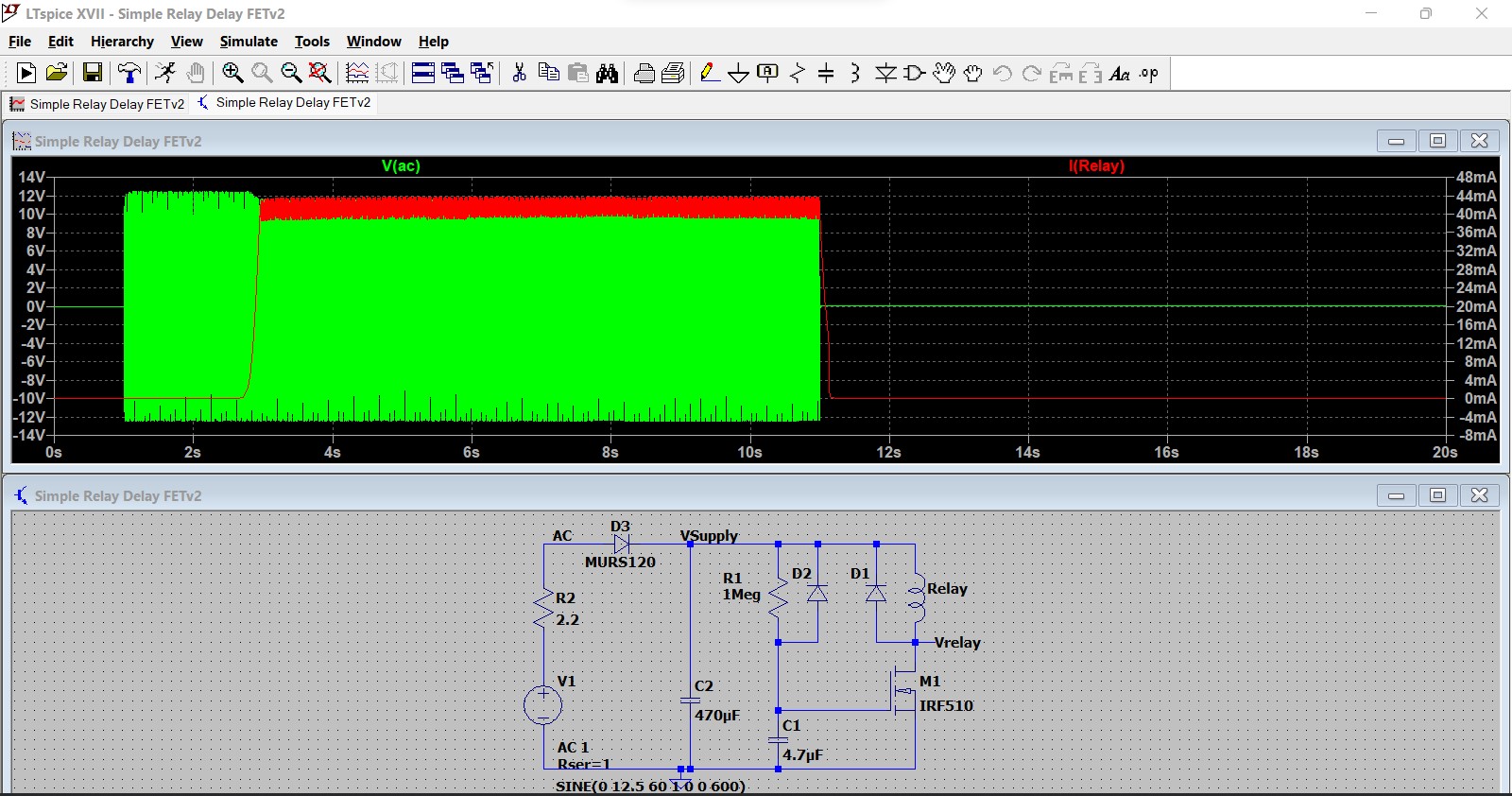

Try these. The first one gets its supply from the main DC rail in the amp. The disadvantage of this is that the relay does not drop out instantly at switch off but holds on as the rail falls. In many amps that would not be a problem because the amp keeps working for a while as the rails fall. As long as the relay drops out before the amp makes any noises then its not a problem.
The second one generates its own rail from the AC of the transformer. The reservoir cap is scaled to allow a fast drop out.
The trace shows the relay current and its timing relative to the applied supply voltage.
(The FET's used in these are power FET's and these type are normally off and only conduct when a G-S voltage of about 4v and higher exists)

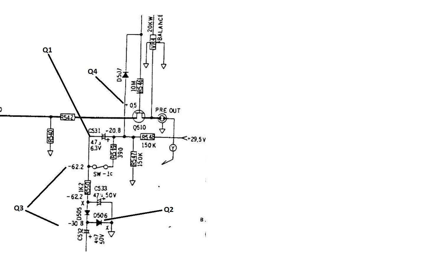

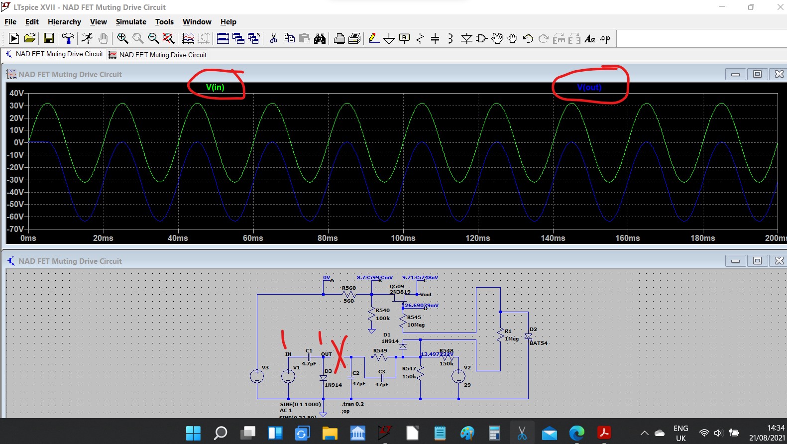

just a few questions about the attached
Afterlooking at your sim it makes more sense to me how the FET works with the
they are or will be obvious to you guys but i need to ask so i can understand if im looking at this correctly
Q1-i presume when the switch is closed the cap cannot charge
cap 531 is in parellel with R519?
Q2-why do you have a diode here?if it wasnt there what difference would it make?
Q3-why do would you start off with -30v, go up to -60v then back down to -20v
why not just go to -20v
Q4-how does this voltage suddenly become 0.5v
in your sim,if you also remove the diode D3 it appears to have no real impact,does this need to be there, like in the diagram?

Imagine the circuit without the switch contact or R519. The circuit works normally at switch on.
When you switch off two things happen:
1/ The switch immediately shorts out the cap and so that instantly applies a negative voltage to the FET gates and so mutes the signal. That negative voltage is the -62 volts on the diagram.
2/ By shorting the cap out it removes charge on the cap and so the circuit is ready to start again should you suddenly switch on.
R519 limits the discharge current of the cap into the switch contacts. Even a little cap will pit the contacts if repeatedly shorted out by the contacts.
The voltage from the transformer is lets say a 30 volt peak voltage, that's 60 volts peak to peak or about 21 volts AC if read on a meter.
The peak voltage goes 30 volts above ground and 30 volts below ground.
Capacitor C532 AC couples that voltage and so removes its absolute reference to ground. Remember caps do not pass DC.
So the output of the cap is now of the same amplitude but 'floating'. Its reference point to ground has gone.
D506 is used to 'clamp' the voltage and tie it to ground. The AC voltage (the 50Hz sine wave) is now clamped to ground and swings 60 volt below ground. The diode conducts when the voltage tried to go above ground and so the net effect is that the whole waveform shifts level downwards.
So we have level shifted the AC voltage from -/+30 volts that was ground referenced to one that is now 0 to -60 volts ground referenced (referenced via the diode).
D505 is a simple half wave rectifier used to generate a stable -60 volt rail from the 60 volt sine.
Look at the sim here. There is just the cap and diode in circuit. See how it level shifts the AC voltage. If we reverse the diode we would shift the waveform 60 volts positive.

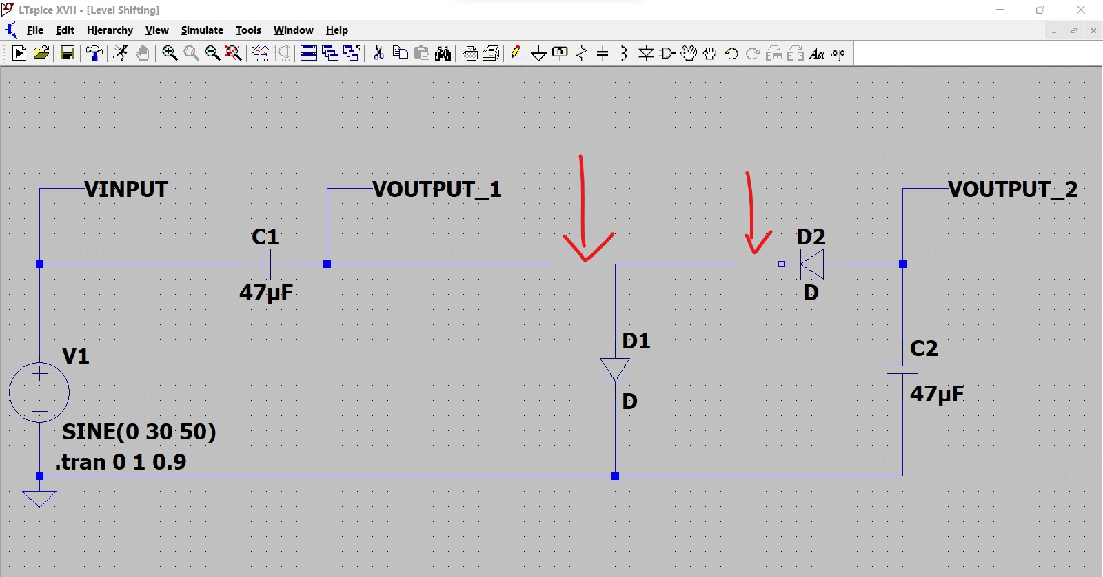

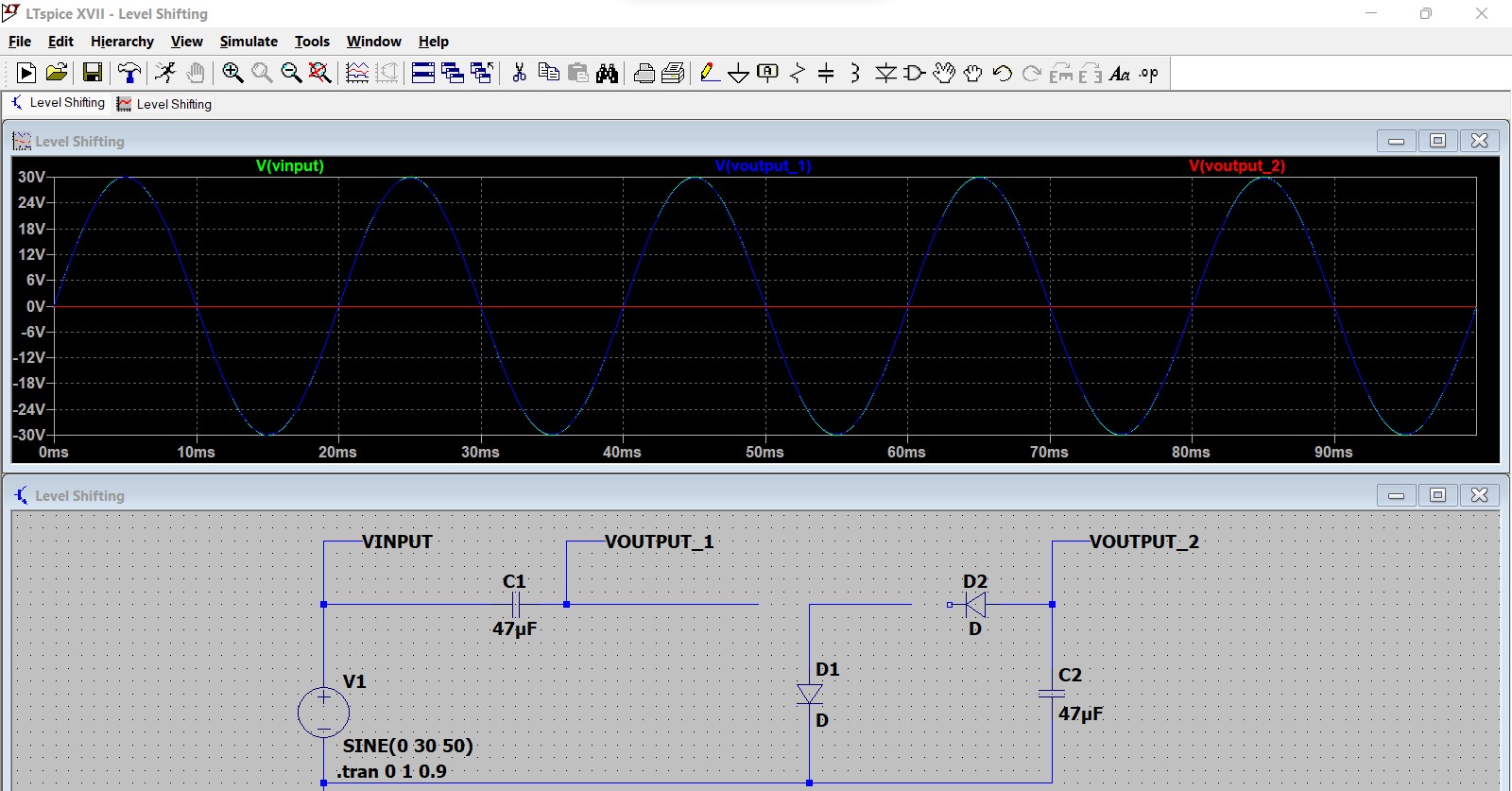

Try this and look at the waveforms of the labelled sections. After you have run it add the two missing links and then running the sim again before adding the next one.
Without the links you will see VINPUT and VINPUT_1 are the same but the VINPUT_1 end has no knowledge of ground. It is floating.
With the first link added the voltage is now clamped to ground via the diode D1.
The second link adds a rectifier to give us a smooth negative DC voltage from the level shifted sine.
If the level shifting was not done then we could only ever get a negative 30 volt rail from the input voltage. Doing it this way gets us the full 60 volt.
It is a simple Voltage Doubler.

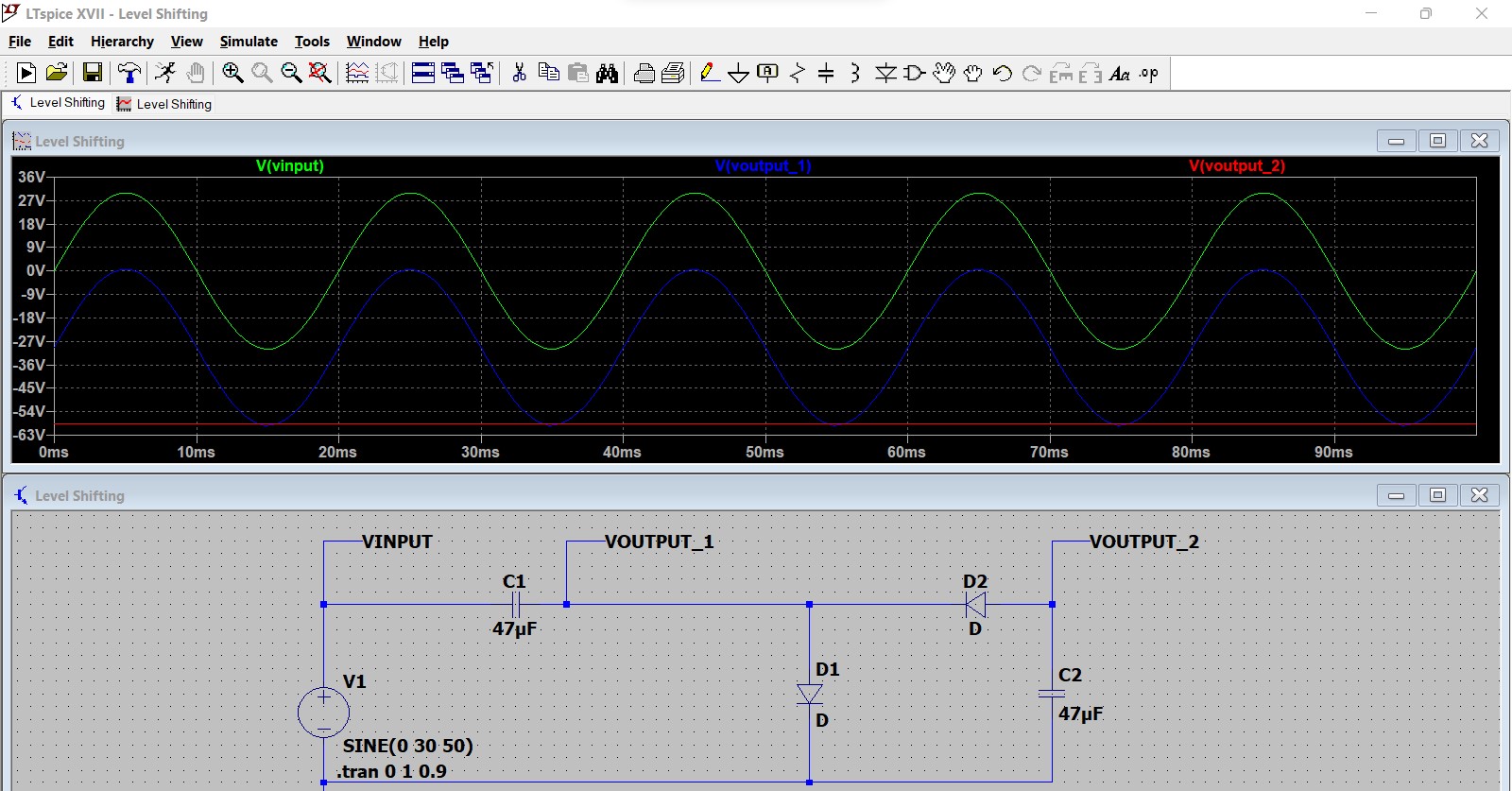

is there a reason why the waveforms are different on V1 output to V2 output?
so i do now see what you mean.
i guess this is what it would look like on anoscilloscope?
i dont have one of those, as im not sure i would realy benifit from having one yet.

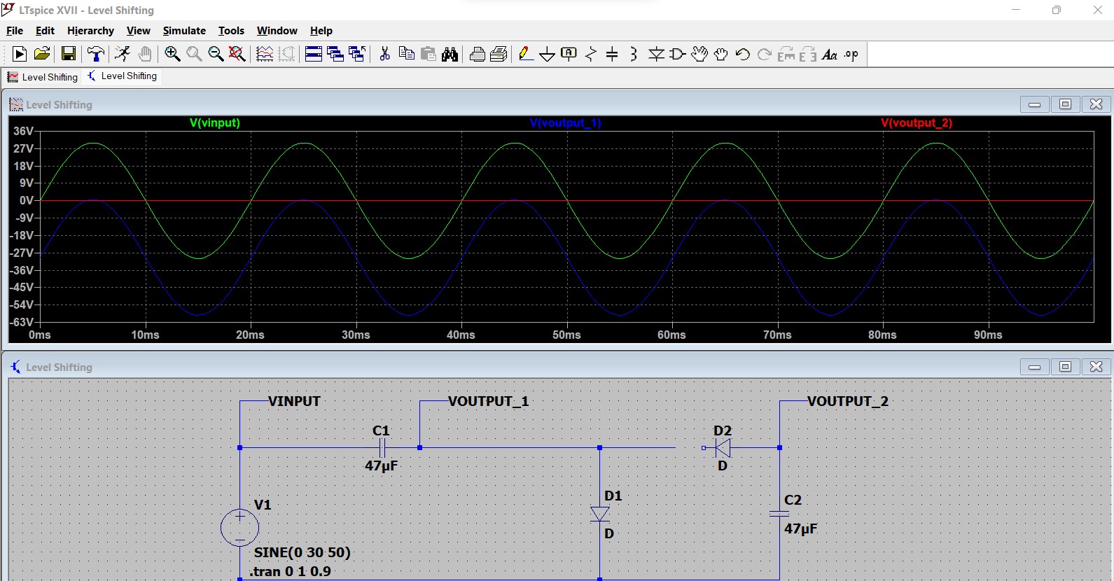

In the first waveform diagram VINPUT and VOUTPUT_1 are overlaid on each other. They are the same.
In the second waveform diagram we shift the level so that the AC sine voltage goes from 0 to -60 volts instead of going from +30 and -30 above and below ground.
In the third image we rectify that -60 volt peak to generate a smoot 60 volts DC.

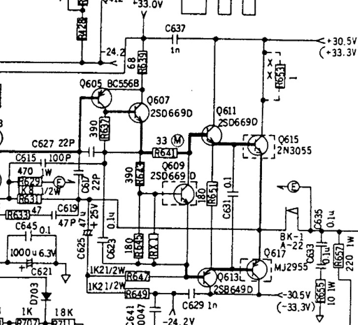

so it is definatly the idle current i think is casing the distortion.
i have no current at all across RX1 or RX2 with temp trimmers fitted across R653 and R654, no current at all, so this is the starting point
Slow down 🙂
The relay is to prevent switch on and switch off noise, nothing else.
The voltage across R653 and 654 is used to determine idle current. The voltage across RX1 and RX2 does not tell us anything about the idle current.
Reducing the value of RX1 will turn OFF Q609 which allows the idle current to rise. It is very easy to cause damage by reducing RX1 to much.
If you really have no idle current at all then check the voltage across Q609 C to E. You will not see any idle current until you have at least 2.5 (ish) across the transistor.
