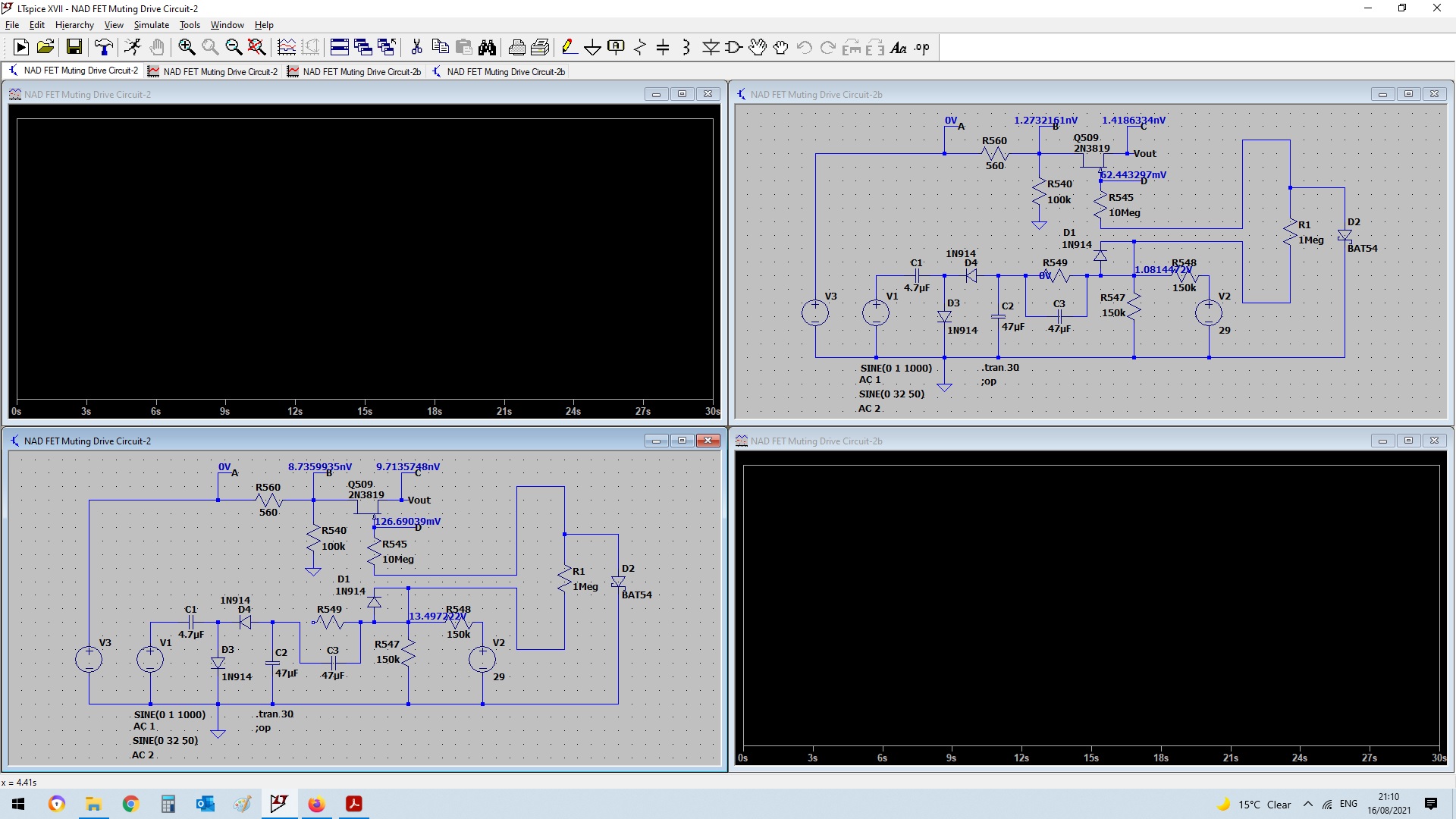

Didn't you have one of these faults a few weeks back and we looked at the sim of the muting circuit. Wasn't the auxiliary contact on the mains switch a suspect back then?

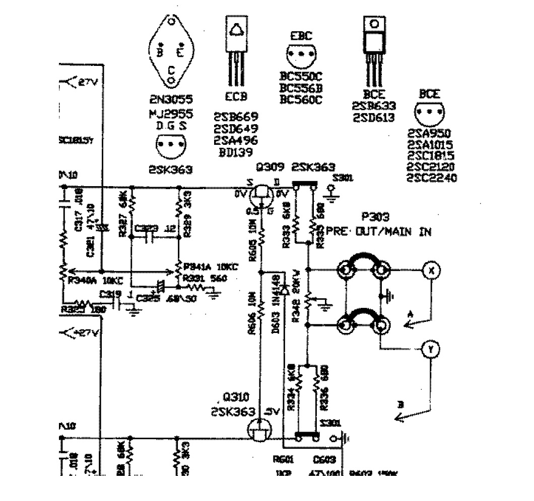

The mains switch could be a suspect with that auxiliary contact. Here is the sim for the NAD. The FET's mute the audio when the gate voltage is negative. They are wired as simple series switches.
These were the two sims I did earlier.

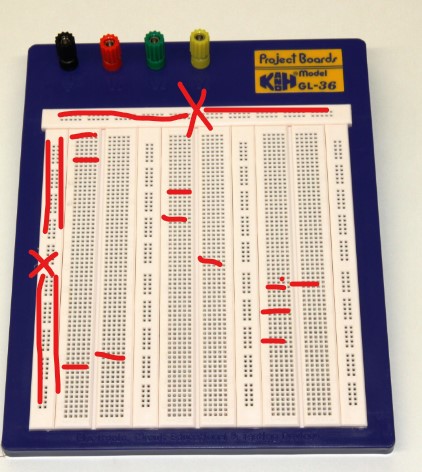

Breadboards...

R549 in the real amp is just to prevent arcing and pitting of the switch contact as it 'shorts' out cap C3. In the sim it is left open.
When the amp is off the switch is closed. When the amp is on the switch opens.

Look at the NAD circuit (the real one, not the sim) and D507 that goes to the FET gates. The diodes leakage current is more than enough to be able to pull the FET gates negative. The diode is reverse biased when muted (non conducting) but is still conducts enough to work and to be able to pull the FET gates negative.
3/ When the gate to source voltage difference is close to zero volts the FET is on (and so has a low resistance between D and S) To turn the FET off the gate is pulled negative by a few volts. How many volts is needed is called the 'pinch off' voltage and varies a lot between different FET's.

You can get a good feel for the FET with your breadboard and a simple circuit with a resistor and LED.

The FET's in that diagram are just connected as series switches. When the gate is pulled negative the FET is off and has a very high resistance (100's of meg ohms). So no audio gets through.
When the gate drive voltage reaches around -3 volts (guessing... typical value) and higher (so closer to zero) the FET turns on and has a low resistance of tens of ohms. So it passes audio.
If the drive voltage exceeds around + 200 to 300 millivolts the gate to source/drain channels conduct a bit like the diode volt drop across a b-e junction. In the NAD the 10 meg resistors ensure that current flow is microscopic. Remember the FET is voltage driver and so those 10meg resistors could just as easily be 100 or 1000 meg and it would still work.
