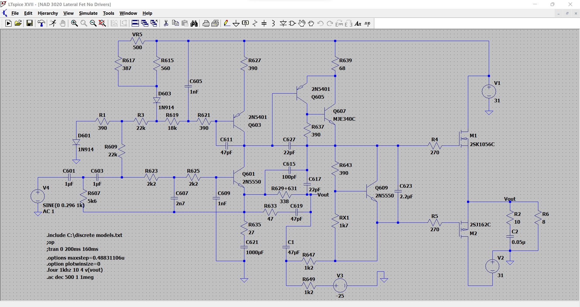

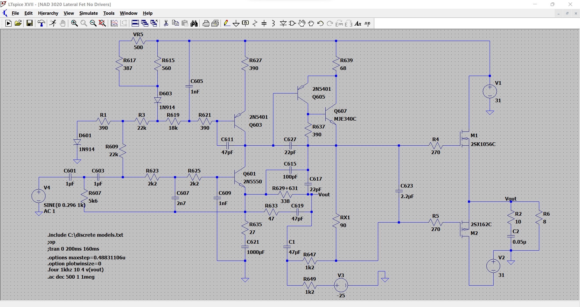

I was doodling with the circuit.
The Lateral's are super easy to drive and that allows the drivers themselves to be ditched in the NAD (I think it would work well). The VAS current is high enough to drive the capacitive loading they present.
We could ditch the vbe multiplier and use a preset or fixed resistor.

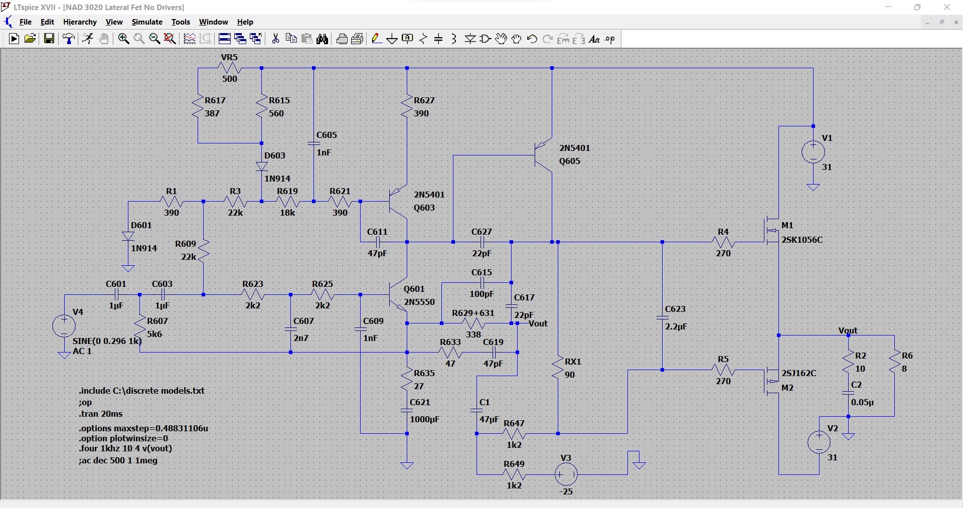

Going further maybe a different VAS transistor and ditch the quasi PNP/NPN combo.

Hmmm... its all about learning and trying different set ups. How about :eek: a HEXFET version. These have compatible pinouts to the original devices and are much cheaper.
Well it wouldnt be difficult to do
thing i notice on your sim is the preset value
with the drivers in place this value is currently 469mv on each channel, i notice yours is 1.7k

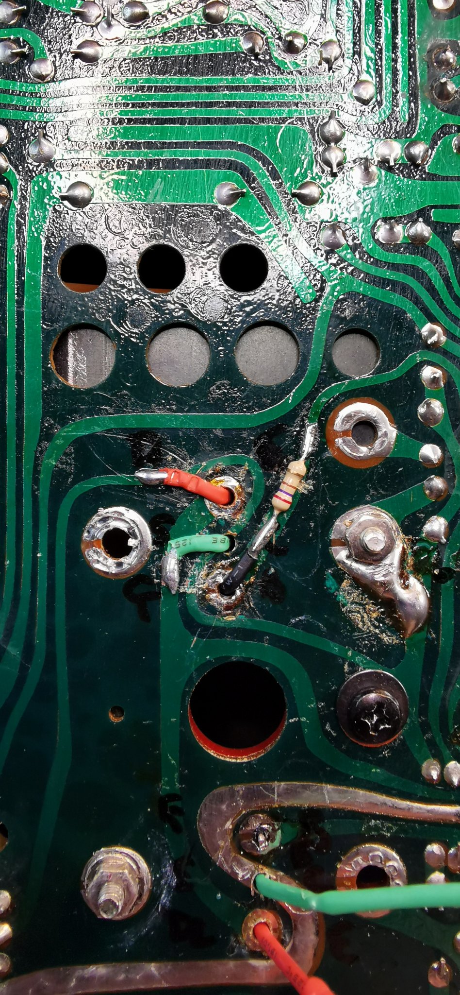

Joined 2021
nope nothing like that
it was difficult to site them though as the GATE/BASE stays where it is, but the collector/drain and emmiter/scource have to be swapped over underneath, so all legs need to be sleeved through the board so they can be crossed over the print underneath
this was the first early one and is basicaly what you have to do as the resistor has to be attached to the leg of the gate
im still learning all this stuff but its great fun,if a bit risky playing around with a perfectly good 3020 worth upwards of £200

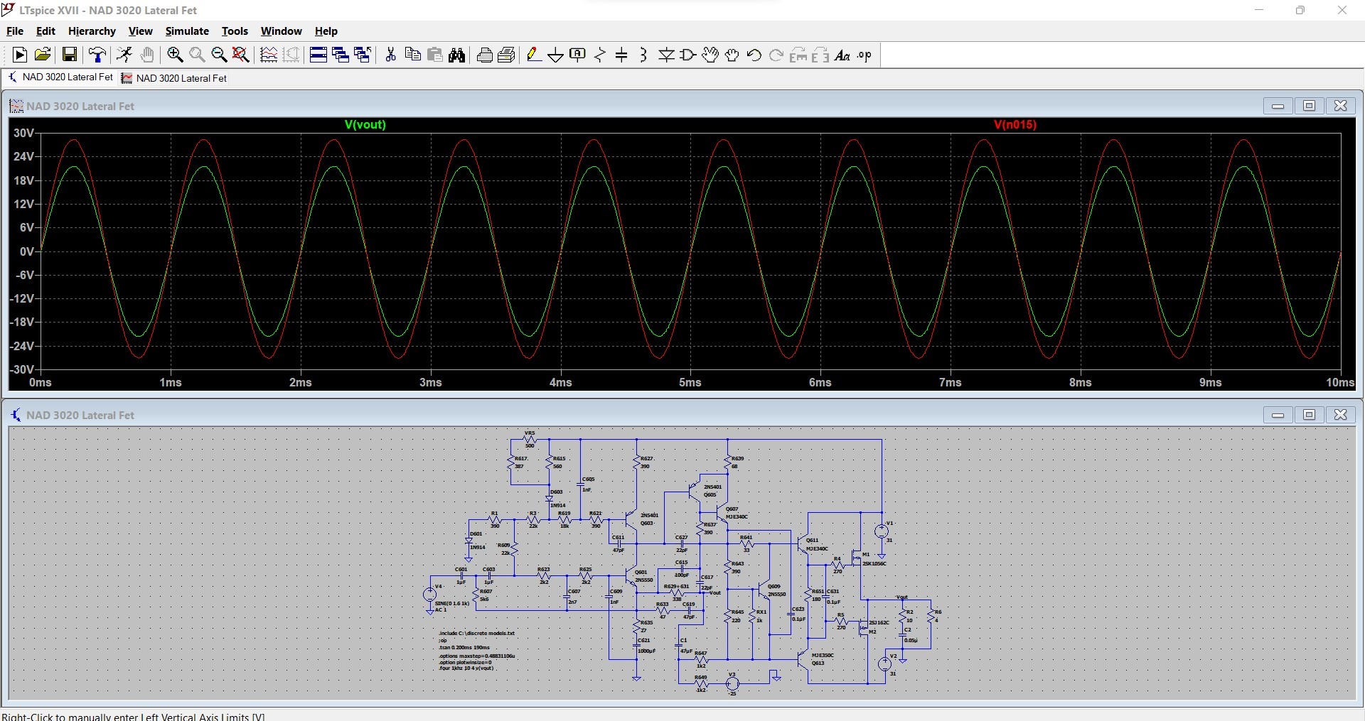

Hi Poundy, what's the output power with latfets/bjts?
same as the BJT'S
That's one for Mooly
I think what Jacques is getting at is that the FET's don't behave quite like ordinary transistors. Whereas a transistor has current gain, a FET has the different property of 'Transconductance' which is how much the Drain current varies in relation to the Gate to Source voltage.
This means the ordinary transistor can be made to conduct harder by supplying it with more base current. The FET gate works on voltage, not current and so to get it conduct harder we increase the gate voltage.
What all that means is that depending on the load current required (if we want more current), then the gate voltage needs to increase. The effect of that is that when loaded into say 8 ohms is that the driver voltage to the gates needs to go higher.

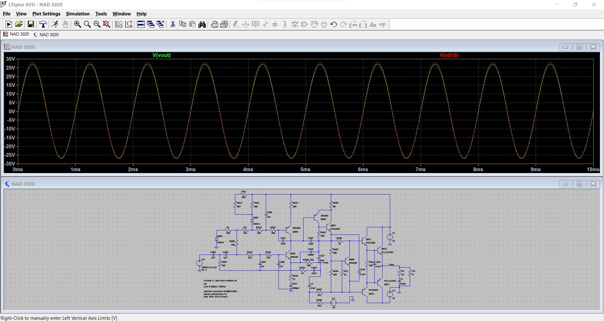

This shows the output voltage and the FET gate voltage. The load is 8 ohms. See how the drive voltage needs to be higher. This means that the amp will deliver less maximum voltage swing into a load than with ordinary transistors (but you won't notice that listening to it).
So our simulation using 30 volt rails we can deliver around 15.5 volts rms into 8 ohm which is 30 watts rms.
This is the standard version at clipping. This delivers around 19 volts rms into 8 ohm which is 45 watts rms.
Note... reality and simulation may be slightly different. Also note how the base voltage of the ordinary transistor doesn't rise like the FET does. The ordinary transistor needs more base current, the FET needs more gate voltage to conduct harder.
