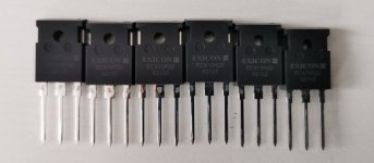

so i have all the bits i need to start doing this

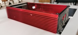

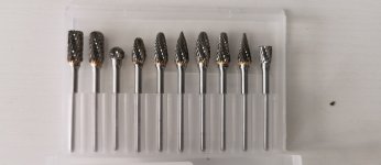

the FETS arrived today as did the sheet aluminium that i was going to use to make the new heatsink and milling bits that i will need to make the new openings but..........
i found a few old bits of IT kit in the bin so i nabbed the old heatsink off it, so i may look at using that.
not cheap this development bit, but its great fun

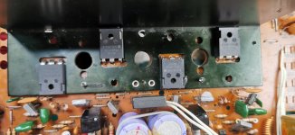

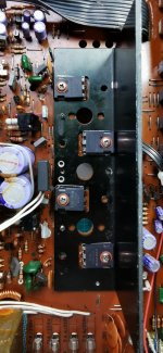

so i will be starting on this heatsink later today.
It is going to need some carefull thought about how they are going to be possitioned because of the resistors, but im sure i will work it out
its likely to be on the print side
OK so alot of work for nothing realy today with that heatsink. It's too big, so I'm using one from a mk1 version, you can tell its an early one as it doesn't have the double fold. But the FETS are in, and now I've just got to work out the rest, just dry fit for now and I've had to put micas on the back as they are not all plastic, but metal backed

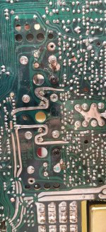

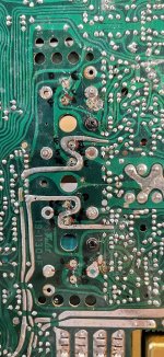

so the plan is now, that i want to do as little damage as possible, so that it can at any time be converted back
so the base/gate connection -i will make 2 cuts one near the main transistor connector and one further back.Then i can solder the resistor to the leg and to the print a little way back, i will also heat shrink these so they can short on anything.These can then be easily re joined at a later date if required.
Now the drain and source connections have to be swapped over, but there is a problem here, i cant cut the print or it will disrupt the on going connections so my thought is to slightly enlarge the hole of the current collector and sleeve/heatshrink the leg, then bend it over so it is close to the board, it can then be soldered to the emmiter connection(source) with a short hard wore connection, and i will do the same with the emmiter and connect it to the collector(drain)
it can be done neatly without destroying it that way

Its all looking very neat. What I would say is check, check and check again before finally soldering. Look at each transistor in turn, make sure you have the N and P channel parts in the right places and that each lead of each one goes where it should.
The Drain goes where the collector would have been and the Source to where the emitter was.
Also you should at some point (temporarily) remove the two fixed bias setting resistors. Hopefully when all is OK we can use a preset (and if you like drilling holes in boards 😉 then you could maybe think of fitting a permanent preset) but if not we need a way to select and fit new value fixed resistors.

Oh I can fit them OK, those 2 on the board though are proper tight next to each other so it won't be easy with presets. One might have to go on the print side
Sounds like a plan. So its either fit a preset as a permanent fixture or rig a preset temporarily with a view to adjusting it and then removing and fitting two new fixed resistors back in its place.
Up to you which...
