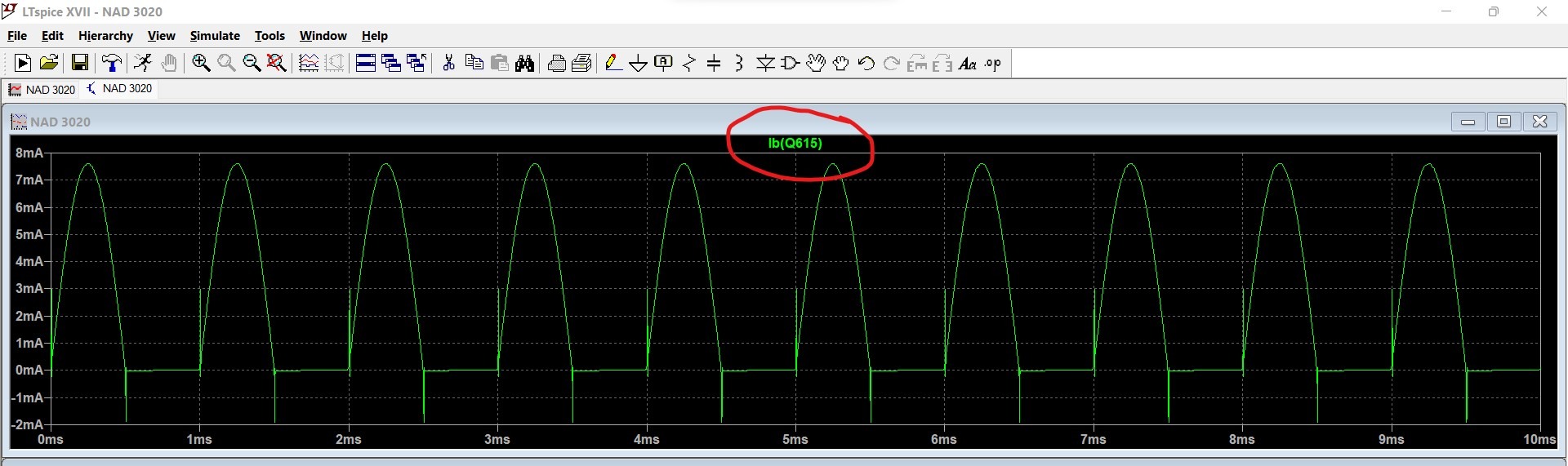

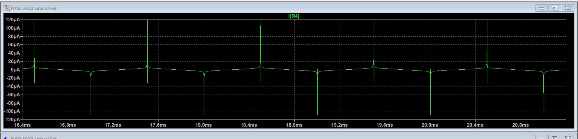

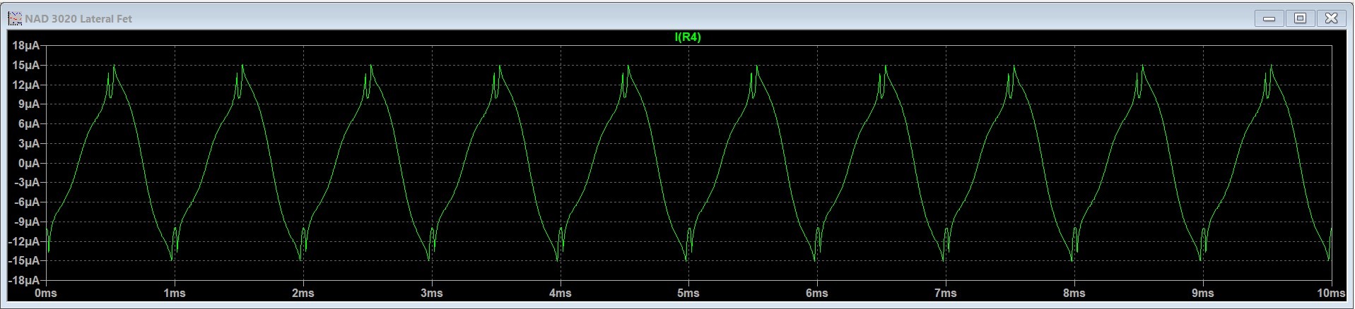

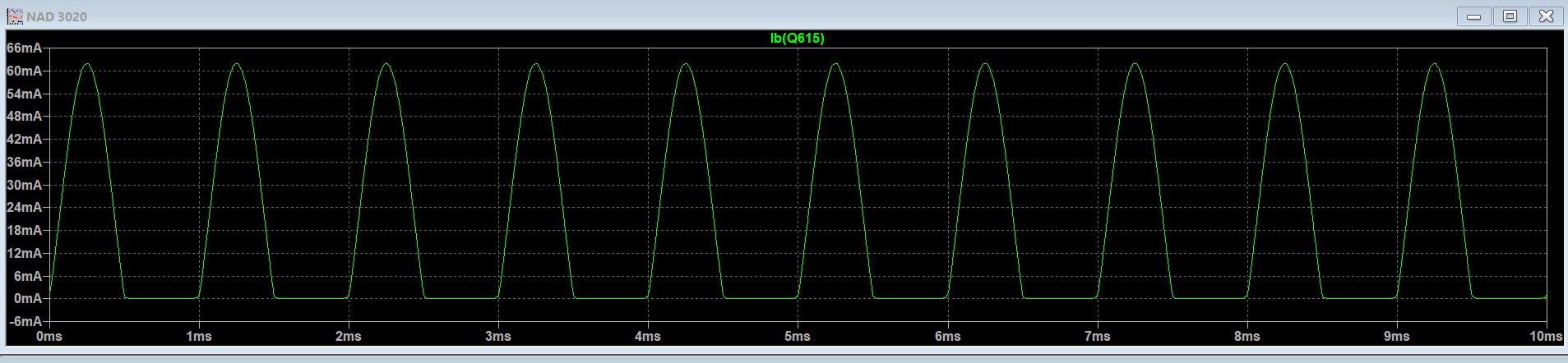

what are the very short drop outs at the peaks on the FET versionHave a look at these and look at the scales and units. The first is the gate current to the upper FET at full output, the second the current into the base of the upper output transistor in the ordinary version.
Good question, and they look terrible don't they?
The NAD is a Class AB amp and that means the output stage has to cross a region of non linearity as the signal crosses the zero point (going from + output to - output). The driver voltage has to 'jump' that region and so it becomes very non linear.
If we reduce the bias to a low value it gets worse.
What you see is the current suddenly changing as it charges/discharges the gate capacitance to move the output stage as best it can across this non linear zone. The output voltage will still look perfect though and that is all thanks to the feedback loop.
If we increase the bias current to cover the needed load current then the output stage is biased more toward Class A and does not have this zone to cross (provided the bias is sufficient for the load current).

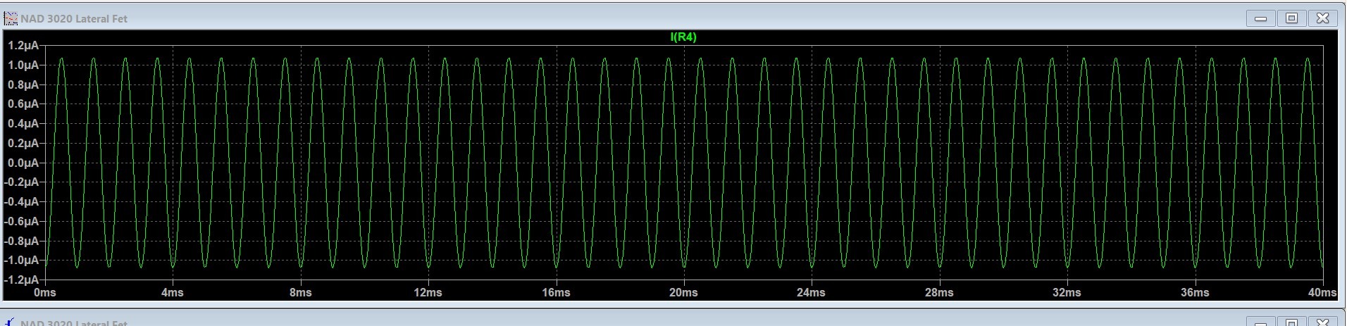

This is with a higher bias.
This non linearity in the crossover region is inescapable with a low bias Class AB amp, they all do it.
This is the ordinary transistor version and the base current into one of the output transistors. Anything but linear, but the output voltage is fine

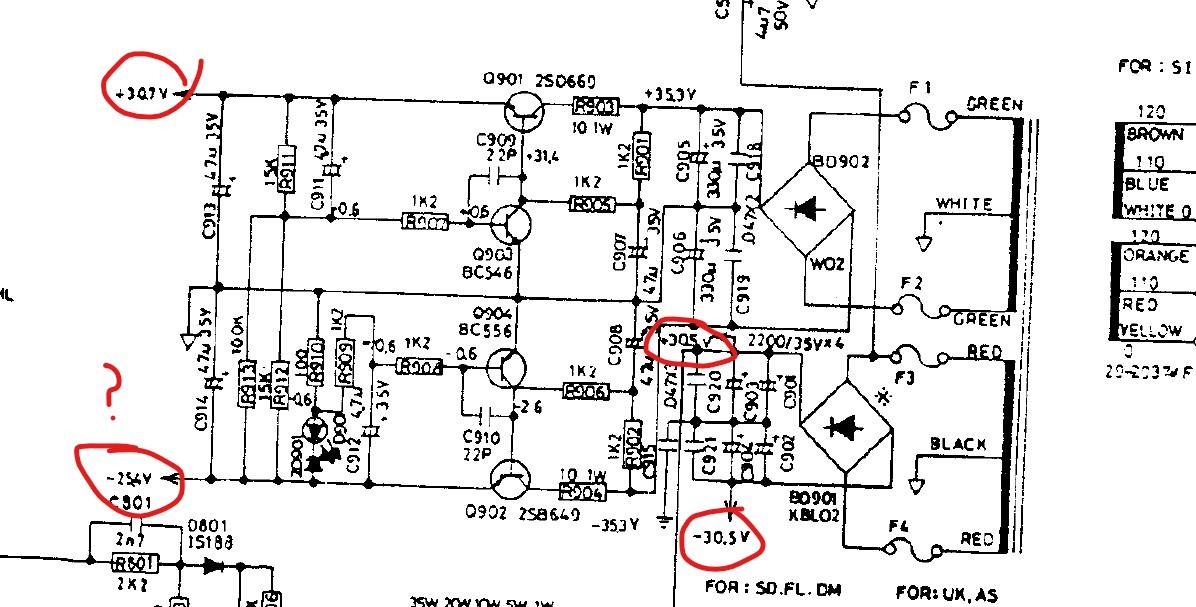

This amp already has separate rails for the output stage. Trouble is the driver isn’t higher by enough to fully drive mosfets. With a little power supply work you may be able to find a way to increase the driver voltage by the 4 or so extra volts needed. Might not be that hard to add another low current regulator. Certainly something to consider if building one like this from scratch. But getting the full output power like Mooly says just isn’t a big deal - it’s not like wasting 200 watts in heat like a bigger amp would.
Well it's driving this one just fine, no problemThis amp already has separate rails for the output stage. Trouble is the driver isn’t higher by enough to fully drive mosfets. With a little power supply work you may be able to find a way to increase the driver voltage by the 4 or so extra volts needed. Might not be that hard to add another low current regulator. Certainly something to consider if building one like this from scratch. But getting the full output power like Mooly says just isn’t a big deal - it’s not like wasting 200 watts in heat like a bigger amp would.
actualy if you measure the rail it normaly comes in at more like -27/-28vThere are just so many versions of this thing Interestingly the negative regulated rail looks to be set lower than the positive one and also neither is higher than the output stage feed.
It is what it is
this is the most common version, the later ones like we did the FETS on is alot later and this board was used for the 'A' version, which is why im keeping my eye out for an early one as it had the series 20 front cover and MC/MM, and i want to see what the board is like for conversion of others
