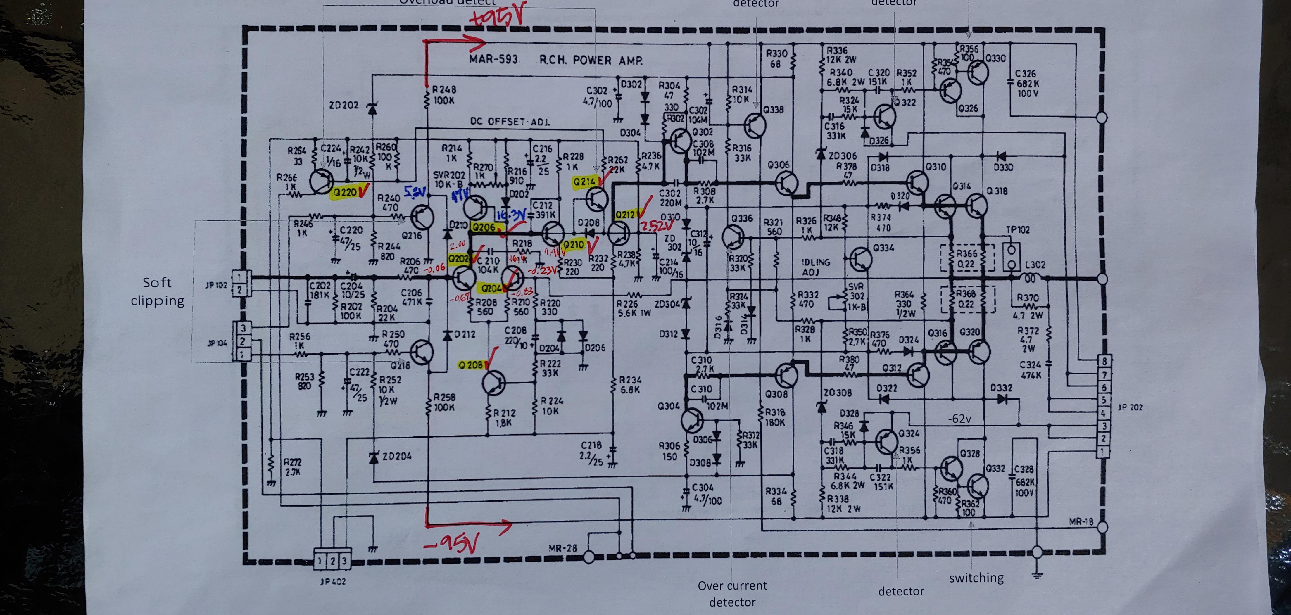

Here are some voltage measurements from both channels. This is with their respective 18V JPs connected, but 62V or 95V rails not connected. So, for instance, Q215/217 and Q216/218 don't have the correct operating point (their emitters are floating). Red ink are actual readings, blue are SM or pwdiya12 values. I used an "*" sign inconsistently, all voltage readings are 6/23 data.
I am still digesting these numbers, but one thing that's clear is that the different state of the alert LEDs with either channel connected seems to be closely reflected in the different voltage readings. If anyone ponders over these numbers and wants to share observations or thoughts, I'd appreciate it a lot.
I am typically looking for a few things when I do this:
- Vbe being a junction worth of drop (~0.6V)
- signs of shorts, open junctions (same voltage on two legs, of too wide drops across a transistor, such as C to E, etc.)
- matching conditions to what's published in SM or by others (thank you, pwdiya12).

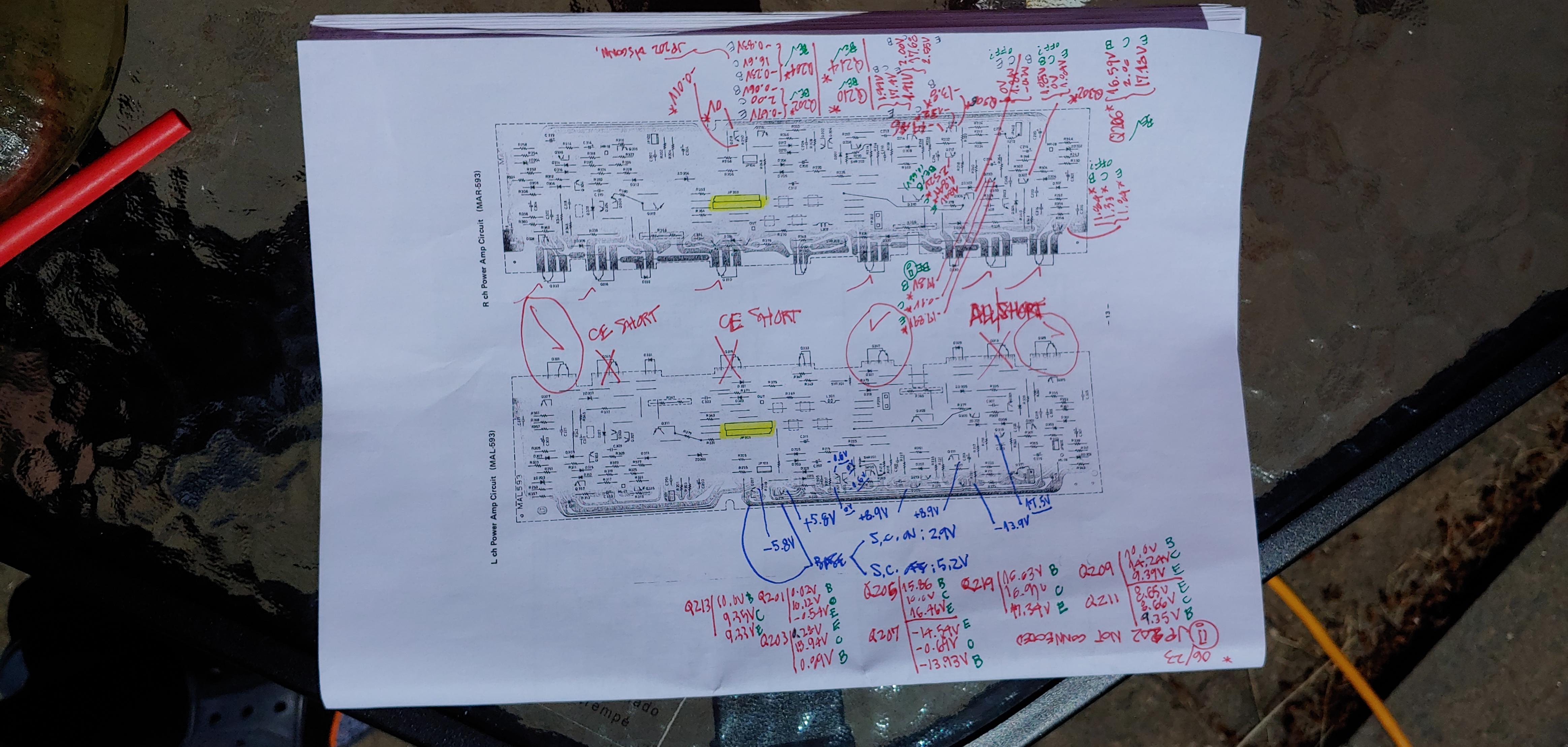

good work so LH channel voltages look OK can you measure the RH channel in the same manner? I would power up the left channel and check the rest of the voltages, I think they are likely to be OK. Then we can wrestle with the right channel and see what else is fried- if anything

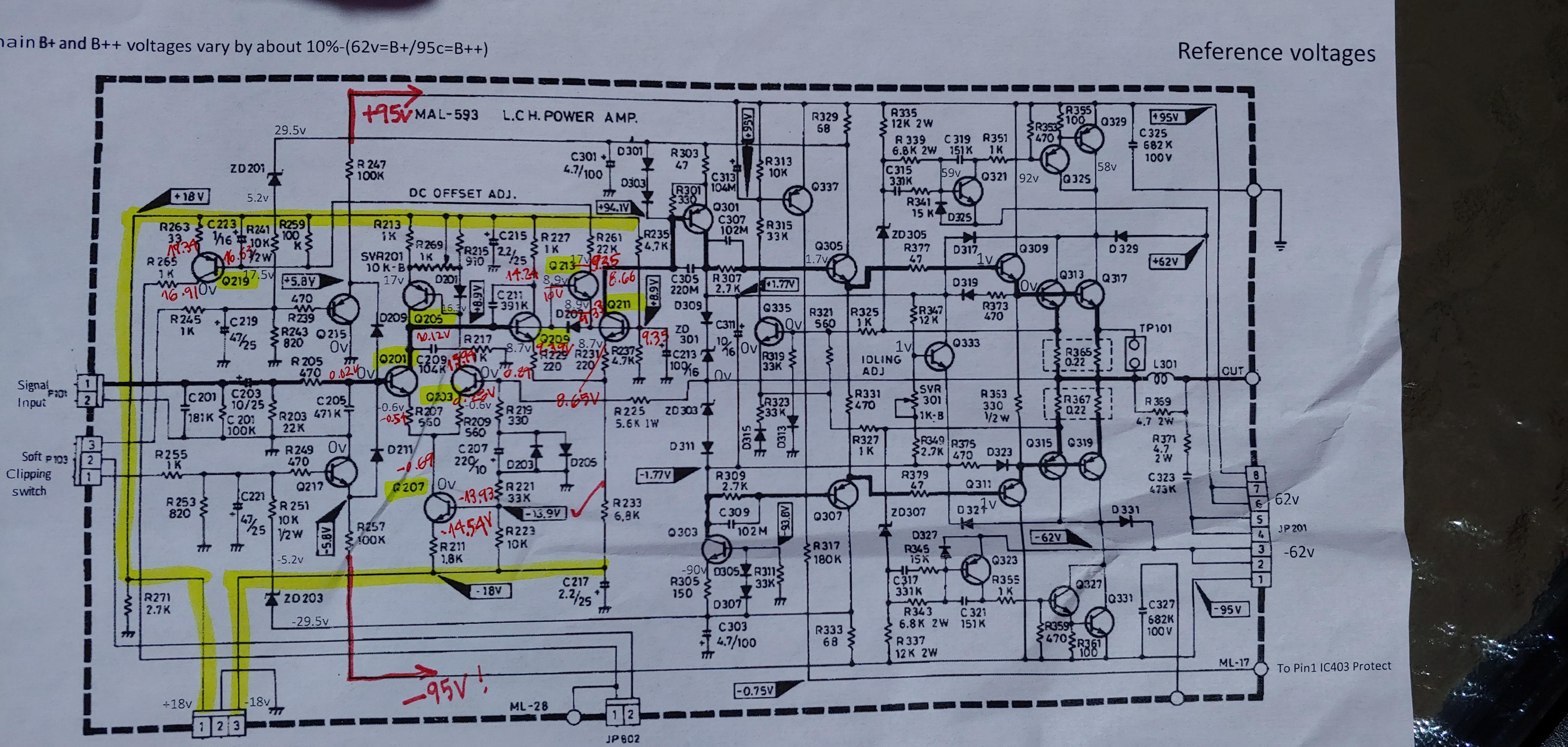

Here's a more complete, and better organized scan/annotations of readings.
Some thoughts:
- The Q201 collector node is much higher on the "faulty" channel (L) - about 10V vs 2V. That said, the schematic calls for 8.9V there, so it's a bit confusing which channel's really broken. But that "lifts" the O/L detect Q213 and Q219 to a state that generates:
- 0V out of Q220 collector
- 17V out of Q219 collector, and to the fault LEDs, respectively.
That said, I don't know how this gets reported from the L channel, as - against the schematic - in my amp only the R channel has a JP802... But if this is the case, this may explain my LED alerts and make them a bit irrelevant (given I only power one board at a time).

A question I meant to ask for a while is - does anyone know the starting position for the adjustment pots (bias and offset)?
In other SMs I used a minimum bias position to start adjustment from, and usually a mid point for the offset adjustment, is noted. In this amp's SM, all they list is the values one should adjust for, but not where it's safe to start from. Especially having replaced some of the power transistors, this definitely needs readjustment, and cannot assume the current position is even in the ballpark.
I'm past half way through the boards in diode testing Qs, and I just can't find anything wrong with any parts in the input circuitry. The easiest way I've found to do this is to suck the solder on two of the legs and test out of circuit but in place.
I wonder if my voltage differences from one channel to another come from different DC offset adjustment points.

If there are differences in the offset and you cant find any faults in the passive components then adjustment is required at the input differential pair to BALANCE out the differences due to gain differences if they are not a Super-match Pair.
Duncan - not talking about offset at outputs, but differences in voltages between the two channels (see my recent PDF attachments). I can't find any further faults in both active and passive components at this point. True that a whole lot of them were initially blown, but they're all replaced a bit of time ago.
A frustrating case scenario in something like this is indeed that in which something seems to be wrong (different DC voltages between L/R, see PDFs) and all parts seem to be working, no matter how many you check. I don't feel I can deem the input stages working just because I can't find faults to components, when I measure and there's distinct differences, and alarm lights act differently too.
Have you checked the diodes for leakage ?
I diode-tested some, but not all. I'm also considering replacing all zeners as I have plenty of the correct voltages. I dread shotgun repairing, but with the zeners, I'm not going to hold it against myself.
My working hypothesis is that Q202 has a "dropped" collector (2V vs 8.9V expected and 10V in the other channel), so I suspect some undue conditions either on its base biasing (R204, R206), or its collector - where I think that's there is a current source (Q206) that balances the pair driving Q202 harder or leaner, and thus providing output DC offset adjustment. For instance, per your point, Duncan, D202 is a diode I have not checked yet. This "low/2V node" condition I suppose may lift Q214/Q220 for the other unruly voltages I see.
So this is my next investigative step. I welcome feedback, of course, and thanks in advance.
