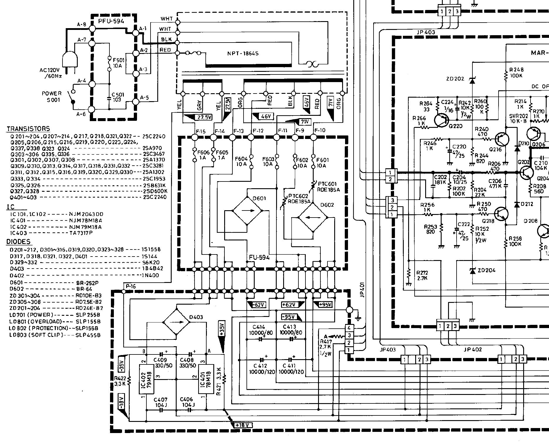

Sucking solder out seems to allow me to disconnect various parts from that node, so that's how I did this.
- With the 7918's output disconnected from the circuit (but supplied from it), I'm getting a bit under -20V out, which is a bit high (in my test fixture, I measure -17.8V out of it while applying about -29V in), but I assume this slightly elevated value may be due to the input voltage being so high, and actually a bit over its absolute max (the part I'm using, ST Micro L7918C's absolute max input DC is spec'd as 35V, while the 7818 JRC - the JRC 7918 doesn't spell this out - says 40V)
- when I connect it back, but have R422 disconnected, the voltage is maintained
- when I reconnect R422, the voltage jumps up to this high value of about -32V
R422 measures an expected 3.3k.

Given all this, it seems somehow R422 lifts "up" that rail. I've looked this up in the data sheets and on, but can't find this bypass resistor anywhere - not sure what is its role. Thinking of taking it off, and seeing if things get back on track. May also put back the JRCs, as they seem to handle better the high input DC (which, for reference, in my unit amounts to about -36V).

R422 bypasses the 7918 and for load currents of up to 5mA, the 7918 essentially does not power the load, the resistor does. With R422 removed and the output pin of the 7918 elevated off the PC board, use your meter in current measuring mode to complete the circuit from 7918 output pin to PC board. How much current does the load circuit take from the 7918 with all connectors plugged in?
I don't know why NAD even used R422 in the circuit as it looks to be unnecessary to me. At light loads it causes the voltage to rise beyond the 7918's output. I would try moving R422 to the output of the 7918 as a load to ground. Then the voltage should settle back to -18V.
With the 7918 output pin completely isolated, I would not expect the voltage to rise above -18V even with a highish input voltage. That's a bit odd along with the rest of this issue.
Once the load current for the 7918 is determined, a resistor can be added to the input to drop the input to 30 volts or so, just to test if input voltage is an issue.

Bill - thank you, I wasn't aware of this - let's call it "low current behavior" - where this switching series resistor voltage drop / voltage regulator occurs. This explains what I'm seeing quite a bit. Not sure why the 7818 behaves differently and predictably while the 7918 does this, but it doesn't quite matter ultimately. I think I'm just going to remove the resistors.

Here's the relevant part.
The load on the 7818 appears to be greater than the load on the 7918 so the bypass resistor has less chance of pumping up the +18V output. I would remove the resistors since they can cause overvoltages and some capacitors are 25V rated. I think the load on the 7918 is less than 20mA, and most of the current is to power the NJM2043's.

The main schematic is attached.

Thanks Bill & Rax for the power circuit diagram but the 7918 legs don't number the same as the standard connections -
Standard= leg 1 Earth--- leg 2 In ---leg 3 - Out
LM79XX 20110907.fm - LM7918-1306745.pdf
IC 402 has 1=out---- 2= in----3=earth ???
IC401 has different numbers than standard also ?
