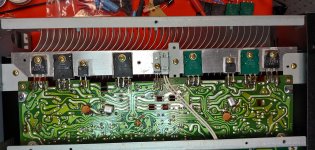

Got the parts, back to work.
Here's my toll this far:
- Q313, 315, 319 failed. I got the MJWs in at this point (for good measure, also replaced known good Q317 to create a good parallel pair). As said, I further replaced Q303, 307 and 323 (failed, literally broken or suspect).
- drivers (Q309, 311) seem to be fine.
- ZD303, D311 failed. Replaced with 10V zener and 4148.
- R325, 327, 363 failed and replaced. Replaced also R323, as it looked bad though I think it measured OK.
- I didn't get to checking all other semiconductors, as things seem to go back in order as I go away from that area. Spot checked other parts and didn't find further trouble.
- started recapping the board, almost done. I've read recommendations to up C215/217 to 470uF by some testimony, but I'd like to hear some thoughts on this. My typical approach here would be to use a 100-220uF in parallel with something like 10-100nF film cap.
- on the good channel, I checked all heatsinked Qs and they are all OK.

Check the voltages from the PS- the ribbon cables can be removed, but be careful as if you insert them back the caps will still have a charge and sparks will occur.
If the overload detector is always on then check Q214 and Q338 and associated components
I have attached a slide which shows what each section is doing- try to break the diagnosis into up to Q212 and then following on from this.

@rax- a couple of choices here.
1) build a dim bulb tester (lots of info here on what and how), which will tell you if the amp is drawing too much current and avoid the "magic smoke"
2) as one channel is OK you could disconnect the cable for the PS to the bad channel and then check all the voltages on the PS ( +/- 62v/+/-95v and +/18v)
3) remove both cables for both channels and test PS voltages.
In cases 2 &3 the main caps will not discharge for quite some time, so you will need to discharge them with a couple of 2W resistors (again load of info on this), before inserting them back into the amp board sockets.
I would suggest option 1 as the best. If it keeps drawing too much current then cold bias will help figure out which section (input VAS etc or output) is causing the problem. An alternative is to test the good channel to convince yourself the protection circuit is OK and then proceed to the bad channel. The protection IC can go bad/be fried as can some of the components around it- also the 18v regulators can give problems- though generally this is not the case
BTW at idle the current draw should be a stable 0.5A

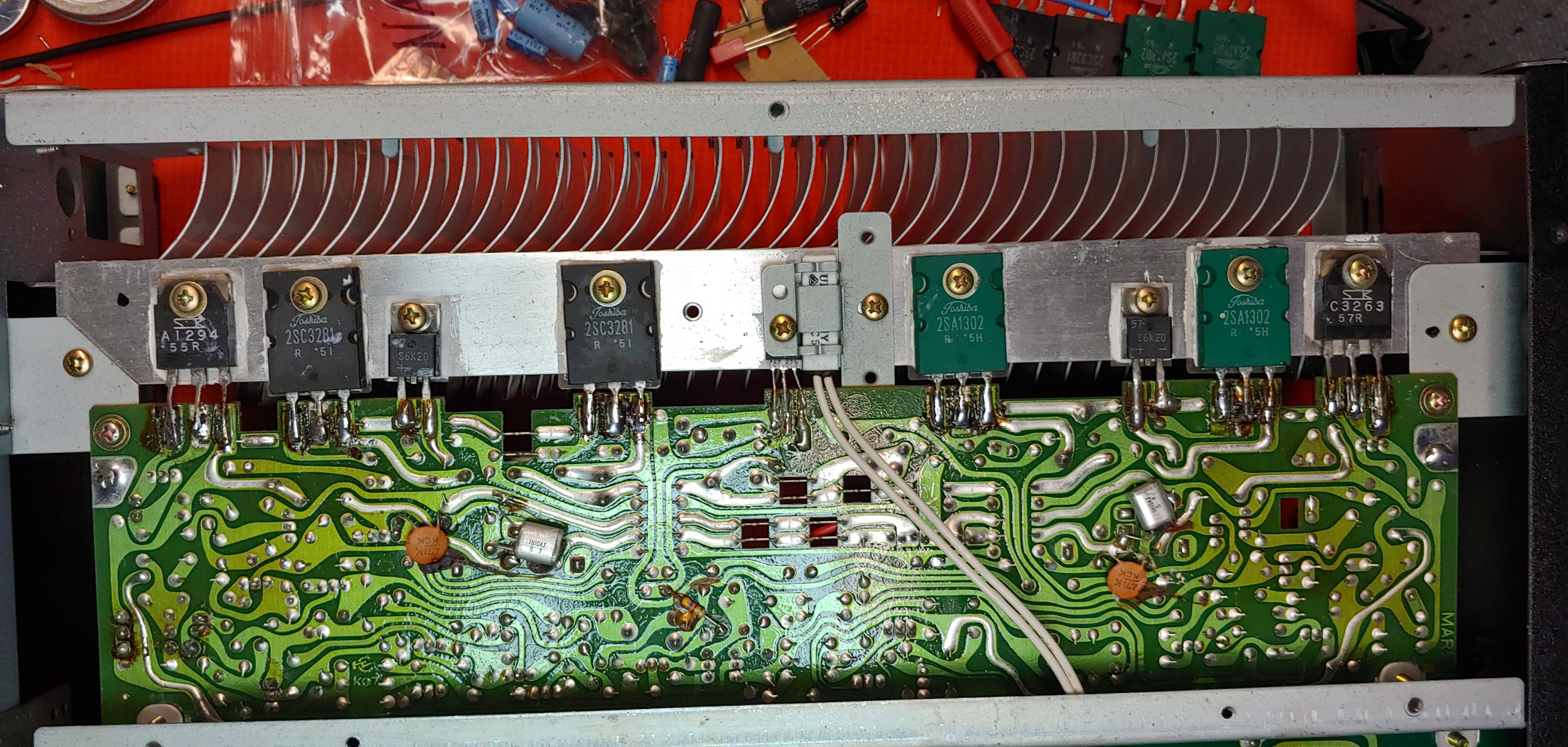

But of course you're right and I do have one available. Given all the parts I've changed I think at this point I should be ok firing it up as is with the LBT. If I don't get any crazy draw I'm likely over the top of the hill with it, and may run it normally and check for all things for normal operation and finalize the recap.
Interestingly, my sample uses 2SA1294/2SC3263s for the "headroom switchers" (Q329/331). I believe originals should be same parts as the final amplifiers (2SA1302/2SC3281). It doesn't seem like an ulterior replacement (as in repair job), as both channels have them. Testing fine so will leave alone.
The Sanken's are retrofits by someone- they are fine replacements. What is the serial number range- (first 4 digits), and on the amp boards - what version are they?
Boards are MAL/R593A, and S/N is 51002401. There's also a "B" on the S/N sticker, not sure what it is.
This also tells me the hands that have been on this are more than... two. Some of the more difficult repairs I've done were those where someone else, and at times what seems to be multiple techs, have messed up and a lot of the effort was cleaning up and doing it straight forward and correctly. Not really the case with this this far, from what I can tell, at least this far.
