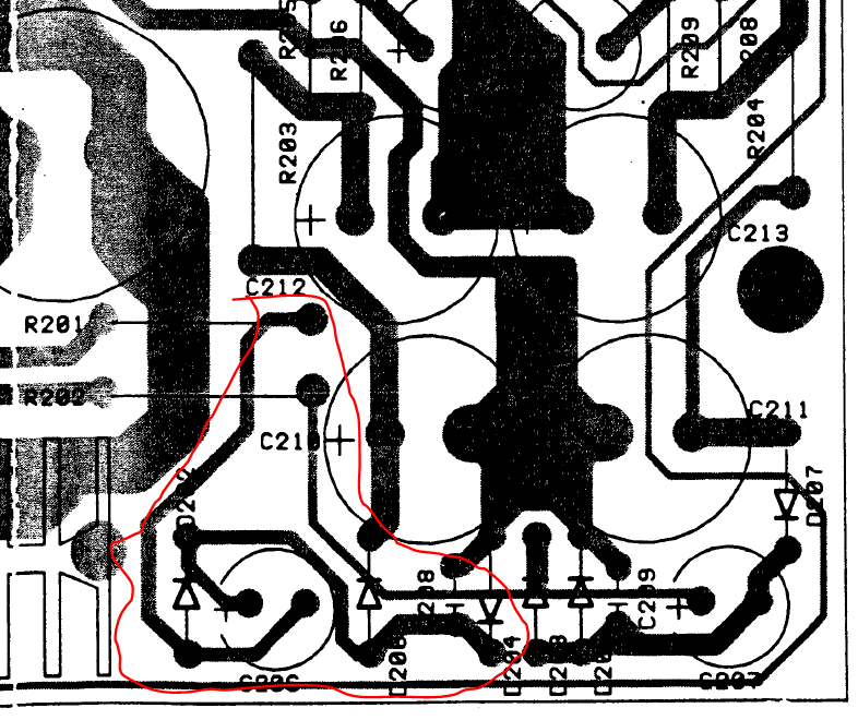

But other way is, take R203 out, install jumper on R201 place and measure DC voltage on C210, if it is somewhere +90V or maybe higher and nothing is burned, then circuit on right side of R203 is OK and it is safe to install jumber on R 201 place and R203 back as R203 will limit current, if somethig is bad on leht side from R203.
Did you measured DC voltage? C210 not grounded pin is + pin, not - pin.
If yes, then is needed to check again all components right from R203 until R201 and traces marked with red on image.
I’m sorry for not replying, been busy. So, at last the red led turns green however I took two steps forward then one step back. While I was measuring D204 I slipped my probe and shorted, it blew, taking some traces with it, after that I got frustrated and decided to just buy all the electrolytics, diodes and some resistors. I replaced all the electrolytics on the power supply board and replaced R201, D202, D203, D204, D205, D206, D207, C208 and C209 and repaired the traces with jumpers. I did the alignment procedure too.

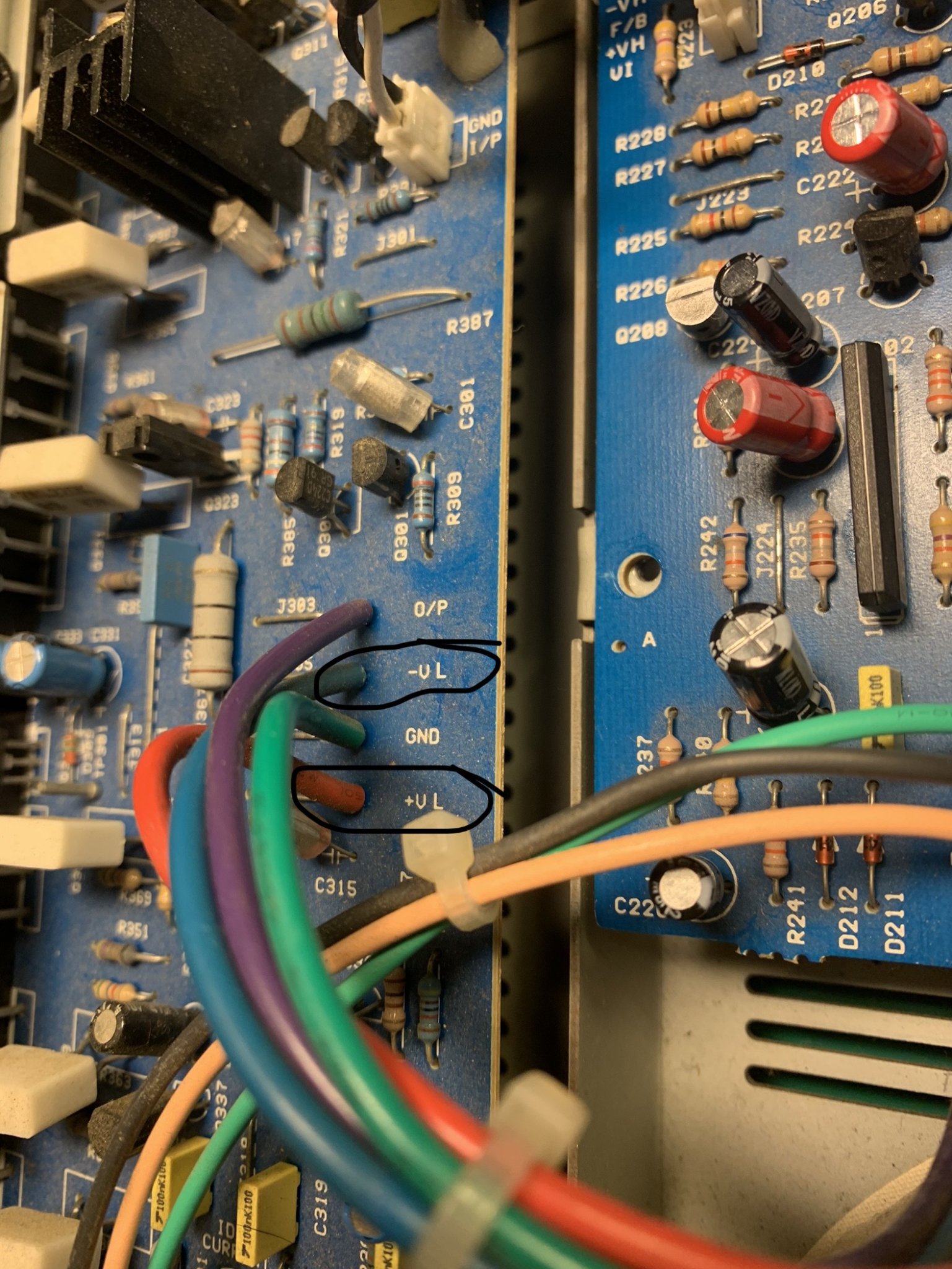

Unfortunately I do not have an oscilloscope. The positive and negative 67 volt on amplifier boards would that be the places marked on the photo I attached? If so then I’m only getting these voltages:
Right channel
J306:-58.8
J310:58.7
Left channel
J305:-58.7
J309:58.8
But I think I’m misunderstanding what you mean

+67 and -67V are going also to amp boards for input and VAS stages supply thru JP303 and JP304.
Had you sound card on PC with protected input? It can also be used as oscilloscope, but you need to be sure not to kill inputs with over voltages as amp give out more than sound card can handle. I use for over voltage protection on 2 V RMS full scale sound card input 22 times voltage divider from low ohm resistors.
The negative and positive 67V appear at the amp boards, I’m not ready on sacrificing my sound card just yet for this (considering this is probably the only amp I’ll be repairing, time will tell)😅 maybe we can figure something out without an oscilloscope. I have recorded IC201 and O/P voltages and they seem to my eye to be similar (the pattern of change) although the voltages differ quite a lot
