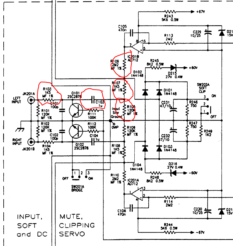

You had very different measurements from same points. Probably somewhere is bad contact/soldering or some resistor or capacitor is faulty.
Try to measure this components on image ( measure resistance and/or capacitance when power is off, in first step no need to solder them out), are you getting stable reading?
Can’t measure capacitance, don’t have the equipment for that but I can do the resistors:
R103: 1.486 kOhm stable
R105: 79 kOhm stable
R107: 1.486 kOhm stable
R109: The longer I hold the higher it gets but the readings started at around 960MOhms
This is still with Q101 out and D101 and D103 out. The results are taken with the resistors still in the pcb
Change IC201 back to original. It is very unlikely that new op amp is faulty but measurements shows clearly that there is something wrong with it or related components.
But this is definitely not the only fault in this amp. Something is generating low frequency noise but I am out of ideas what it can be, the fault is somewhere on the last image.

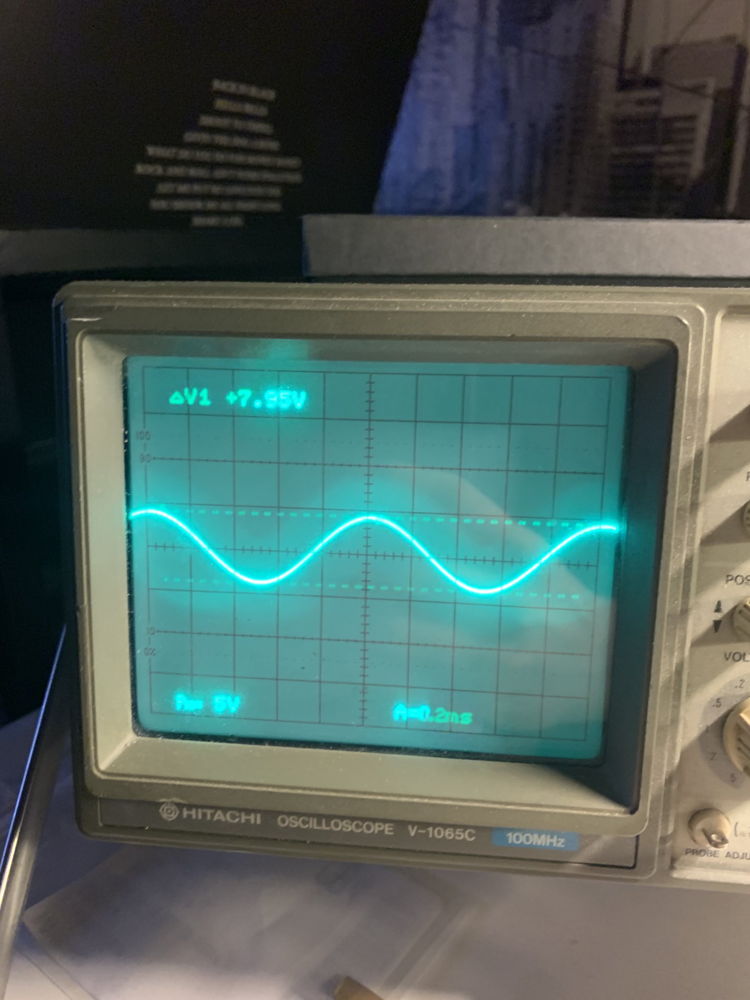

So, the volume problem: I put a 1khz signal through my phone (I know its not the most advanced frequency generator but it's what i have) on the
Left channel I get around 8V P-P on O/P and on Input (R301) around 300mV P-P
Right channel I get around 300mV input (R302) P-P so that's good, the input voltage is the same. On O/P i get around 30V P-P so this is where my problem is I only get 8V P-P on left channel and on Right channel i get 30V P-P.
So this is where I'm confused everything points to that the right channel has to be the one that's loud, the one that's working but that's not the case. When plugged into my speakers the right channel is barely audible while the left channel is booming with music. It's not a balance problem and I'm not mixing up amp boards, the Left Channel after some decent time of playing the output transistors heatsink is significantly hotter while the right channel is practically cold to the touch. It's definitely the amp that's the problem, i tried with another power amp for sanity check and left channel was fine.

Is Bridge switch in OFF position?
IC201 voltages seems OK for 0V on O/P status, all inputs are on 0 and outputs on some small positive voltage.
Try to check voltage on speaker terminals, as speaker protection relay will change amplifier amplification with negative feedback change, then if relay contact is bad you can see similar problem as you get.
Normal amplification is about 30 times, with 300mV on input you must get about 9 V on output. Wen protection relay is off or contact is not made, amplification is bigger as you get on right channel.

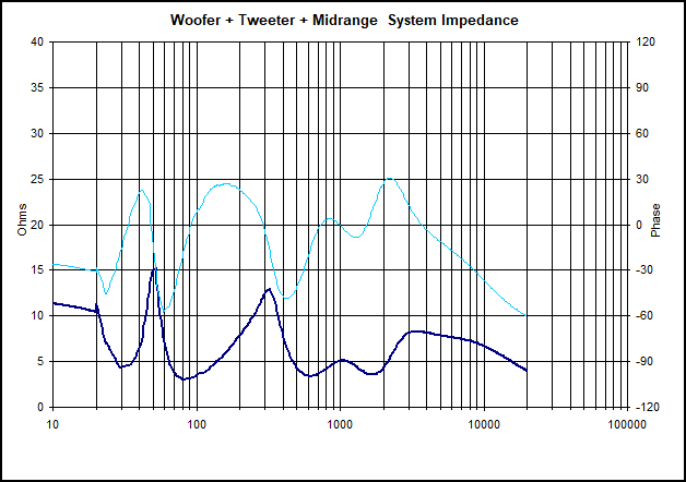

Just a curiosity question, I feel like this amp shouldn’t be clipping with the speakers I’m using but it seems like it is, I’m using well the NAD216 and a C 162 with some Paul Carmody Pit Vipers here is the impedance sweep done by Paul carmody
And the amp starts hard clipping before hitting the middle of the volume knob when listening to some Megadeth with soft clipping on. Now I know that the volume knob isn’t linear, but is there a way I can test to see if the amp is clipping too early. Another theory I had was that my pre amp was clipping but with its specs it should not be the problem.

Connect oscilloscope to output and other channel to input and you will see directly what and when is clipping. NAD216 max voltage amplitude before clipping is little less than 60V (or voltage on your amp power capacitors minus about 3V)

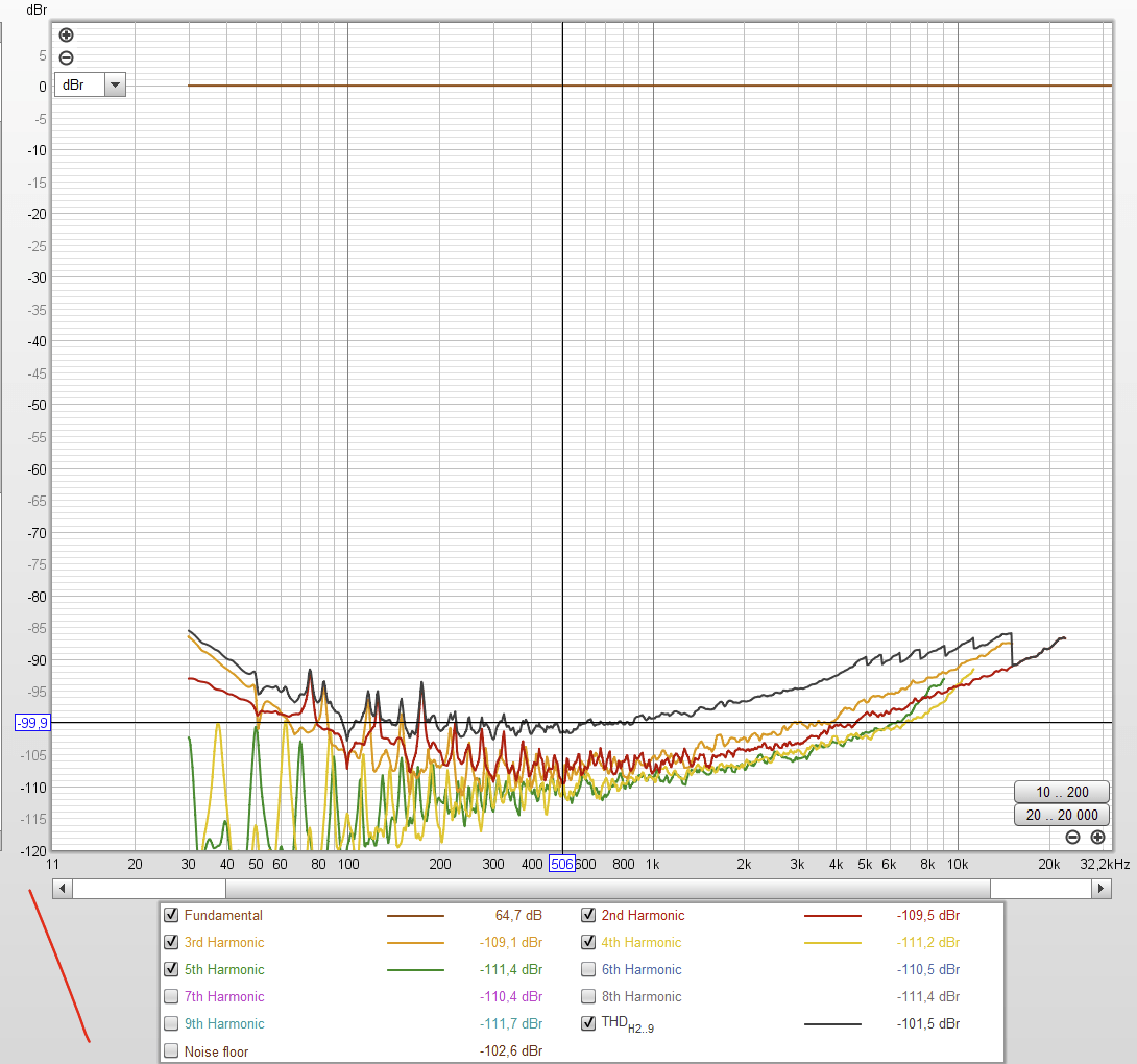

I can give a hint on how to evaluate the general quality of a NAD216 amplifier. Give 200 Hz to 1 kHz signal to the input from good sound card and REW software with such a level that the output voltage is about 5V RMS on 8 ohm load and measure the THD with same sound card, if THD is about -100 dB then the amplifier is in good condition.
My measurement was:
